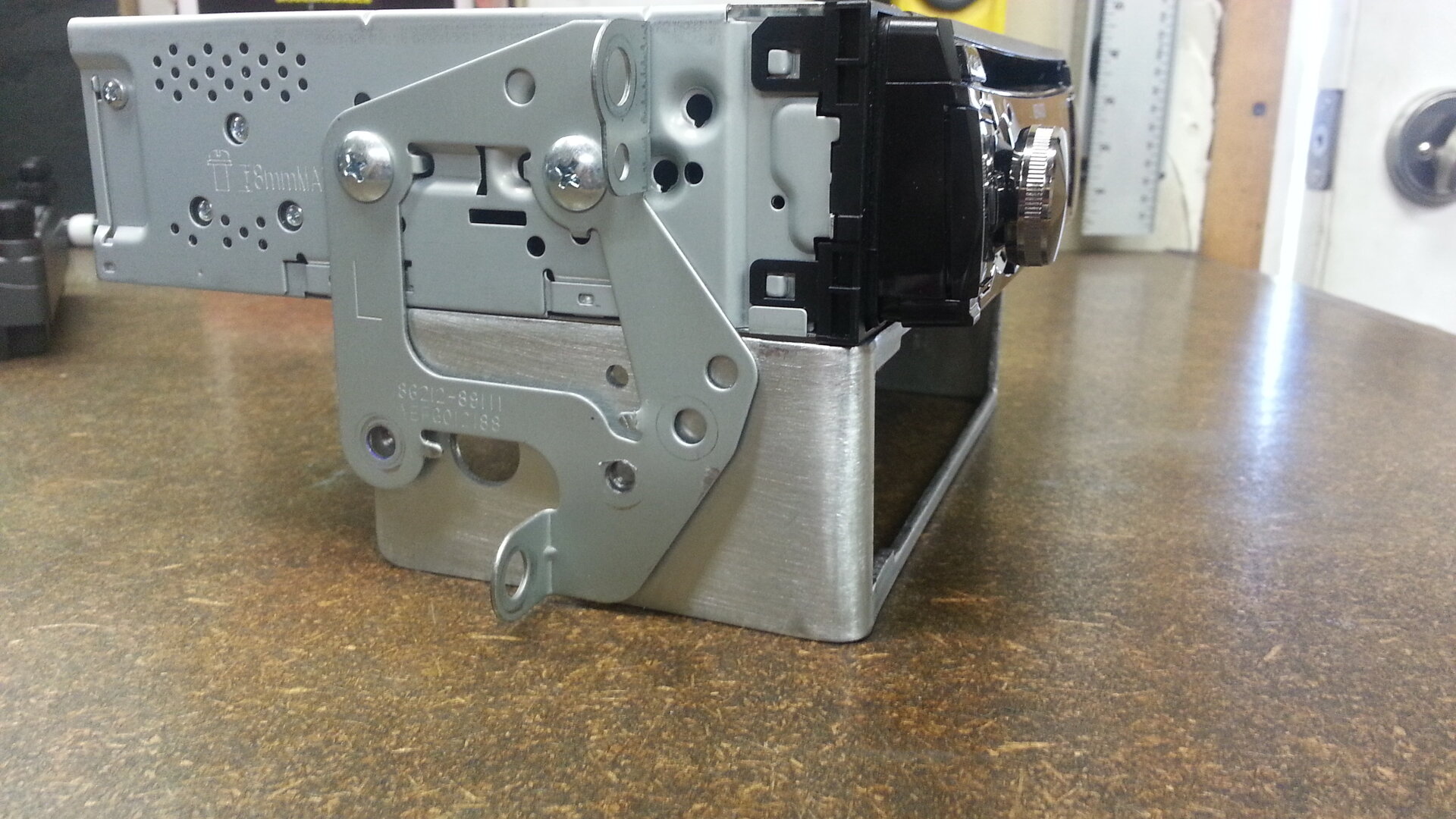

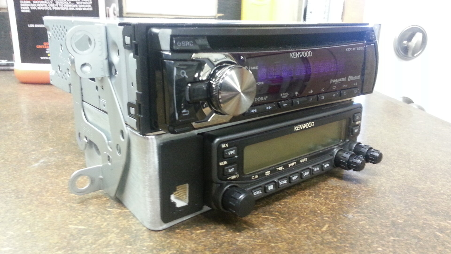

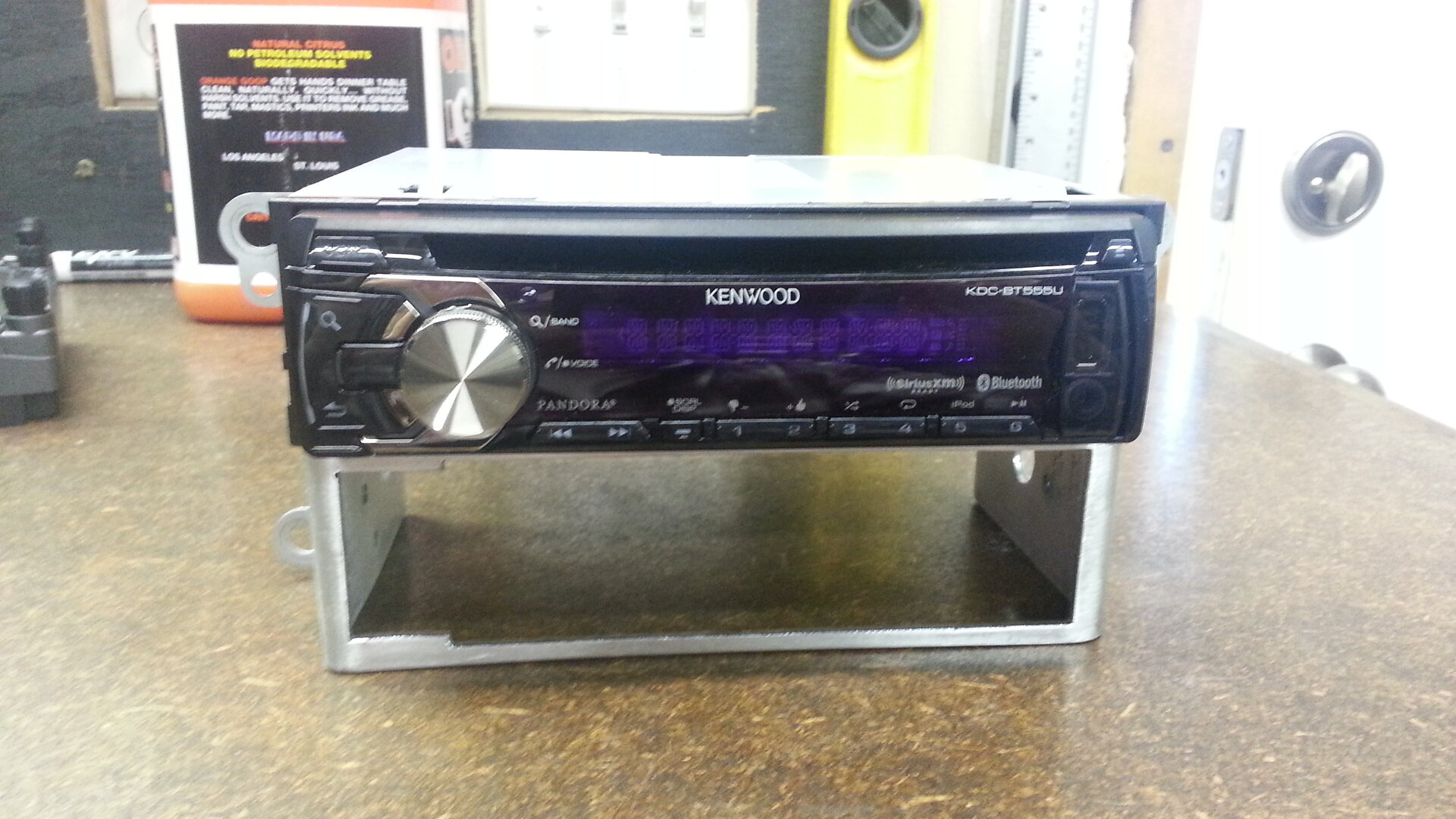

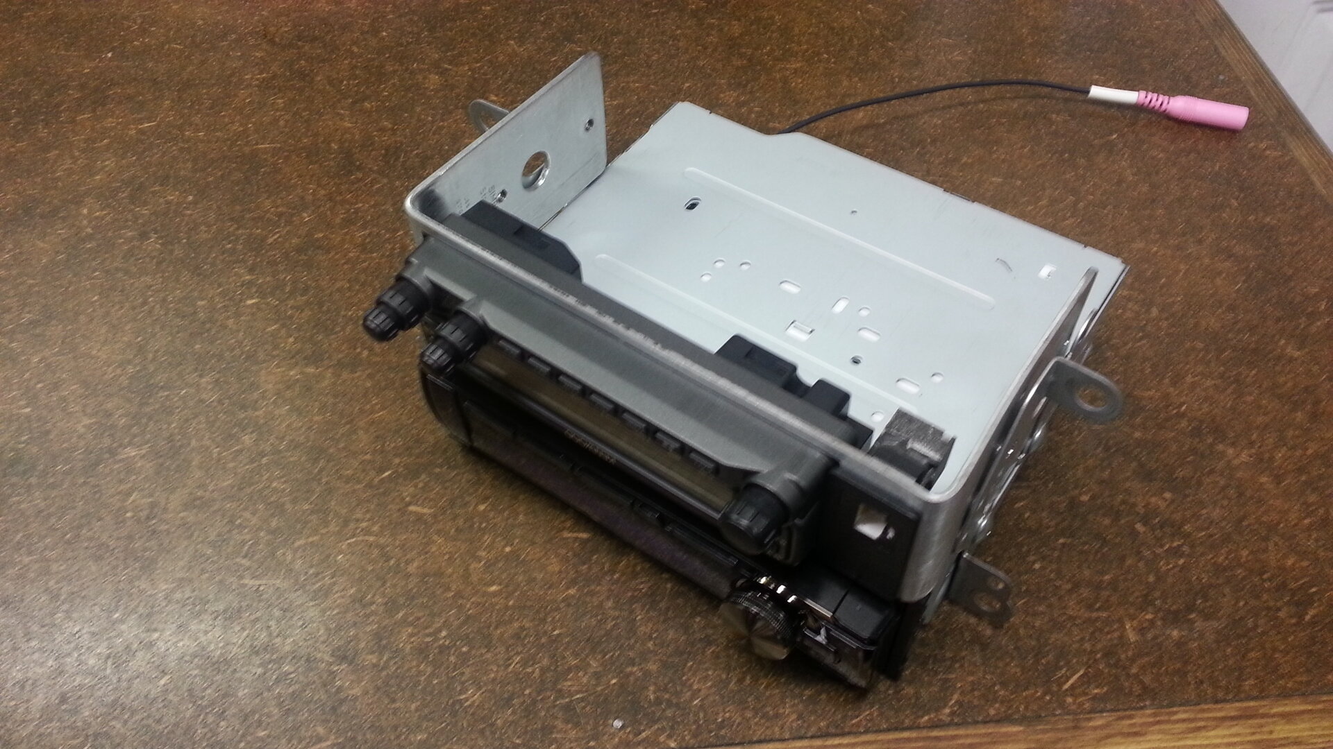

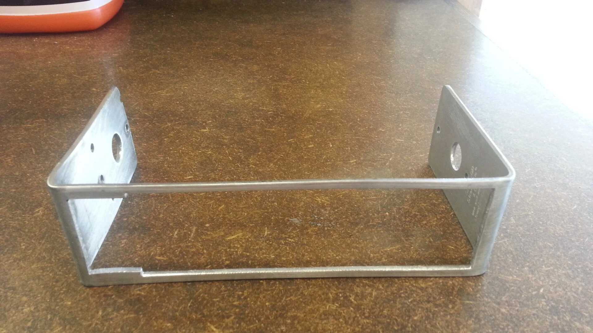

I don’t have the measurements as it was quite a while ago that I made this. I used a Simpson Strong-Tie angle bracket, bent it to the size of a single din, then cut out the dimensions for the face of the TM-V71A. Drilled and taped the bracket to use the factory mounts. Originally I had the mic input right next to the radio but moved it later as it was easier to fit the USB in that spot vs modifying a different spot in the dash. Here’s a few pictures from when I made it.
That's awesome thank you for the pictures. I might try to make something similar and this is helpful.
