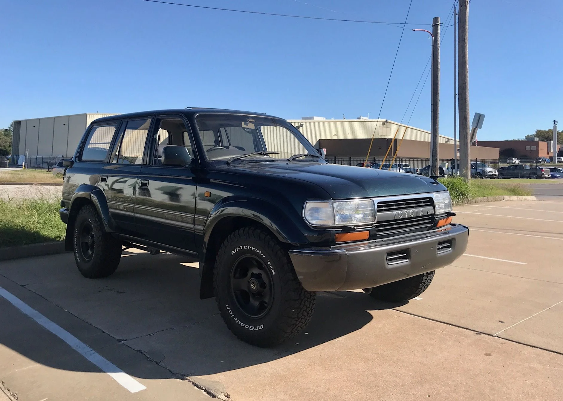

Its a late 92 Emerald Green JDM build so its a hodgepodge of 93 and 92 specs, got it with 193k kilometers so about 119k miles back in September.

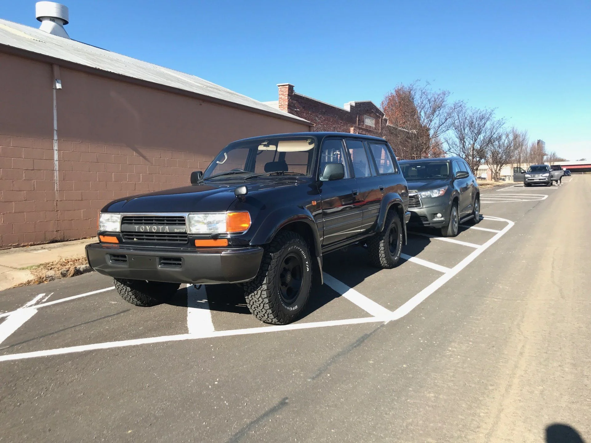

Here she is next to her current stall mate(my first new car ever 18 Q50 Red sport(which will prob be gone soon))

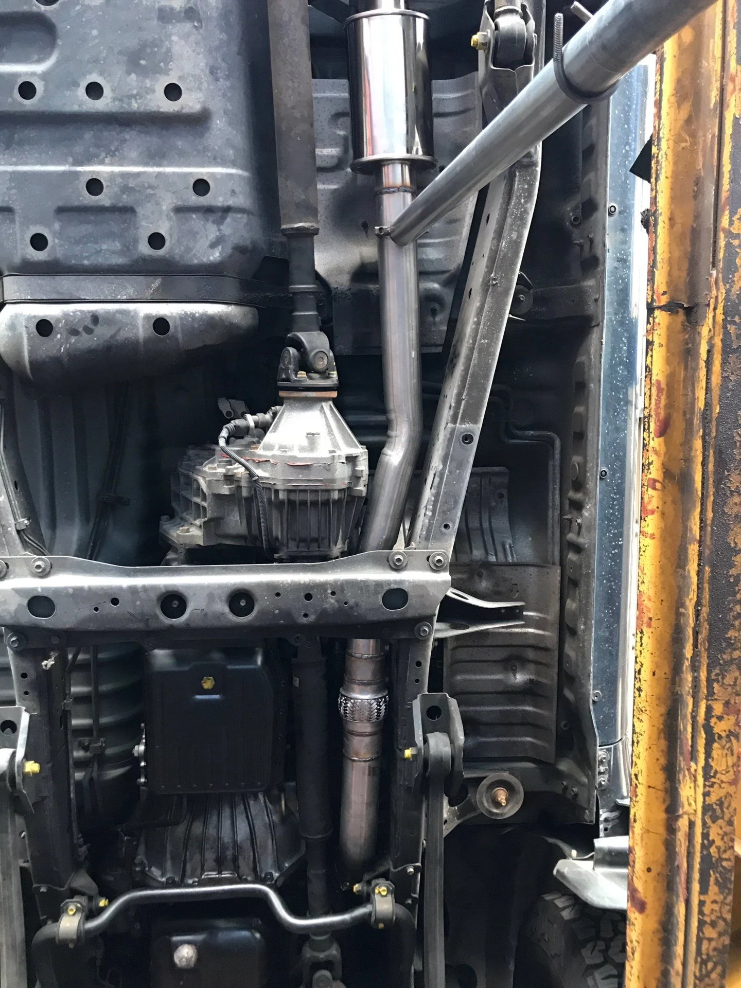

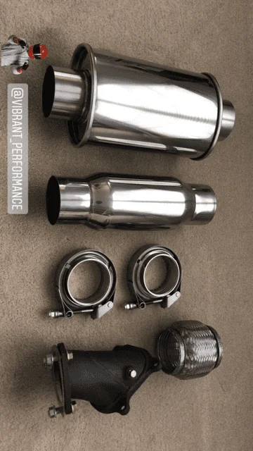

Then me being the novice that I am and already trigger happy to mod this thing, the thing smelled like diesel, a lot of diesel, so of course I figured the car had an exhaust leak. So right away I collected some vibrant pieces, 3inch dump from AUS ebay and took it to my local exhaust guy to do a 3inch Turbo back
We ended up not using the middle flow through resonator
As you can see clearance is t i g h t

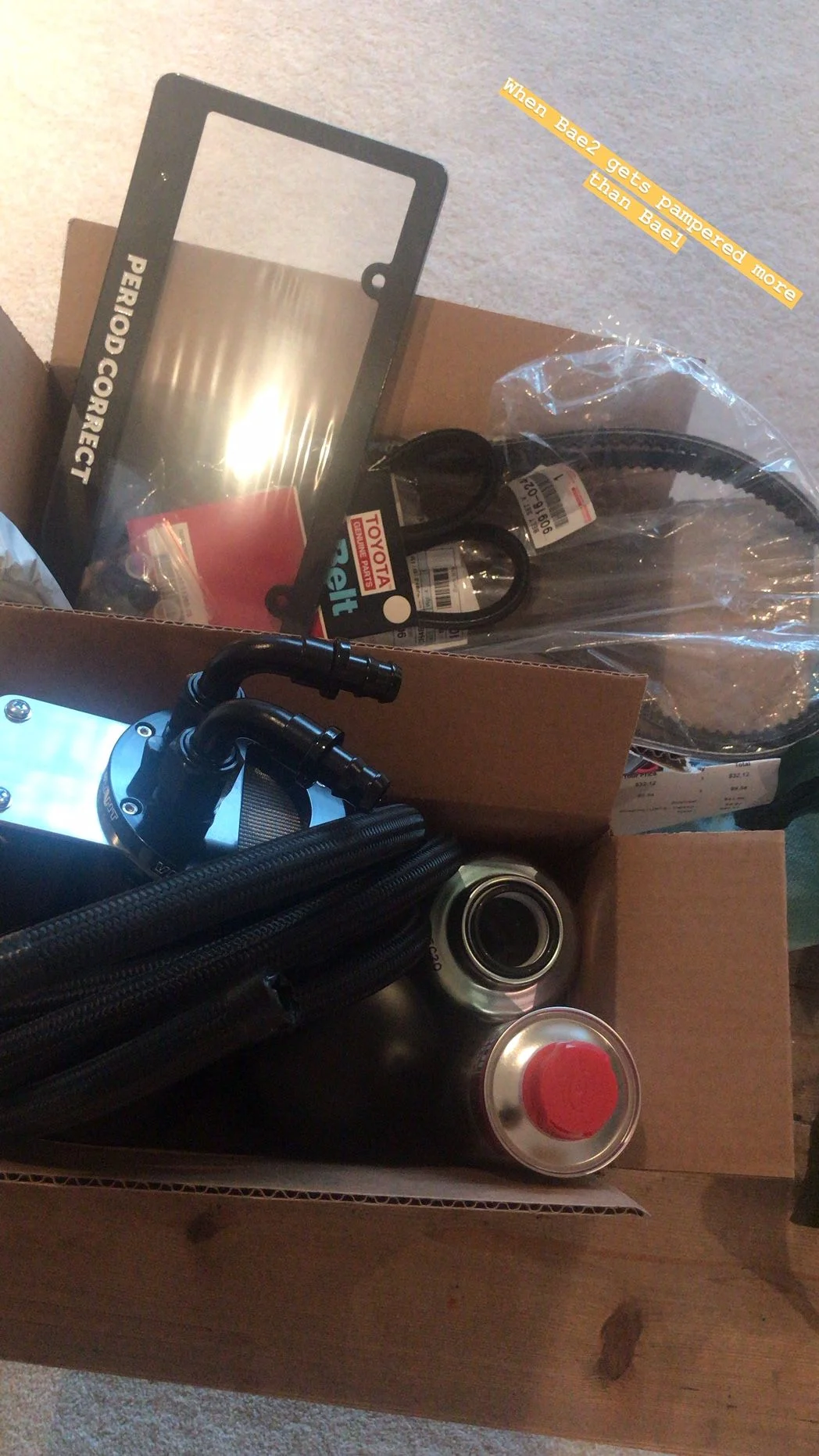

Then I started to collect mods for the next part of the baseline:
Oil Change
Fuel Filter

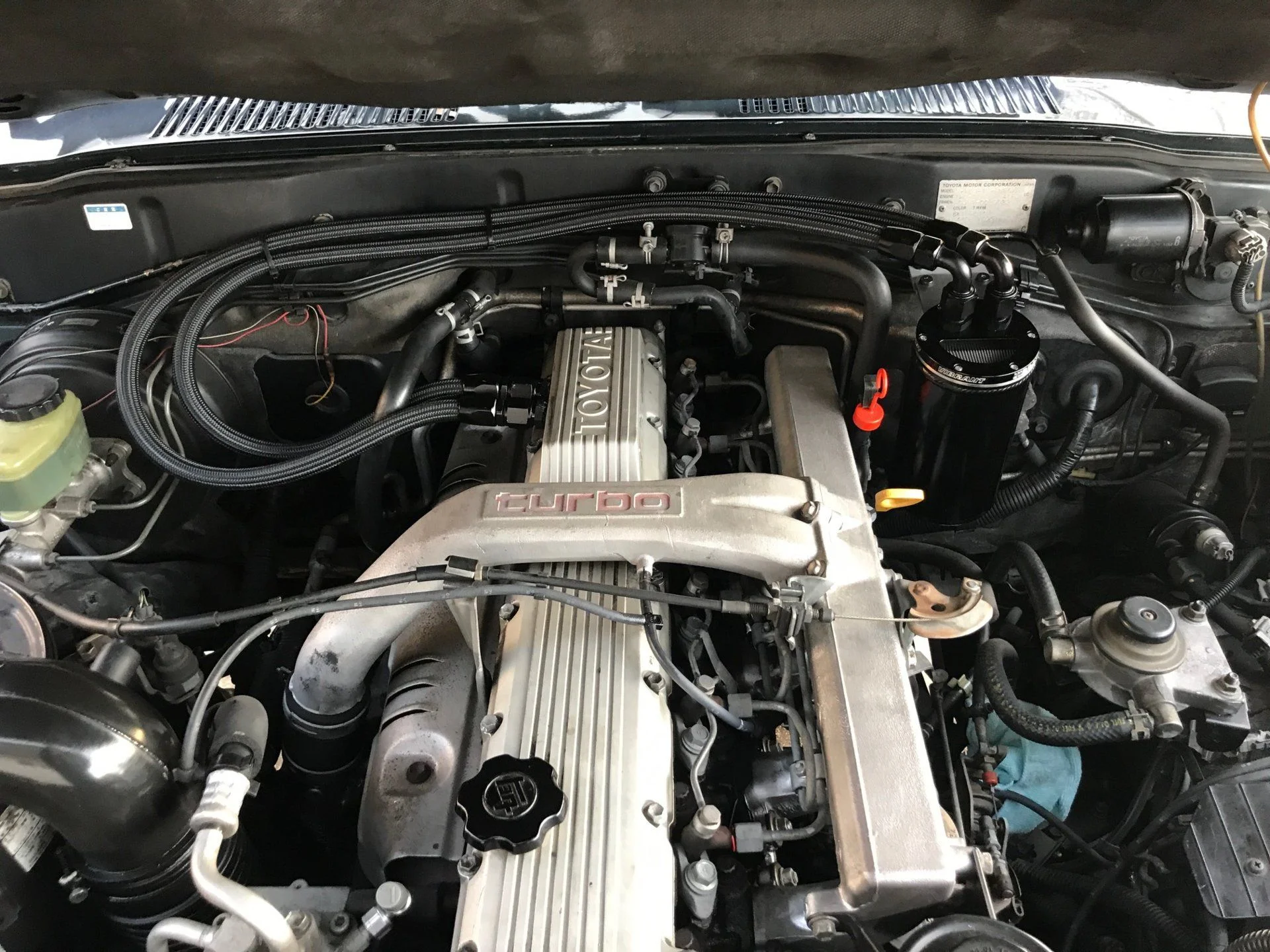

Catch can to help with the startup smoke(Spoiler it helped a ton)
Belts
Got the catch can installed, recommend this to all 1hdt owners, cleared up a bunch of smoke.

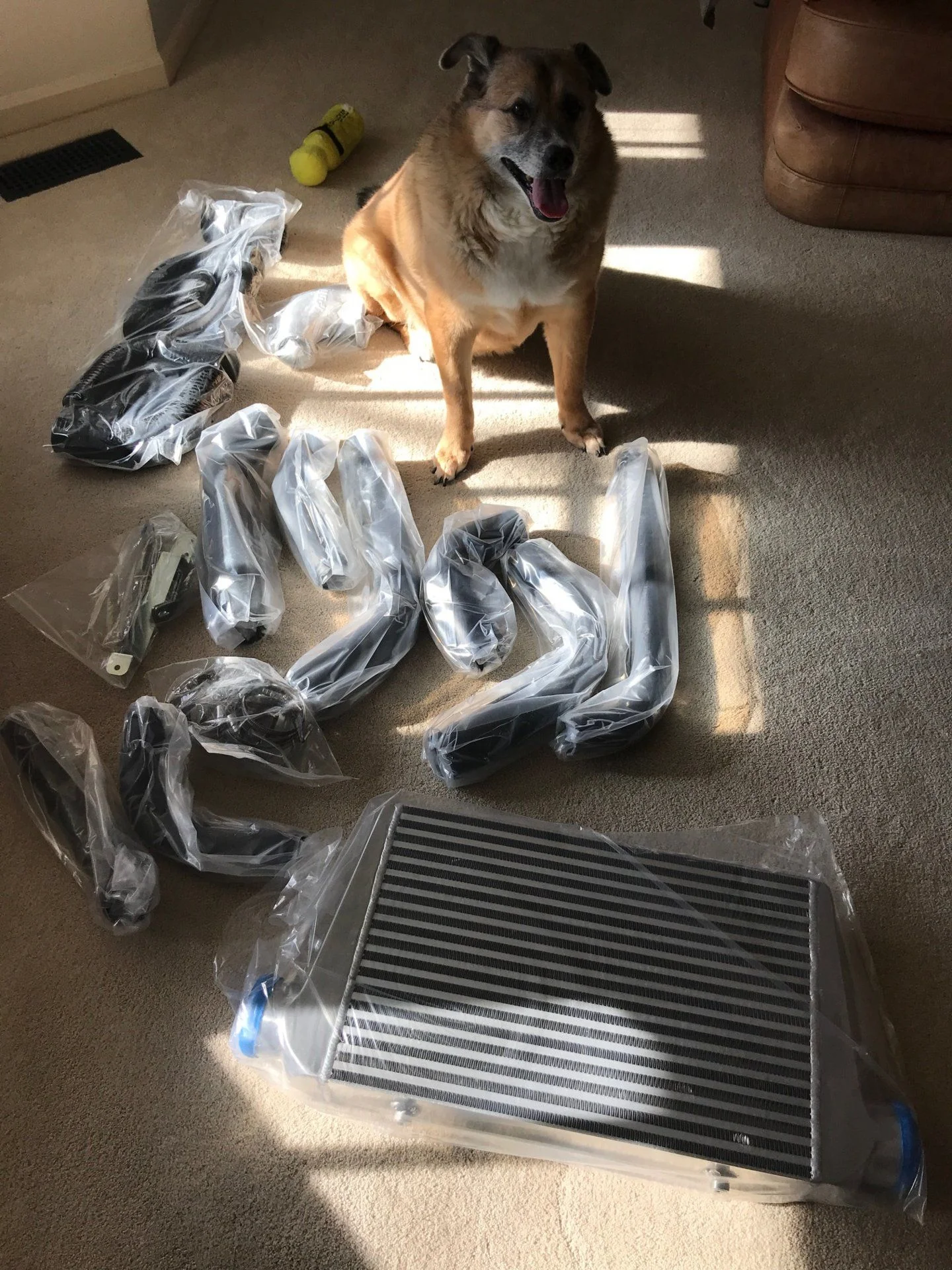

Also this came from Australia, not sure when I will have time to install it but its coming soon
Oil Change
Fuel Filter
Belts

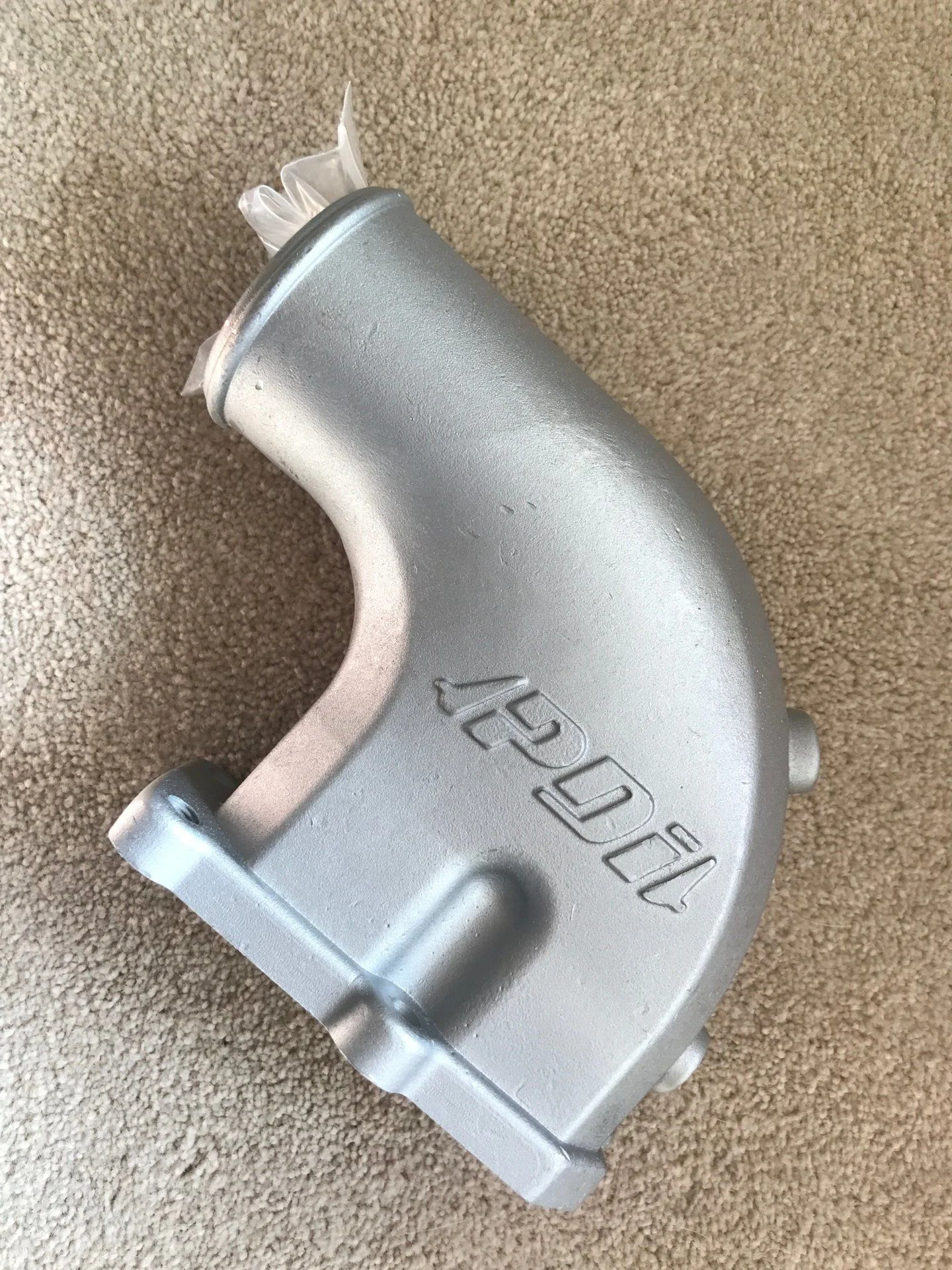

Which intercooler is that one? HPD? Can't wait to see more.
I am somewhat of a brand loyalist and do believe in R&D, except when it comes to some exhaust systems and intercoolers. I actually think the pricing for HPD and PDI is pretty good just the shipping was so hard to stomach for something like this(Ill bite the shipping bullet when it comes to the Gturbo). So I went with a ebay unit from AUS, I have a shop nearby capable of custom fabricating a kit so I figured if I get us 95% there then they can fill in the holes if needed. But the quality looks good and its a clear rip from PDI/HPD even came with this :rofl:

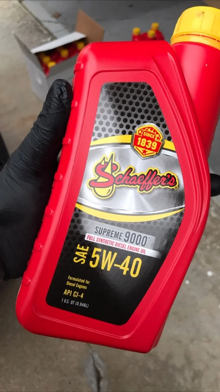

Not much of an update yet, did a quick oil change on it. Glad to not find any shavings and such in the oil, planning on doing a Blackstone analysis after the next change.
Oil is one of the biggest voodoo sciences out there but this stuff is supposed to be pretty great for these old diesels. I have to say im very happy with the smoothest of this motor it blows my mind everytime I drive it

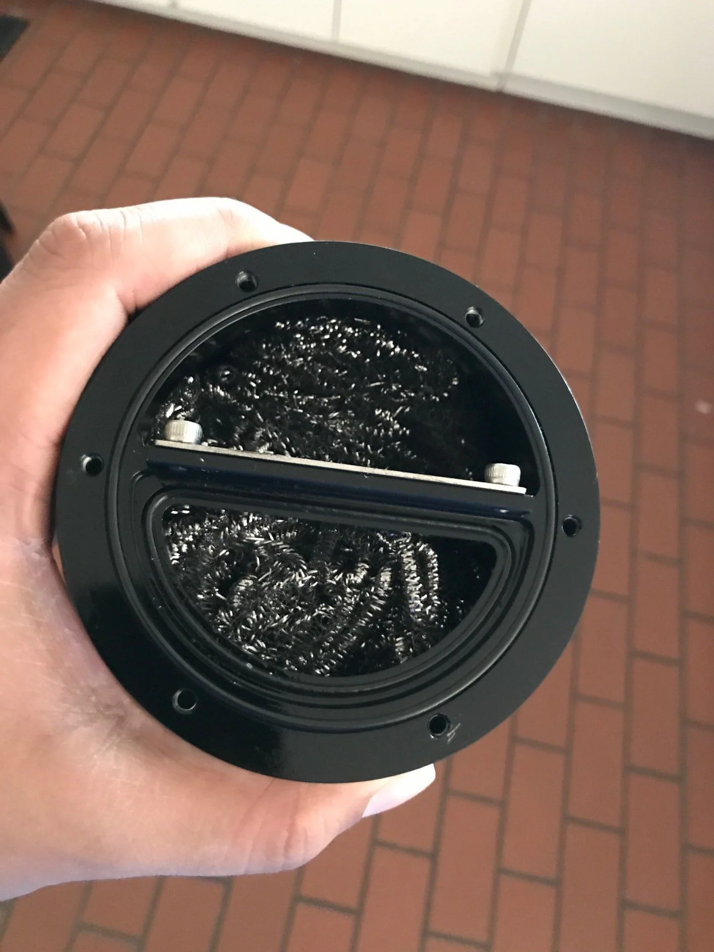

I noticed the catch can not "catching" any oil, this is mainly due to vibrants mediocre baffling system, so I did some research and found the best remedy to be Stainless Steel scrubbing pads, dont cheap out on these because 1) they are already cheap and 2) others will break down, these are the ones I bought:
Amazon product ASIN B07JNJZ6X9
This is just to "catch" the substance in the vapors so it will drip to the bottom of the can, with out this the vapors move so quickly that it basically goes in and comes out before any chance of collecting.

@Jroc561 Any heat issues with the exhaust routing? Any additional heat shielding? Rattles or other problems? Planning on routing my exhaust inside the frame as well.
None, I checked every few days for a couple weeks after I got it done to see if it was coming in contact with anything and nada.
Ill snap a few more pics of it soon
