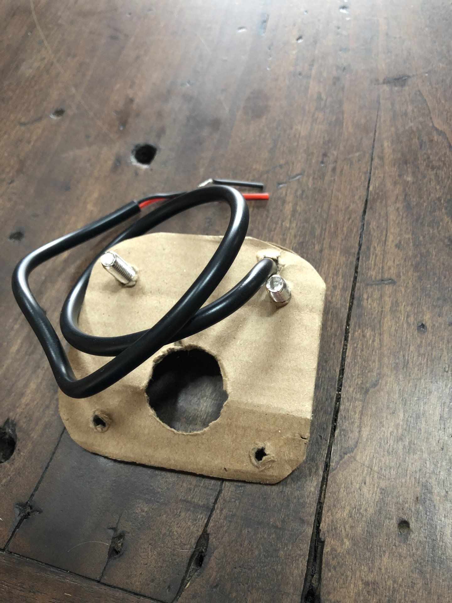

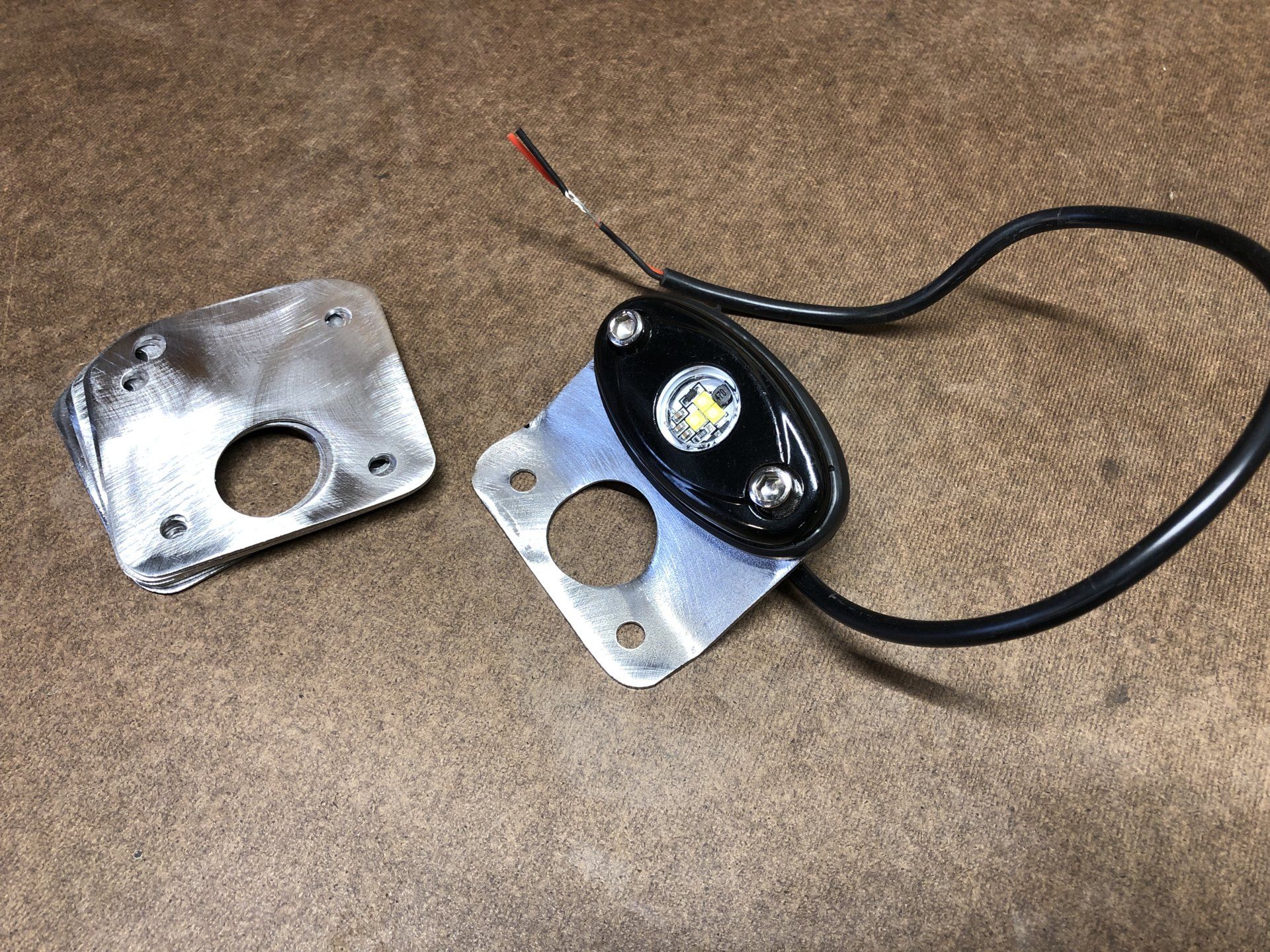

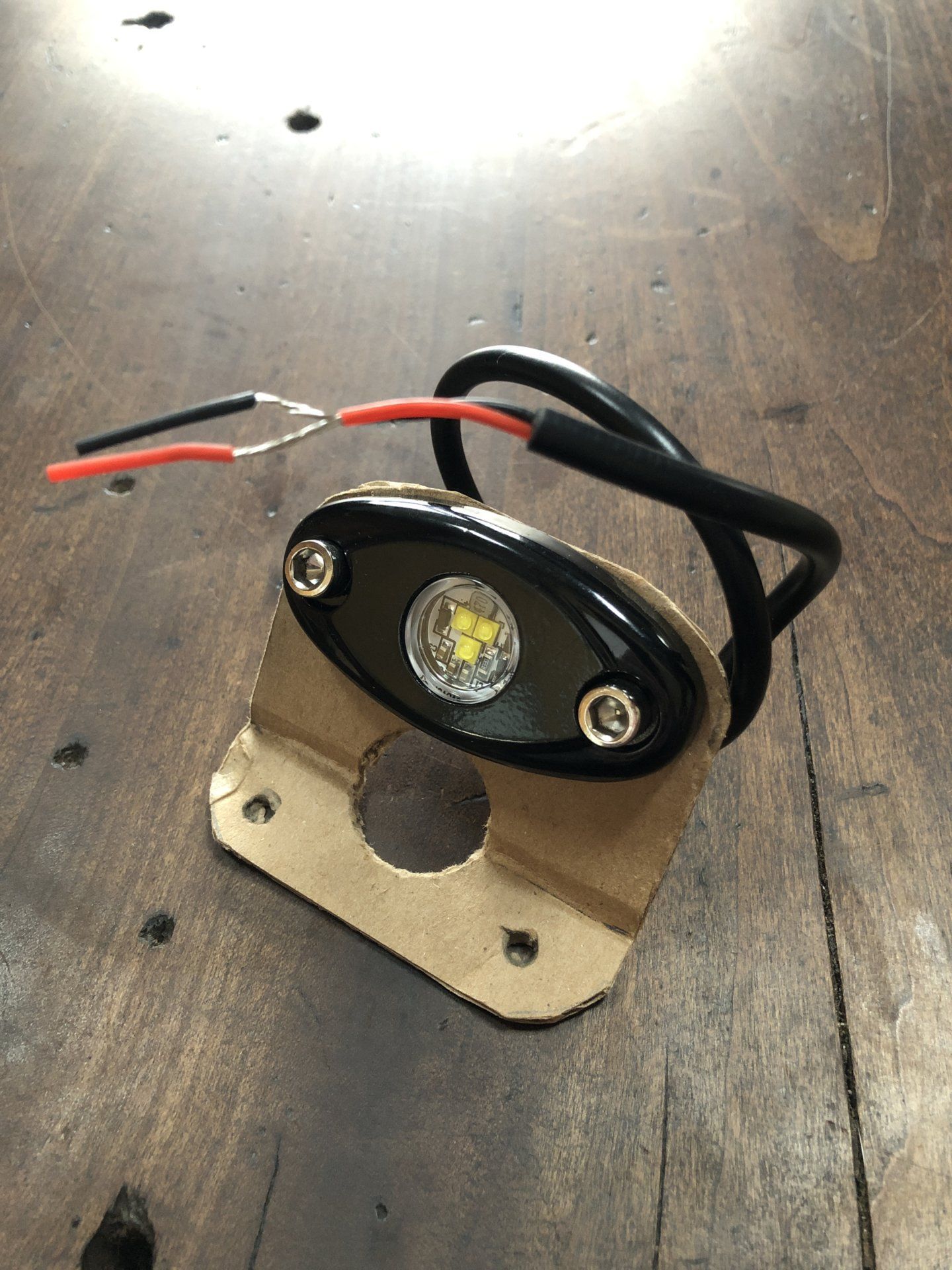

Since it’s been snowing off and on today and feels like it’s only 9* outside I’ve been tinkering around and decided to mock up some rock light brackets. Hopefully it warms up enough later this week I can actually make a few.
Since I overdid it yesterday on yard work I took it easy today and fabbed up the light brackets. Still have to decided on where to mount them and then play around with the angles.

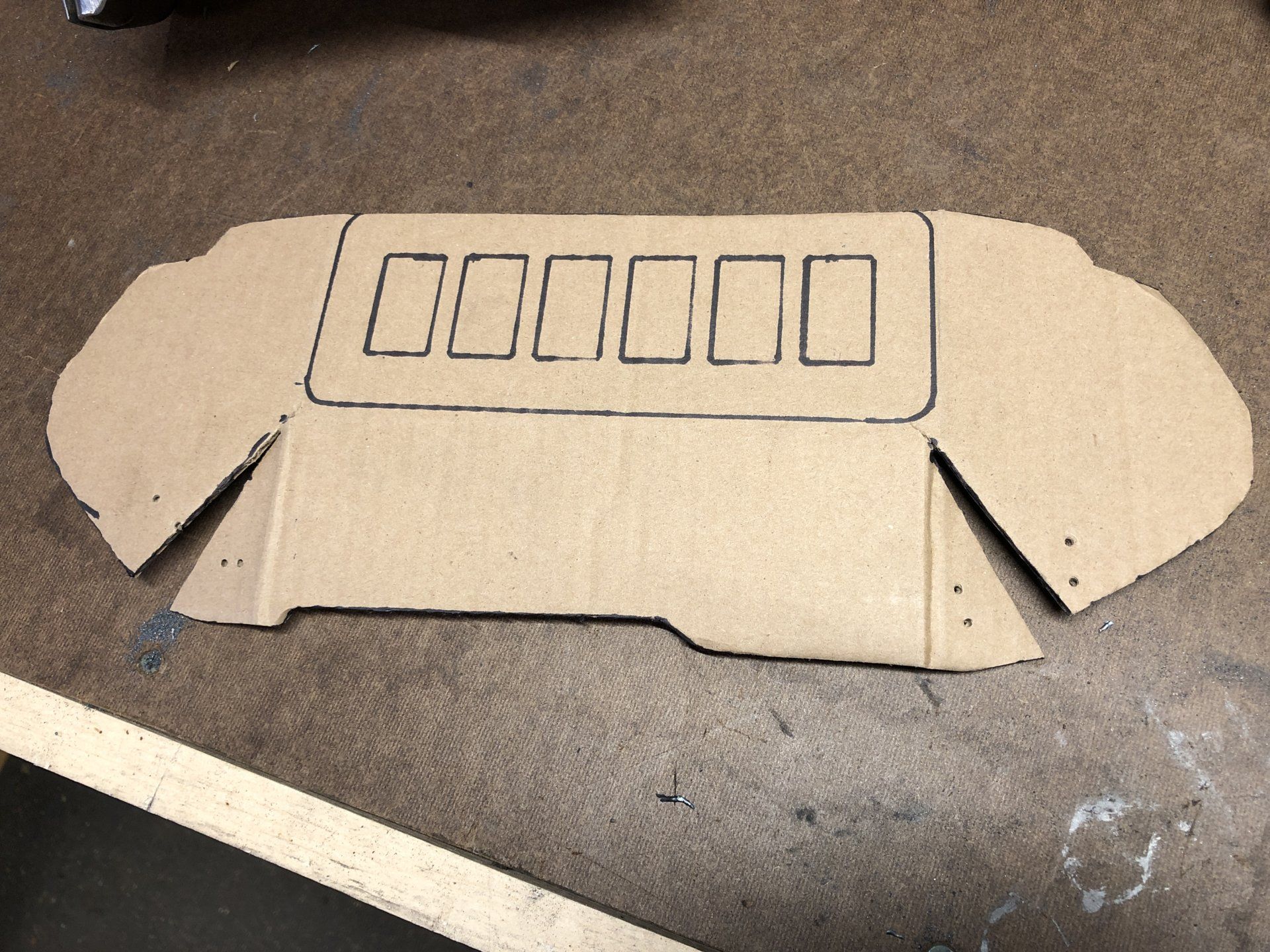

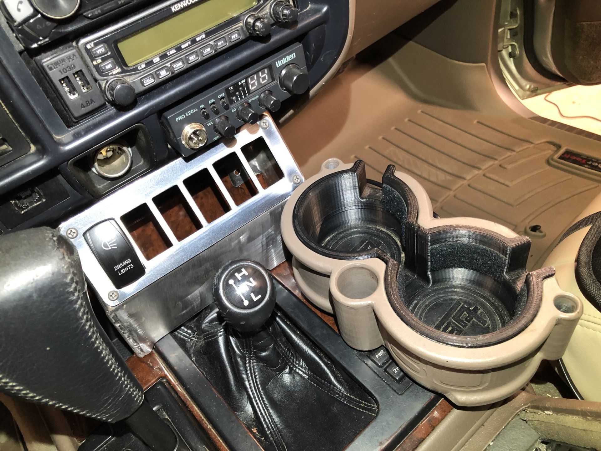

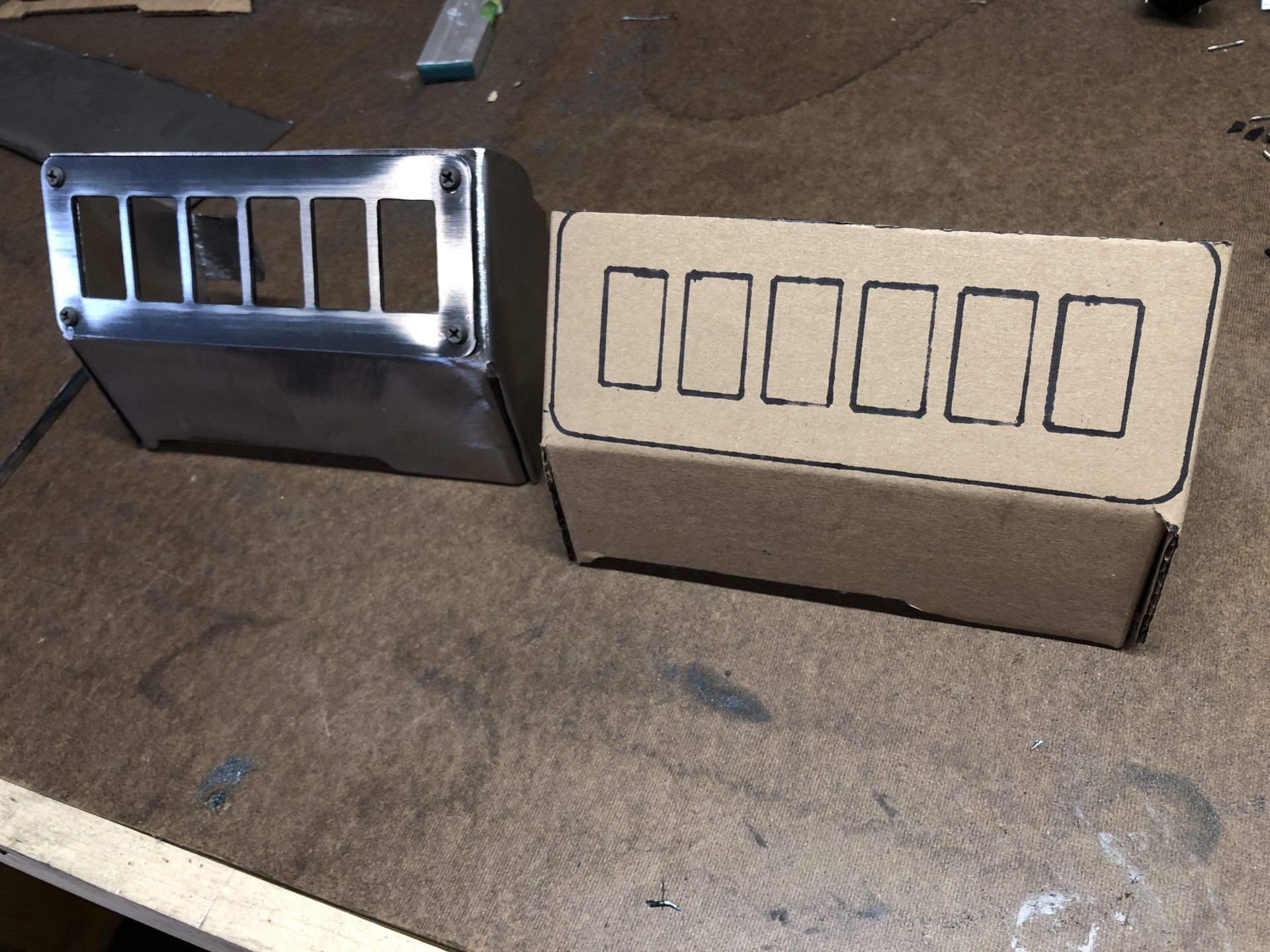

Farbicobbed a carling switch panel together as I’ve run out of dash spots. This will also allow me to redo some of my old novice wiring and clean things up. There’s enough room under the switches I could move my voltmeter and install more USB ports.

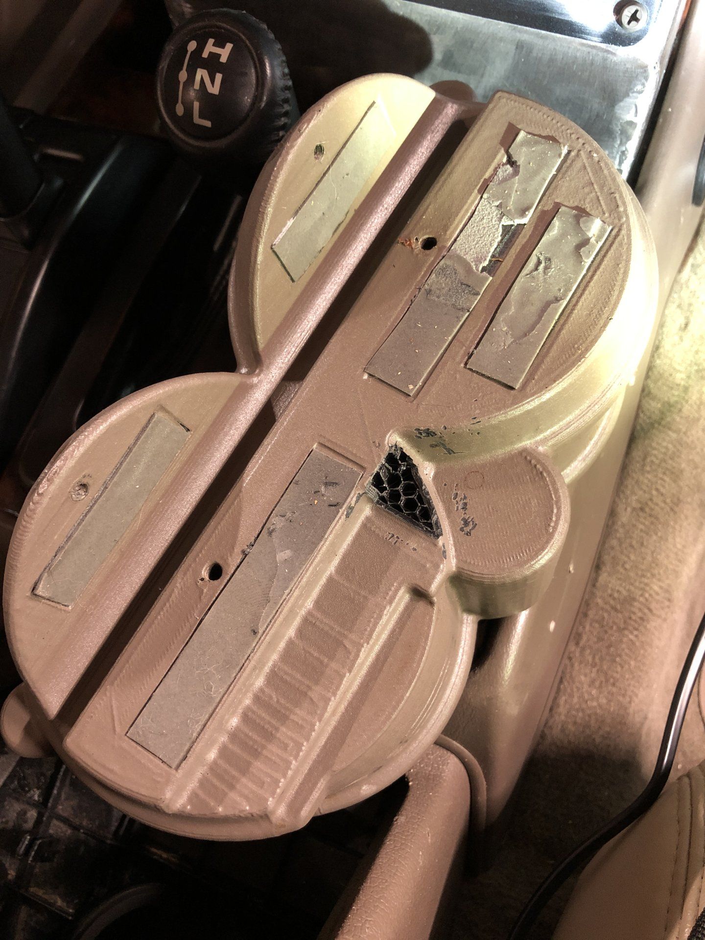

In order for the panel to fit with my old style @bhicks cup holders the bottom needed to be trimmed and the cup holder moved closer to the seat. Luckily I had already trimmed it a long time ago to be able to fit Yeti style cups in it without them hitting my ham/cb radio buttons.

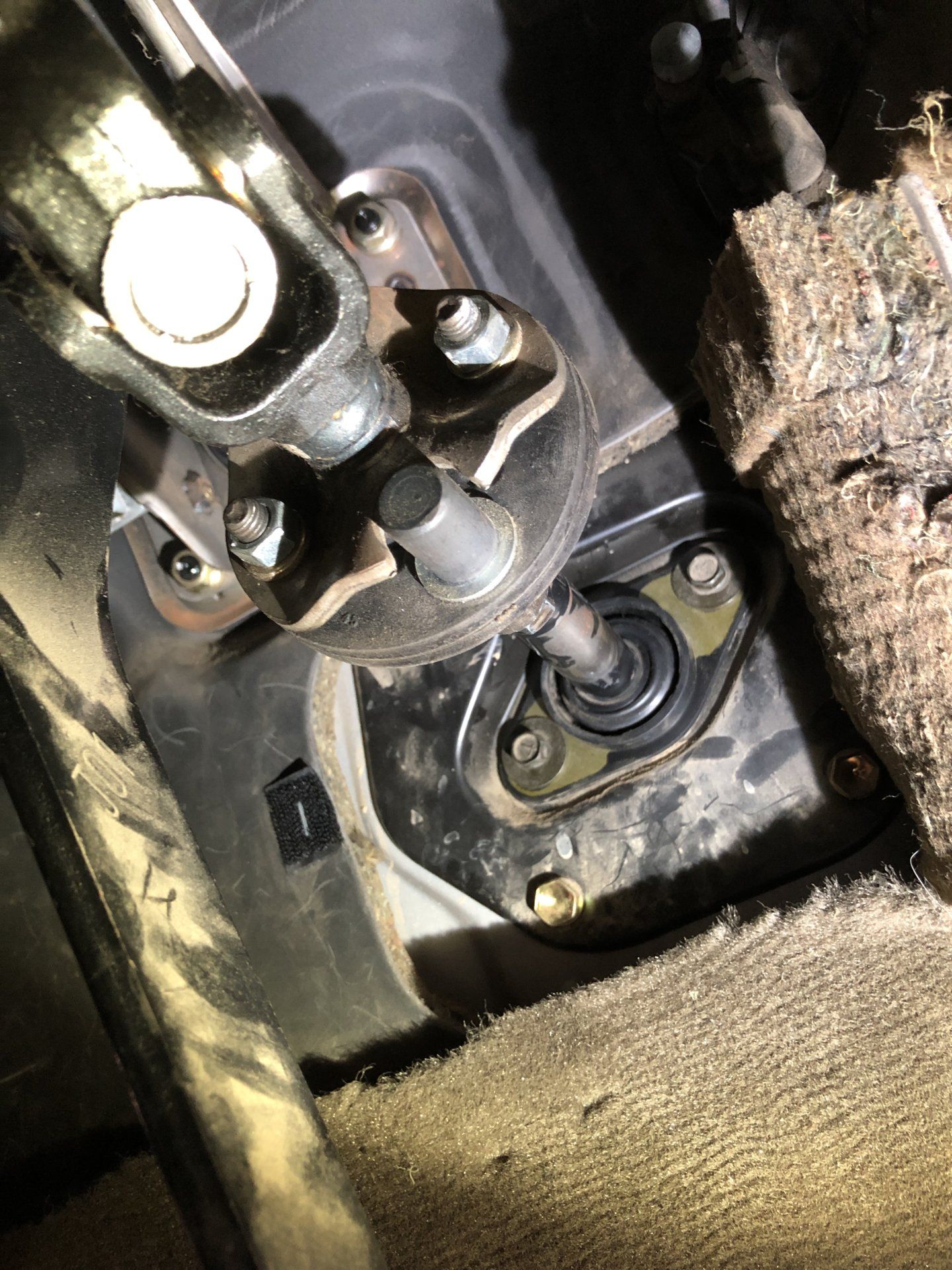

Replaced the shaft seal and steering coupling, well past due.
Feel any better?
It does feel a little tighter now. I still have some play but it's in the gearbox and inherit setup of the 80's steering.

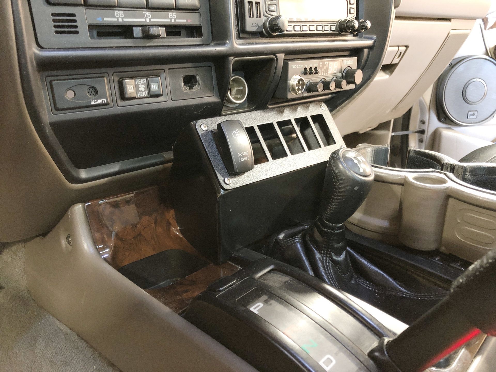

Still playing with the dash panel, it will be a while before I can get it wired up. Been thinking about changing my current wiring setup and building a new quarter panel mount.

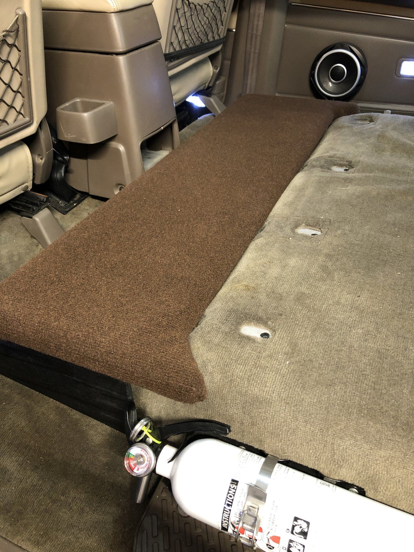

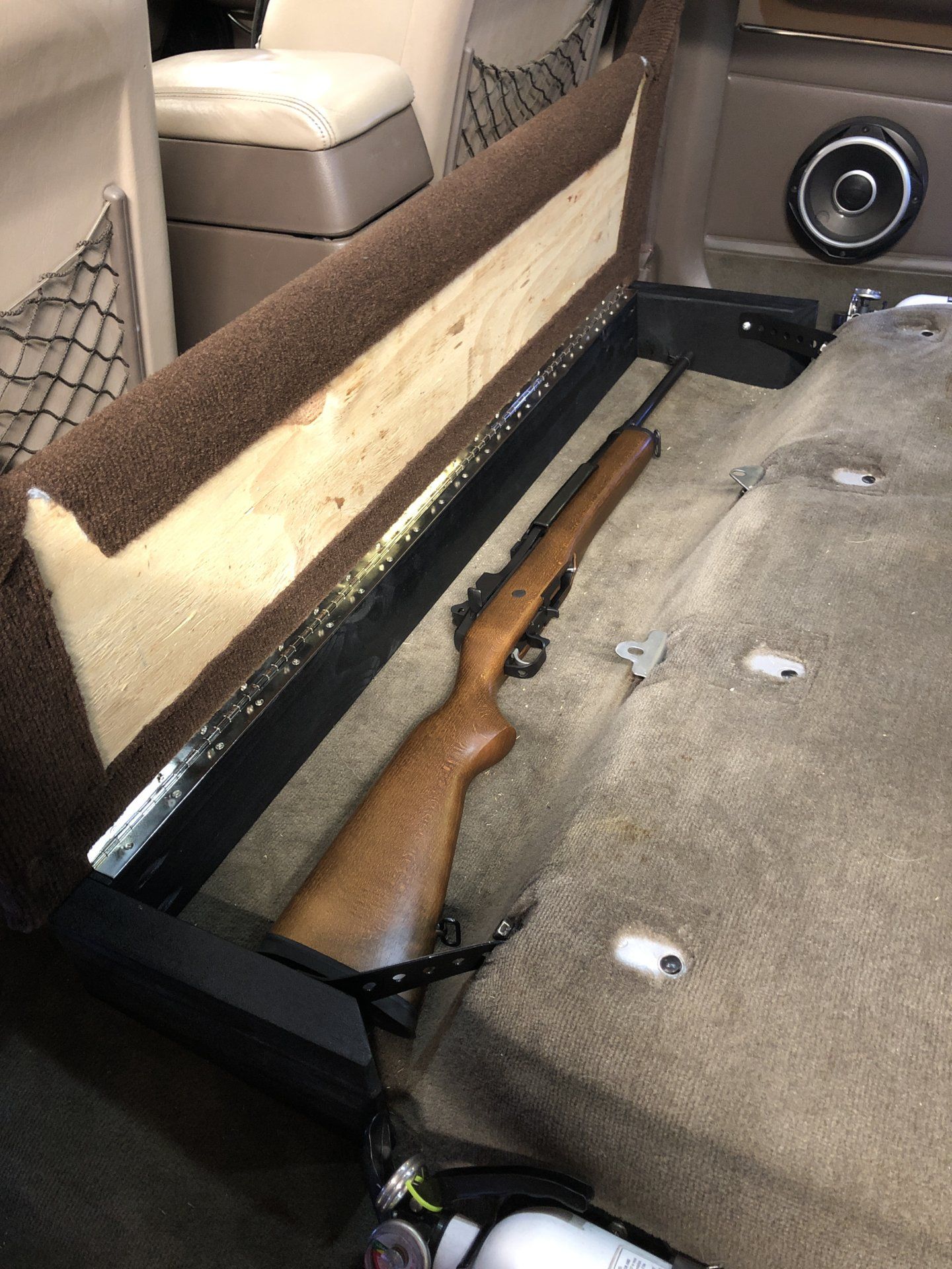

Also decided to make a prototype 2nd row floor storage. This is to level the floor for sleeping in the cabin. I’d prefer the final design to be made from aluminum if possible.
oh the possibilities
