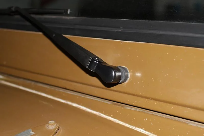

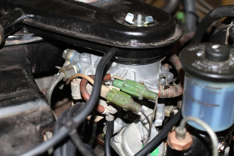

These wiper arms haven't seen these nut covers for a good many years... kind of a nice setup. ;)
I have GOT to get me some nut covers.

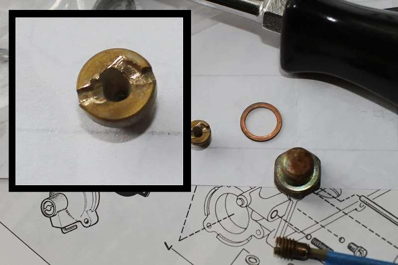

I guess something always needs go wrong. Woofed up one of my main jets with an ill chosen screwdriver. Didn't think I was going to get it out for a while. Ground down a big, nice Snapon screwdriver I've had for years because the fit was perfect - and it worked. I guess I have a special "jet" screwdriver now.
Dumb question - can I use this jet as long as the hole is good? And where do/would I get a replacement, Toyota, SOR?

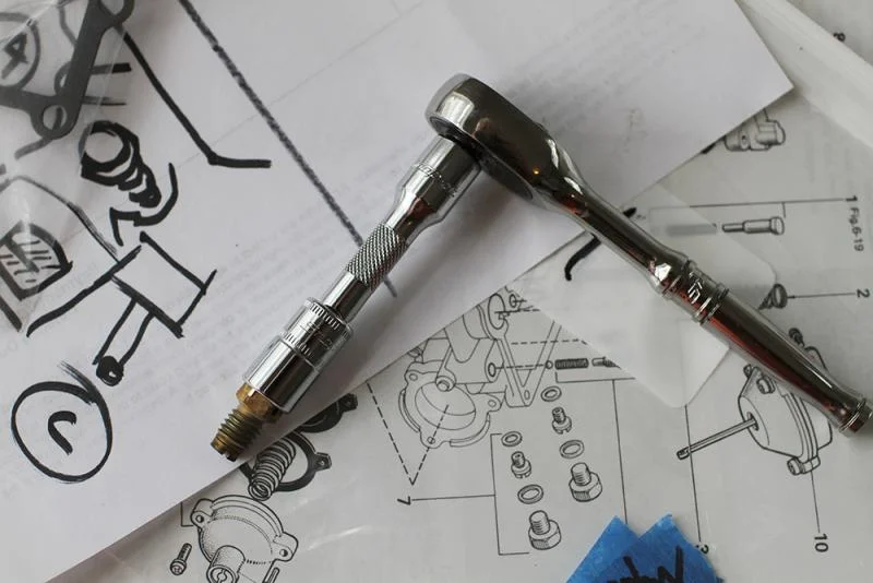

Looks like a small 1/4" drive, 9mm Snapon socket is a perfect fit for the hard to reach Power Valve.

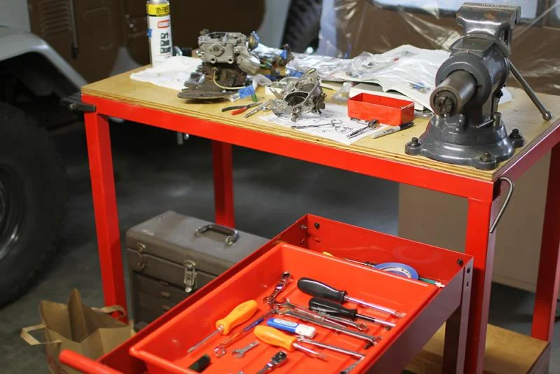

But, what I was going to comment on, was to say you need a shop stool the appropriate height- makes the whole carb rebuild experience even more enjoyable. :)
That would probably work fine, but I'd replace it at the local dealer.

I am betting calling Mark A. or Jim C. is going to be one of your few options. This is the reason I finally sent off my carb to Mark to get it rebuilt- couldn't find jets. :( however, I did discover something, as I was rebuilding a '72 carb at the same time: the older keyster kits for the carbs that had extra jets in the bowl plugs- (eg 72 & etc- maybe up to 74) came with jets, and when I ordered my rebuild kit from Kurt at Cruiser outfitters, I got a keyster kit that had jets! Now some of these jets were for non us applications so it's a bit of a crap shoot, but either way, one can take a smaller jet size and drill it to the desired size. A number of members on this board have done it: Degnol is the first that comes to mind.
No. Observe that the hex is barely inside the socket. The PV spring is too tall to fit in a shallow socket. Use a 1/4dr 6pt. deep 9mm.

Hope I didn't screw up (PV) on this. :o The image is a little deceptive, the spring is pushing the nut out of the socket. With a gentle push it tucks right into the socket (collapsing the spring a bit). The little mark on the brass is because I grabbed a 10mm first until I realized it was 9mm. :doh: Hopefully the spring is ok, it all seemed normal (spring action) when I put it back in... Maybe I can get a set of deep 1/4 inch drive sockets for Christmas. :)
Thanks again for all the advice. I actually found a .055 inch reamer in my old stuff which seemed to do nice job on the jet so I should be around 1.40 mm now - I'll see if I can find something a bit bigger/closer to the 1.45 or 1.50.

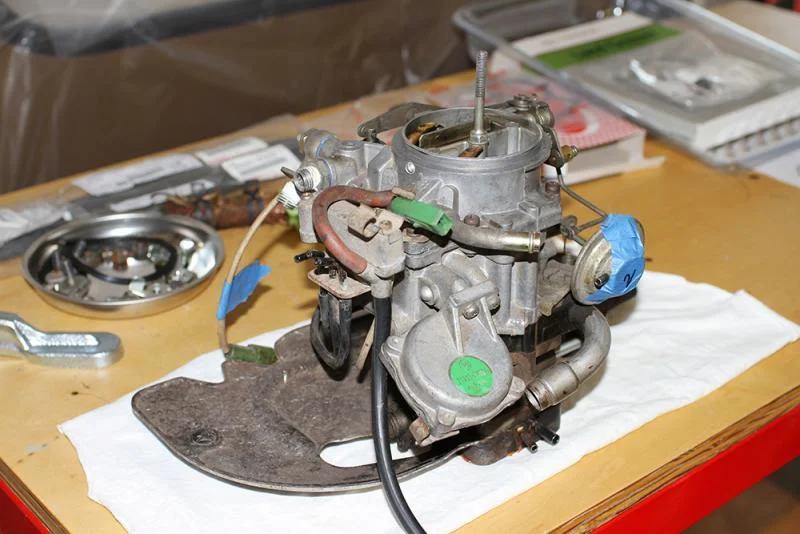

Got the carb back in. Short test run with the idle/air mix screw just set at the 1 and 1/2 turns out. All the stumble from idle to higher rpm is gone and driving along in gear I no longer get the on/off the gas pedal "jerk" of the engine trying to get the RPMs up.
Opened up the main jet to 1.50 (thanks again Jim C) and not only does it seem to run better - I think maybe it smells less. Need more time to test adjust.
And now I have new SST carb tools, special jet screwdriver and a chopped off 12mm open-end. Never found new jets for sale, and ended up with 2 rebuild kits. Got a Keyster kit from Kurt. Then of course the secondary was bad. Kurt didn't have one in stock, Napa ordered an alternative instead of the correct Hygrade number I gave them. Finally got the Hygrade (older one I think - had copper washers, etc.) so now I have a few spare parts.
Carburetor was great for a while. Then I left a store in San Mateo to drive home a few days ago and started getting sputtering and bad "off-idle" again. Got home and stuck a tach on the hot engine and the idle was low so I set it back to 650 and adjusted the idle/air intake screw again. Ran better and the next few short trips seemed ok but wasn't running like it was when I first put the carb back on. Went to vote yesterday with the added bonus of finding some dirt to drive/park on (behind the local Fire/Poll station). On the way home started to sputter again - dirty gas like. Took a closer look at the carb and the accelerator pump was completely locked up. :bang:
Pulled the carb again today and found the accelerator pump, pump outlet and ball all working fine - but the spray jet (just the small hole itself) was completely clogged with a very small chunk of gunk (technical term :D). With the good seal/pressure the pump could not push gas out the jet. Very gently took the smallest drill rod I could find, loosened up the gunk in the hole and blew out a little splatter of brown grunge. This after the carb body had earlier been dipped, sprayed out repeatedly with air, carb cleaner sprayed through all passages (that same jet a number of times), etc. Everything else in the carb still looked spotless (new gas line filter put on earlier).
Only thing I can figure is a small piece of gunk was left hidden somewhere (like the base of the pump around the ball, etc. where I cleaned out a lot of stuff earlier) and later worked it's way up to the jet after a few days. Now everything is back on the truck and the pump is delivering a strong shot of gas from the pump jet. Test drive maybe tomorrow. :meh:
