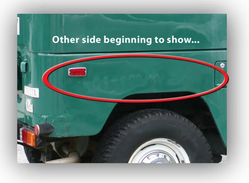

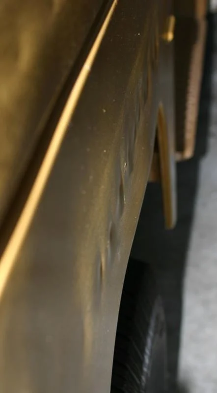

I’ve seen rows of what look like rivets or spot welds on the hardtops of FJ40s high above the rear wheels and they seem like a factory thing. Lower, on the tub, my 78 has “dimples” above the rear wheels on both sides in the area that looks like the tub to rear wheel cover join. I’ve seen another one (see green photos) that has dimples on one side and the other side is clean and straight. Mine has dimples on both sides. Is this corrosion happening at the inside join and a sign of cancer inside or is it something else? Almost seems like the sheet metal has been moved around causing the mounts to show? Thanks
Factory spot welds. The side without them has been repaired and repainted.
But I haven't seen factory spotwelds as "deep" or as "ugly" as those in the first 2 photos before. (Especially the first one.)
Perhaps they aren't "factory spotwelds" or perhaps rust is indeed causing the exterior panels to bulge away from the spotwelds.
Normally a sign of running 10.5 tires without a lift...they'll bulge the fender wells like that when at full compression the tire rubs.
I thought about that too - shouldn't I see some tire marks/rubbing on the inside fender area? I'll take a closer look when I get home.
It's mild, not gouging. You'll probably see the lip at the top of the fenderwell opening turned under. Continues over time as previously mentioned. I actually had a customer ask me one time if I had one of the tubs with the flared quarters!
Appropriate fix?
Both tire to fenderwell contact/distortion and rust bulges - bending the tubs accellerates the rust as it allows more junk to get in the seams.
This seems to be right on the money. Hard to see, but check out this photo - fender looks like it has a pushed out radius.
Looked inside and there is rust the length of the seam - not yet breaking through.
