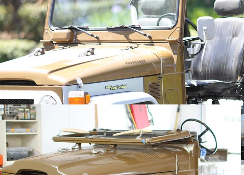

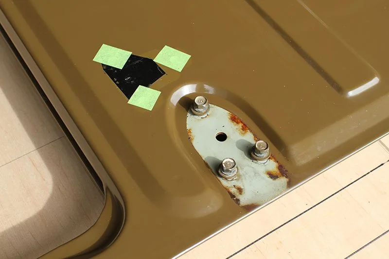

The paint guy used the camera on the outside of the door - original factory paint. I'm trying to match the aged paint and the hidden areas (no sun) with clean factory paint don't really seem that different to my eye. I'm sure the outside is more faded and the door is probably less faded than the hood, etc. I attached 3 samples below of the old original paint in different light. There's a section on my hardtop (passenger rear) that the PO had painted at some point and it kind of seems like an ok match but get it in the wrong light and it goes green - really shows in the dirty - no wax shot below - another match miss in the green direction I think.
The Rising Sun truck you put up looks a lot closer to me than PPG's book color for Olive. I think the gloss on new paint really makes it tough to judge also.
If that's a paint swatch you have taped onto the door there, I'd say it's good enough.
