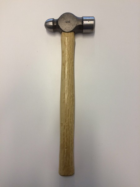

Interesting. What are the brand marks on those? One looks Japanese.
Are ball pens used for body work?
It's been over 6 years, but I did some digging and found O.H. Industrial as the most prominent hammers in that photo:
Looks like O.H. Industrial is the OEM for the TOYOTA branded hammer:
