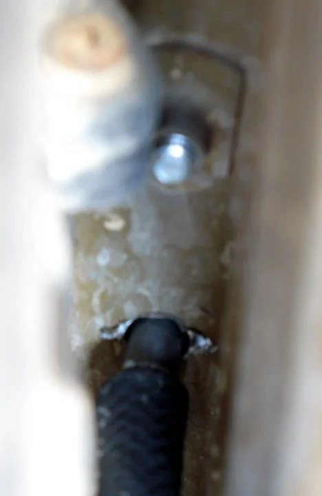

Gus, can you follow the red hose from the other port and take a picture of what it looks like on the other end? I follow Fast Eddy's description but it would be nice to see a picture of it. I have a later dizzy on my '77 and just have the hose going to a generic fuel filter on the inside of the firewall.
This probably doesn't help much - can't really show you anything inside without pulling a bunch of stuff.

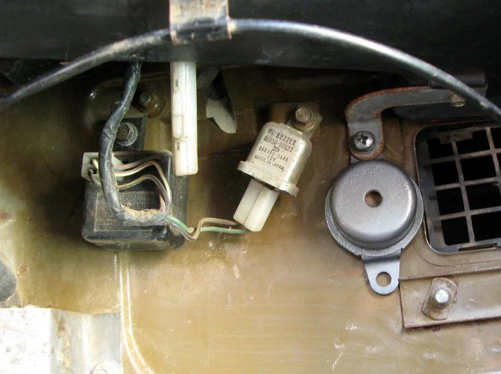

I don't have a picture of the stock location on a '78, but I had an extra breather and I added it to my '76. It's not in exactly the same place though.
attachment.php
attachment.php
huh. Interesting contraption. Thanks for the pics. Need to figure out where to source one of those...
Yep, just a breather.
