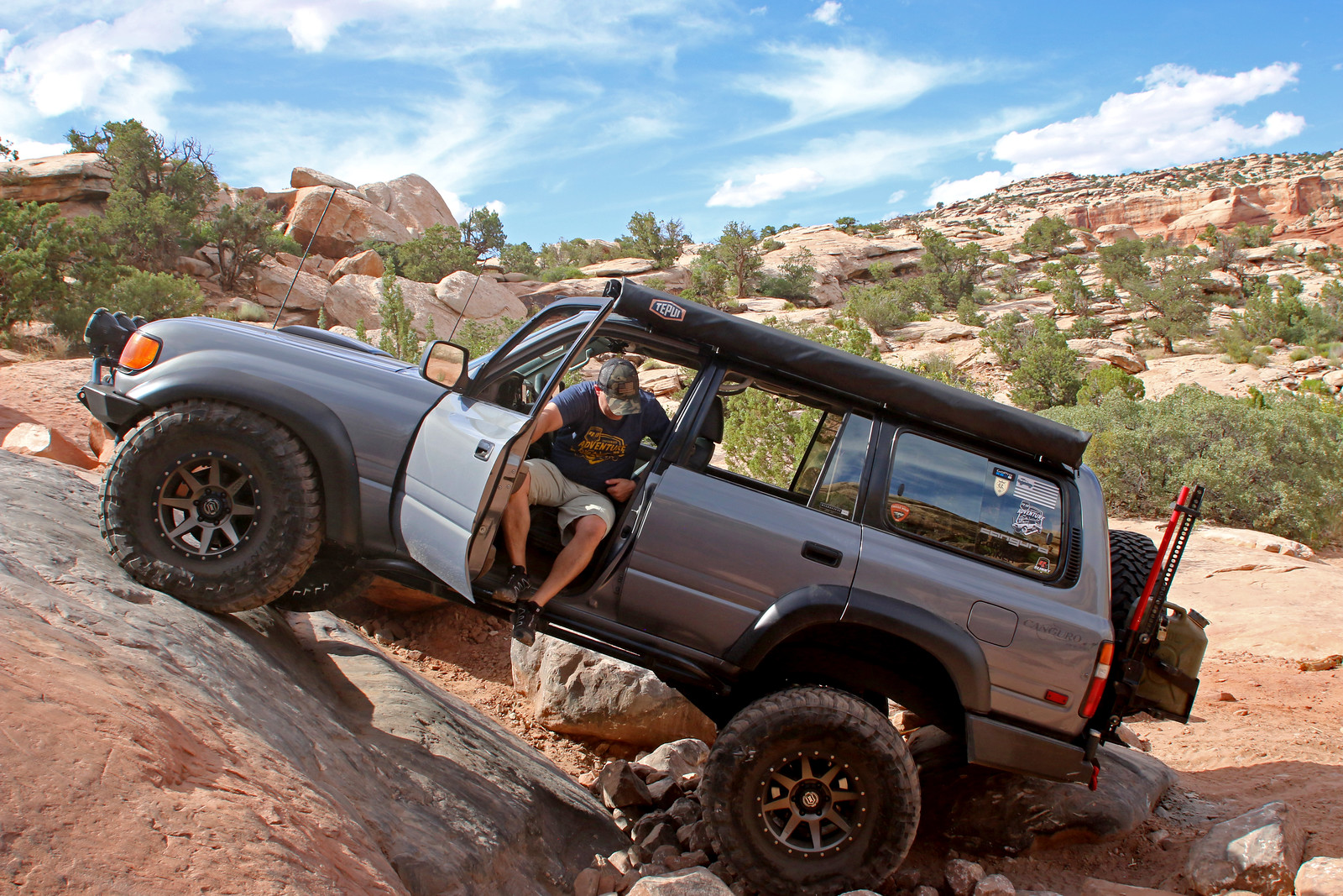

Had some additional trail time recently to further test the Timbren bumpstops with the 37s. I'm feeling satisfied with the steps I've taken to properly fit the 37's with the 3" Slinky lift. The truck worked well in Moab at the limits of flex. There is still light rubbing of the tires. The rear tires are rubbing the forward face of my rear bumper wings but its minor and doesn't cause any tire damage. The front tires have some light rubbing on the tops of the inner fenders near the fender lip. Replacing the bolts that hold the inner fender to the outer fender with button head bolts was a good move.
I have a 1" bodylift sitting on the shelf that I don't think is even necessary now, but I will probably still install it soon. It would mean I could reduce the bumpstop height a little.

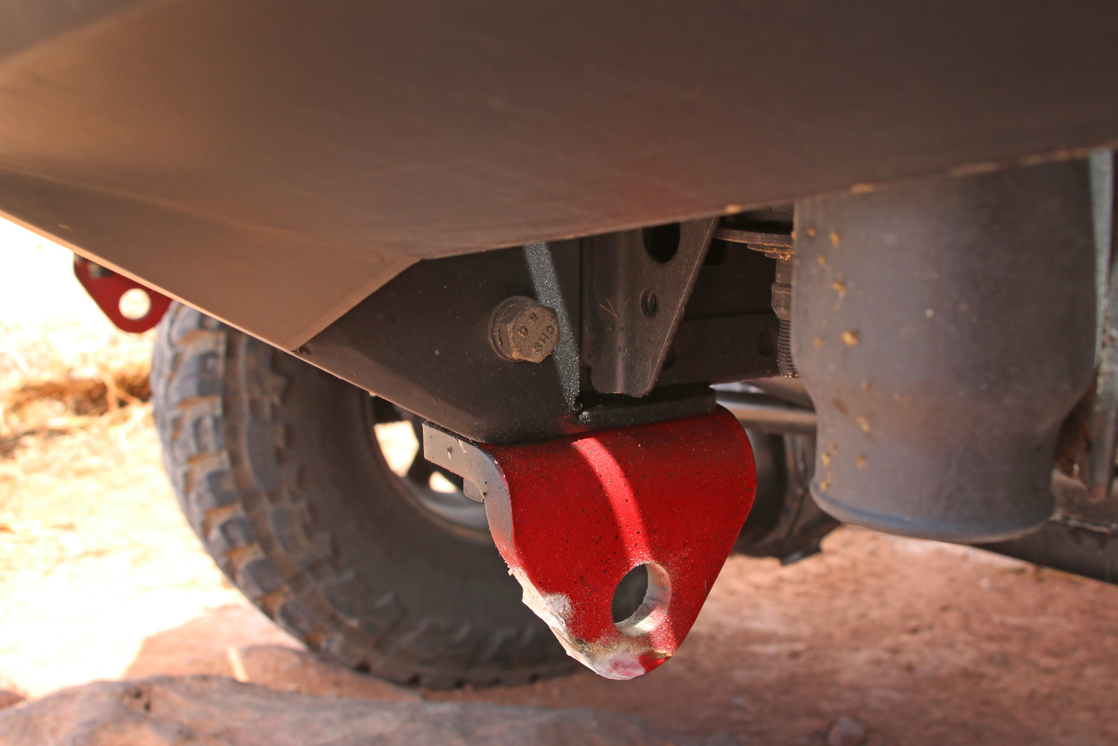

I've found that the Trail Tailor front recovery points have done a good job of protecting my AC Dryer. I know they aren't designed for that specifically but numerous times now I have hit them on large rocks or big ledges. Had they not been there the AC dryer would have likely taken some damage.

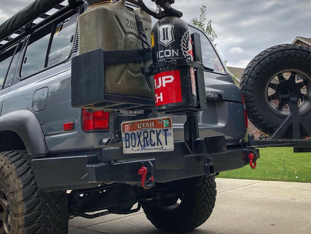

Added a mount to my second swingout for my CO2 tank. I have some rear drawers that will be going into the back of the truck soon and the tank has been mounted inside the truck in the cargo area. So I needed to move to tank to make room for the drawers. Simple one hour mod.
CO2 by Adam Tolman, on Flickr

I believe a Camary dryer from same year will work as replacement and is half the height.

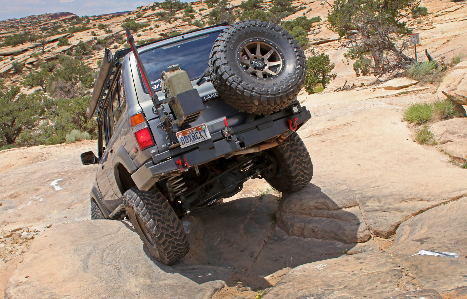

The last pic is where I snapped a Nitro axle shaft. How’d That go? I ended up winching to that buried axle shaft up top.
I've never had trouble with that obstacle until that trip and it was just poor line choice. Rear bumper got hungup on the big boulder at the bottom and couldn't go forward or backward. Winched about 10" to dislodge the bumper and crawled right up.

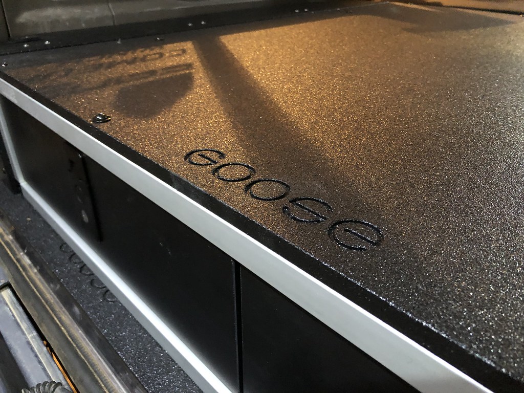

Another weekend project was installing the new rear drawers from Goose-Gear. I chose a basic two drawer 50/50 split setup. Goose-gear's design uses a wall to wall perfect fit base plate that bolts down using the factory holes for the third row seat and corner tie downs. The drawers came with all new hardware so there's no need to reuse any of the factory bolts.
The base plate has t-nuts in all the right location to bolt the drawer module to the base. The base plate has more holes than what I needed so it's universal for any of the rear module configurations that Goose-Gear offers.
Latches are clean and strong.
There are side panel compartments with quality 5-way adjustable hinges for the perfect fit and it completes the top for a wall to wall platform that also runs from the tailgate to the back of the second row seats.
Truth be told Goose-gear is one of the more expensive options for drawers but the quality workmanship shows. It's obvious that these have been built after thousands of miles of testing offroad. They are solid and the construction is sturdy using an internal aluminum 80/20 extrusion frame, and quality sealed bearing drawer slides.
I'm looking forward to figuring out what items I will move to the drawers and then get out and use these things. Last thing to get sorted is a fridge drop slide. Hoping to have a solution for that soon.

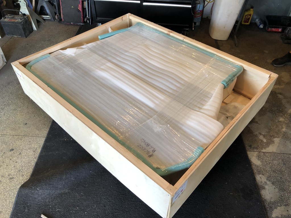

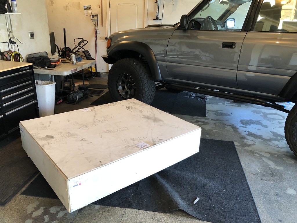

Drawers arrived well packaged in a nice shipping crate and on a pallet.
Drawers by Adam Tolman, on Flickr
Everything was well protected inside.
