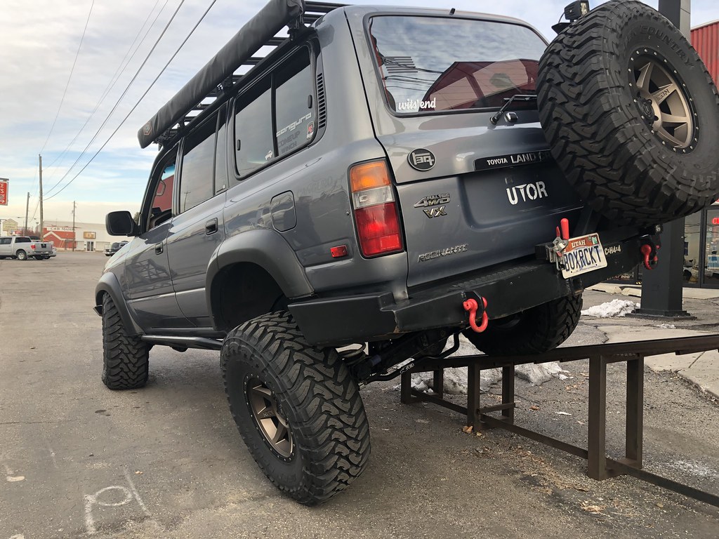

A few pics of the rear bumper. This thing took some elbow grease to get all cleaned up, but it turned out nice I think. I need to make final adjustment to the latch but it's all working well. This was a bumper kit designed by Wildyoats and there were about a dozen kits made a few years ago. I'm glad I got one of them while they were available. I really like the lines of the bumper and it works great.

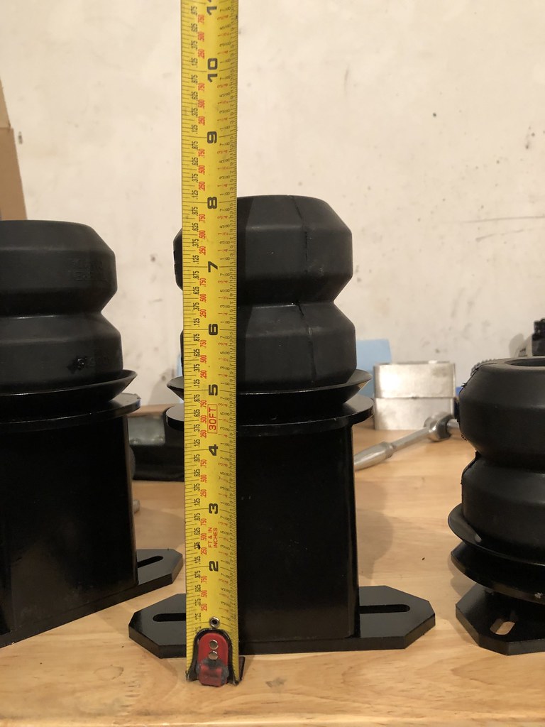

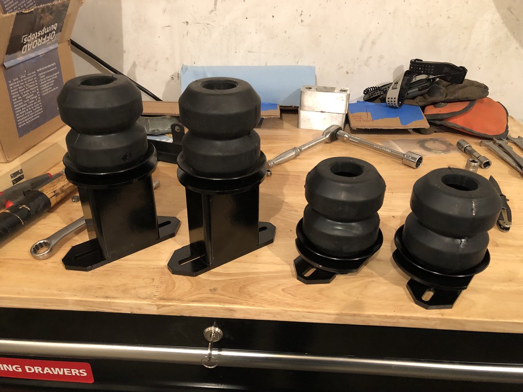

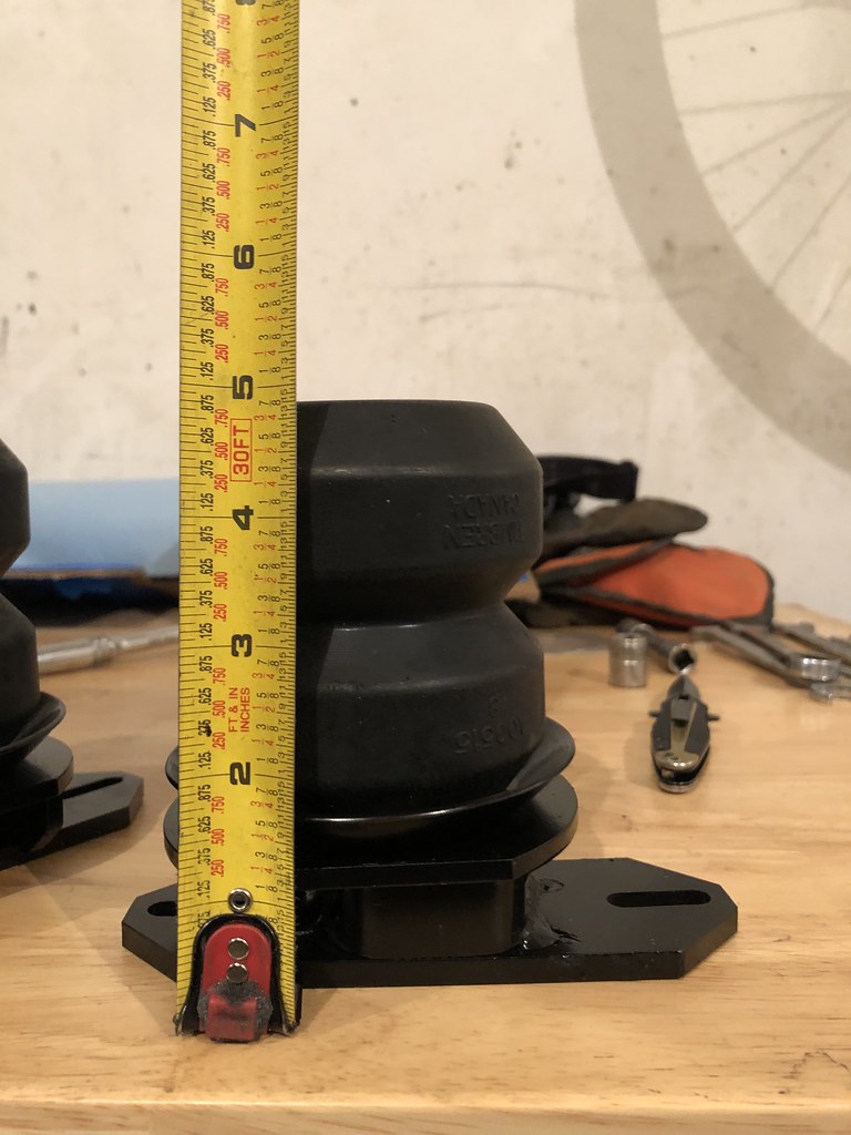

OK last piece of the puzzle regarding bumpstops. I got a full set of bumpstops from Timbren. I've heard good feedback from @woody and others who have Timbrens and since woody also has the Slinky suspension I was particularly interested in his opinion of them. He's a fan, so I got some to address the rear, but was also sent a pair for the front if I want to try them. Here's what I got from Timbren.
Slinky Parts by Adam Tolman, on Flickr
The short ones are the fronts. They would need to have the bracket trimmed a little so that they don't contact the coil during compression. But when compressed they should be the same height as the Slinky bumpstops I just installed so if I decide to use these they should work fairly easily.
Front:
The rears are another story. I don't know how Timbren is designing these for the rear with that massive bracket. Even with a 6" lift these would be too tall. But at least its a simple cut and weld to shorten the brackets. These also would need to be trimmed to not contact the spring and tire in the rear but I can get these set to add the additional 1" to the rear for the 37's. My initial calculations end up with a bracket that's roughly 1.5" tall. I'll post an update when I get them modified and proper fitment is confirmed.
Rear:

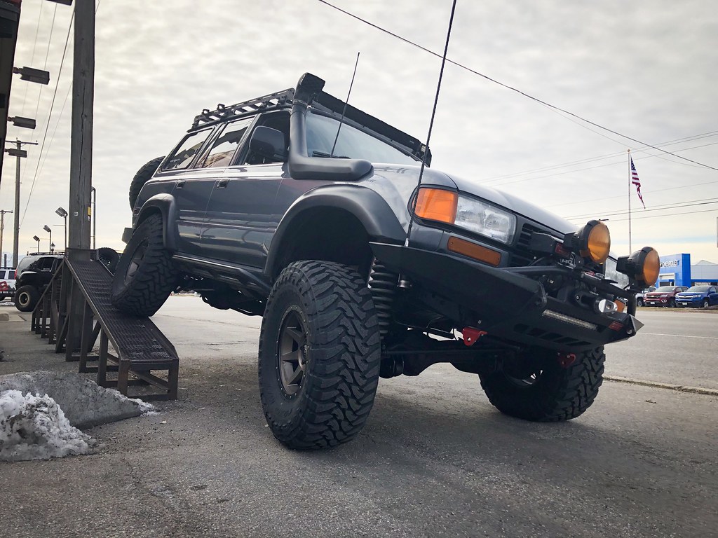

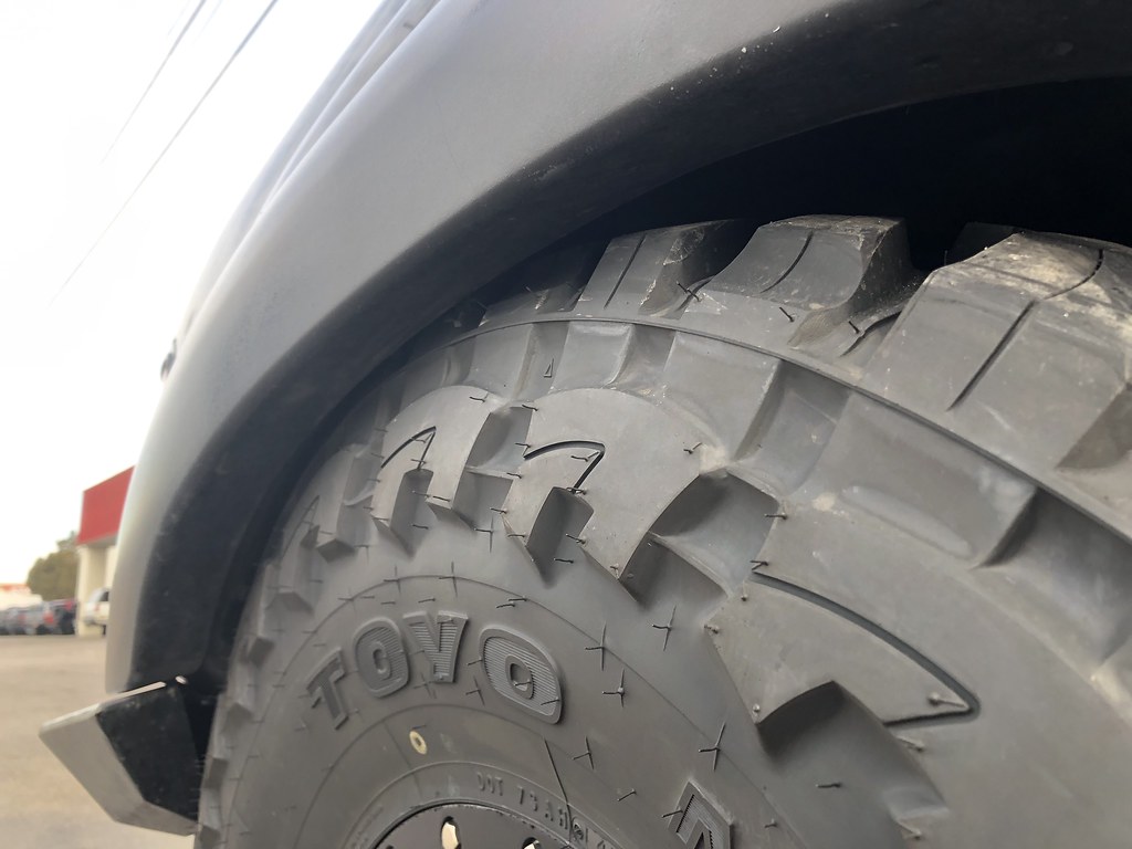

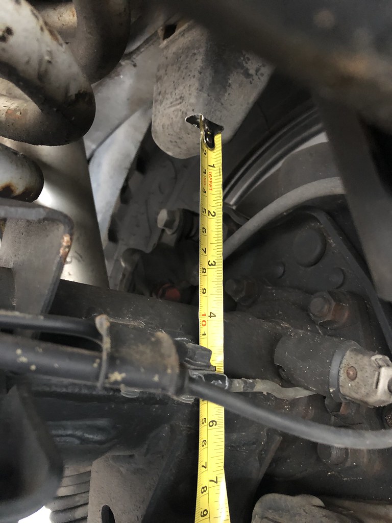

Here's a bit more info as I find my way through the rabbit hole. Used the ramp at a local shop to check for tire clearance and get better bumpstop measurements. First off, the truck will go quite a bit farther up the ramp but I stopped where the tires were making contact so I can see where I may need to do a bit more trimming or spacing of the bumpstops.
The rear tires seem to be stuffing pretty well for the most part. As a reminder I have longer lower links (11mm) and 1.5" wheel spacers installed. The rear axle is centered well at ride height but because of longer lower links the tire moves to the rear as the suspension compresses. Even with the spacers it looks like it's going to tuck inside the wheel arch. I will still trim a bit of the flare, especially at the rear of the wheel arch. I think I will also trim a bit of the fender lip at the top of the wheel arch and some of the flare.

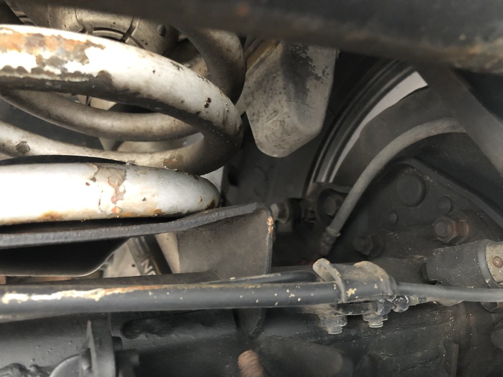

As mentioned the suspension will still compress farther in the rear, but at this point on the ramp (front tires were rubbing) there was ~4" of space between the frame bumpstop and the rear axle. My best guess at this point until I can trim up the front a bit is that a 5.5" rear bumpstop should be about right. We'll see how close my guess is at the next test.
Bumpstop measurements by Adam Tolman, on Flickr
The front is a little different story. The axle relocation mod looks to be very effective in improving tire clearance at the firewall. As the suspension compresses the arc of the radius arm pushes the tire forward for even better clearance when stuffed. However, it also causes some contact at the front of the wheel arch. I'm going to need to trim the bumper wings a little and do a little surgical hammer work to the inner fender in the front. The inside edge of the flare will get trimmed some, but I don't see anything too extreme to get this all sorted. Again, still lots of travel available in the suspension once I get the proper tire clearance.
Bumpstops by Adam Tolman, on Flickr
