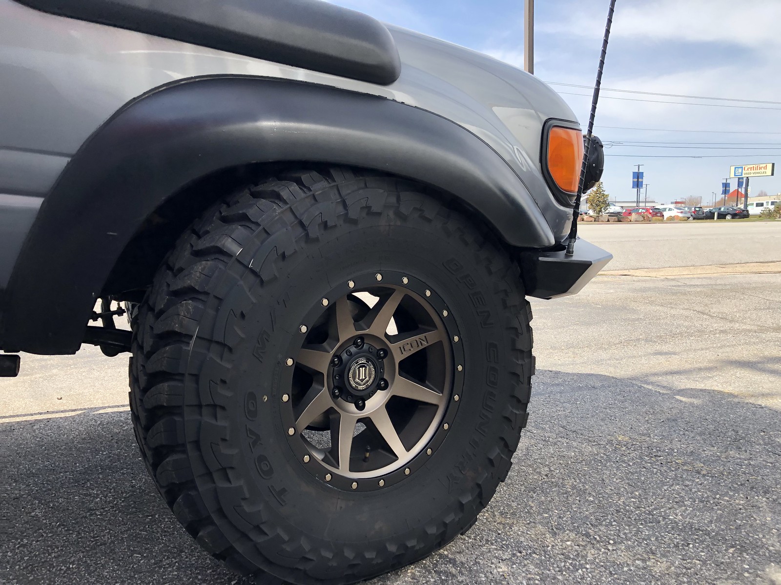

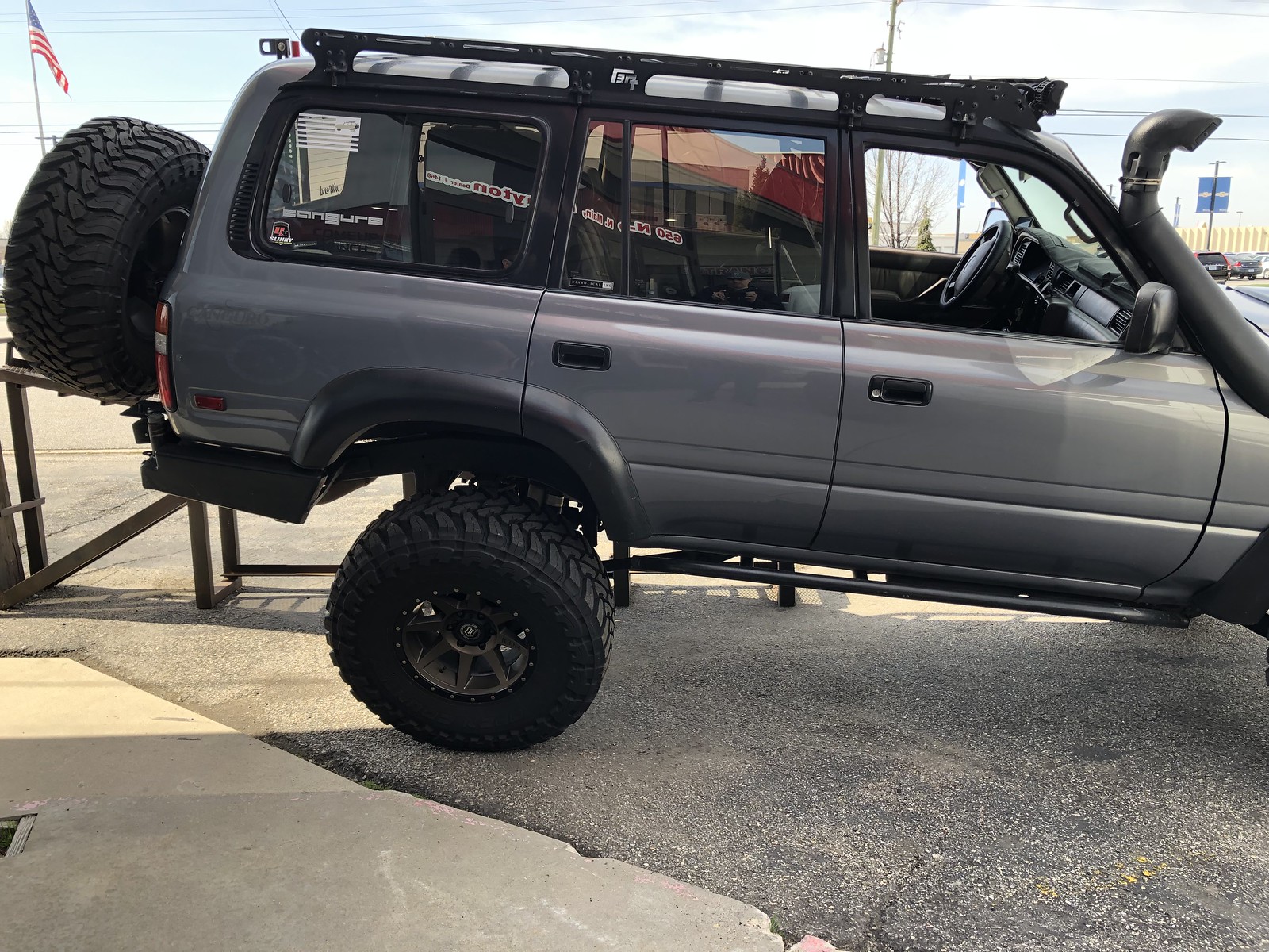

Hay Adam Looking good, It appears that your !3.50 tuck nicely. The tread portion of the tire looks to be a bet narrower the the rest of the tire helping it tuck in.
PS When I first put 37s on my Reg they looked so Big. Now when I see them They look all most stock. Your truck looks really good with those 37s

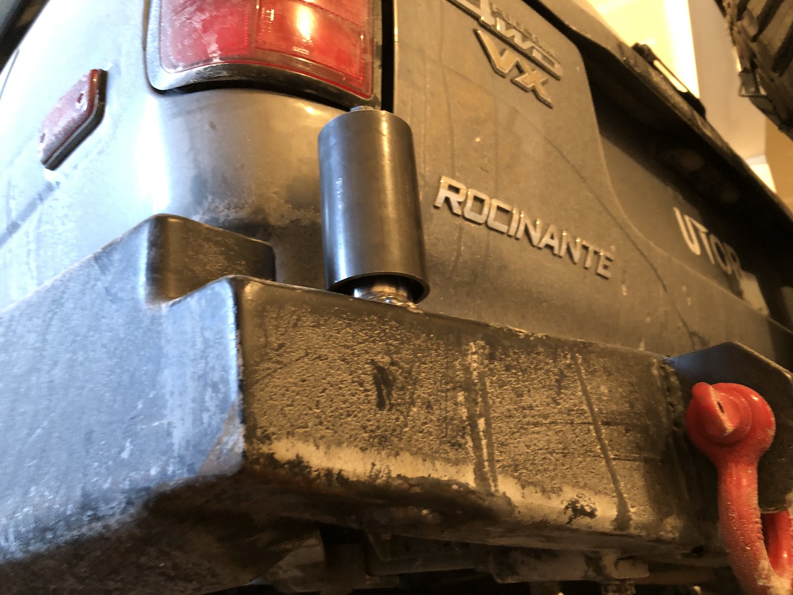

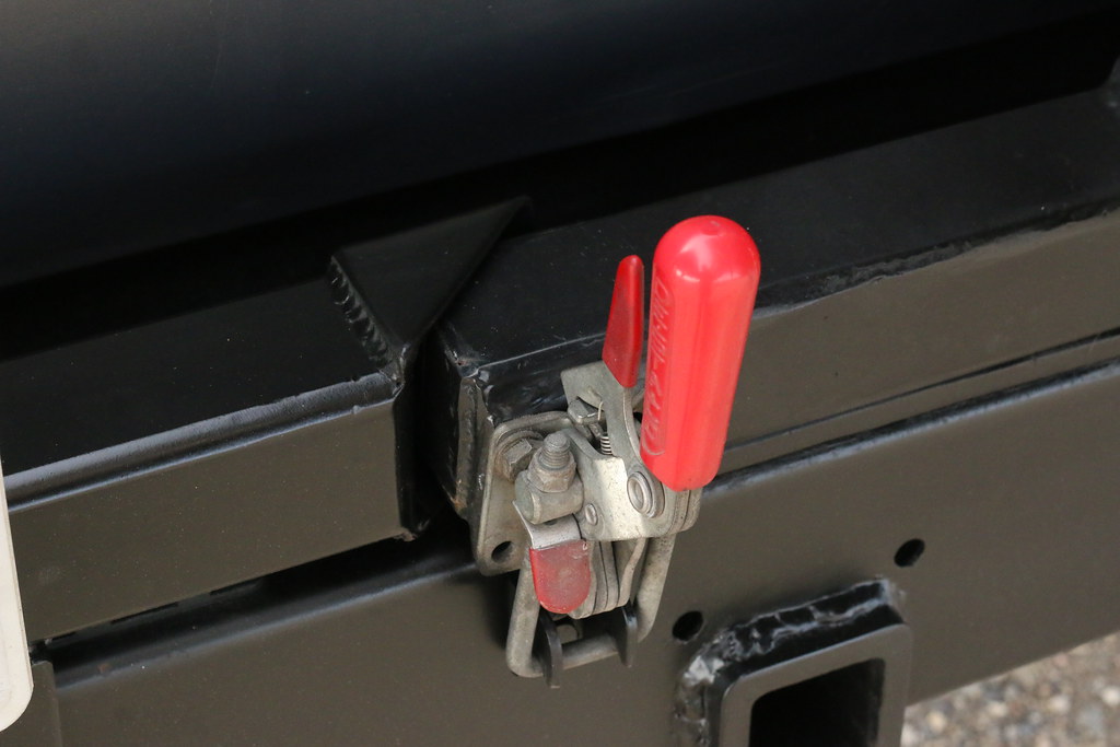

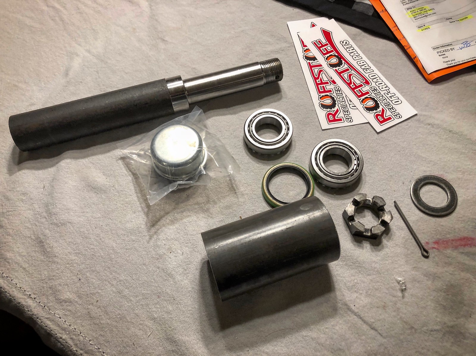

Made a bit of progress on my second swingout for my rear bumper. Using a Ruffstuff hinge kit. Spindle is in place and passes through the entire bumper, welded to the top and bottom. Main arm is done with a small bend to batch profile of the bumper. Simple pocket on the end of the new arm to fit the old arm so I don't need to add another latch. Should finish it up tomorrow.

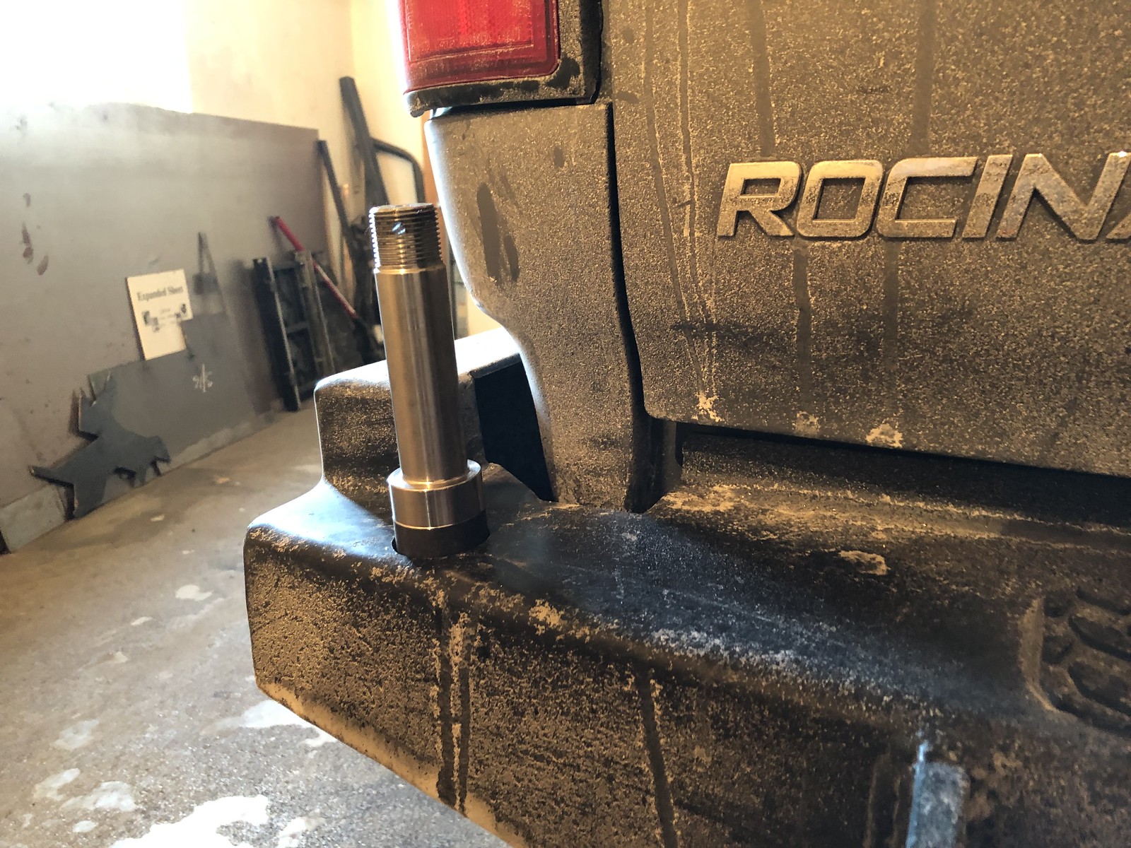

Not a great pic but you can kinda see the the spindle just through the bottom of the bumper.

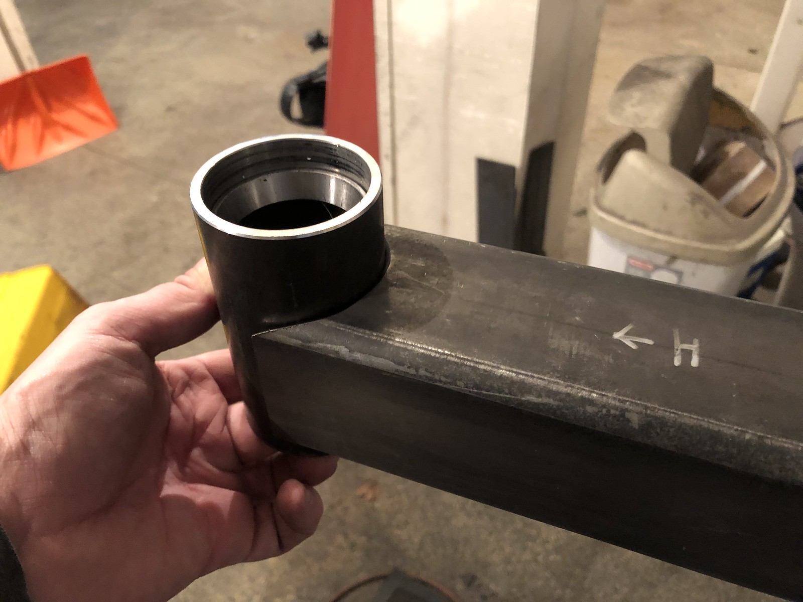

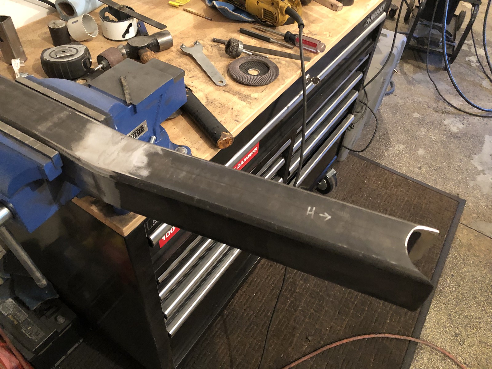

2.5" square 1/4" wall for main arm. Didn't get a pic of doing the bend, but it was just a cut through 3 sides and weld it up.

"Stop" welded to the bottom of the arm to match the other arm and a pocket on the end.
Glad to know it’s not just me. Thought my eyes were deceiving me. 40’s are barking at me and a 3 link wiggles it’s way into my thoughts more and more often. Need to stay focused!

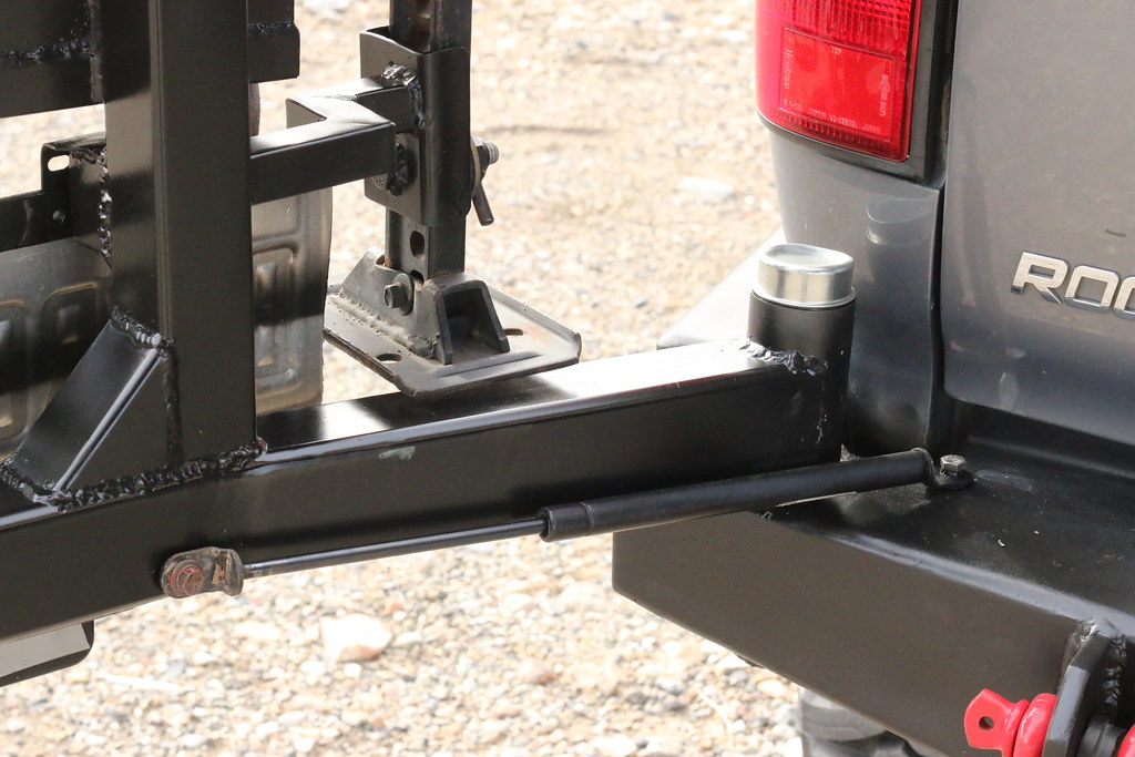

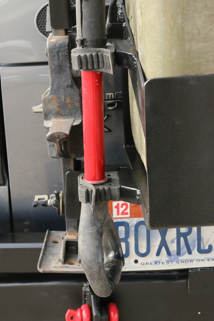

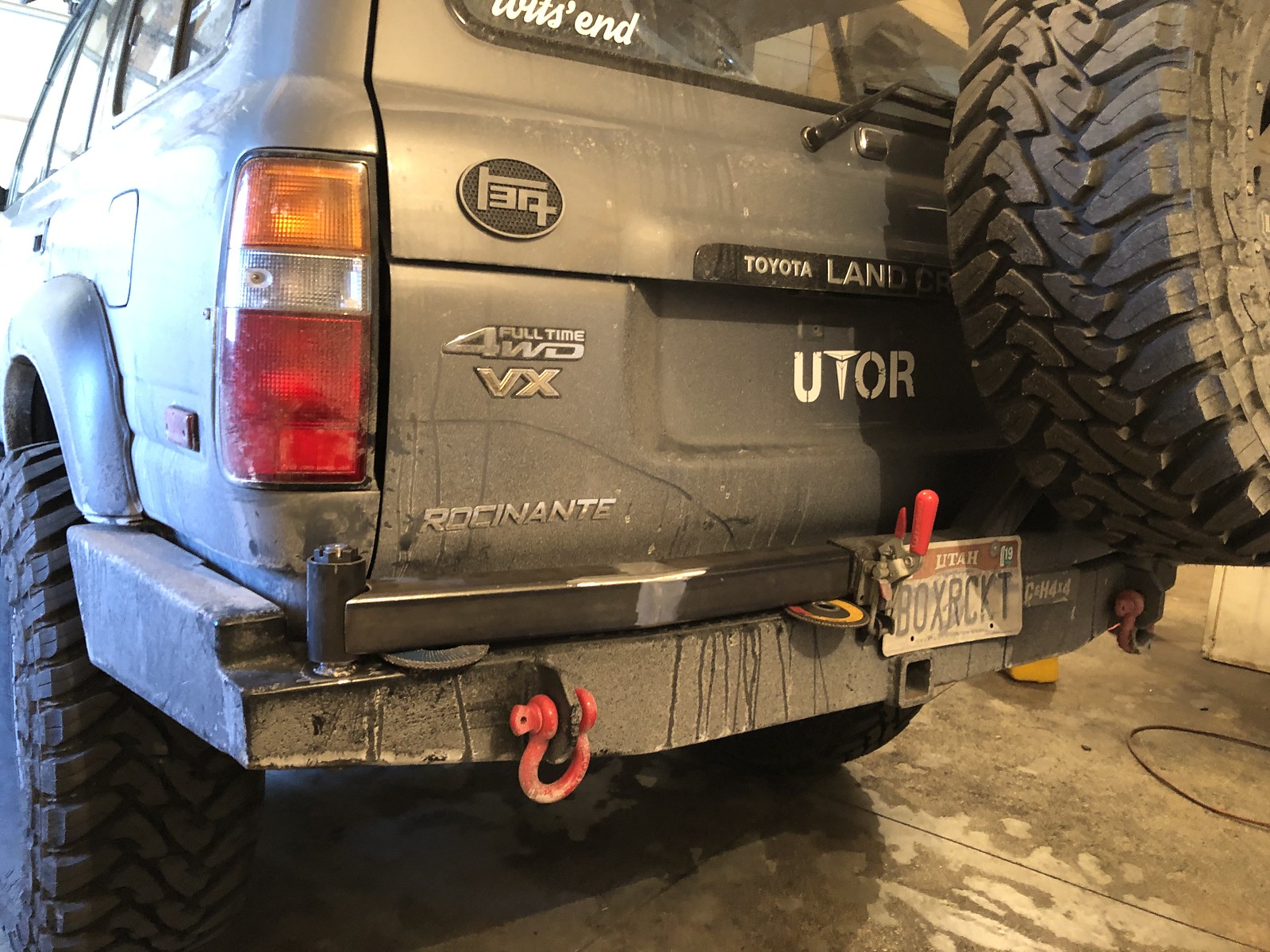

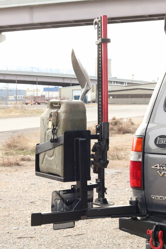

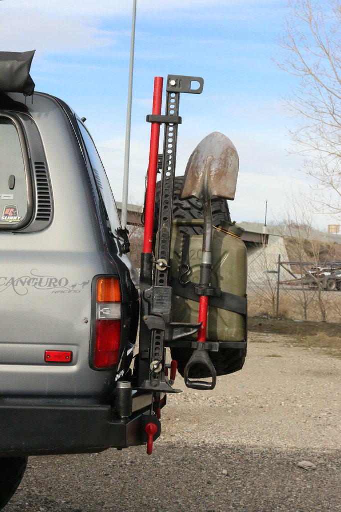

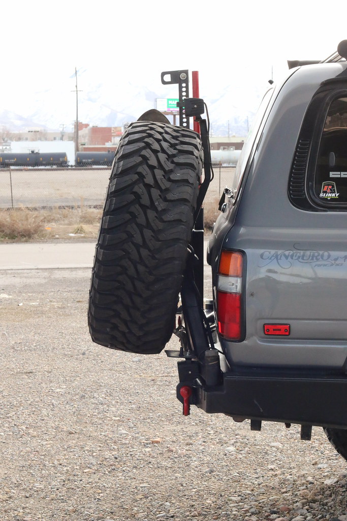

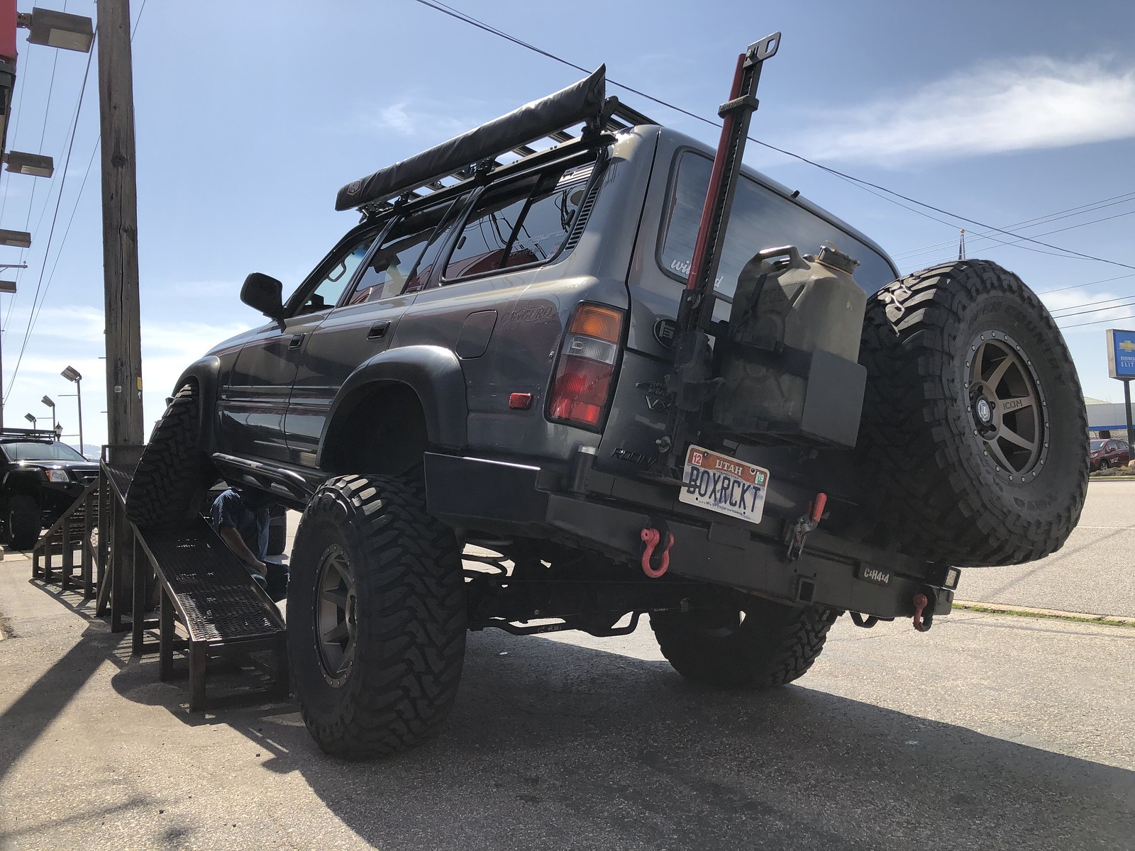

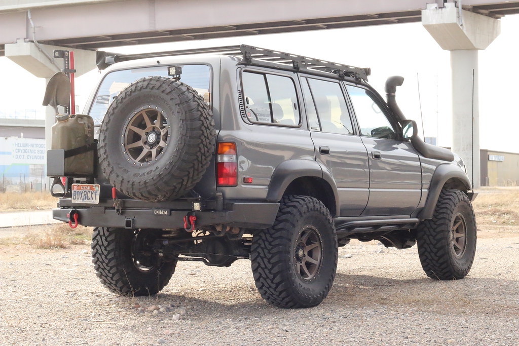

Finished up the new bumper swingout over the weekend. Pretty simple setup overall to tide me over until I get a Delta bumper. Single fuel can basket (with room for a second if needed), hilift, shovel.
I replaced the gas struts on my lift gate a few weeks ago and the old ones still work well enough that I re-purposed them for the swingouts.

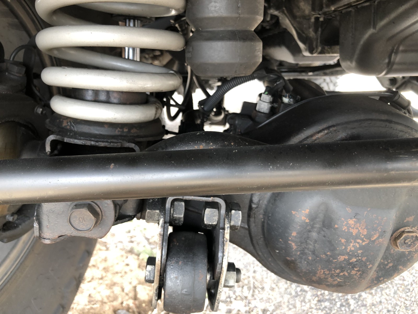

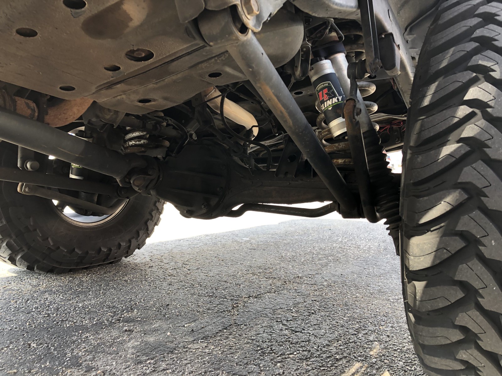

There is interference with the Axle bolt and nut with the Slinky coil. One solution is to lift the frame of the truck to open up the suspension and slide the bolt in from the front with the nut on the back side. If you needed to remove it you would need to open up the suspension the same way to get it out. I chose to machine about 1/2" off the end of the bolt and about 1/8" off the nut (it's like a 1" deep nut) and put the bolt in from the back with the nut on the forward side so that it would clear the springs and I wouldn't need to open up the suspension to remove it.
Nice job on the bracket. When I did mine, I installed the bolt with the head facing forward so it would never interfere with spring movement.

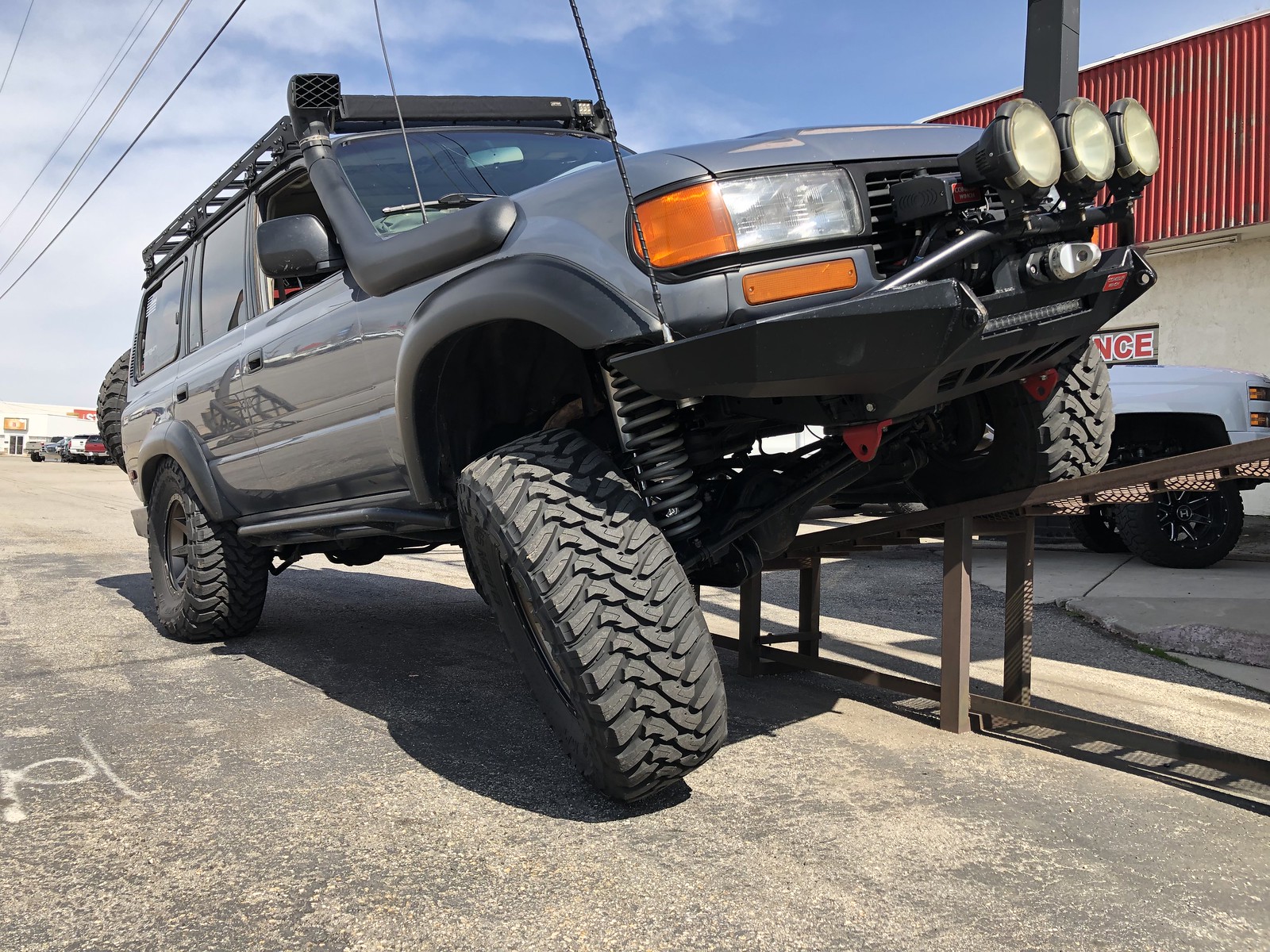

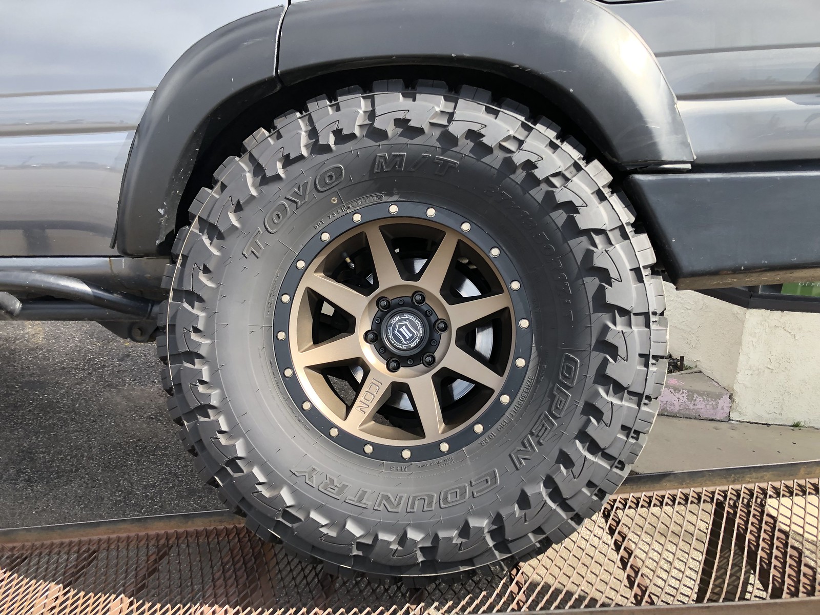

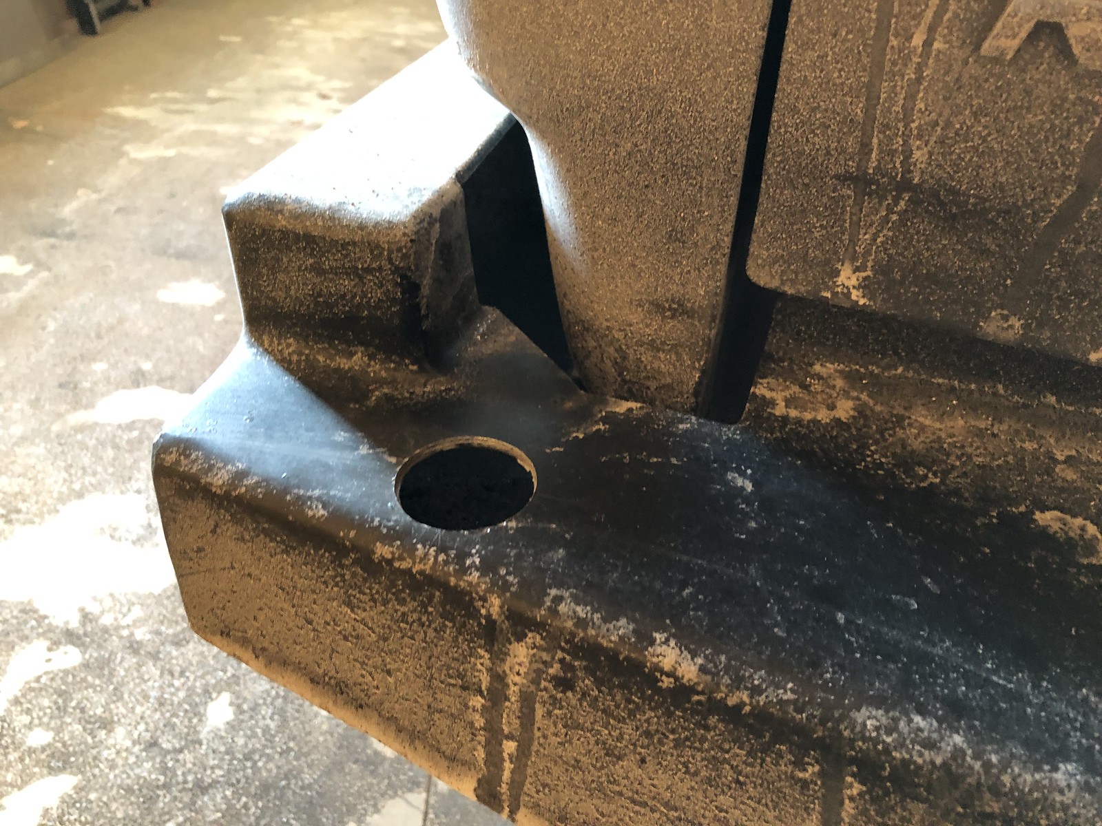

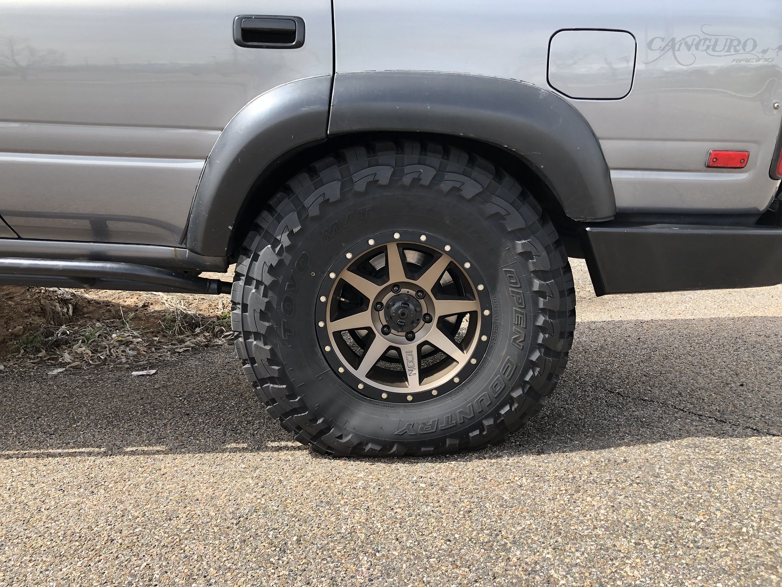

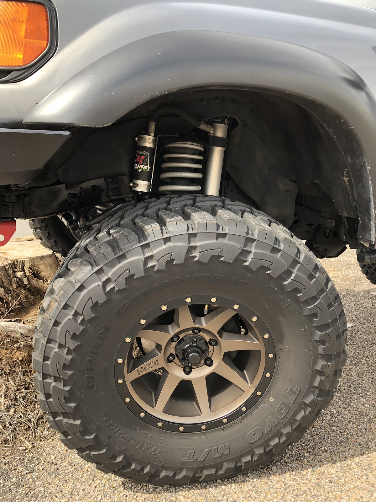

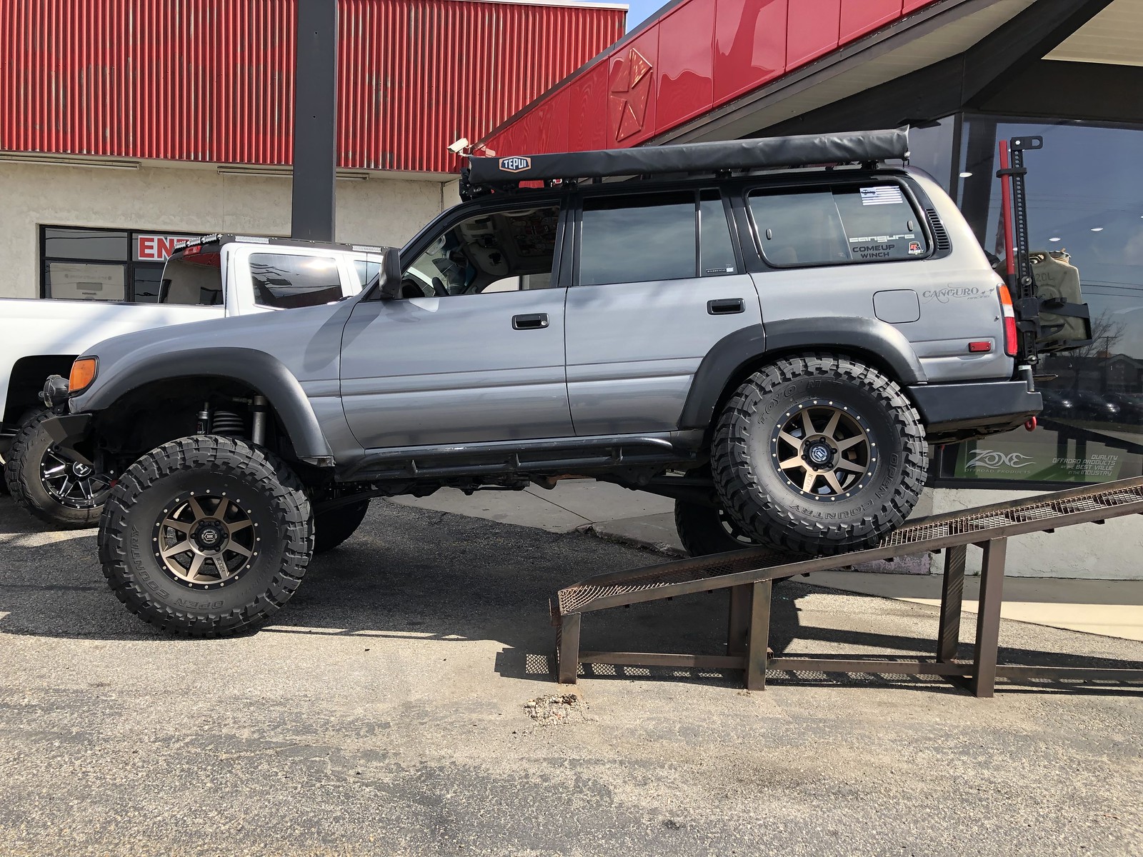

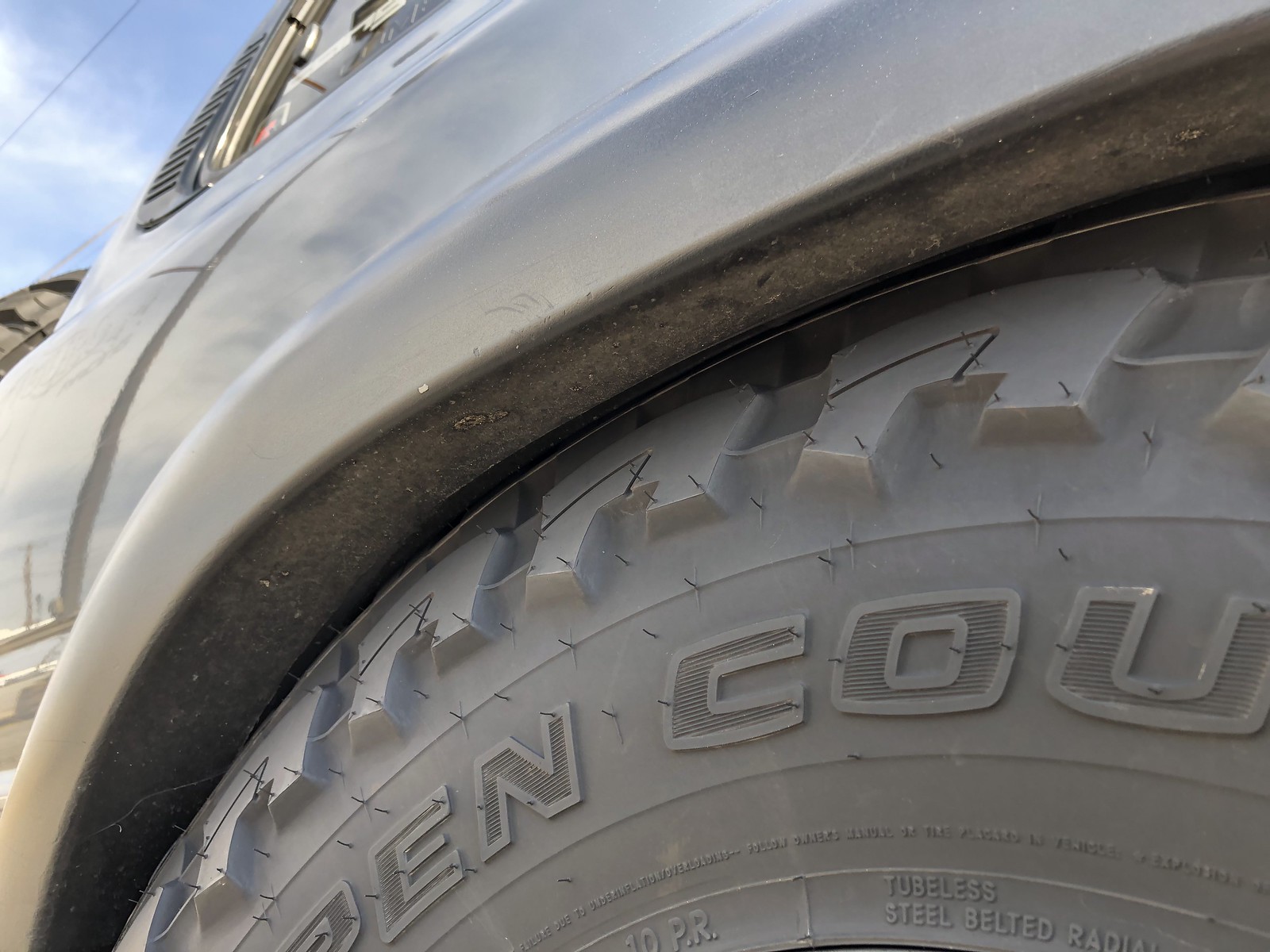

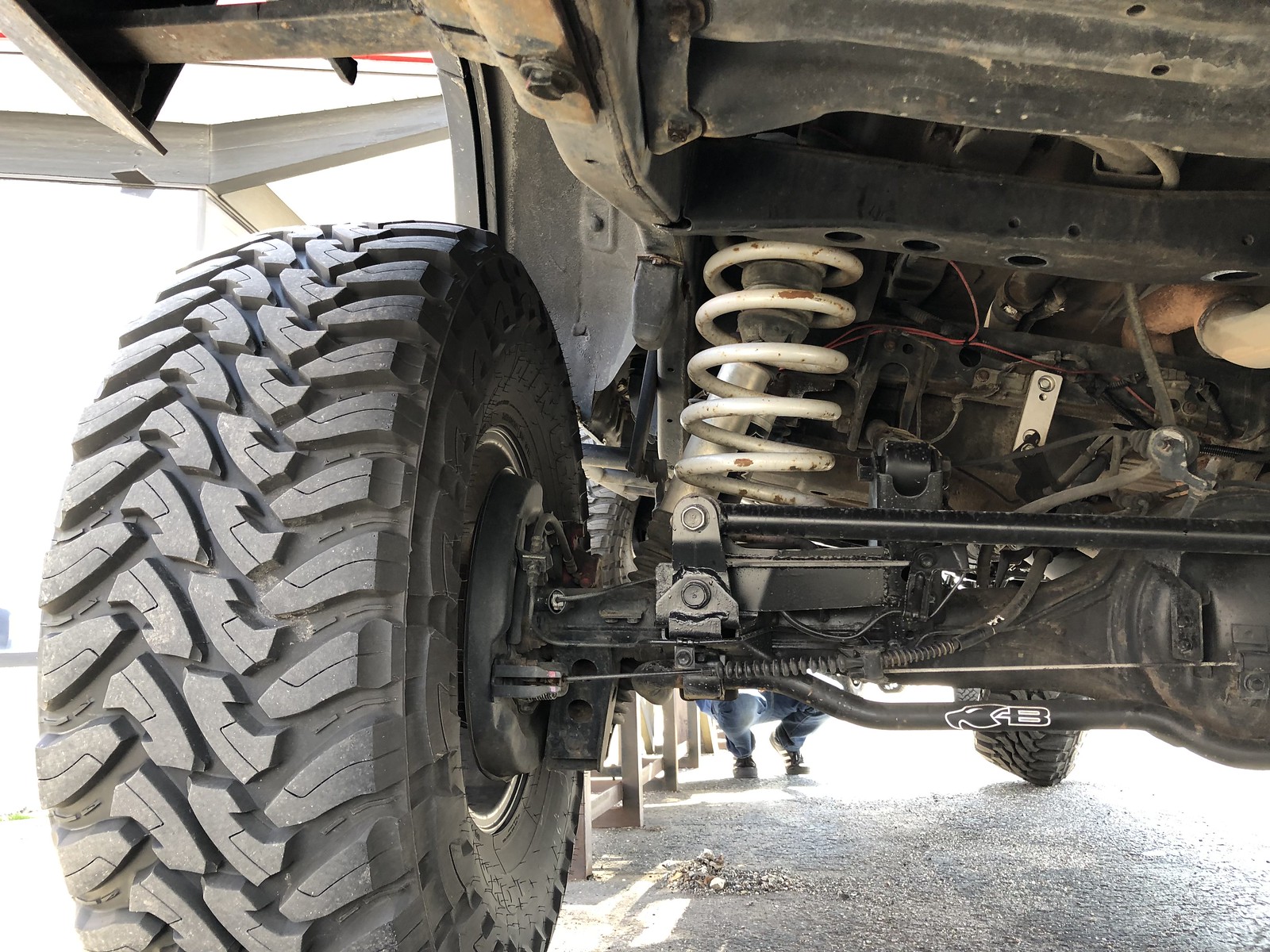

Project 3" lift and 37's continues and I think I've just about got it dialed. Tire specs are 37x13.50R17 Toyo MTs. Wheels are 17x8.5 Icons. 1.5" Spidertrax spacers. I had made some changes earlier to help the front. Moved the axle forward 1.25", cut 2" off the front bumper wings because stuffed tire was hitting at full steering lock. Cut some out of the front inner fender as well in the front area. Front Bumpstop is currently a Timbren spec'd for the 80 mounted to the factory frame location.
In the rear the tires were contacting the rear bumper wings and lip of the fender, but not badly. With the lift I have 5.5" of clearance from the top of the tire to the edge of the fender lip. Here's a few pics from yesterday checking clearances again before attacking the rear. Stock front swaybar and rear Blackhawk HD swaybar both attached.

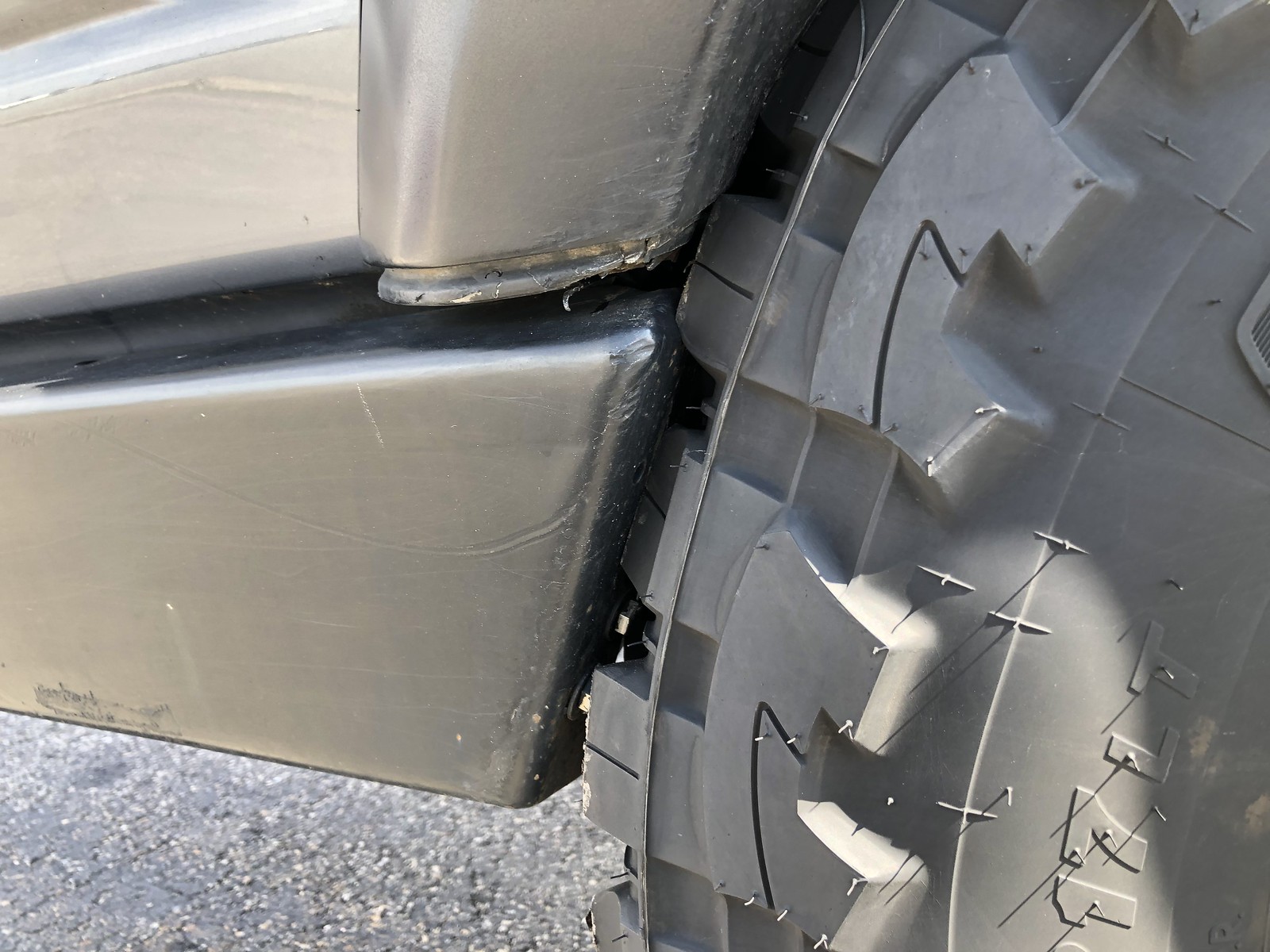

Few more the other direction on the ramp. Had more travel available but was still making some contact in the front, so I stopped on the ramp.

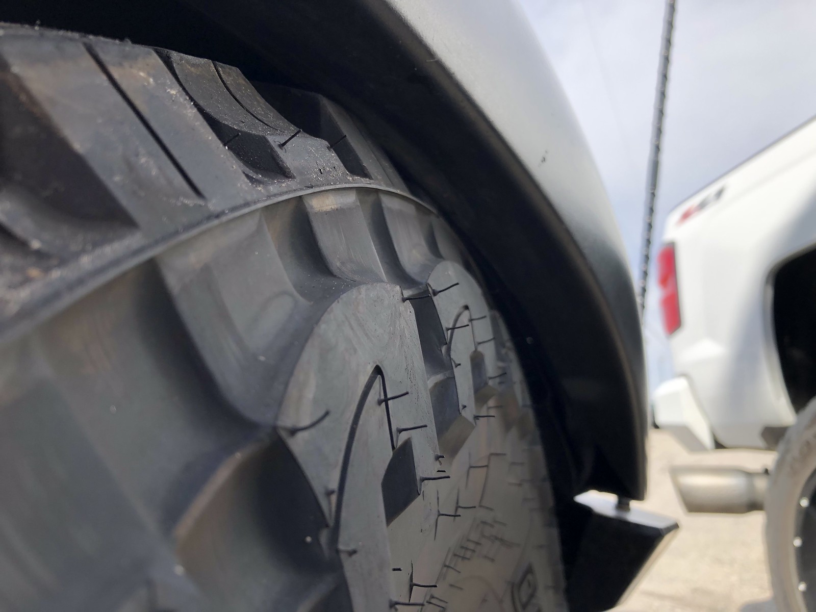

just catching the lip of the front inner fender.
37’s and bumpstops by Adam Tolman, on Flickr

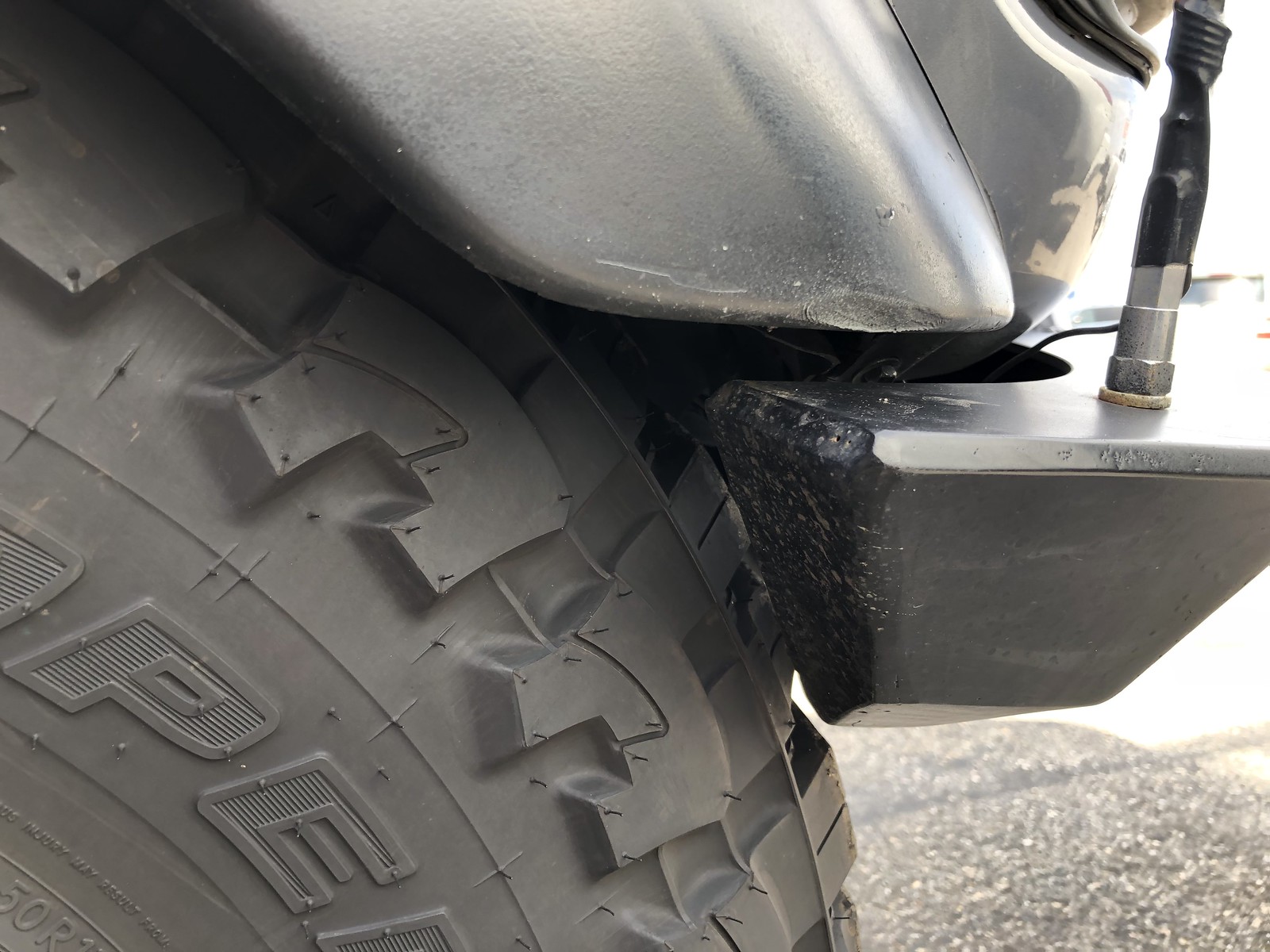

...and, even after taking 2" off the bumper wing, the tire just clips the bottom corner when stuffed/turned. Probably take just a bit more off there.

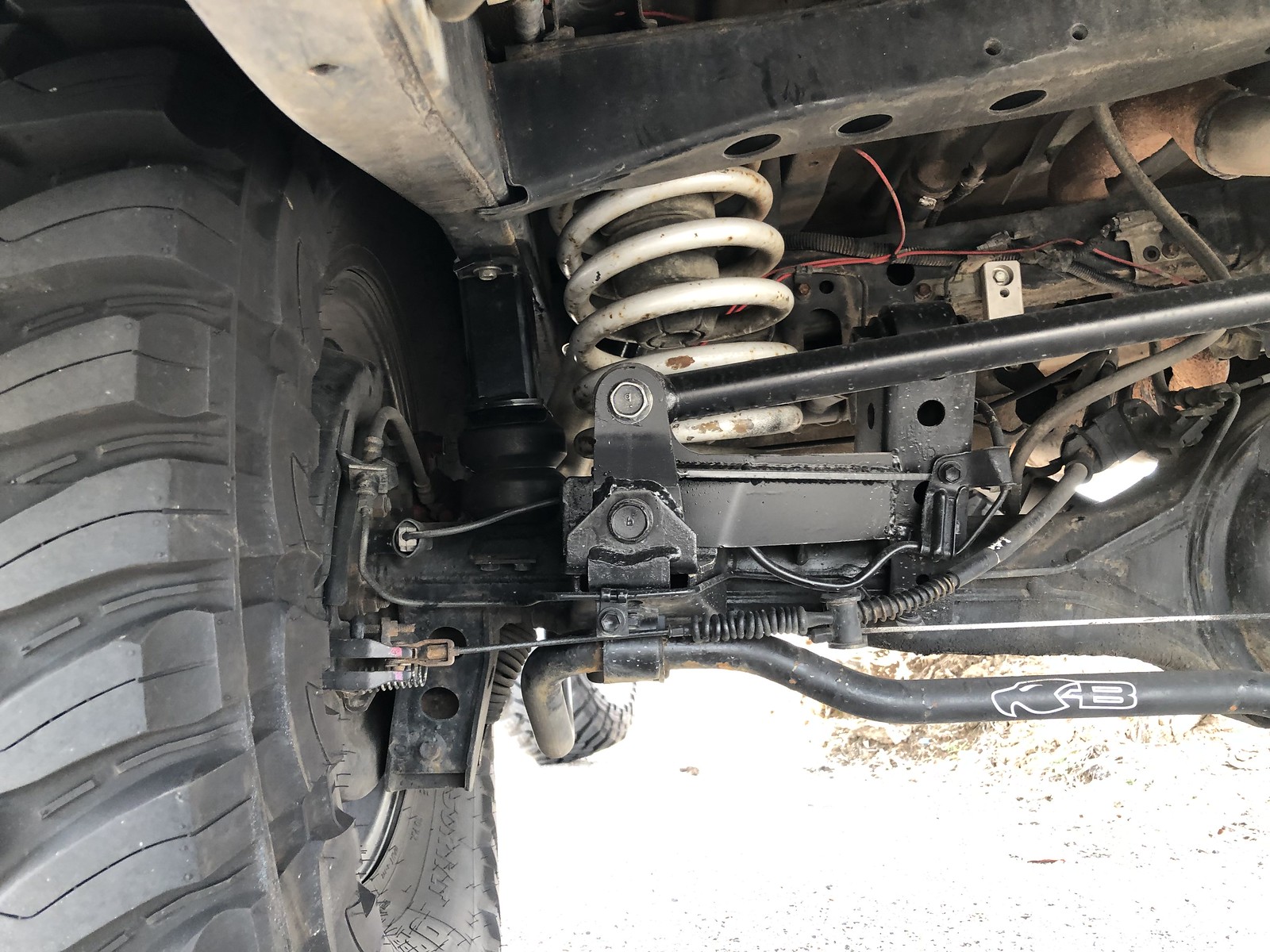

I can add a little to the front bumpstop and it would probably take care of the front issue. I'm not hitting the Timbren yet.

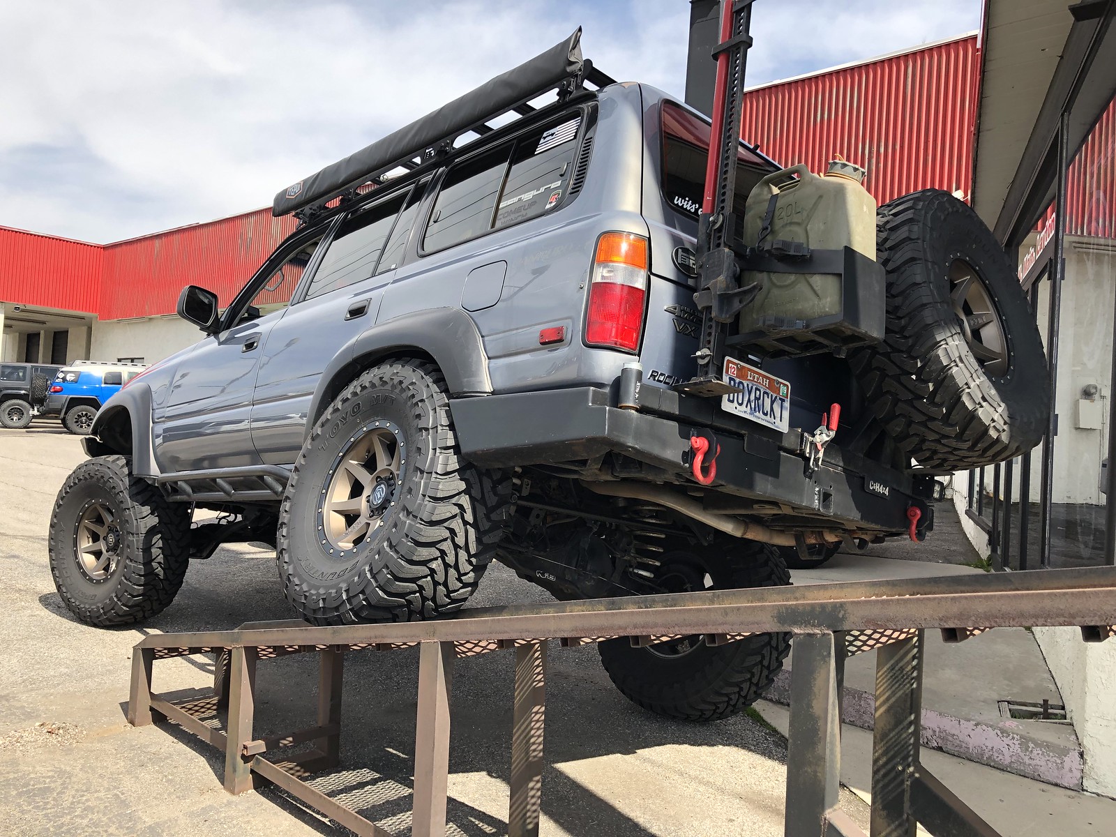

Rear at full twist

Great pictures, i have also installed the front Timbren bumps and the axle is about an inch from hitting the Timbren. The tires were not hitting the front bumper as i did not extend my LCA. My front wheel is free from any sheet metal and no contact on fender lips so far.

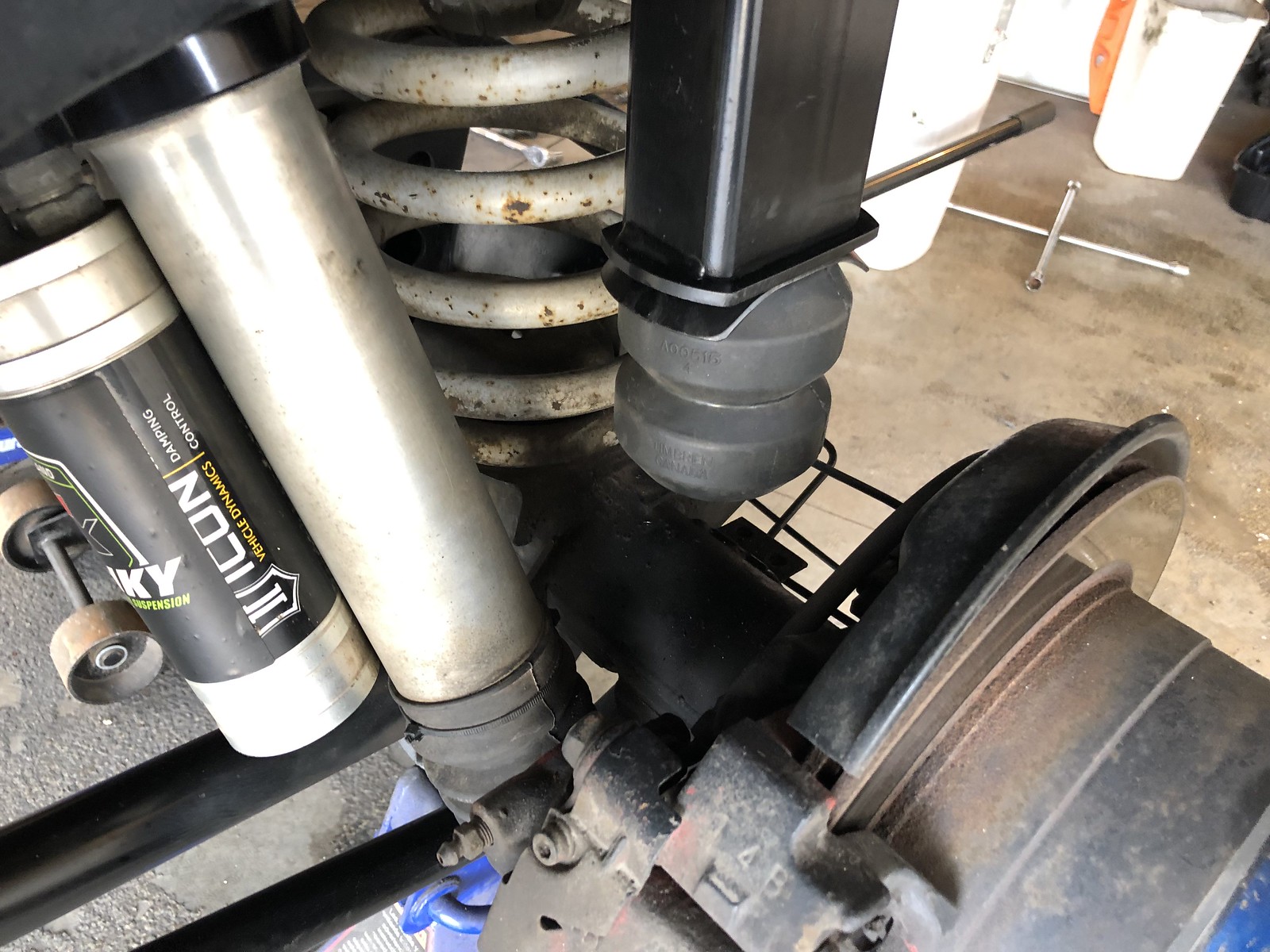

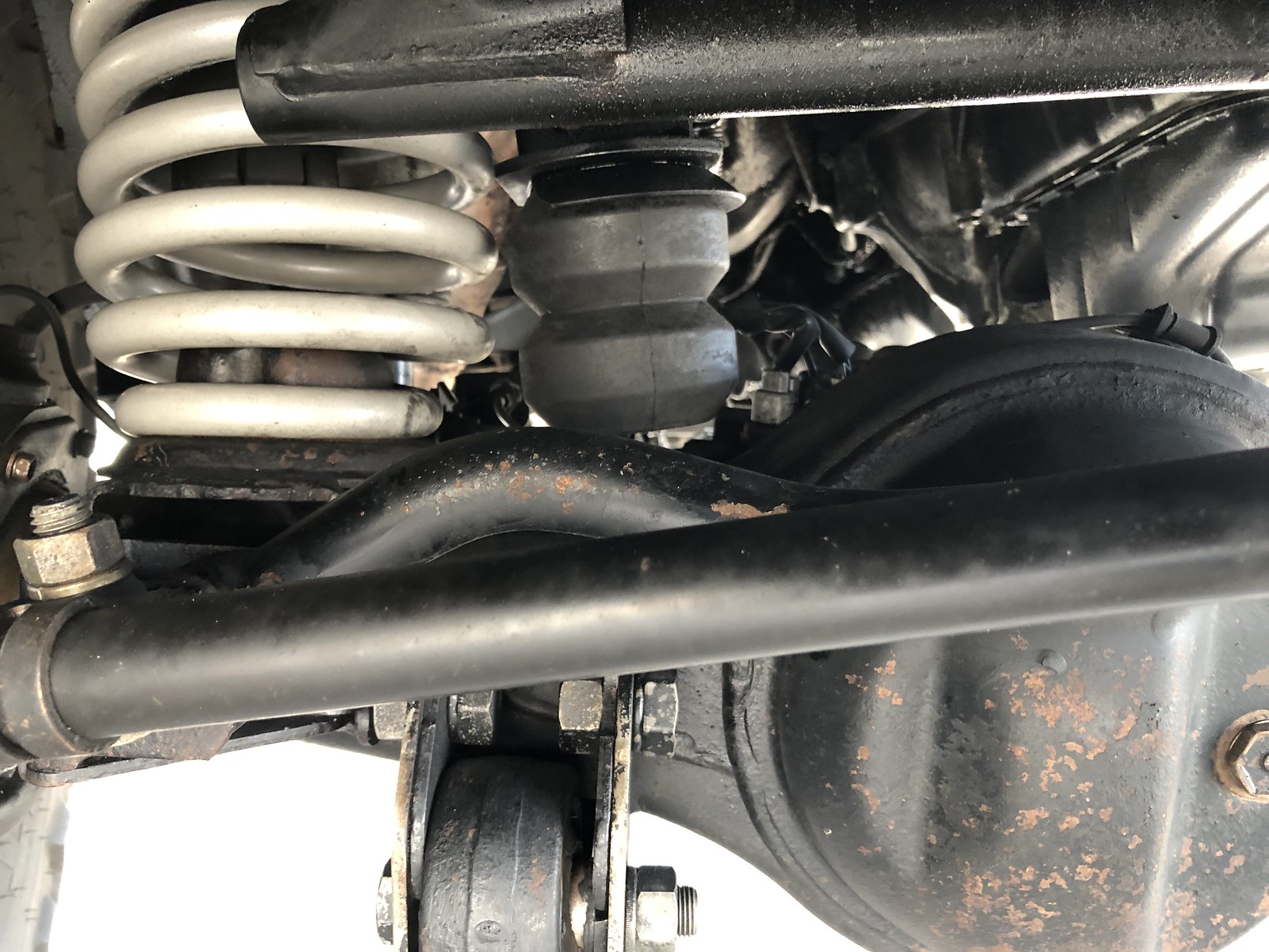

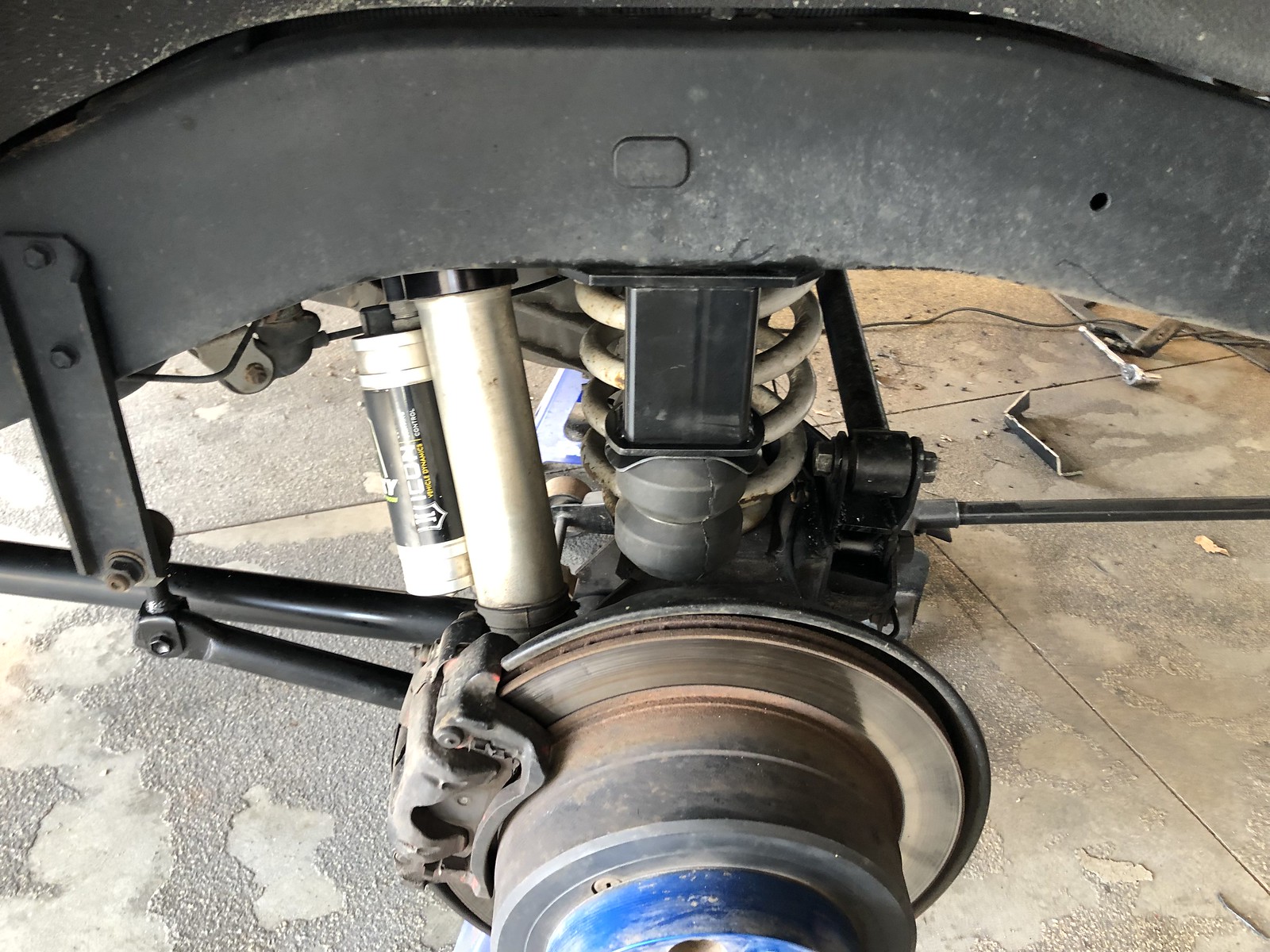

So I have ~5.5" of shock shaft showing at ride height, about the same amount of clearance from the top of the tire to the fender, so the plan was to setup the rear Timbrens to bottom out at about that same point. The Timbren bumpstop that they sent me looked huge and appeared way taller than needed. But in reality the foam rubber bump I've been running is about the same height as the tower for the Timbren and I knew I needed at least an inch taller for the 37's The rubber portion of the Timbren looks really tall too but it compresses to almost half its size and providing a nice progressive bump. So the compressed height of the Timbren is ~1.5" taller than the older bumpstop it was replacing.
After installing it, at ride height there is 5.25" of clearance between the axle and the point of bottom out on the Timbren. Should be just about perfect to not overcompress the shock and to stop the tire just before making contact with the fender.
But it wasn't without its headaches. What should have been a 5 min swap of the bumpstops turned into a couple hours since all 4 bolts broke off in the frame. Drilled out the broken bolts and retapped the holes and was back in business. Note, I mentioned this in an earlier post about the front Timbrens. The plate and cup between the rubber and the mount needs to be trimmed so it doesn't make contact with the springs.

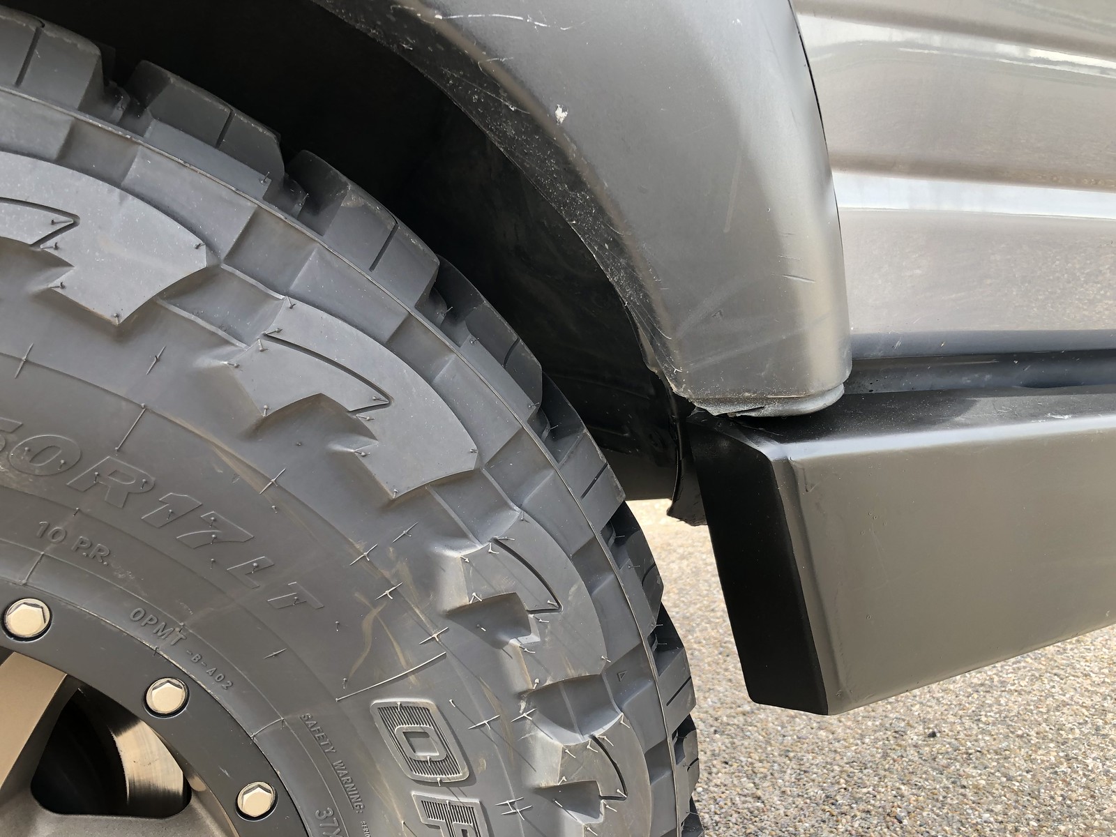

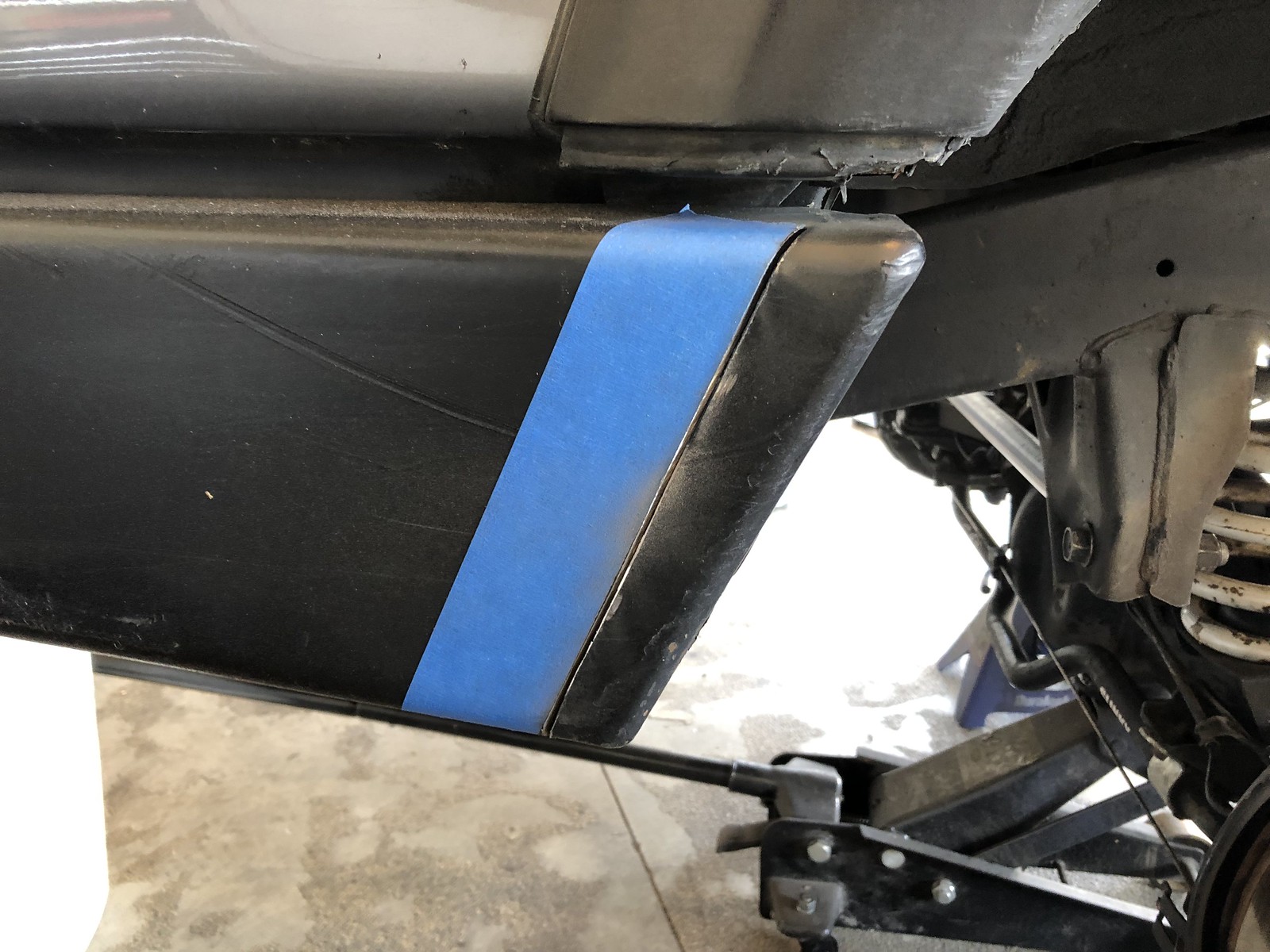

Took just over an inch off the rear bumper wings and flattened the inner fender lip in the rear with a hammer.
No more clearance issues in the rear.

Front is looking pretty good too.
I might add a bit more height to the Timbren in the front since there is ~2.5" of room between it and the axle in the above photos with a bit more travel available.
