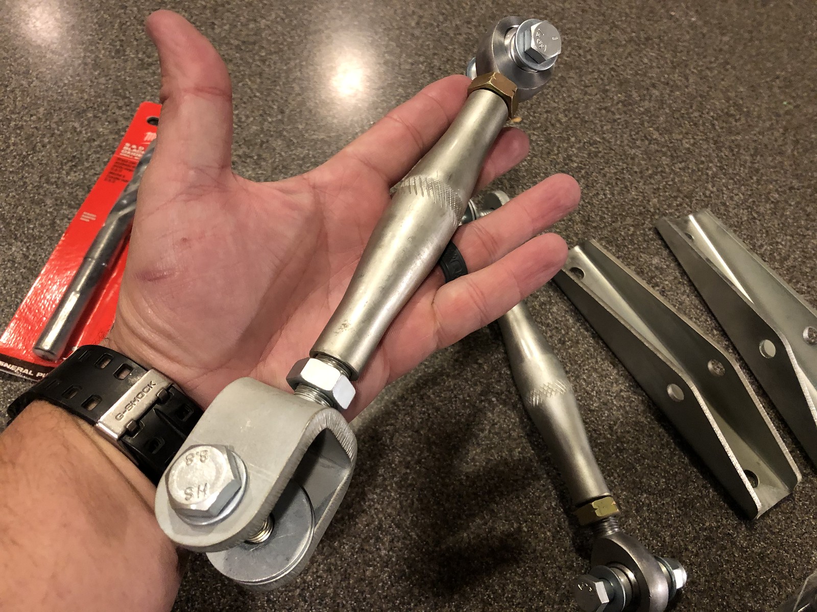

Was able to sneak away from family holiday commitments for a bit a couple days ago and finally got my LCP heavy duty rear swaybar links installed. To Phil's chagrin, I painted over the clear zinc coating. I'm sure the paint wasn't necessary but I wanted to make them a bit less "flashy" with bit of black paint. Seriously impressed with the "Beef" of these things. Should be substantially stronger than stock ones (which I've broken twice because of the HD Blackhawk swaybar).
My 80's stock link brackets were the strap bolted to the side of the frame rather than the bracket that bolts to the bottom of the frame. The holes are there on the bottom of the frame but mine only had holes, no captured nuts or threaded holes. So I ordered the new links with the Nutsert kit that Phil offers. Phil includes all new hardware and an ingenious way of setting the nutserts. A long "nut" gets used as a spacer with a longer bolt that squishes the nutsert in place as you tighten it. Once it's set, remove the long bolt and use the supplied hardware to attach the bracket. However, I had a bit of an issue. On the first nutsert the supplied long bolt snapped before the nutsert was set. It wasn't too difficult to remove the broken bolt and I had another one on hand that I was able to use to finish it up. Wasn't a huge deal for me and a real nutsert installation tool would be a bit easier but also quite a bit more cost if you had to add the tool.
In any case I chose to run a weld bead along the front and back edges of the bracket just as a second level of security. I can always go back to my other links/brackets if these were ever to break, but I highly doubt these will be breaking anytime soon.
The Blackhawk swaybar was pretty chipped so I hit it with a fresh coat of paint before bolting everything up. Looking forward to putting this through some testing. I already know what to expect in term of performance with the Blackhawk swaybar (which is awesome) but without the worry of snapping the stock links. Here's a few pics.

Phil hit a Grand Slam on those brackets.
