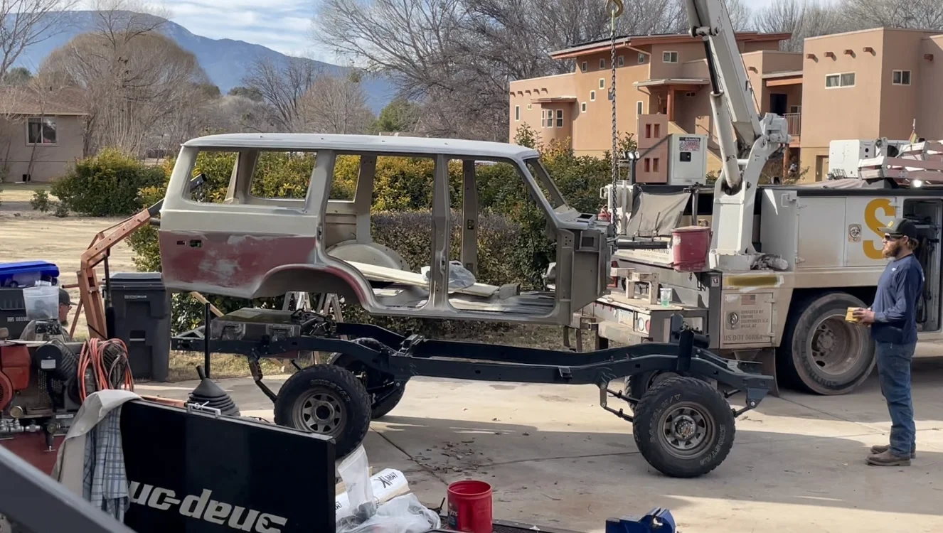

Can someone share what’s best way to do body swap outside of using a 2 post lift?
I’ve been told Gantry lift would work, anyone have experience doing it this way?
Not sure how you would balance it.
I’ve seen it done with a couple floor jacks, stands and 4x4s long enough to reach past the frame. Basically get under the rockers long enough to get a 4x4 under the supports where the front seat mounts rest.
You have to take it slow. Some videos on YouTube.
Or this with an engine hoist inside the cab

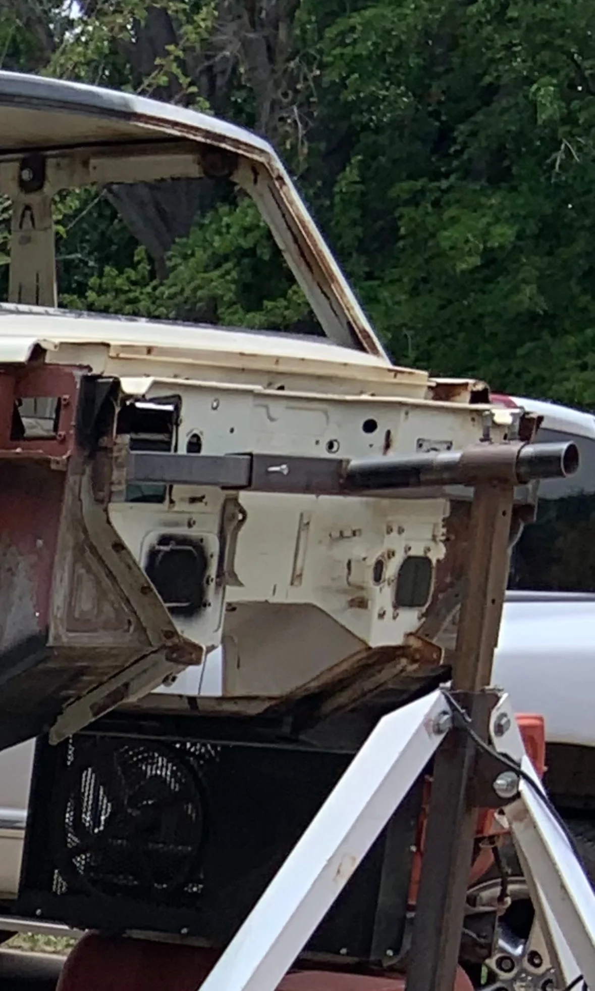

I know of a good way, but it involves some prep work with some welding, and two lift sources (could possibly use one with care if it’s high enough with enough radius to avoid the rolling chassis).
Build a bar to span the tailgate opening attaching to the tailgate latch mounts, then one in the front spanning to the upper flange mounts for the inner fenders. These are your two pick points. Two spaced lifting eyes on each could be included to triangulate your rigging for better stability.
I used a cherry picker on the rear and a truck crane for the front. Super easy and simple.
