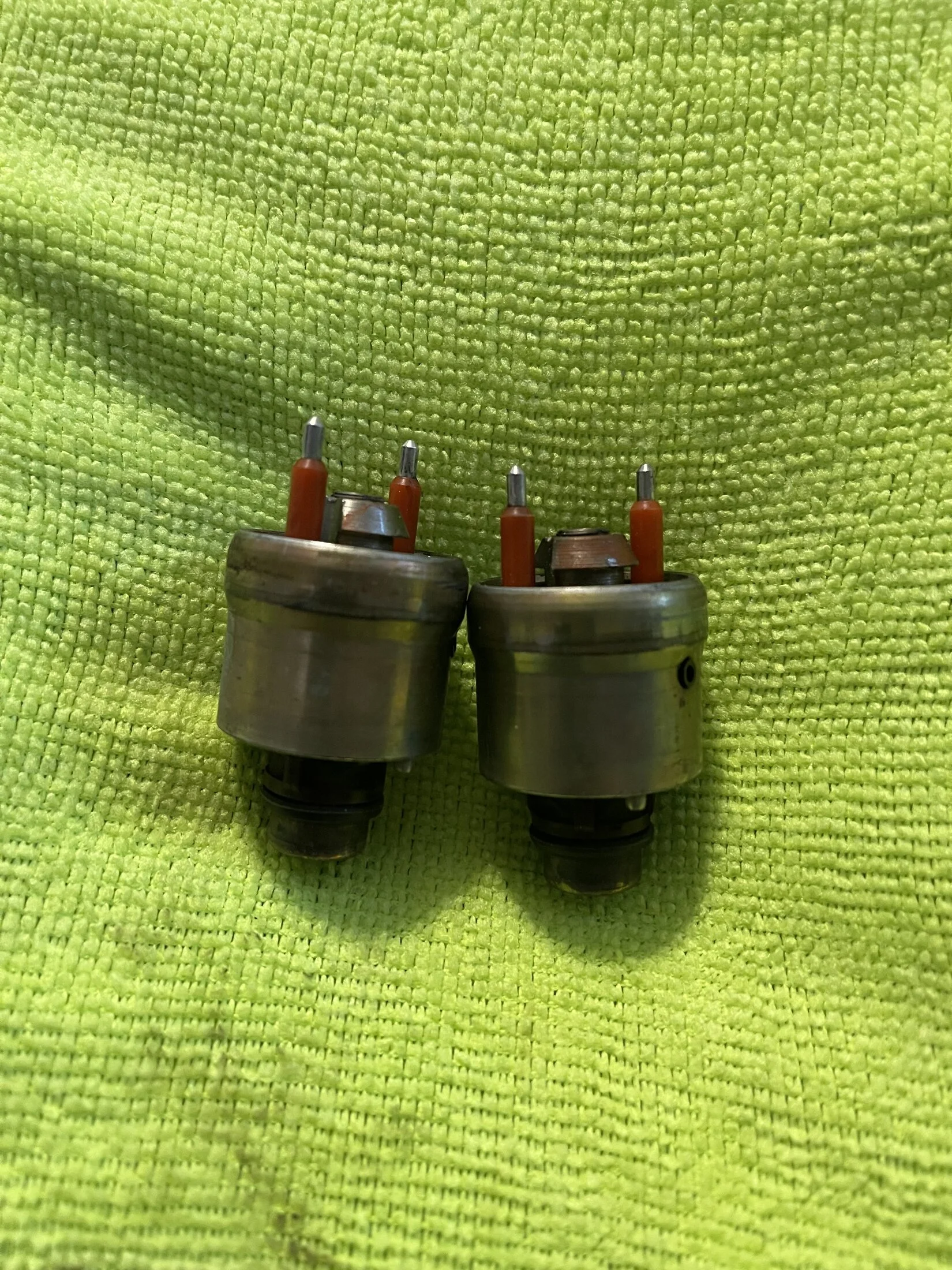

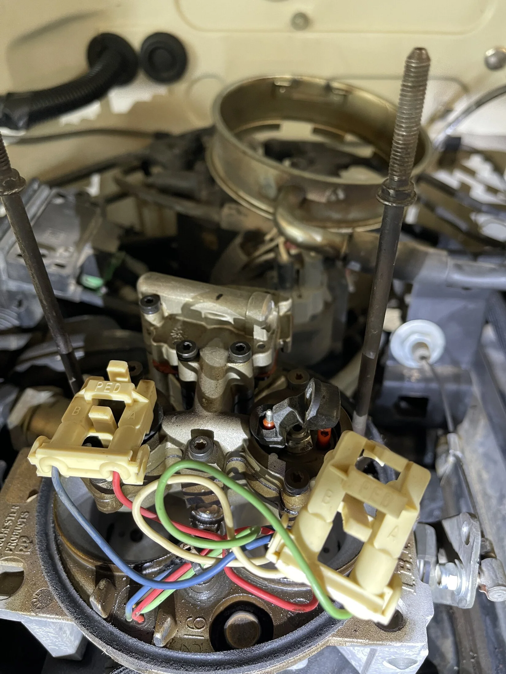

Had planned on pulling injectors and sending off to have cleaned but will likely just buy new ones. New gasket kit in hand to pull injectors. Watched a few videos on this TBI set up and it seems quite easy to work on!

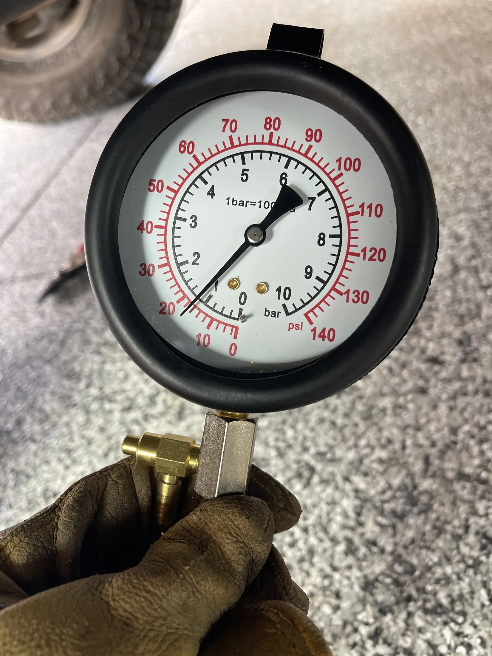

Placed T valve after pump. Started it up and get 16-17psi.
Pulled injectors and I’m off to Oreillys to order couple new ones.

Pump putting out the pressure at idle it’s suppose to.
No longer my monkey so not my circus but…
“FP is VERY sensative in a TBI application. Anything with large injectors firing twice as frequently as they do will be sensative to the pressure changes. Going from 12psi to 14psi is a lot more fuel in a TBI system”
That system is oem from a ‘93 GMC pickup. Fuel pressure spec is 9-13 lbs.

This is the same part number from your old receipts and researching the old TBI forums, it’s far less than what was on it after it had its original hiccups.
Assuming you may have actually been making little more than 13psi and would vary between each pump?
New injectors will be here tomorrow, then sending old ones off to Wichita for good cleaning which will also help confirm whether they were clogged up. They provide print off of before and after their cleaning process which will be interesting to see.
