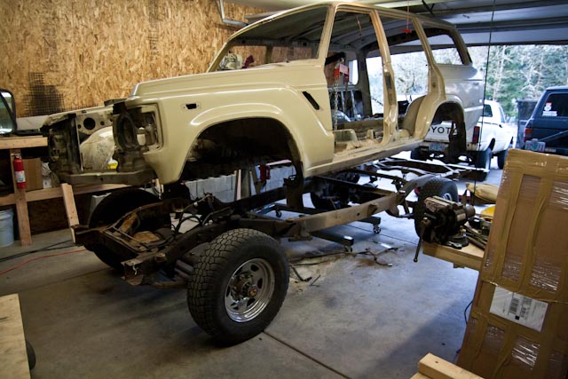

Pretty easy and fun. 2 guys can do it with a engine hoist. If you go the 2 guy or guy and his wife route...
1. Run the mother out of gas.
2. Disconnect hoses and lines in firewall.
3. Remove doors/hatch/Seats
4. disconnect rear heater
5. Removed 8? or 10 Frame bolts.
6. Remove truck with tank attached.
6a. Remove truck with tank detached... make sure your run it out of gas or you will speak "CHOICE WORDS"
7. Grab a chain and connect to the front seat belt bolts. Run another chain from the rear seat belts and connect with a d ring in the middle of the two chains (center of weight). Jack up... pull hoist out and roll chassis.
I'll be taking my cab off soon. My plan is to remove as much weight as possible, I'm going to re-spray my body and deal with some rust so I'm removing all the doors and glass, my whole interior is already removed. I'm going to use an engine hoist with the arm inside the cab, use a couple of chains running down to bolts in the seatbelt locations. Lift the frame up and roll the chassis out from under it. I'm planning to build a "body cart" on caster wheels so I can move the body around my garage. The chassis with motor will go on one side of my garage and the body on the other. I'll then bounce back and forth between body/paint work and chassis/suspension/axle work.

Also remove the fuel tank it's mounted to the body it will help. I've done it Jack's jack stands and 8x8 blocks of wood kick it up hold body up with the stands roll chassis out
