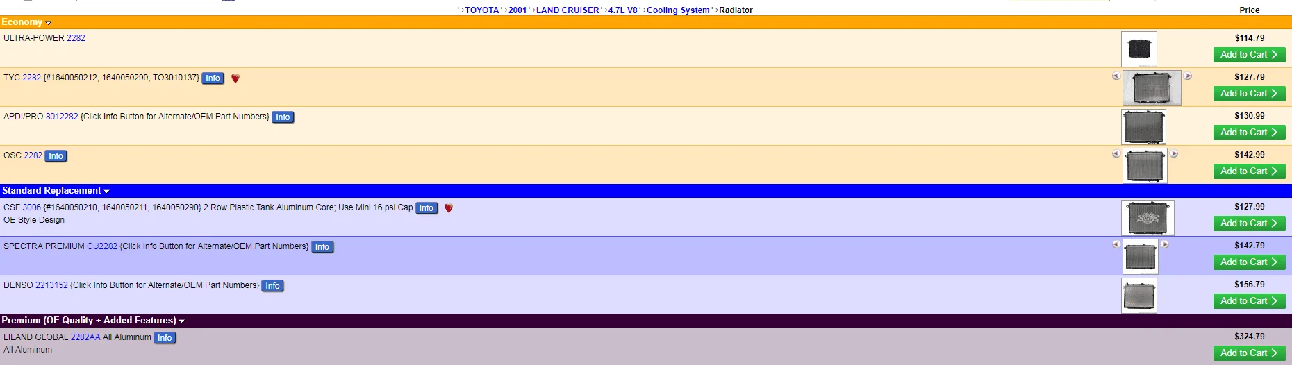

Best replacement radiator for the money today...

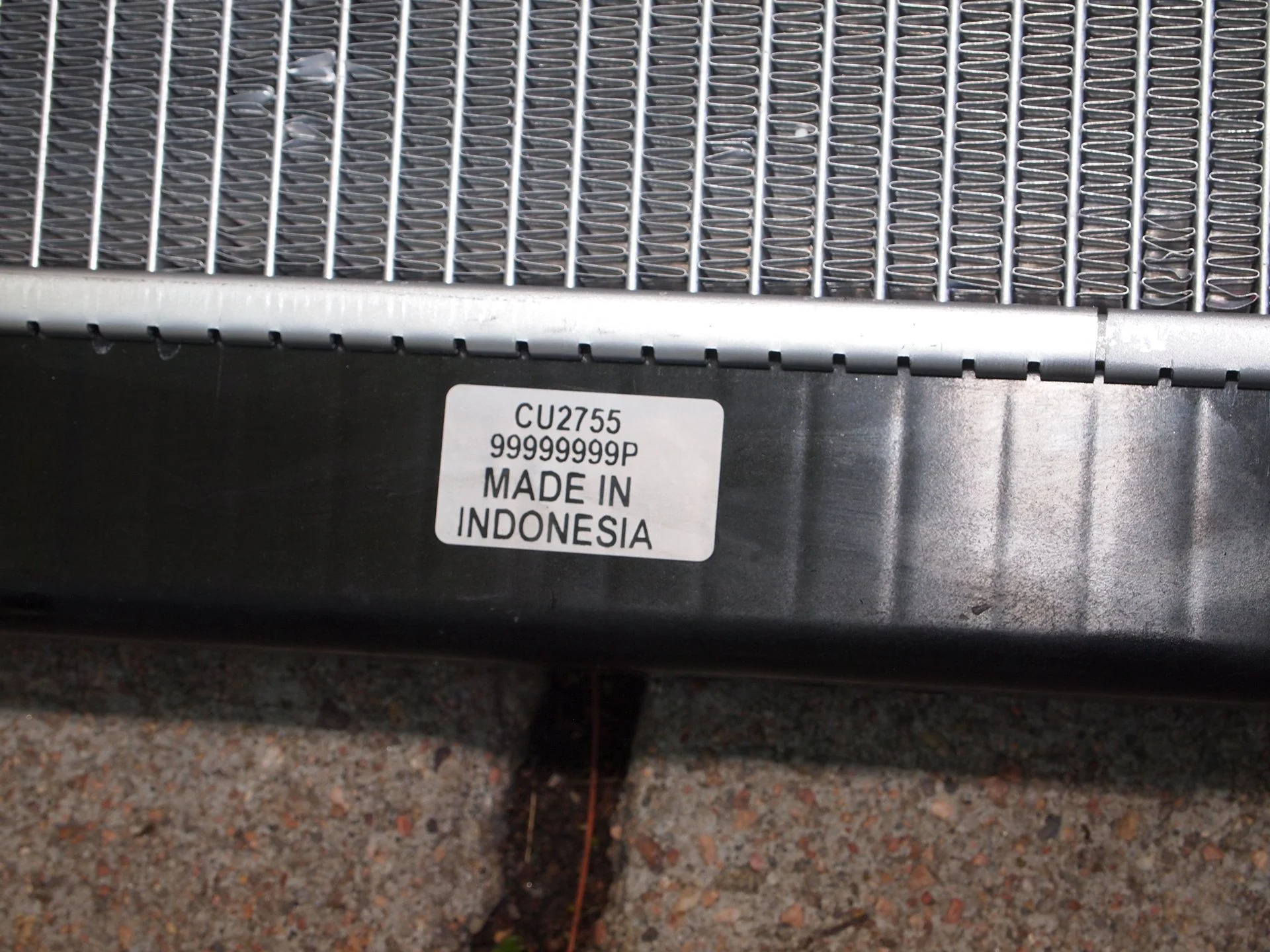

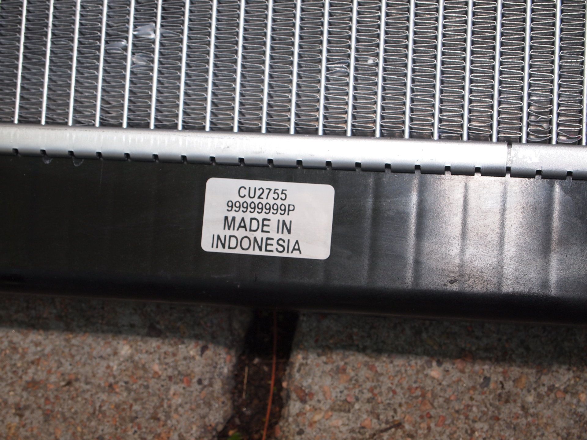

Did you happen to come across the orange mfg sticker anywhere on the radiator?

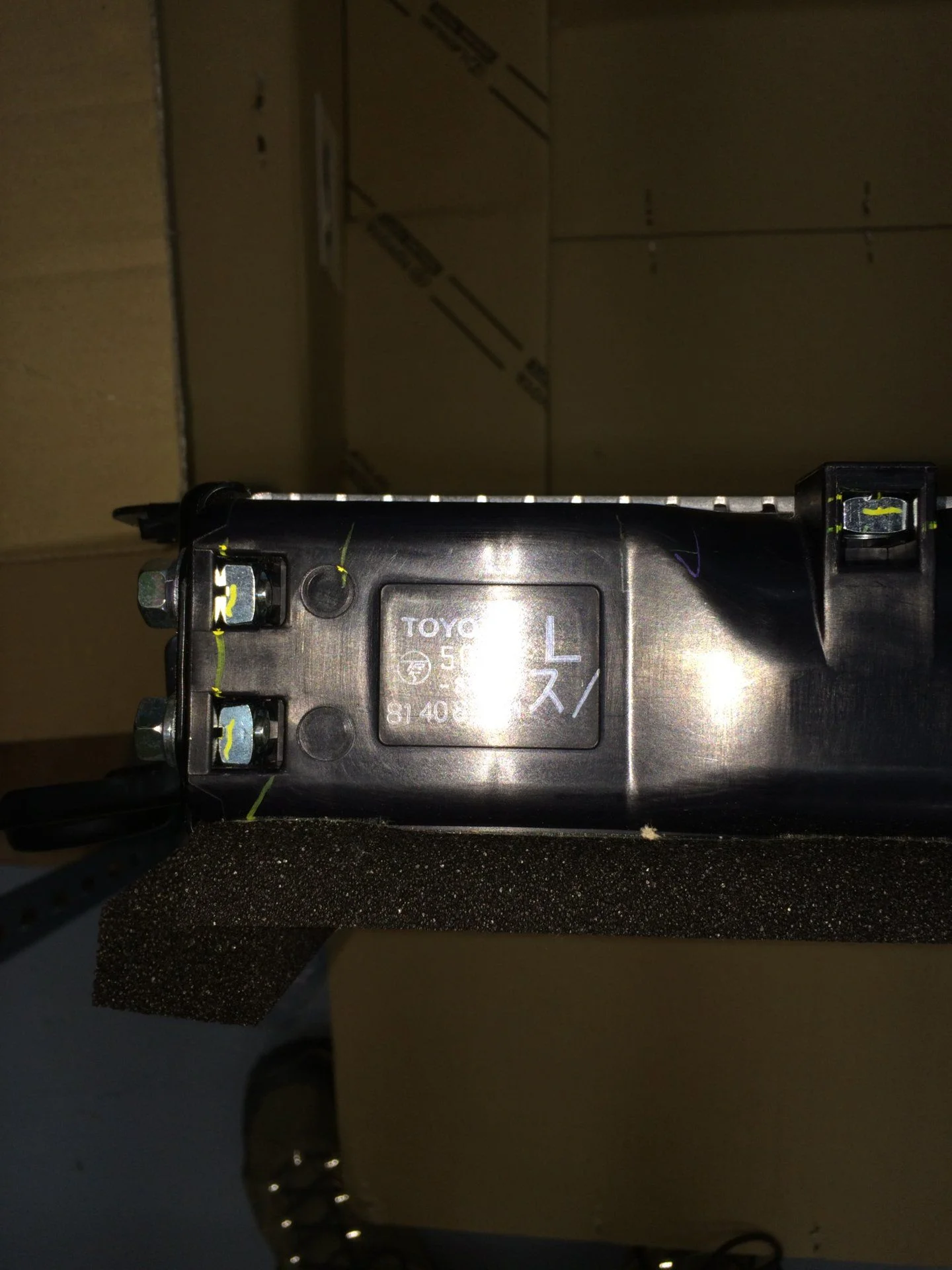

Here's your picture @abuck99 only sticker.
I see you all like the Spectra, and all use aftermarket lower hose(s). I'm doing this for someone that one day will likely end-up at a Toyota Dealer's shop. My concern is Dealer puts on OEM hose, it leaks, then they say needs a new Radiator. But regardless after two from Amazon that had shipping damage and both with casting mark making a valley (V) in water outlet pipe, I'm moving on.
So NO orange mfg sticker.
Your orange sticker states made in China. "China" so what's up with that!
Are we dealing with bootlegs?
Is Spectra made in China or Indonesia???
Thanks Paul- that sticker is different from the one on my radiator- which is different from the one Spectra asked for when I dialoged with them on the issues regarding the inlet/outlet variances. They must have more than one vendor in Indonesia making radiators.
When I was providing feedback to Spectra on the variances I experienced between the OEM and CU2755 radiator they asked me to send a picture of the "orange sticker"- I said "what orange sticker?" since my radiator didn't have one- anywhere. What I posted was an example of a production sticker that Spectra sent me as a reference to look for. They indicate that all their radiators have this Orange sticker. Seems neither yours nor mine have them.
Keep in mind if you look at the model number, that sticker has no reference to the CU2755 (its a reference image). According to the tech I spoke to at Spectra, all of the CU2755 are only made in Indonesia. The CU2282 are made in China, and also 4 other countries.
As for counterfeits, at this price point and volume expectation, I don't see why anyone would try to bootleg a Spectra radiator; its nothing special and it is not worth copying for such low production numbers of 100 series trucks between 2003 & 2007. There are 1/2 dozen different brands offering a radiator replacement for 100 series. There can't be a significant amount of profit for counterfeit. Now based on the price of an OEM radiator which is 3x more expensive than the nearest aftermarket option, I could see someone counterfeiting an OEM radiator.

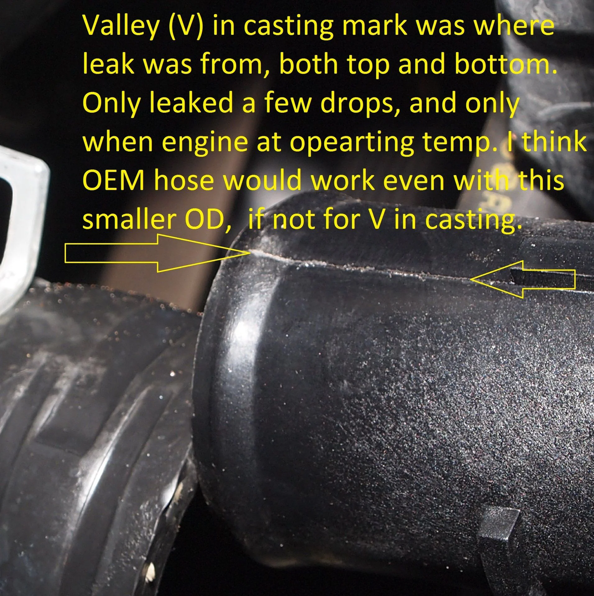

Recap: Spectra Lower outlet OD is smaller than OEM by -1.5mm and may leak. If you are reusing old hose chances are it will leak. If your are using a new OEM Toyota hose, it will probably leak. The Continental Elite has a better fit then oem hose & probably stronger as its thicker rubber. I also suggest new spring clamps. Or you can just use adjustable clamps if thats your preference. FWIW the Conti hose is $12.33 on RA. https://www.rockauto.com/en/moreinfo.php?pk=1333970&jsn=6
Another data point for the Spectra CU 2755. Echoing @abuck99 observations regarding the Spectras smaller OD outlet and leakage with the OEM lower hose. I tried using a newish (less than 2k Miles) OEM lower hose w original old clamp and it leaked badly. Fitted a new Gates hose which had a slightly better ID fit but same wall thickness as the OEM hose with original old clamp and it leaked slightly. I couldn’t source the thicker walled Continental Elite hose locally on a Saturday morning which would have been my preference. Then fitted a Breeze constant tension clamp and no leak, all good.
My takeaway from this thread and personal experience is if you install the Spectra CU2755 ($203 delivered) then expect leakage with OEM lower hoses. You’ll need a new lower hose with slightly smaller ID, preferably the Continental Elite or Gates will suffice, and a new constant tension clamp. A new OEM constant tension clamp with a new Gates hose might be satisfactory. I settled on a Breeze #5281K18 constant tension from McMaster Carr and a new Gates hose. Otherwise the Spectra radiator mounts up nicely with the OEM side brackets transferred over.
Glad to know you sorted through this. I had contacted Spectra directly back in March when I installed mine about the outlet size variance & leak and they weren't too responsive. We're talking less than 2mm variance in circumference, but its enough to provide a pathway to weep past a new OEM tension clamp and new oem hose. Even with a new oem clamp and the Conti hose it weeped a little but then stopped a few days later. So far 4k+ mile trip last month and no leaking.
After trying/returning two Spectra's I went with a CSF. It too had a smaller OD on lower, but casting marks were at a different position (180 deg) and did not had the valley/channel within casting marks. The only reason I did not use OEM, is reports here of (some) being defective. But could the OEM's have been a bad install or bad hoses, or just fluke of the time IDK.
CSF leaked too, but by using a new OEM lower hose along with the old factory clamps leak stopped. I went with the CSF as it's what my local Toyota Dealer was also using for customer vehicles and they typically replace hose(s) at same time. (They used a cheaper aftermarket for their used car lot repairs.) I did not want to use non OEM hose and clamp to stop a leak, so would have gone OEM rad if leak had persisted.

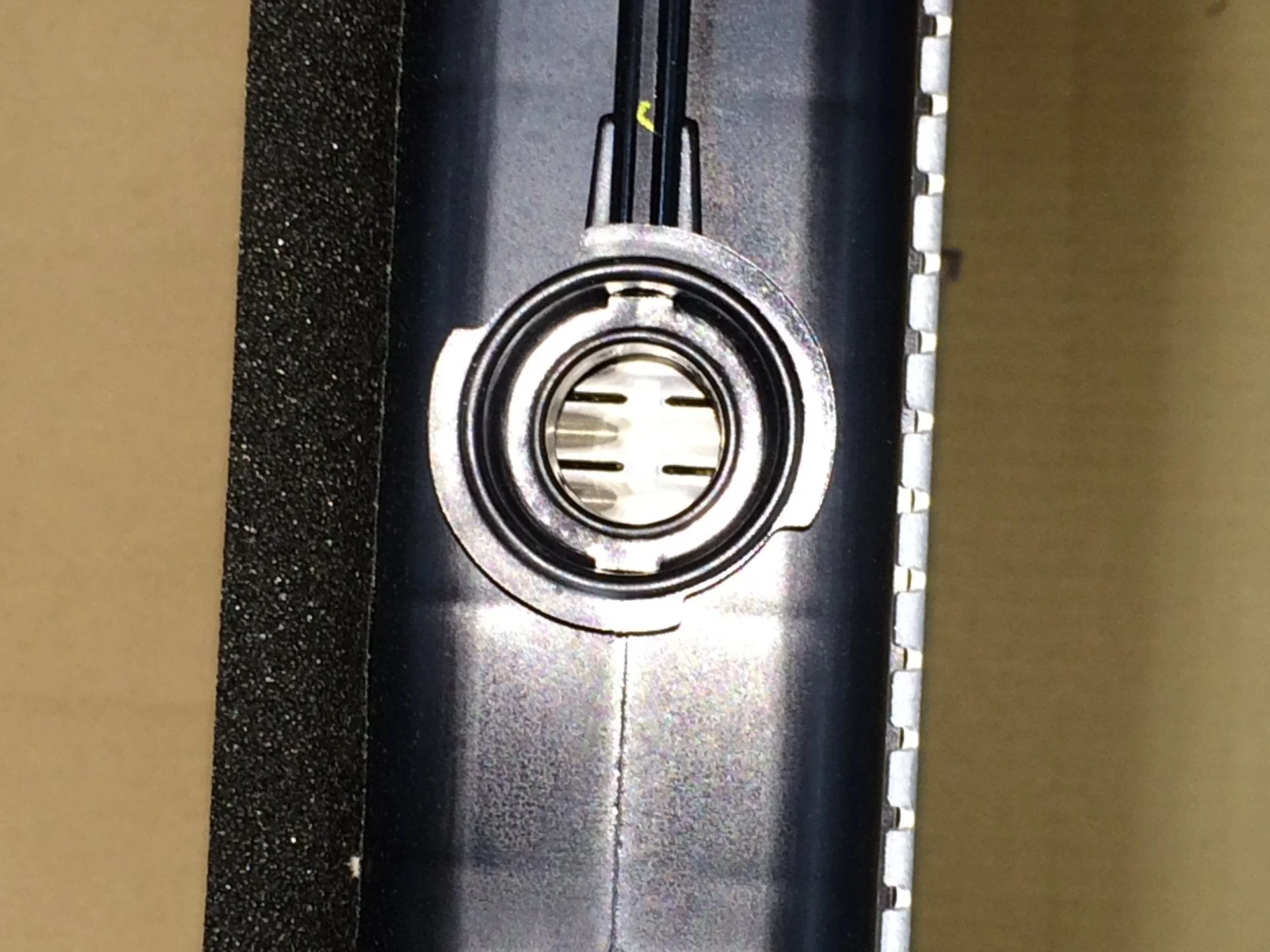

My Toyota parts guy said they almost never order OEM radiators, just to pricy for most customers. He order me the Mexican spec OEM just so I could get a look at it. It looks just like our factory installed and has the foam attached (sweet). The difference between Mexican, US or Canadian spec is environmental certification. They may or may not attactual have difference in metals and manufacture process to meet each counties laws. Note: 2006-07 thermostat is twice the price of the older thermostats, they both look and perform the same. Difference is in manufacturing processes to meet 2005 USA environment standards to remove pollutants..
OD of goose necks:
Measurements are difficult to get an accurate read of, as plastic varies in roundness. The new OEM did seem to be a little turer/rounder and thicker plastic. Also used rads, may have swollen some from absorption of coolant and in my example below from overheating. But lower and small outlet for reservoir of CSF & Spectra did have smaller OD's.
IMHO the valley (channel) in casting markes of the Spectra was the biggest issue causing the leak.
Radiator, OEM factory out of 07 LC overheated.
42.06mm OD Lower
38.19mm OD upper
10.015mm OD Transmission cooler inlet/outlet
Mexican spec:
41.93mm Lower
37.74mm Upper
CSF:
41.00mm OD Lower
38.00mm OD upper
OEM Mexican

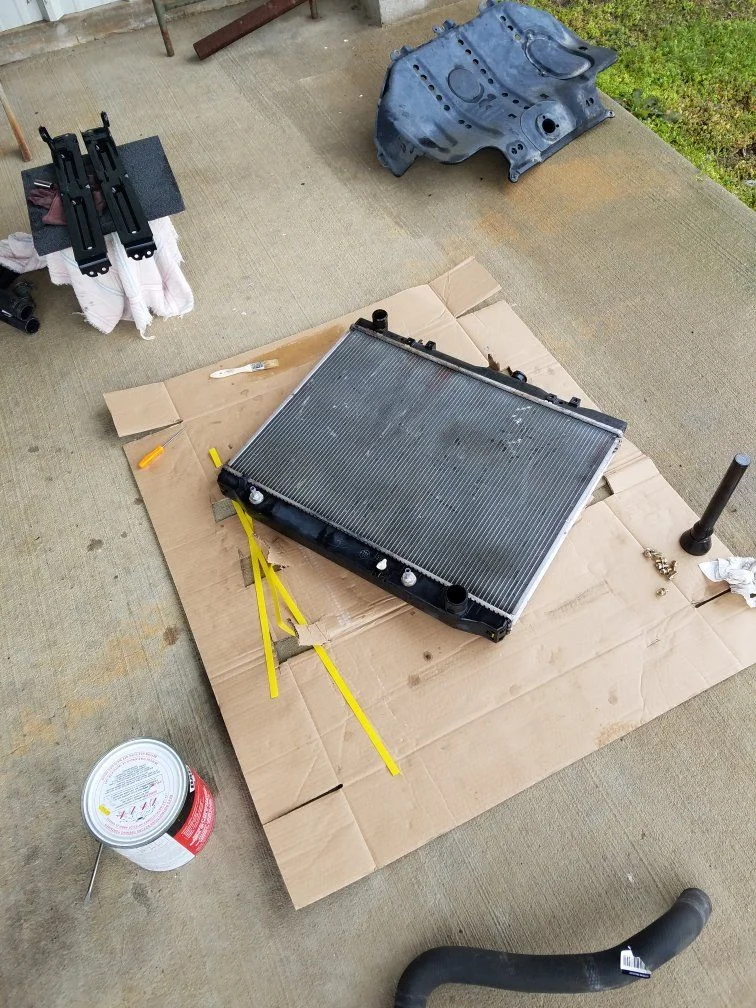

somehow I poked a hole in my radiator with one tool or another doing the water pump, belt, etc. Probably around the time I installed the fan bracket for the second time, or alternator rebuild in and out.
Very much irritated with myself for not just taking the time to remove the radiator for all of it in the first place.
I did get quotes from napa, who would take a day to get a spectra, and a week to get a denso, both for outrageous money.
Advance who said, no we don't have one.
Oreillys said they'd have to call me back.
I wanted one in one day but not at double the cost. So it sat for 5 extra days.
this is my second spectra, both from amazon, who don't understand shipping a radiator. Like it's been said, there is something to be said for just paying up and getting a radiator locally, damn the cost.
I'm through with getting radiators from amazon though. The side panels have been bent in a tiny amount on both of mine.
I still used both and they both were/are fine. The panels get pulled back when you screw in the side brackets into the outside frame.
I reused hoses and clamps. Seems fine, they were all new in june 2017, Don't forget, of the four big hose clamps, the bottom one on the radiator side is bigger than the other three. I've not had the leak issue, but if I did I would swap one of the other three clamps with the bigger lower one.
I'm going to tear down the old spectra and have a look sometime to see where I dinged it. That's my rant for the day, 5 days actually.
