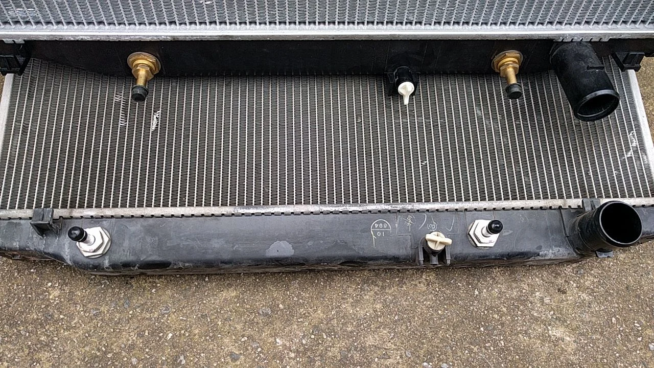

Not liking the fit of the CU2755. The fan shroud isn't happy and doesn't sit well with the spectra.

The outlet is in the correct left/right location, but too high. The fan shroud mounting location on the driver's side is right, but the passenger side mount should be apart of the outlet and it's to the right. I didn't want to trim the shroud to fit around the outlet and figure out the mounting, so I went back to the denso.

Looks like the 2282 I had, most everything is not in the same position as OEM.

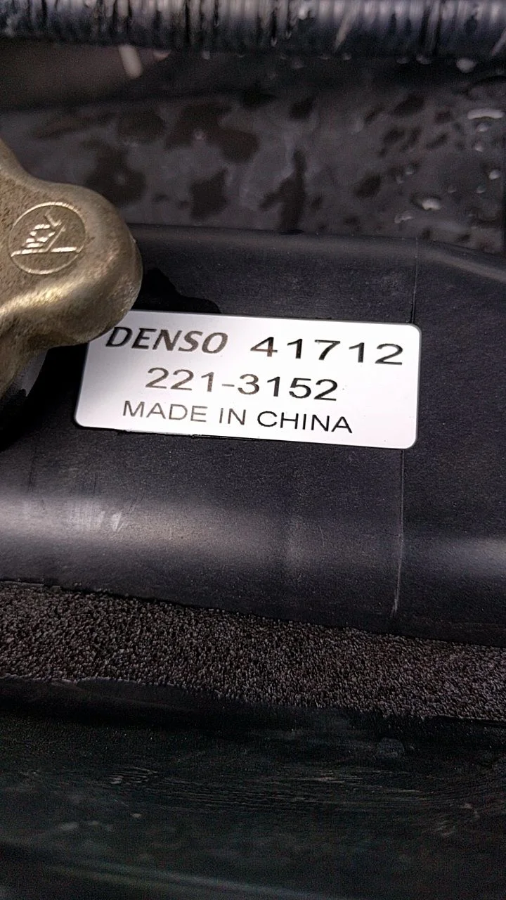

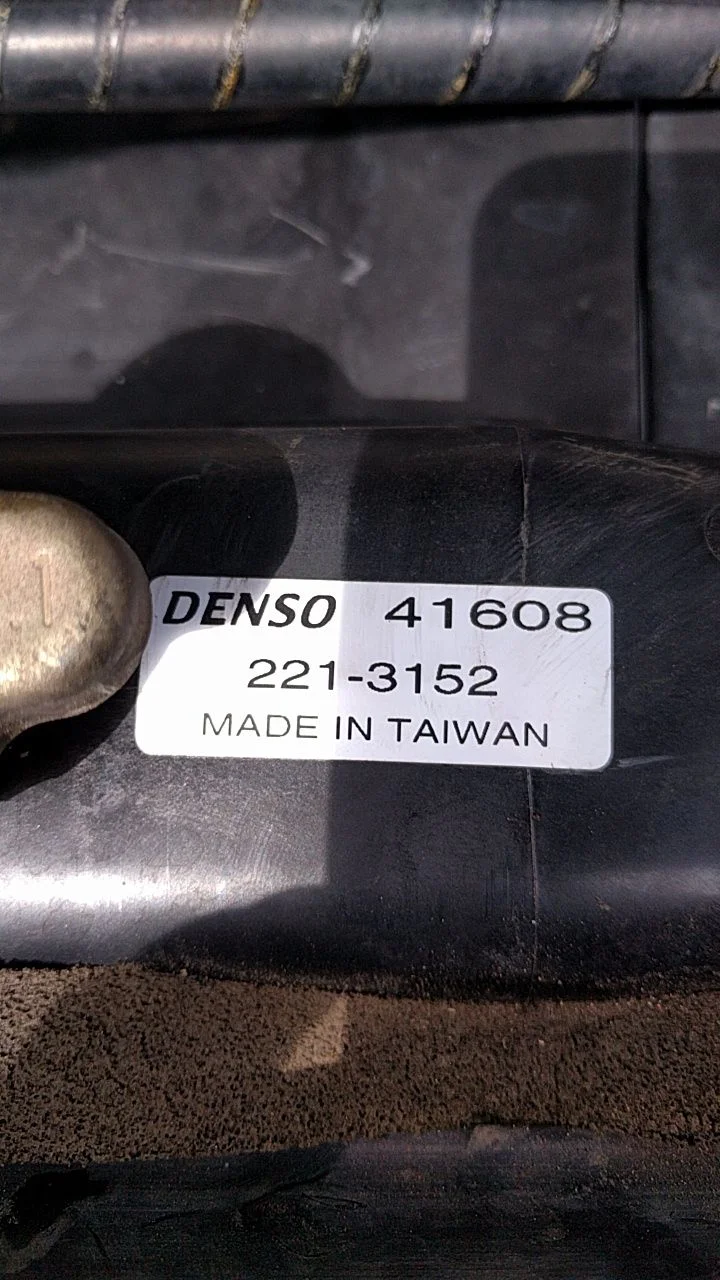

Denso from Taiwan I bought on Amazon late 2017:
Denso from China I bought on Amazon March 2018, same Amazon listing:

Looks like Denso has made a vendor change.

Post up the amazon link where you got your denso when you get a chance.
