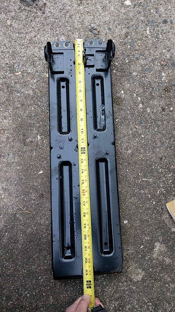

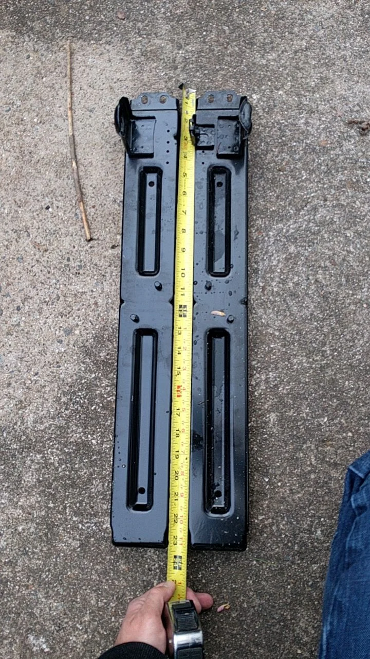

The CU2755 I have here has the bottom PS shroud tab on the outlet same as OEM. Which looks different than Camino's picture. My oem radiator is still in the truck, and the slee skid is in the way of taking accurate measurements but I was able to get a ruler in to measure the locations of the cooler fittings, shroud tabs, outlet pipe and they are all with in few mm of the location on the Spectra I have here. So initial appearances and rough measurements indicate a very close if not exact match. The filler neck measures the same location, and the reservoir tab looks in the same spot as well. Based on what I am seeing, I will go ahead and try to install this and report back on the fitment next weekend.

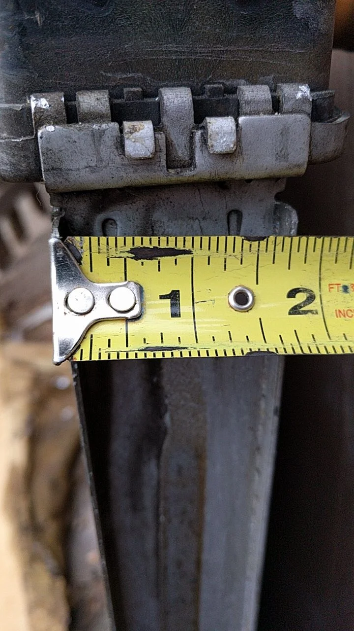

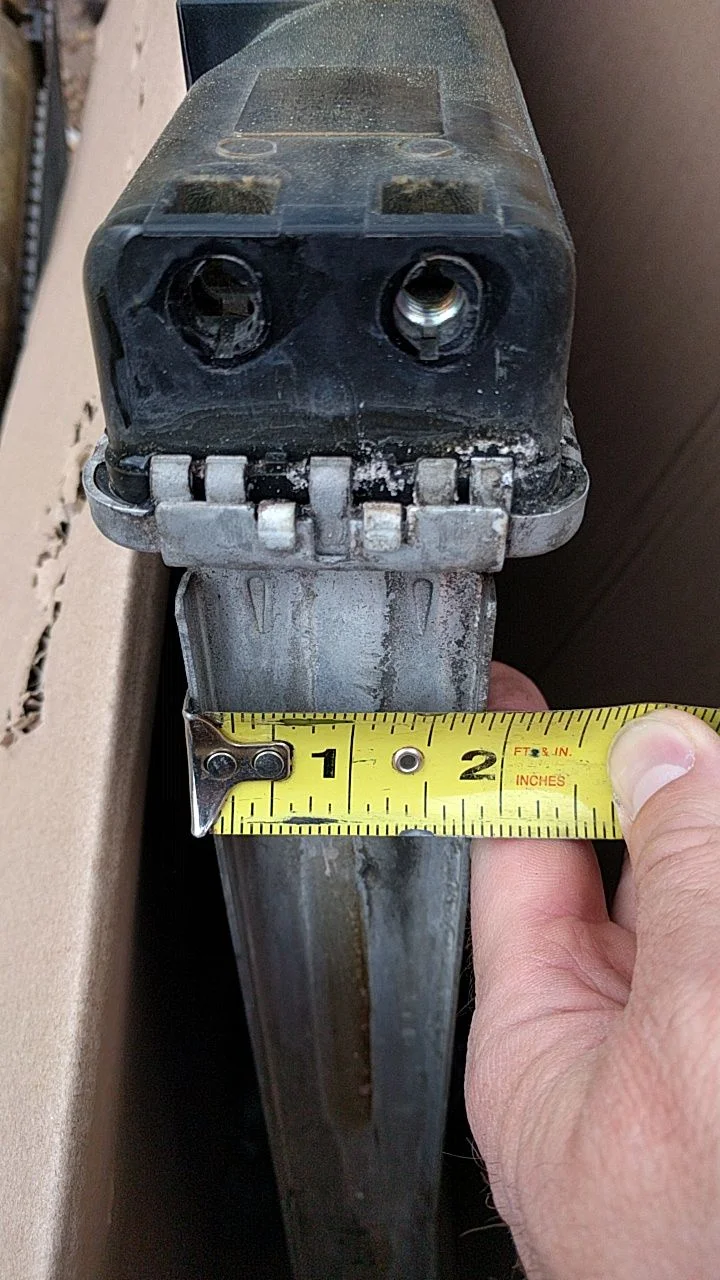

BTW: I measured the core on the spectra and it is 2 1/16” deep; which is thicker than the Denso, and the CU2282 version
Let me know if you need any other images or measurements

Here's some quick pic I took today of Factory OE. You can see positions, also see cooler lines are aluminum.
21 1/2" center to center shroud mounts.
Estimate core is ~2 1/4"
I'll post core measurement next chance I have to measure.
