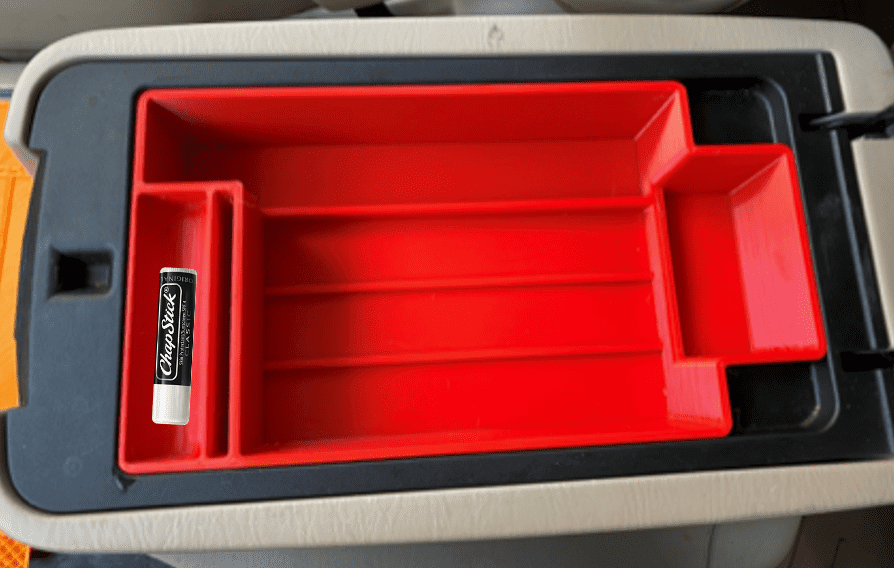

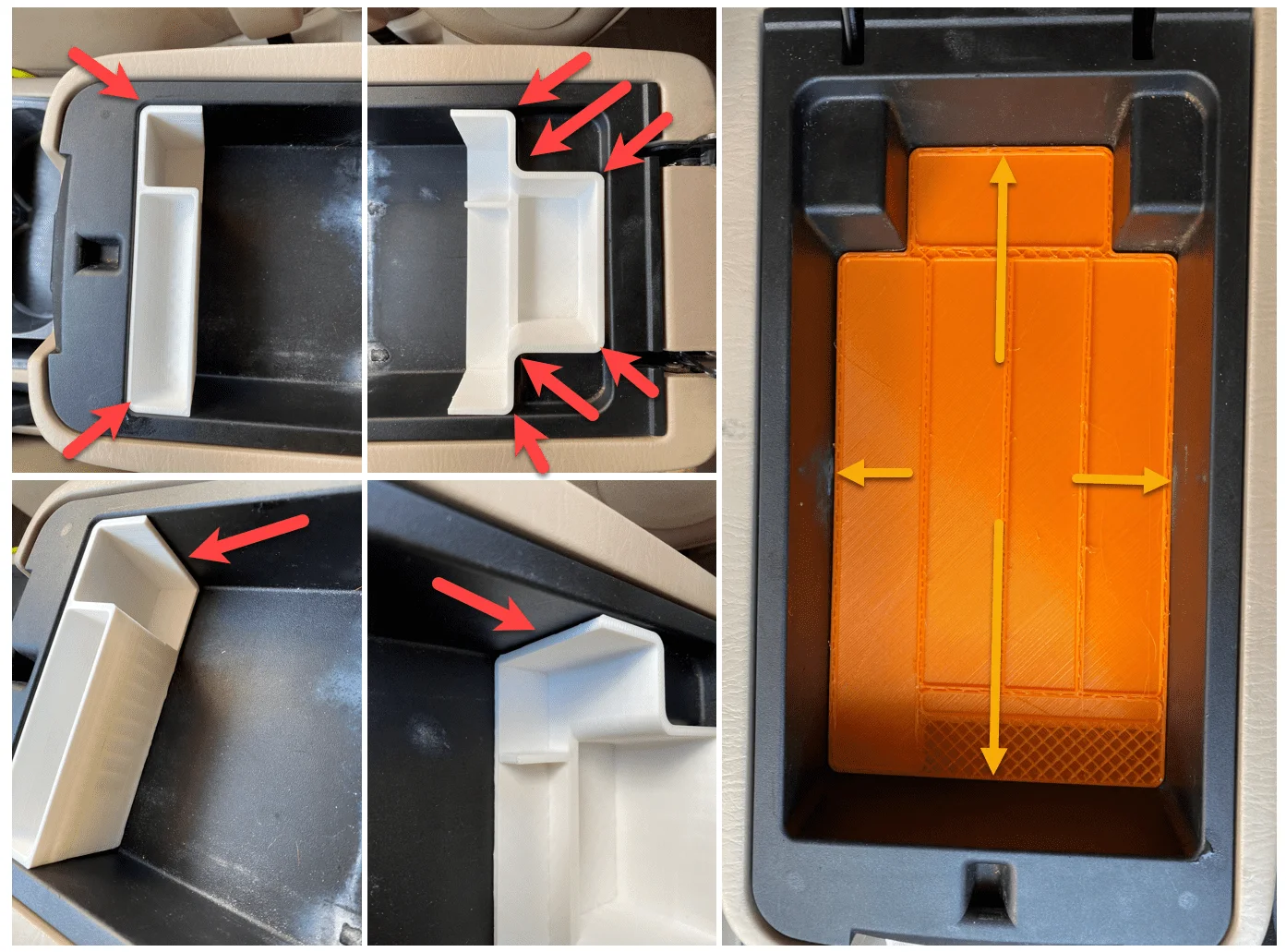

Updating on the center storage box insert:
All corners and draft angles are adjusted to better match the factory dimensions. I don't want the insert to wander around in there.
A prototype was printed in PETG (won't warp under summer heat) and sent to @NLXTACY for product evaluation. I like his high standard on his own products.
Design can be revised based on individual need.
That's pretty nifty looking... s*** this means that I need to dedicate a card to Ben's s*** now as well... Already got one that I am working on for Jason's stuff. **** man, Imma be broke forever... But at least I will have a SICK RIG!!!
Finally! I'll have a center console with a properly configured and located Chapstick holster!

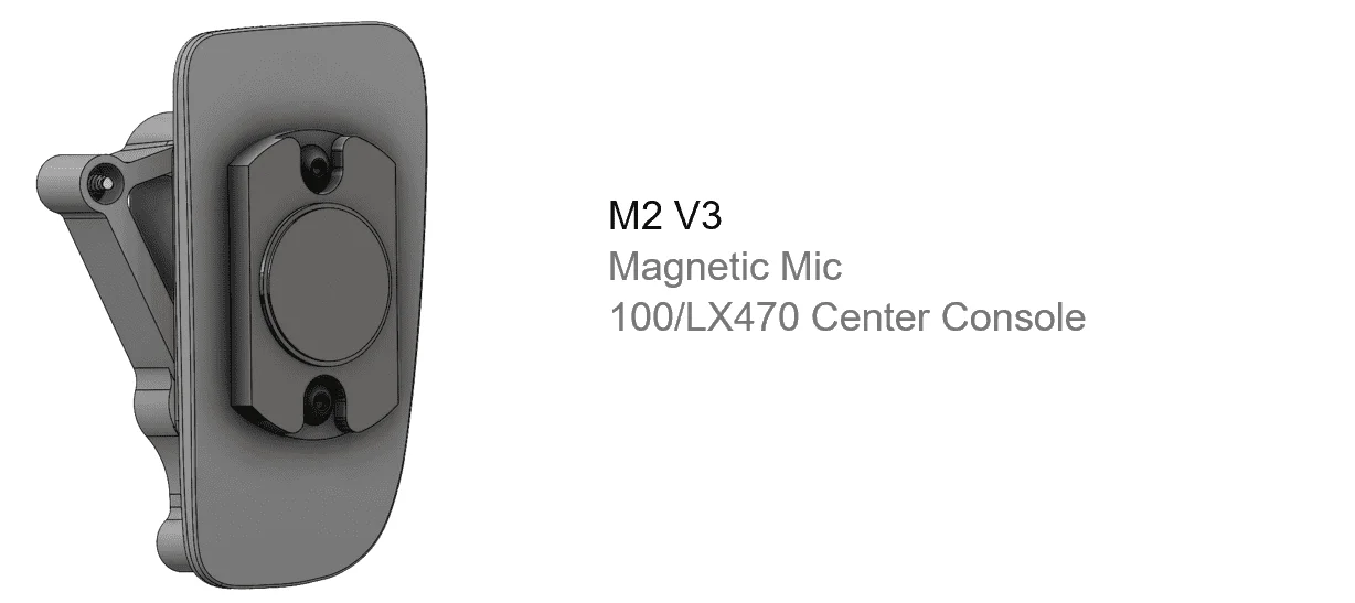

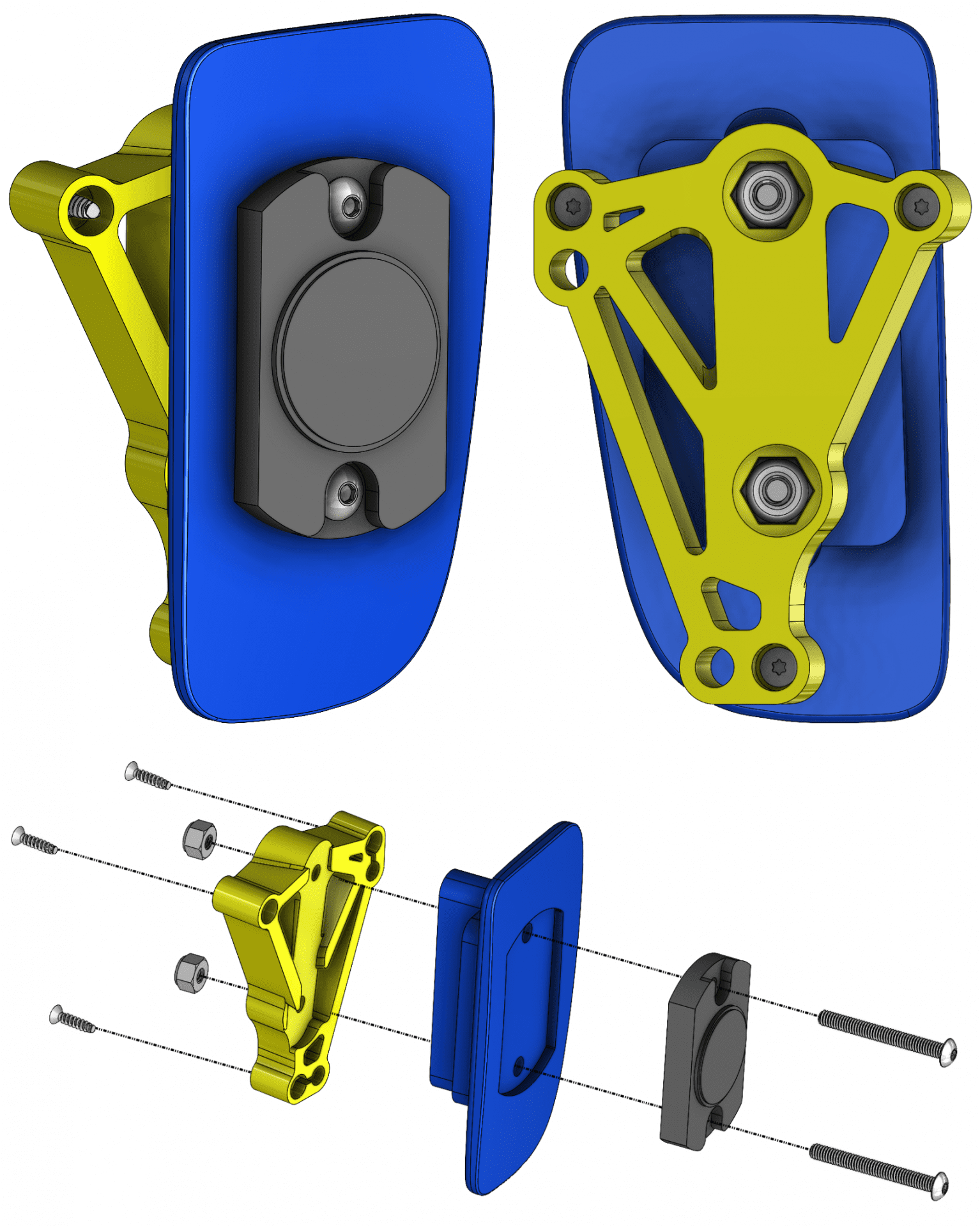

Make 2 V3: Magnetic Mic Mount
1. Overview of the Final Product
2 Description
M2V3 mounts a Magnetic Mic which is designed to securely hold the radio microphone in place. Similarly to M2V2, M2V2 has a backing bracket to increase the structural rigidity. All fasteners are stainless steel and included. Magnetic Mic is not included.
The magnet is ridiculously strong. It definitely can hold something heavier than a radio microphone.

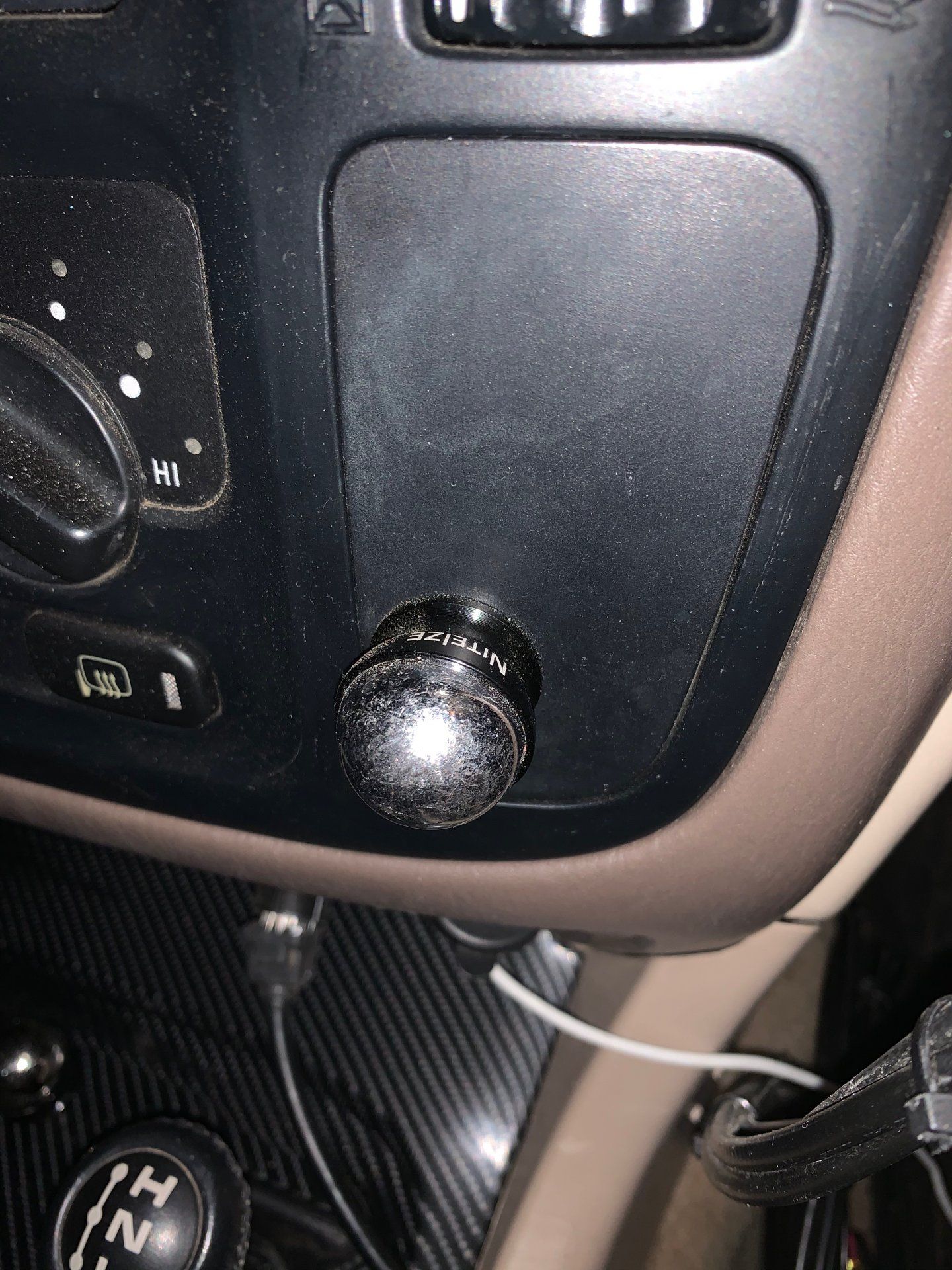

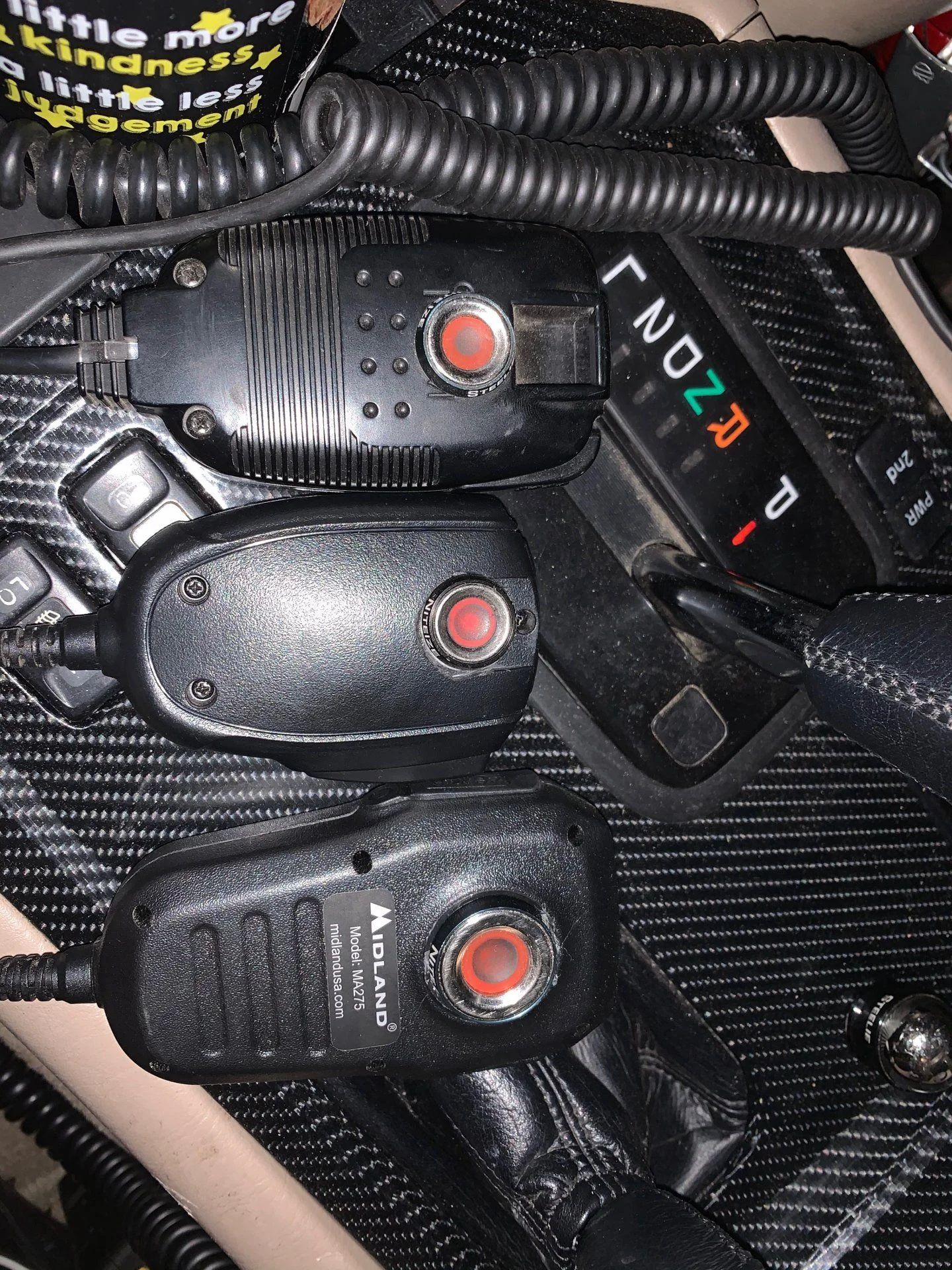

Maybe another version of Make 2 would be to integrate a Nite Ize magnetic ball. Would be similar to the Magnetic Mic. I already have the investment in the Nite iZe (3 mics). Same idea, lower price point.
