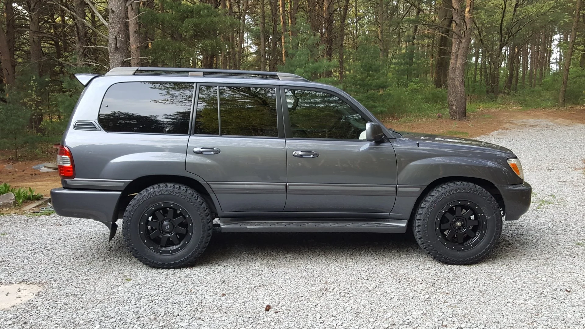

Current form...
So this was bought in March of 2017 and with 105k miles on it.

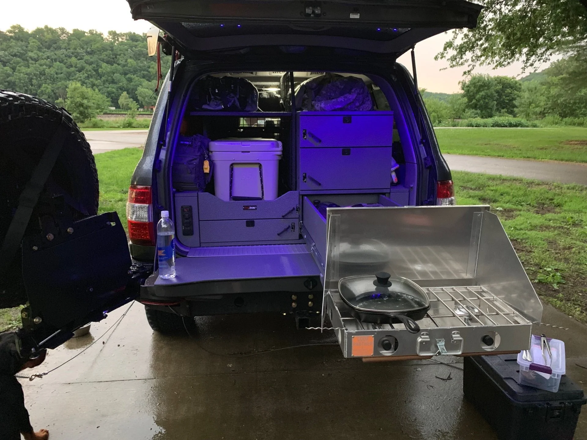

At some point leading up to this trip I knew the Trekkboxx would make doing work behind the 2nd row of seats a bit more difficult so in preparation for that I removed the 3rd row seats and carpets and Dynamatted the entire rear. I also ran a separate fuse box for the new electronics that would be back there, mainly for USB charging ports, some lighting, and a future 12v fridge. Regrettably I can not find any pictures on that right now but I will add them if I come across them.
Also had removed the factory roof rack in preparation for the new one.
And the Trekboxx…

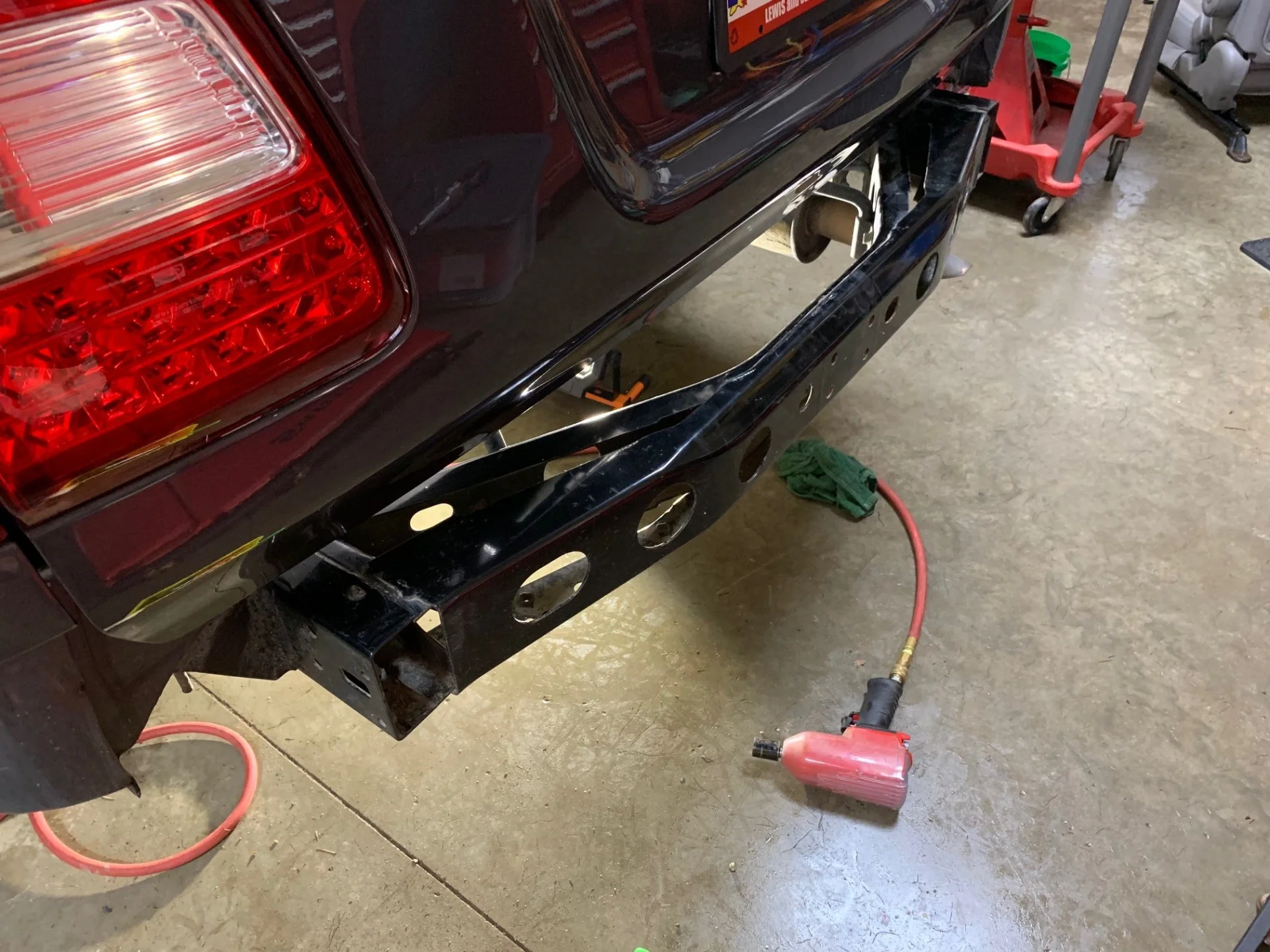

Originally I was going with the Slee rear but then saw that either the 80 or 200 was getting the revised one so I decided to wait for the revised 100. Well, that appeared to have been put on hold so as much as I wanted to stay with Slee I absolutely despise those latches that are/were used on the older version and present 100 version. Call it personal preference from the Jeep days when those were used on some in that world, I didn't like them then either. Had an A to Z on my last TJ build.

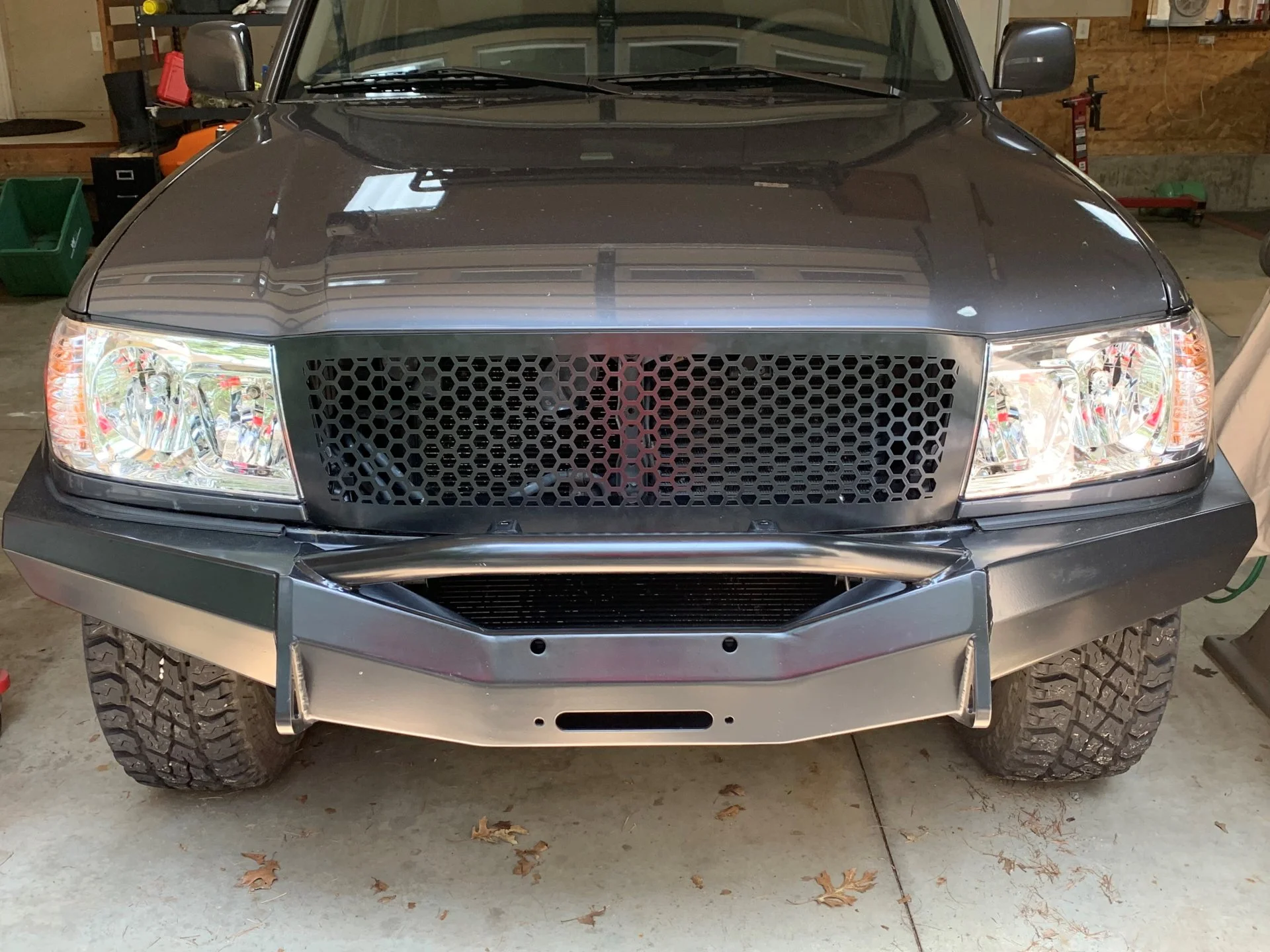

So I needed a bumper and fast. Somehow I came across someone on here selling their Dissent spot and they were due next for shipment. I secured that spot and picked up the pallet a week or so later. I had a little trouble finding a place to powdercoat it but did find one and got it dropped off, the trip was two weeks away and they said it would be done in time.

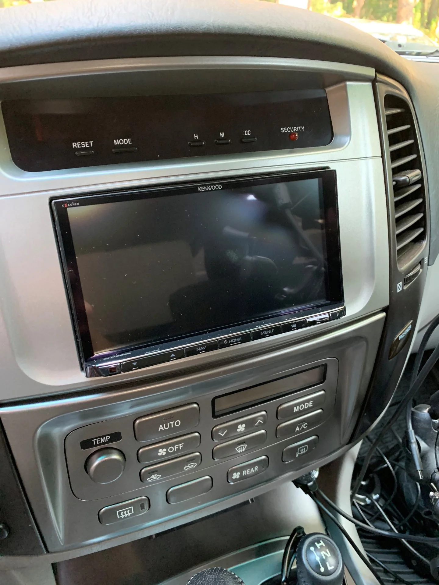

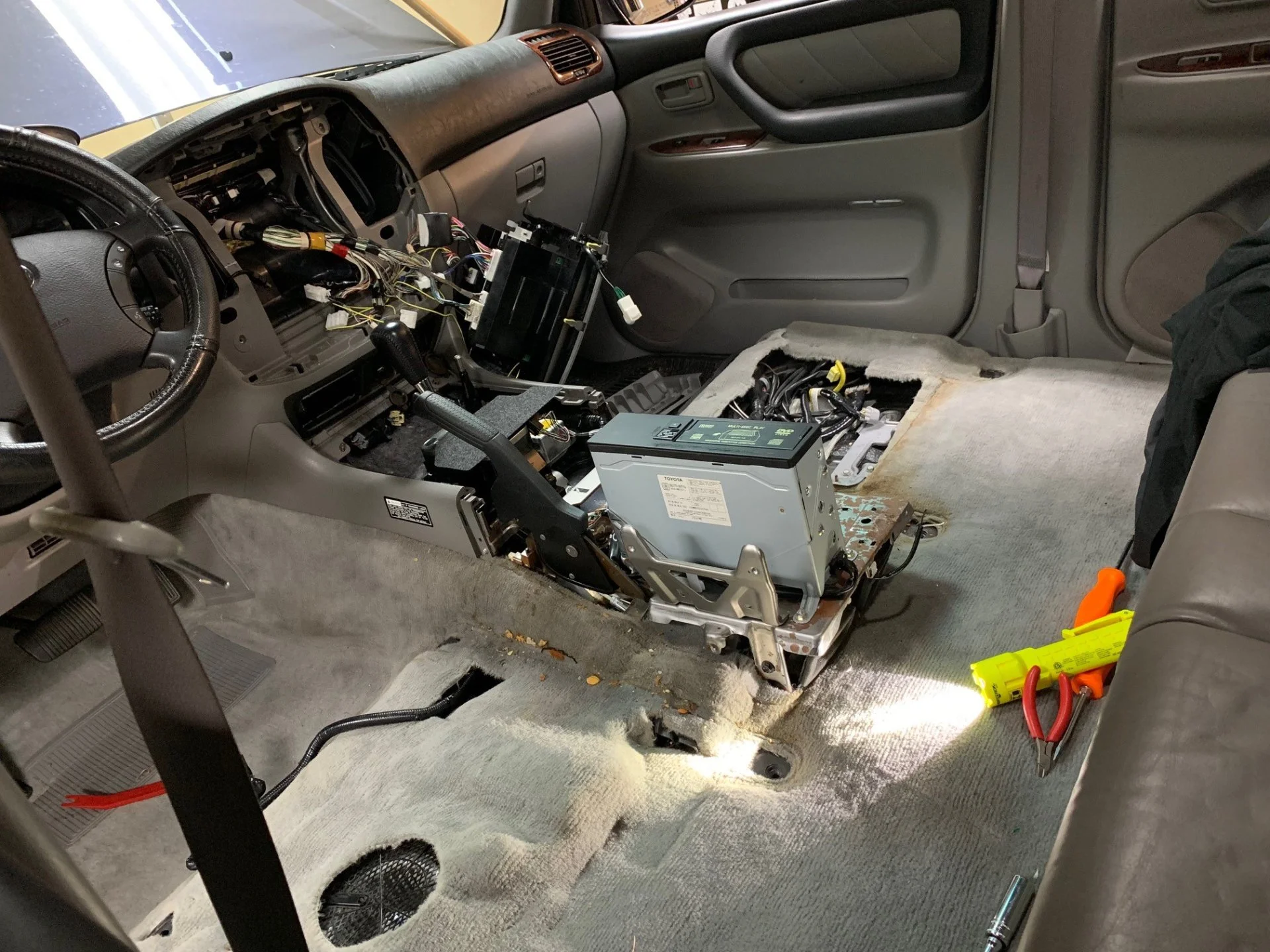

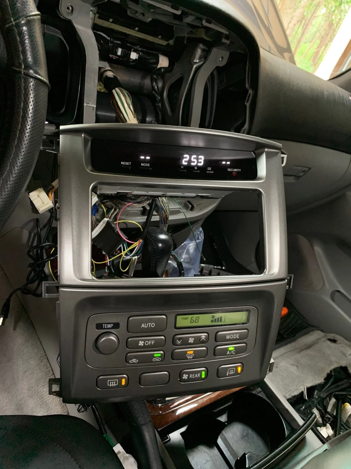

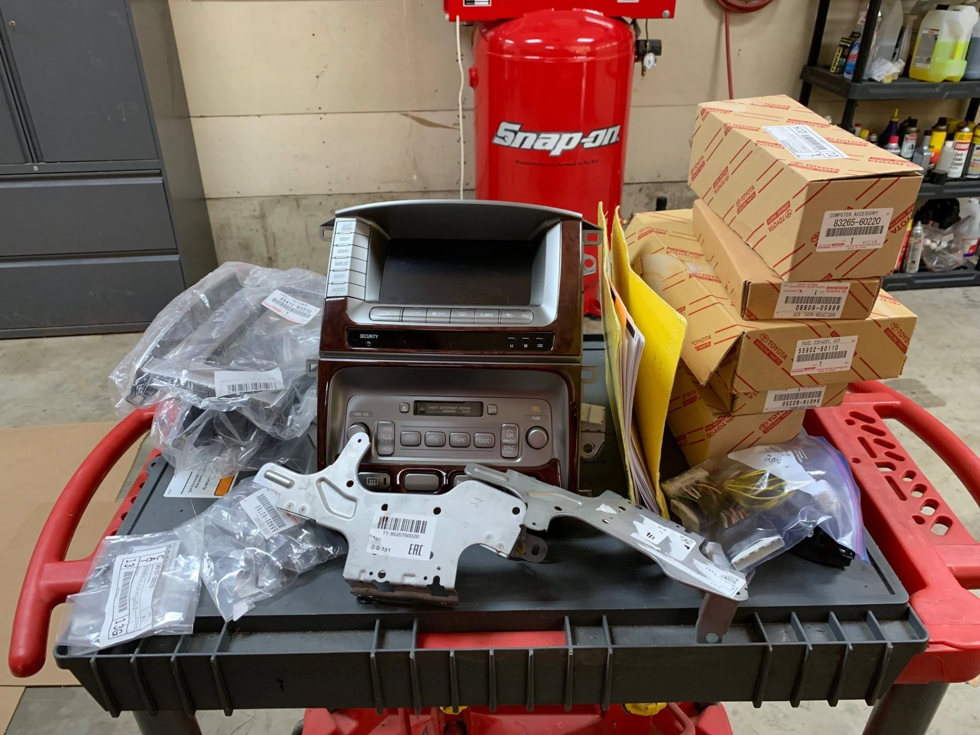

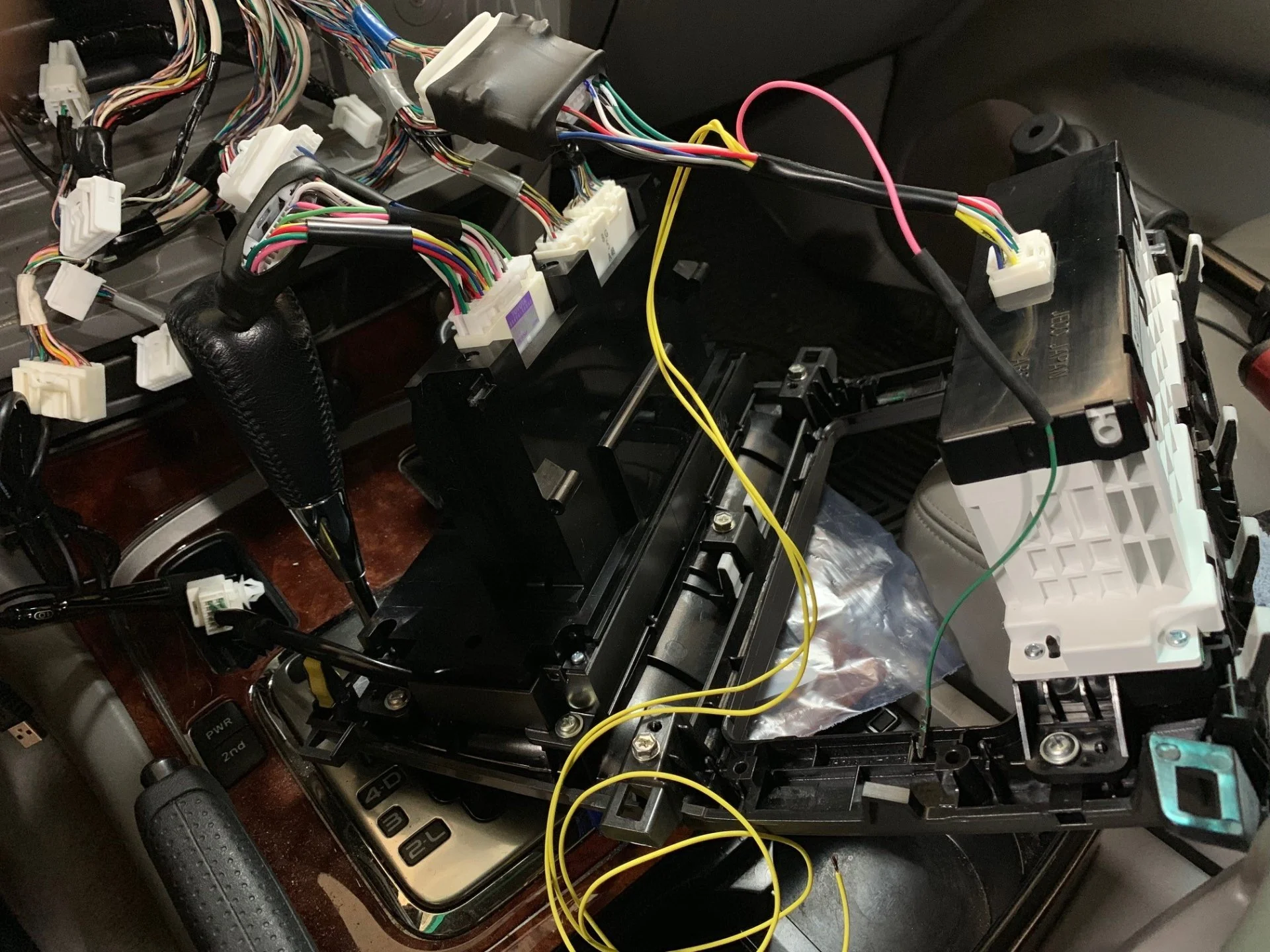

While this was just happening I had been acquiring the parts to remove the Navigation system and make it a Toyota non-NAV spec vehicle. That main thread is here.
I never really cared for the BT grom style system so it had been also on the to-do list for a little while.
@jerryb not only created the thread but made the harnesses to make this come together much easier than it would have been.

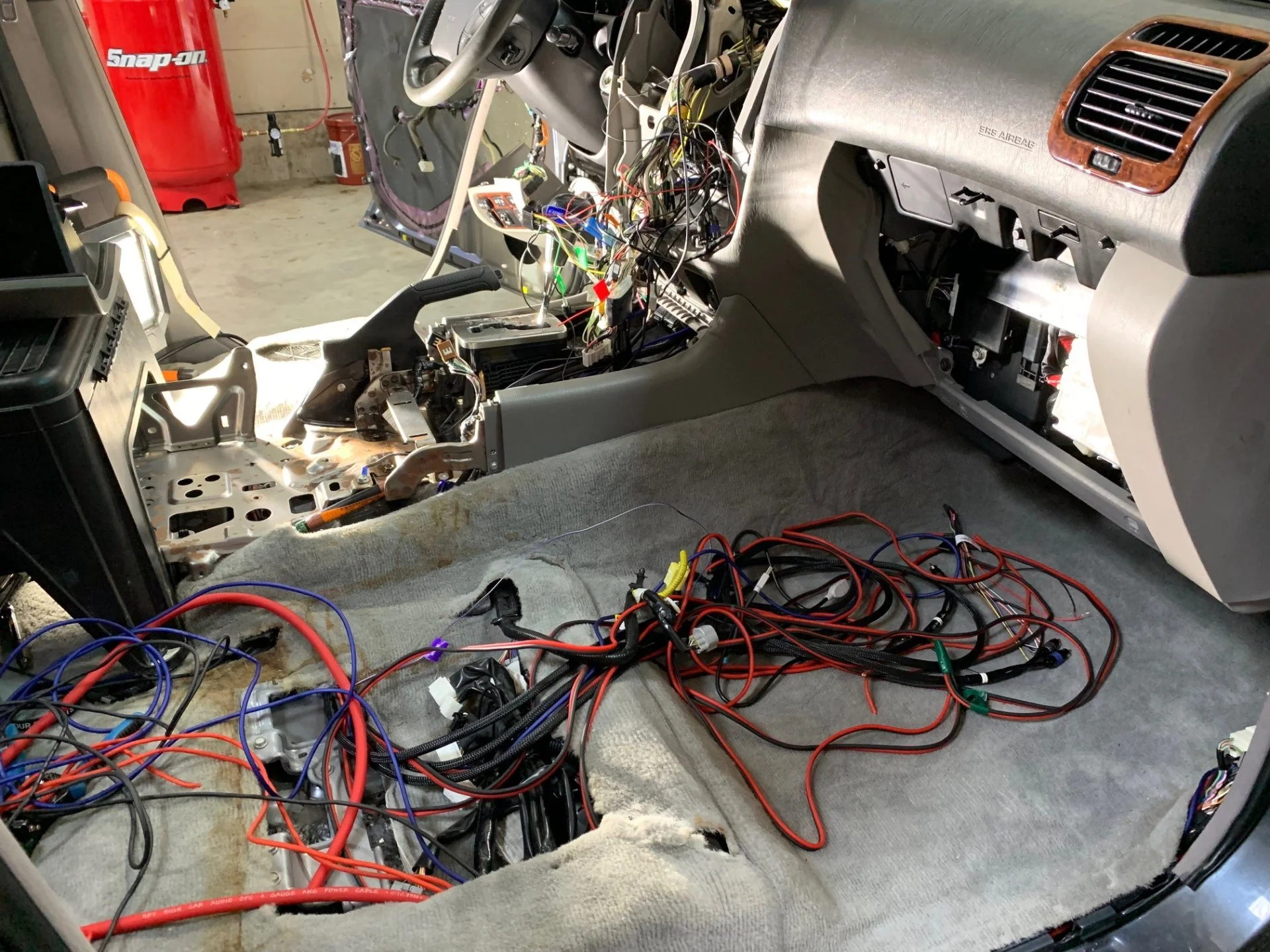

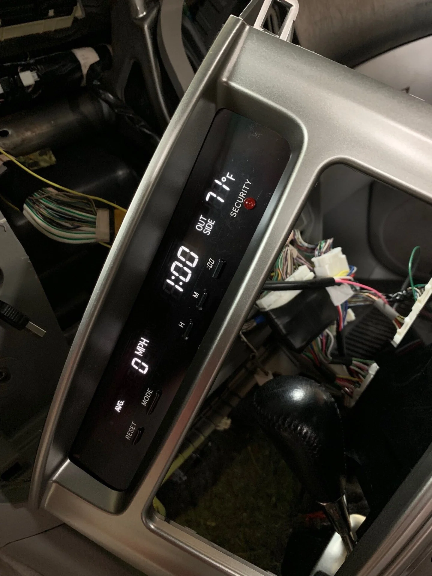

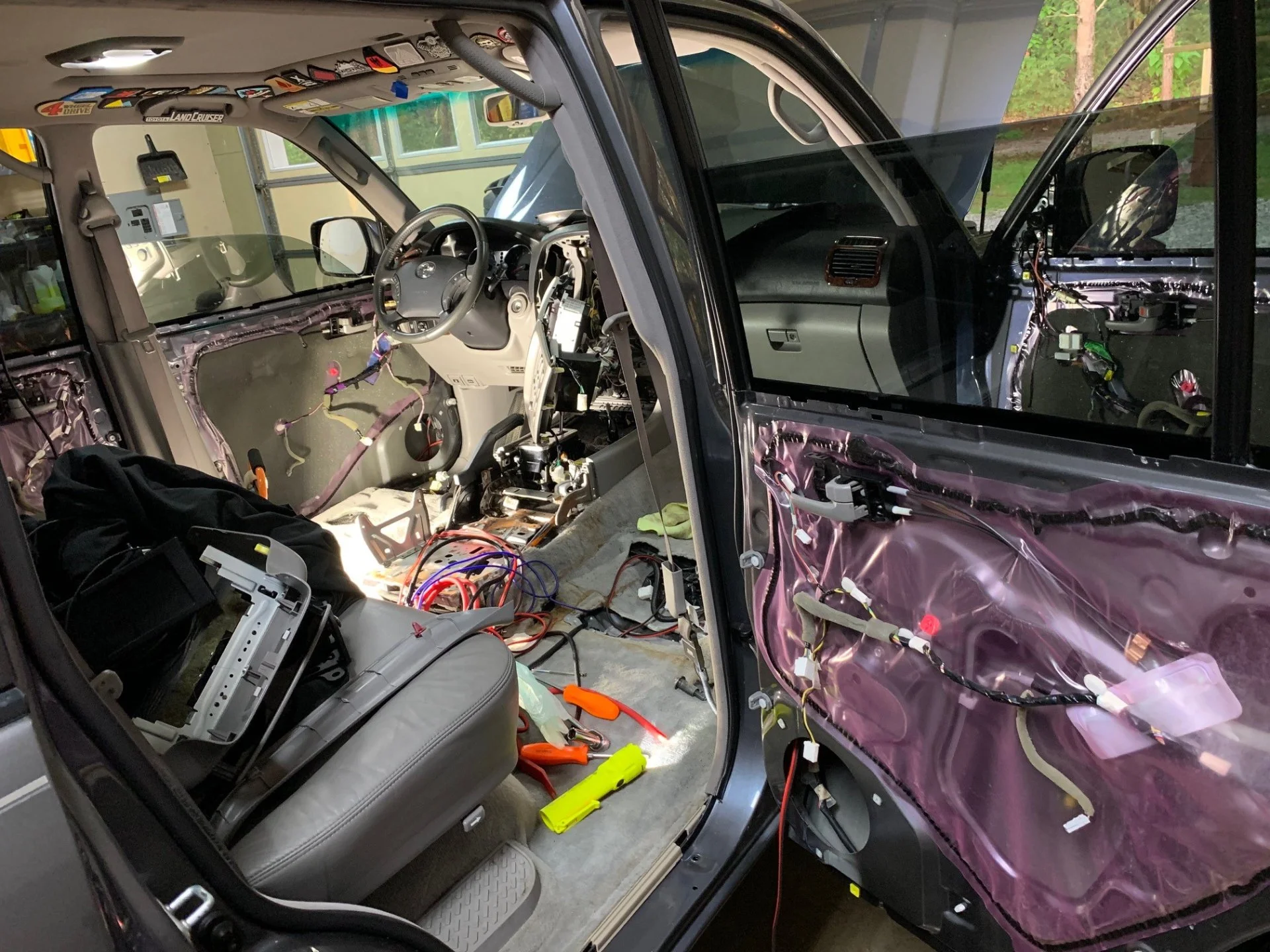

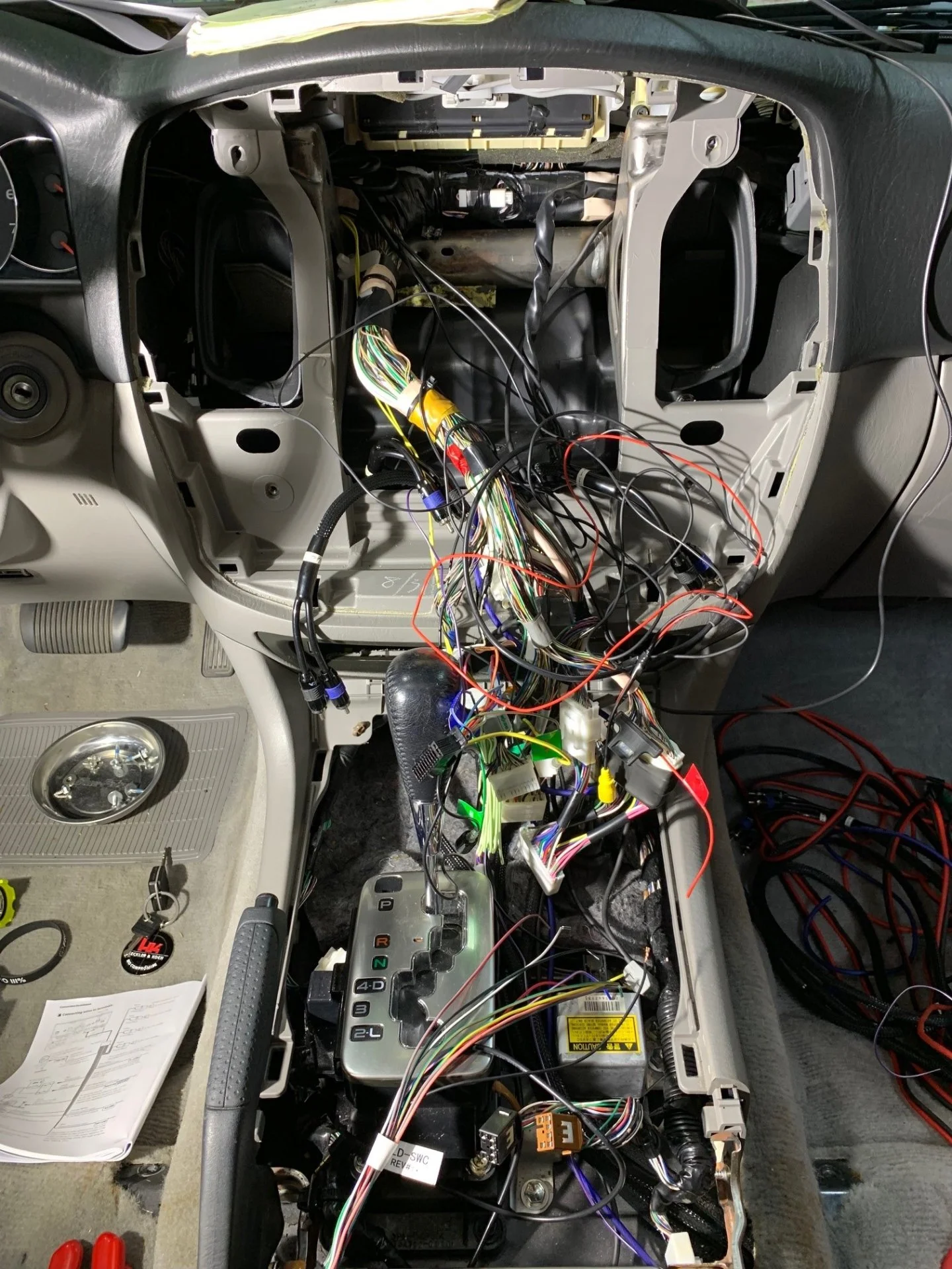

I was somewhere in the middle of the NAV swap when I decided "when in there" it needed more.
The previous owner wasn't too good at not spilling everything apparently, found a lot of coffee stains, a few meals, and about a dozen of those wrist bands that were a thing when Lance Armstrong was legit.

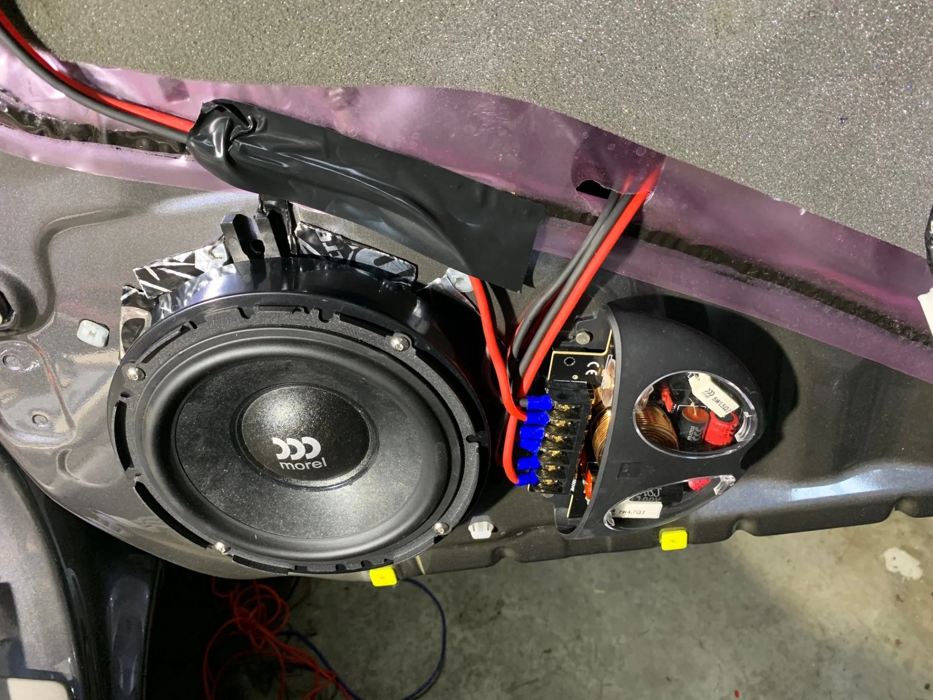

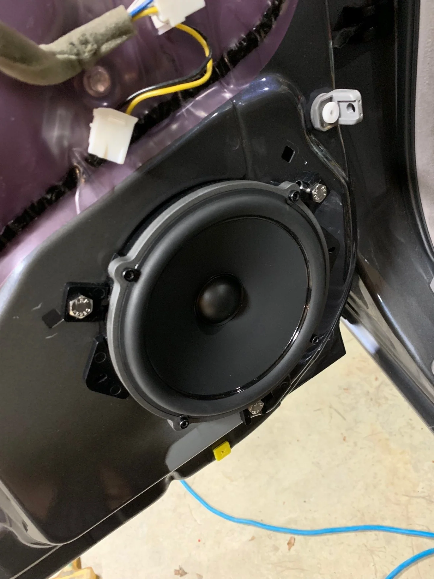

I ended up removing the associated NAV parts and did a complete audio system swap "while in there". Thanks to @suprarx7nut for some recommendations on speakers. I went with a Morel component in the front doors, Audiofrogs in the rear doors, a Audio Control LC-6.1200, a JL Audio 10" and a Kenwood Excelon DNX995S. All wiring was also replaced.
First time powering it up and I missed something...but the HVAC works!
Ah, a wire had popped loose and was a slight nightmare to get restored but it is gtg.

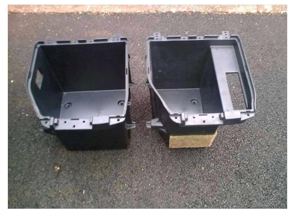

Some additional changes were to find the full size tub for when there is no CD changer *pic not mine* but similar concept.

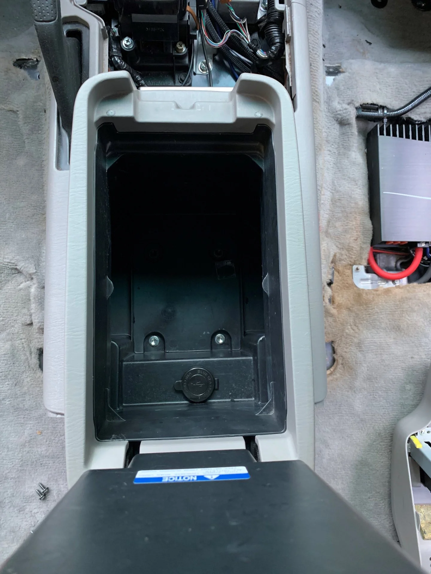

One nice thing I added was a USB line that runs to the brain of my HAM radio so I can plug in my laptop here to program the HAM which is installed under the passenger seat.

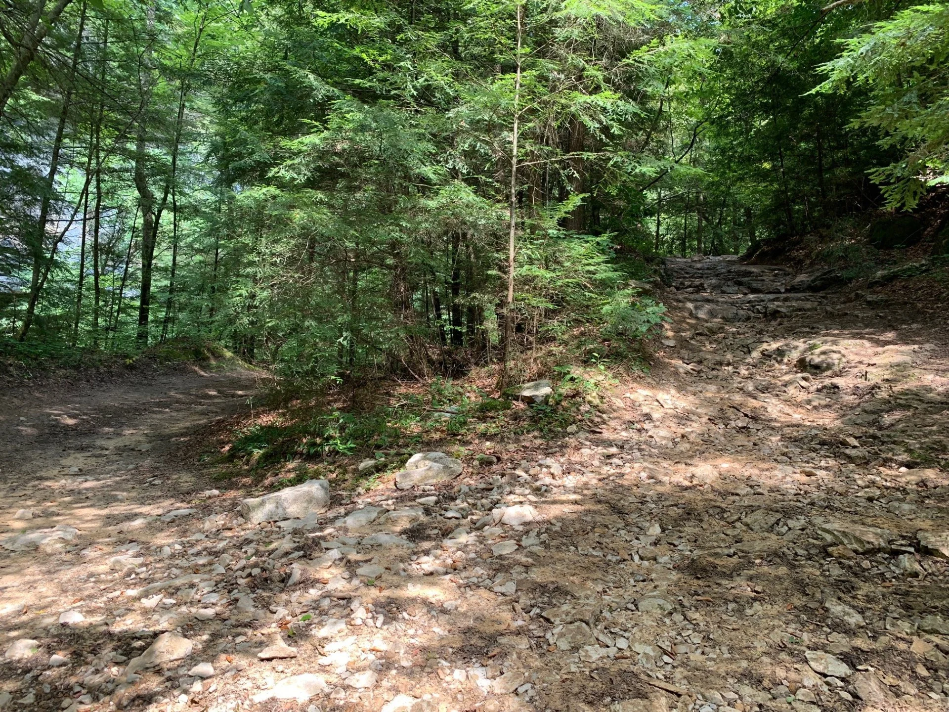

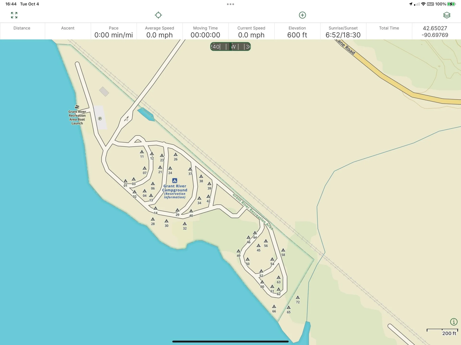

So we crossed into Wisconsin some time mid afternoon and started out on the trail, err well this portion was mostly roads. Found a place for camp on night 1 about 830pm and decided that was enough for one day.
Can you see the issue? We were at site 56.
Now? Hmmmn.

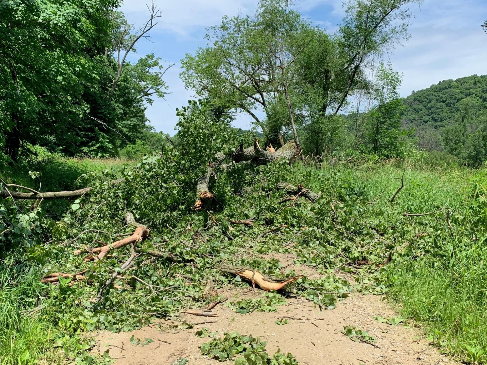

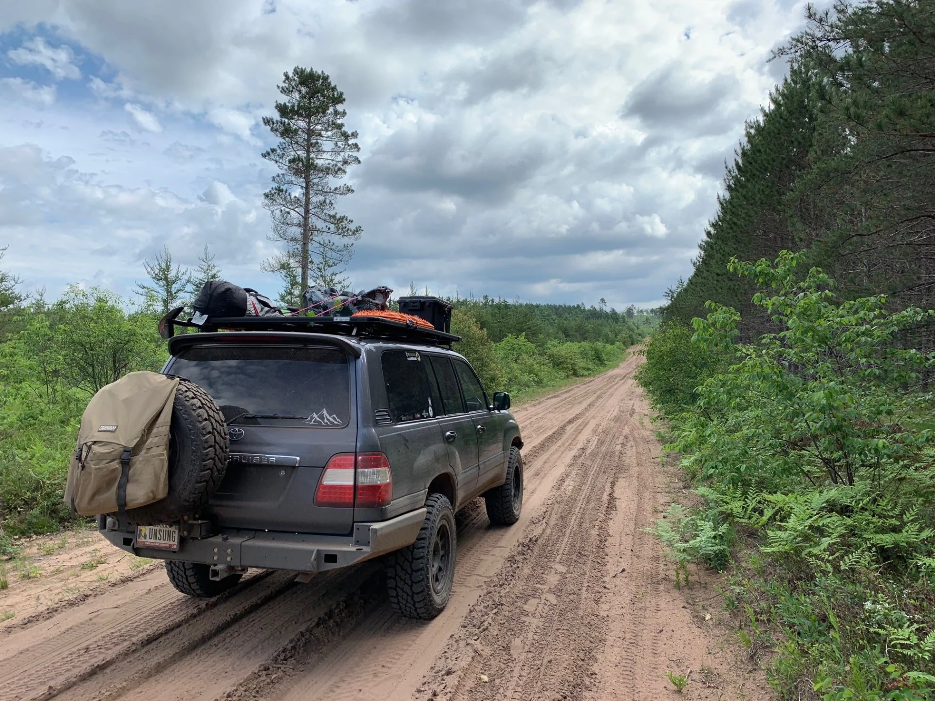

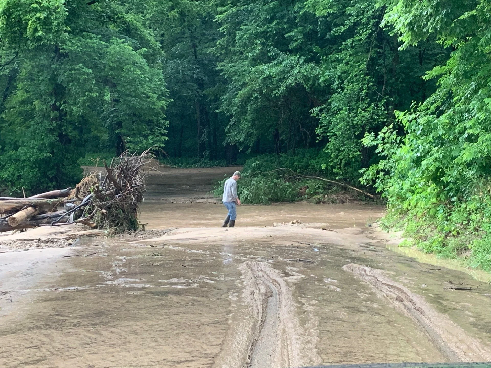

Most of that day was uneventful, and so was the next except for a downed tree that was a bit too big.

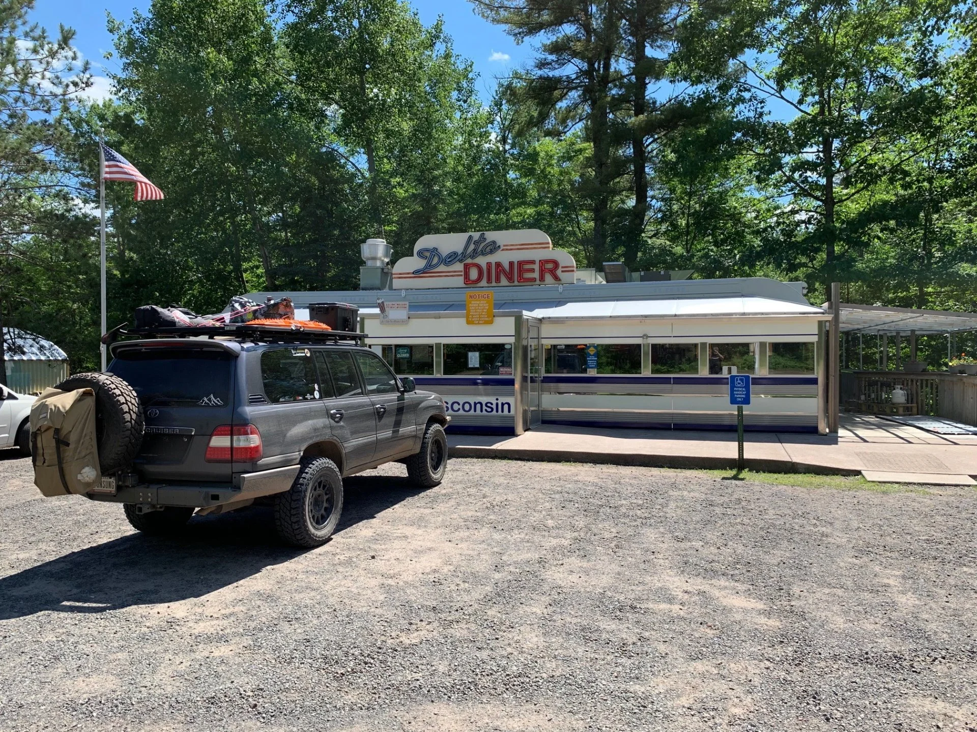

Got back on the trail the next day and hit the much talked about Delta Diner.
I don't know if it is being away from decent eating for a few days that people crave this place or what but after getting through their minimum wage speech I found it very average at best.

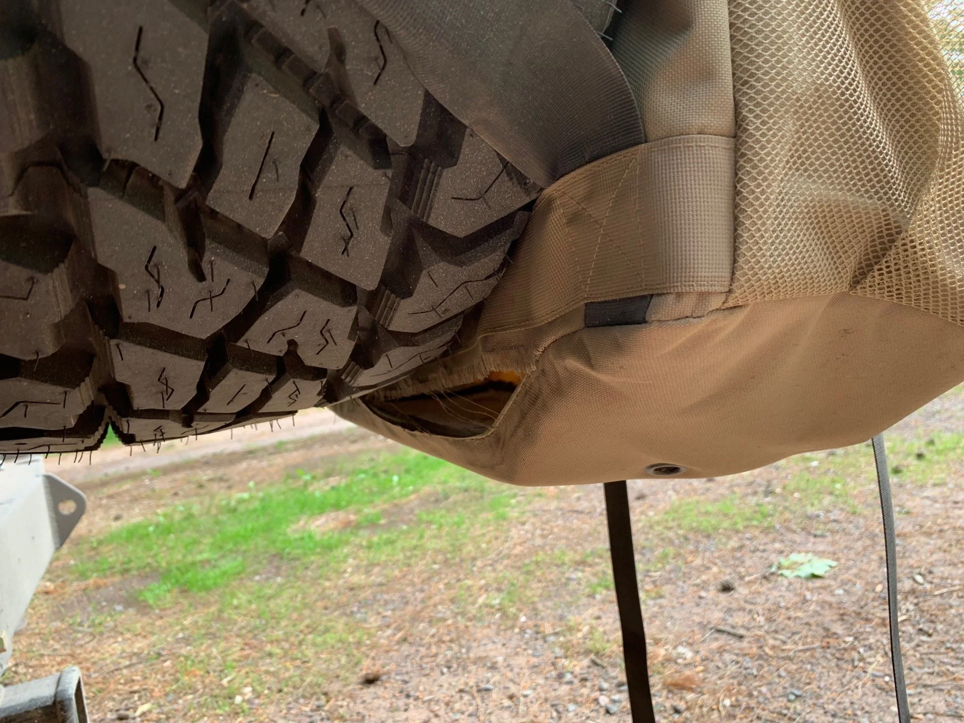

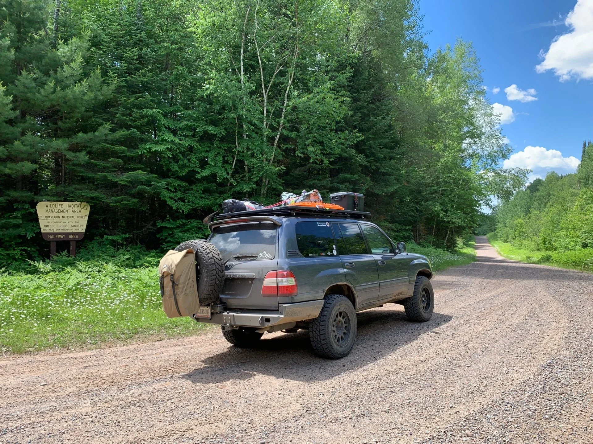

Another thing those popular spare tire bags of the name I can't recall do not handle weight well. That is from a single $5 bunch of firewood. Trasharoo, that's it.
Maybe the rain weakened it. It has since been replaced by a Northbound GARB. It is built much better.

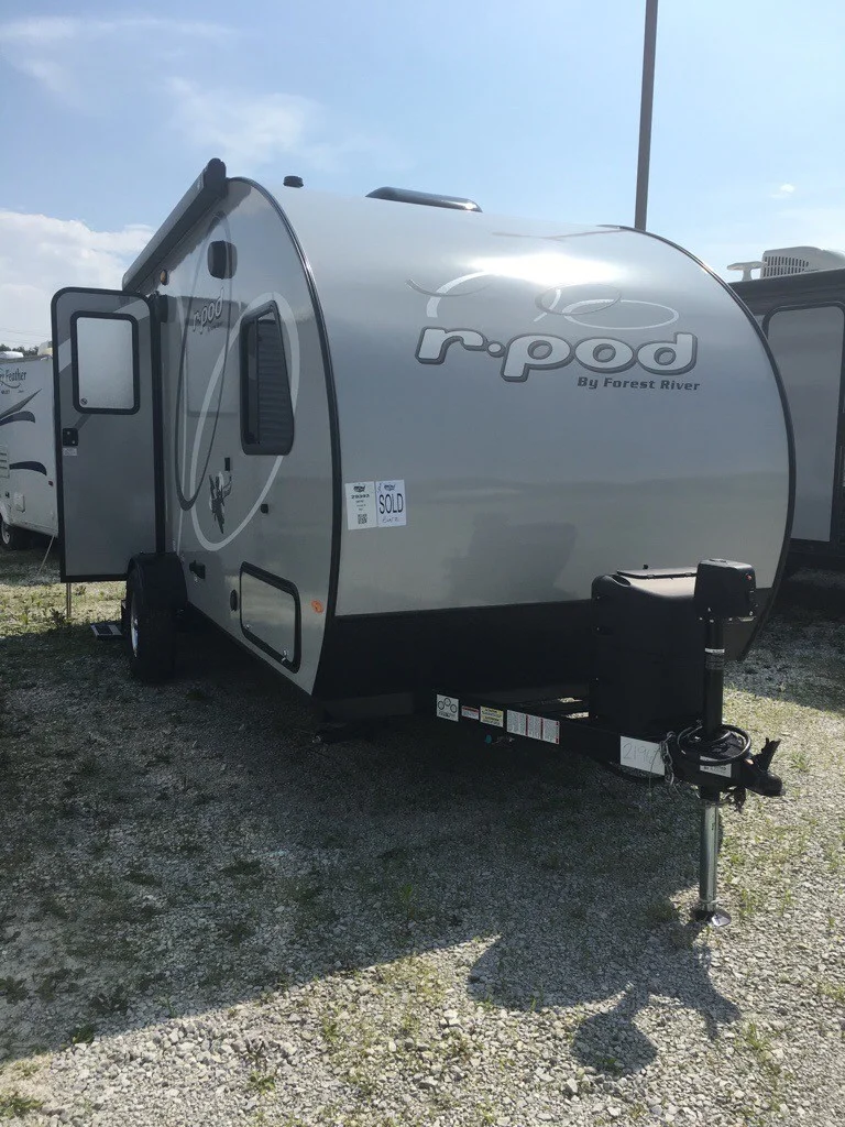

We got home and bought a camper. No more rain. A/C! Well, knowing what I do now I should have bought a Patriot or something similar.

-R&R rear bumper for proper powdercoat

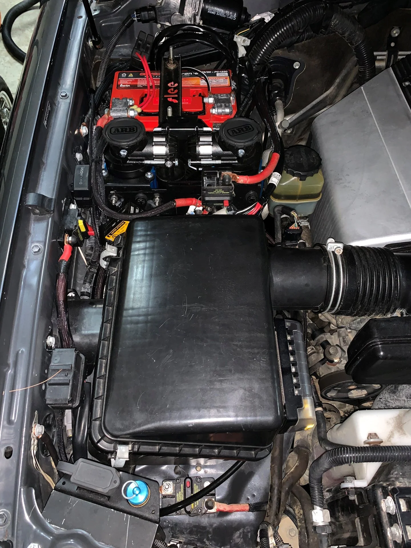

-Dual batteries

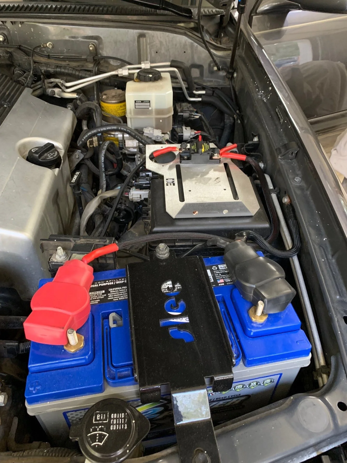

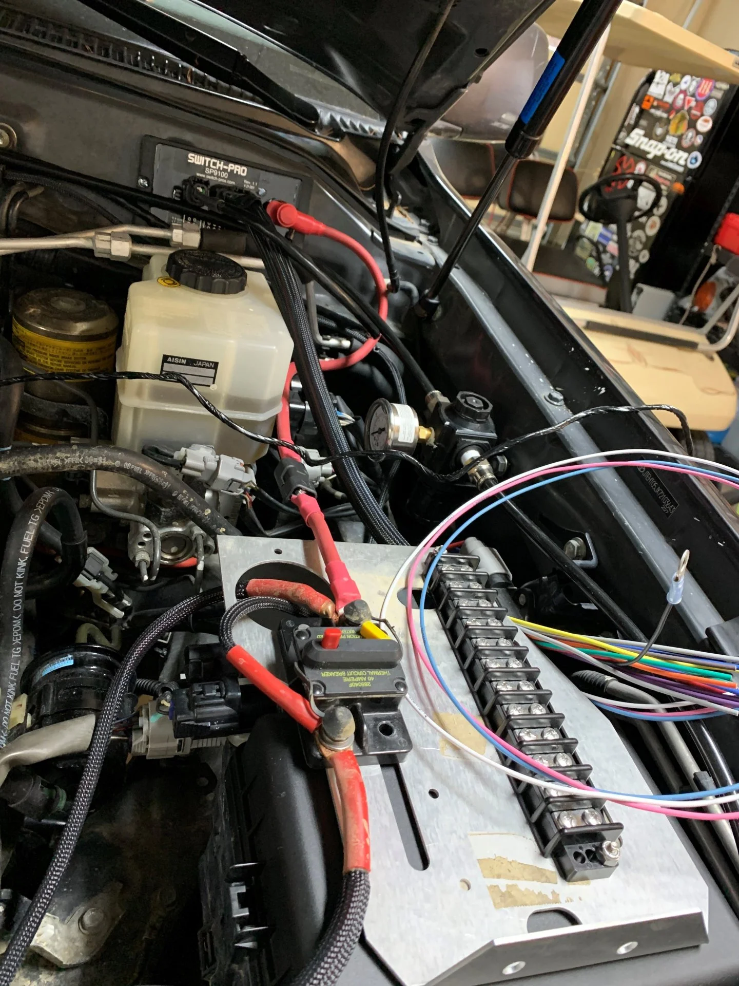

Went with Slee mounts for both the Primary and Secondary, and went with the ARB mount with the Secondary. I probably am a bit on the overkill side so everything is with circuit breakers in between. Blue Sea was my brand on just about all of my electrical devices.
Secondary with ARB dual compressor

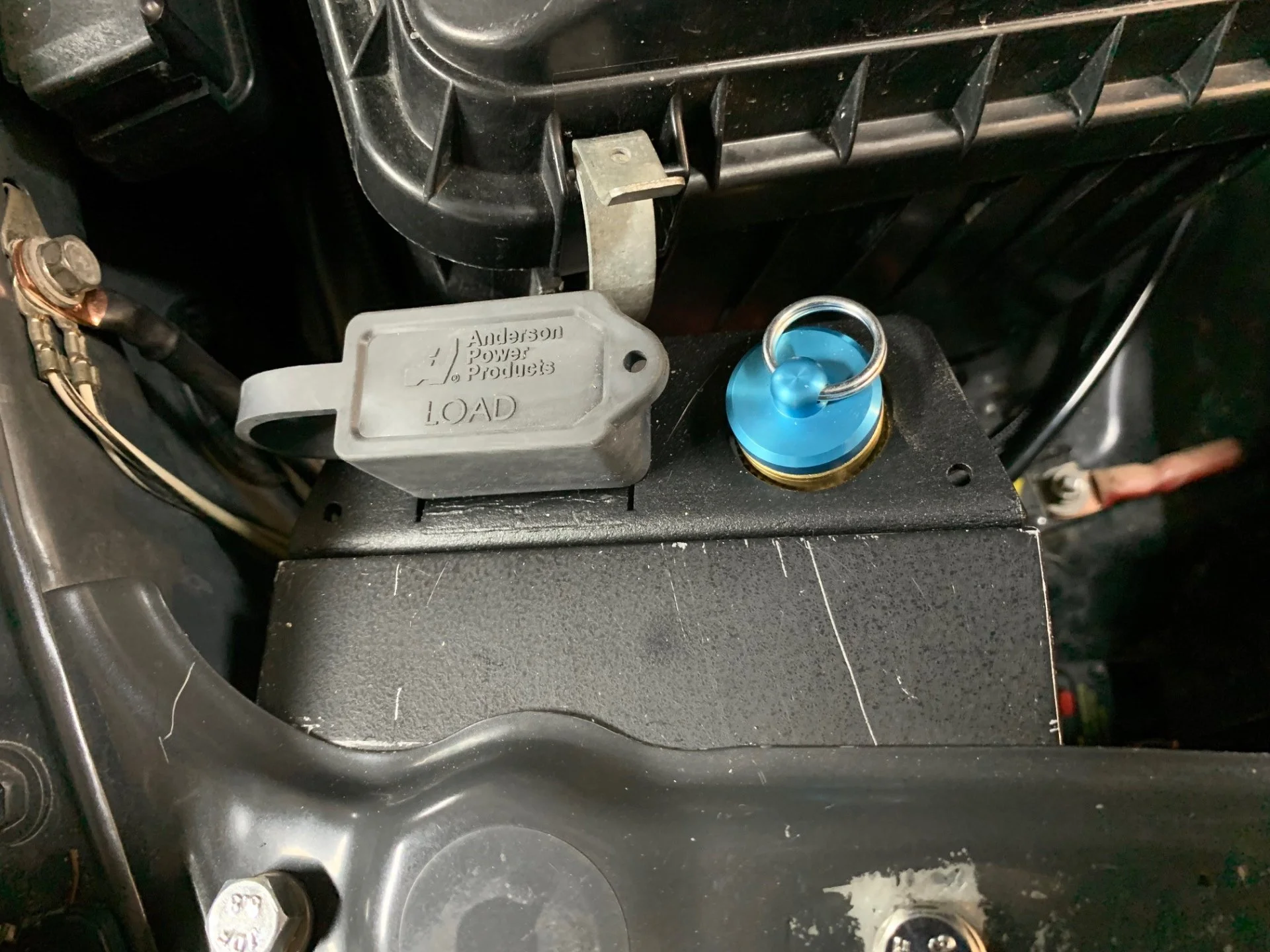

Found a spot to mount the bracket from Wits End for the Anderson PowerPole Solar Input and OBA hookup.

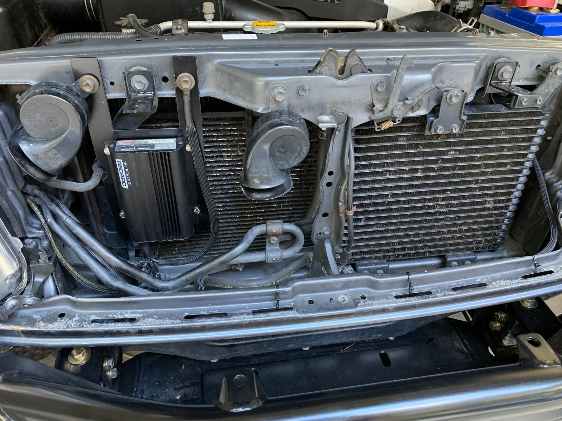

-Redarc
Made a bracket out of SS since none were available at this time for the Redarc and installed that.

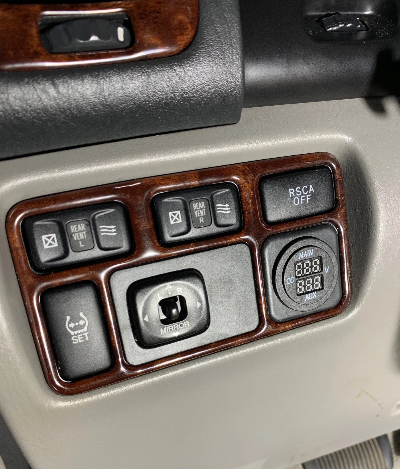

Installed a dual battery monitor. Not sure I will keep this long term, it's been on my new to-do list to replace to something else.

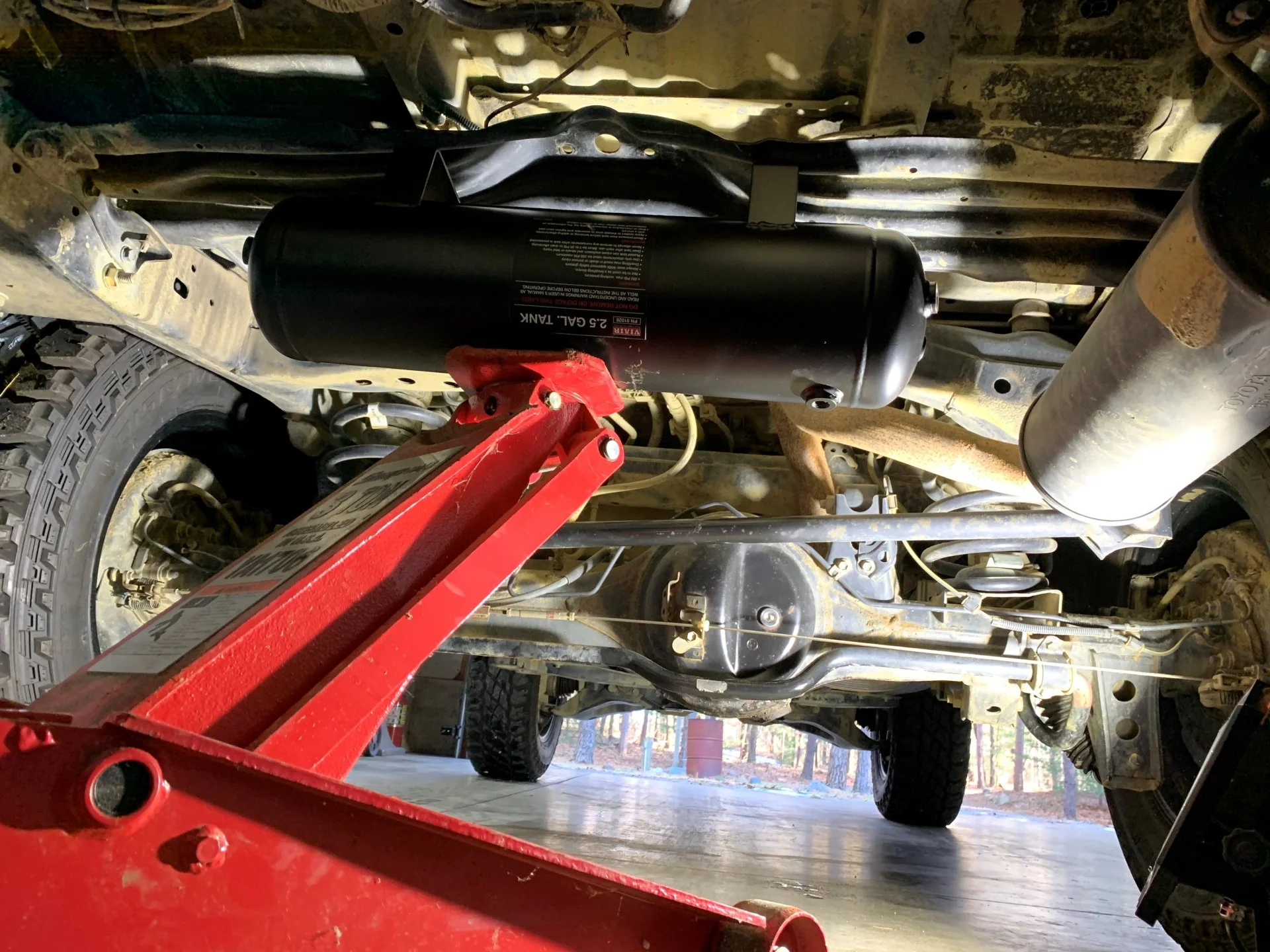

I thought I had more pictures of the OBA install but I guess I don't other than this one. The 2.5 gallon tank is from Wits End and it was a rush install so it is something I need to get back to at some point. It isn't heavy, I just needed a third hand hence the jack. I mounted it to the spare crossmember which doesn't have a level mounting surface anywhere on it, but I was running very short on time at this point and needed to just get it functional. It has worked perfectly actually and I did forget up until now that it was something I needed to revisit.

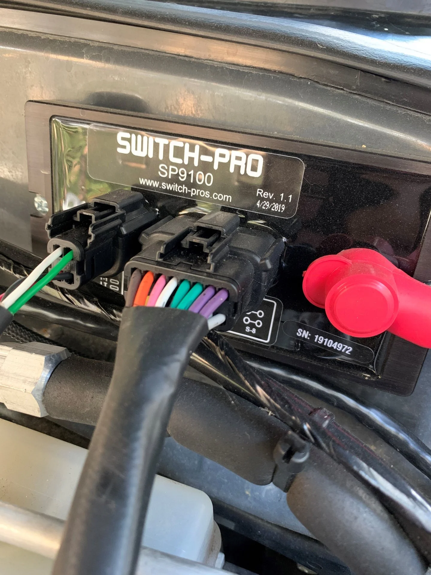

Here's one of the regulator on the right. Also shows where I mounted the Switch Pro to the firewall.

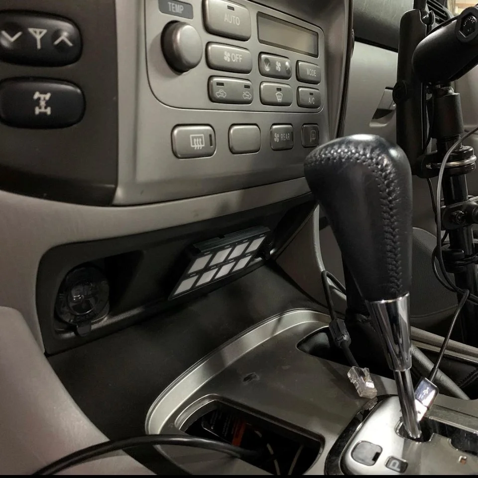

Here is the actual 8 button switch. I don't smoke so I removed the ashtray panel and replaced it with the non-ashtray Toyota panel. Conveniently it has two ports for the BlueSea USB dual chargers with some unibit work. It is showing as NLA but the number is 55413-60130.
View attachment 3131794View attachment 3131795View attachment 3131796View attachment 3131797View attachment 3131798
View attachment 3131810View attachment 3131811
Where do you source all the parts for this? do you have a parts list? I always want to do this but some of the parts are not available.
Great write up. I like how you went from changing the nav, to exposing every wire in the interior of a 100 series. I would love to tackle the nav delete/replace, but I’m very intimidated on gathering the parts and installing, and having my hvac work. How difficult was it all in all? Thanks! Also… mine is an 07 galactic aswell! Great taste.
Thanks!.. It really wasn't too bad, most questions have already been asked in that thread, but yeah the parts chase I have heard is a bit more difficult due to some NLA parts. When I was buying the only NLA was the preferred bracket set so I just found someone had posted an alternate version.
One of the reasons I took that path was to move to a more traditional button/knob HVAC control system and not rely on a screen.
I haven't kept up with that since I completed mine a few years ago but I did use partsouq and amayama for a couple of pieces. There is also a parts thread on the 100 forum that might help.
