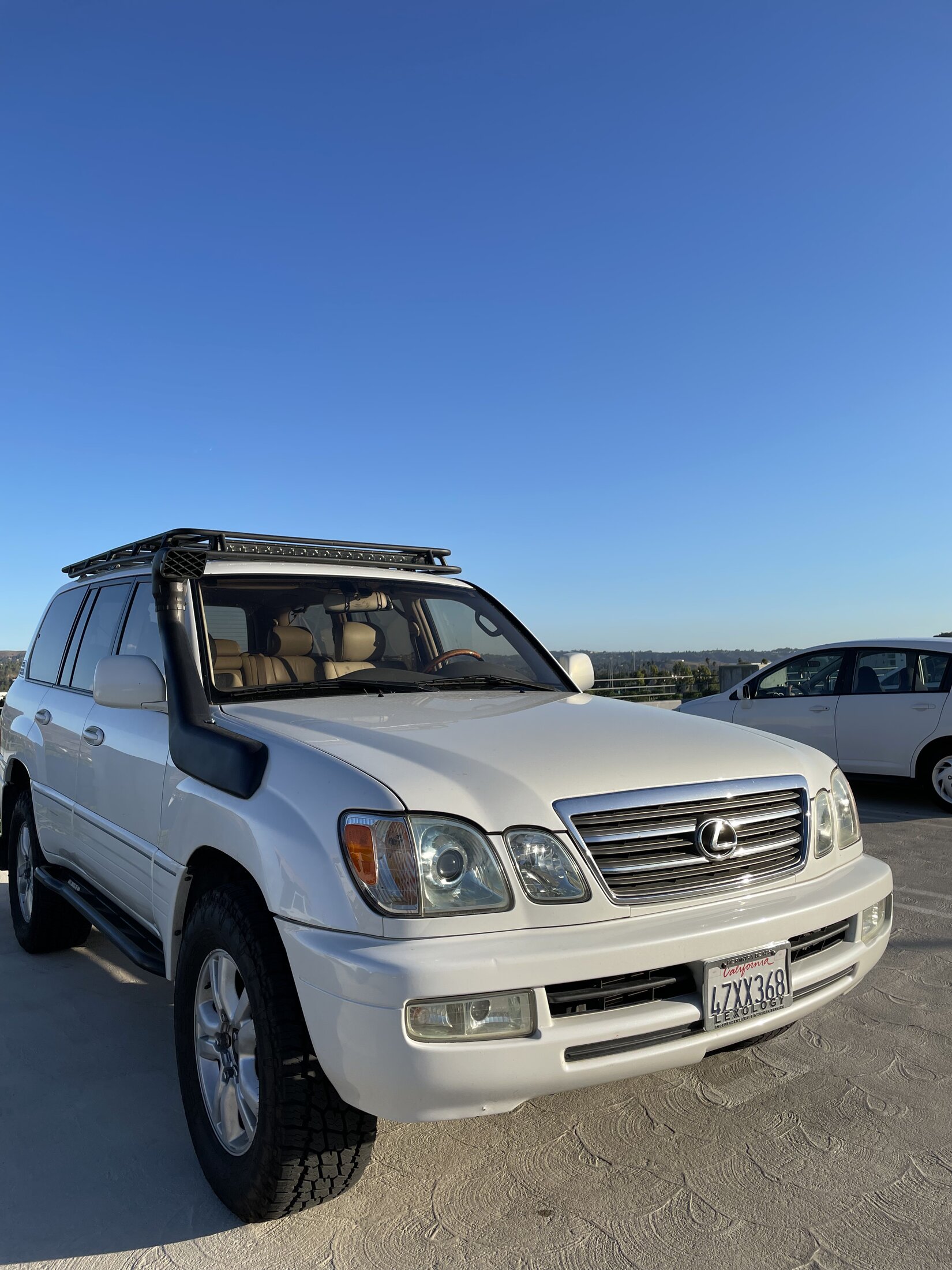

I am going to try to retroactively post maintenance items and such when I did them. Here are some pics of it when we first purchased it.
2003 Blizzard White

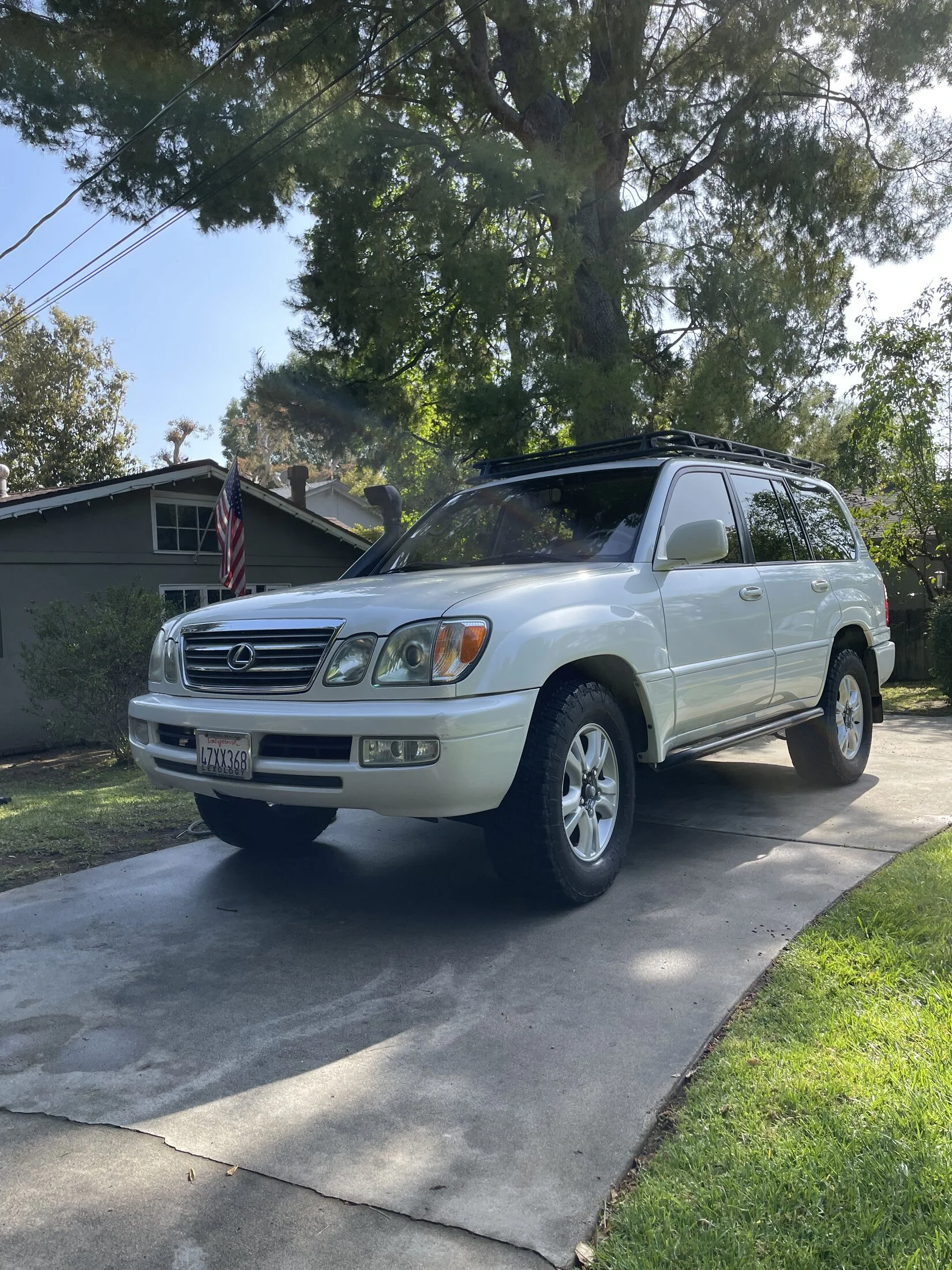

This past week, I used my 100 Series to tow a couple of rotor-tillers and pallets of soil to rebuild our backyard.

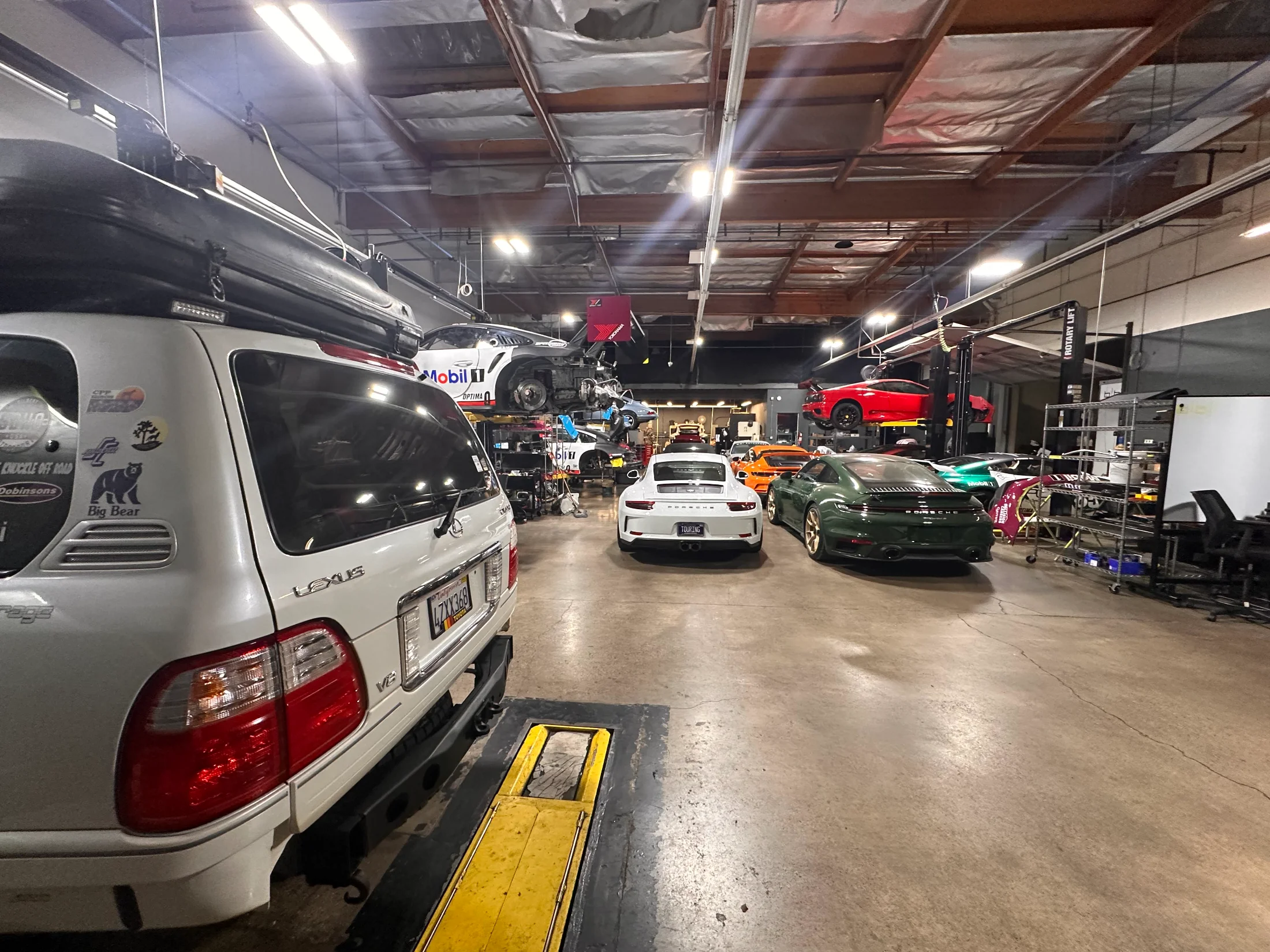

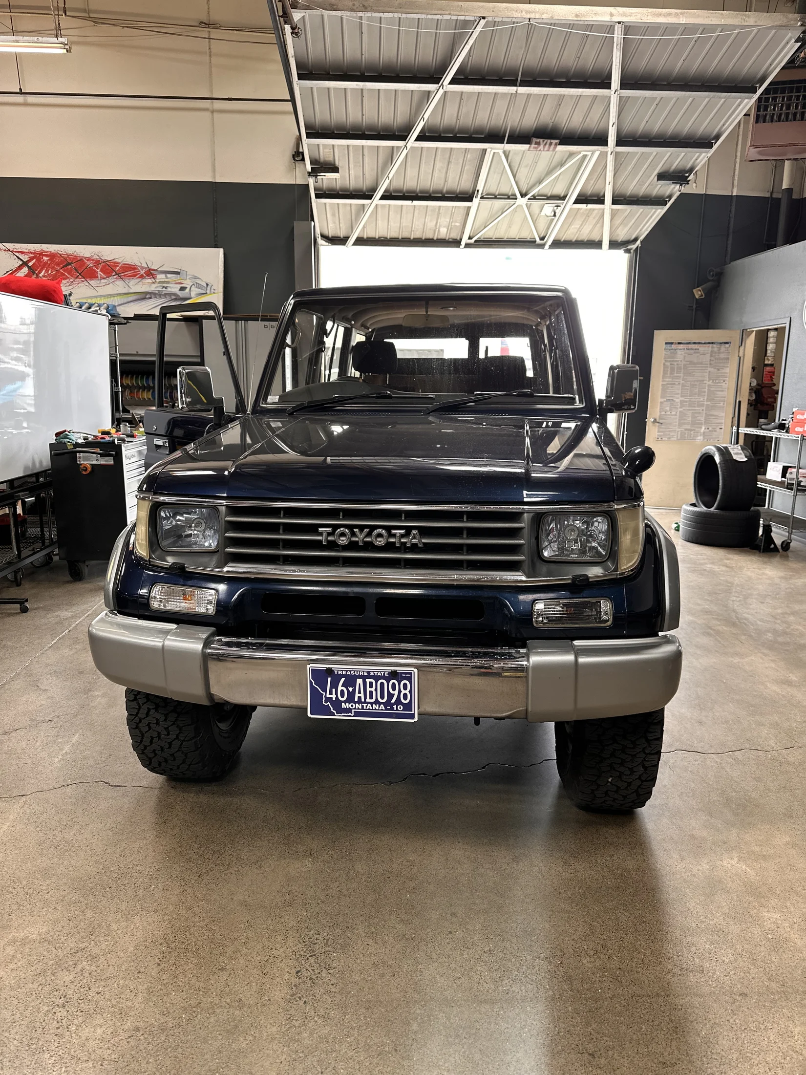

PS, there was a mint 70 Series at the shop as well.
Uuuuuuuuhh, you can't just drop that shop pick, and not address it. :rofl: Do you work at BBi? Sorry to go off topic, don't want to derail your build thread.
