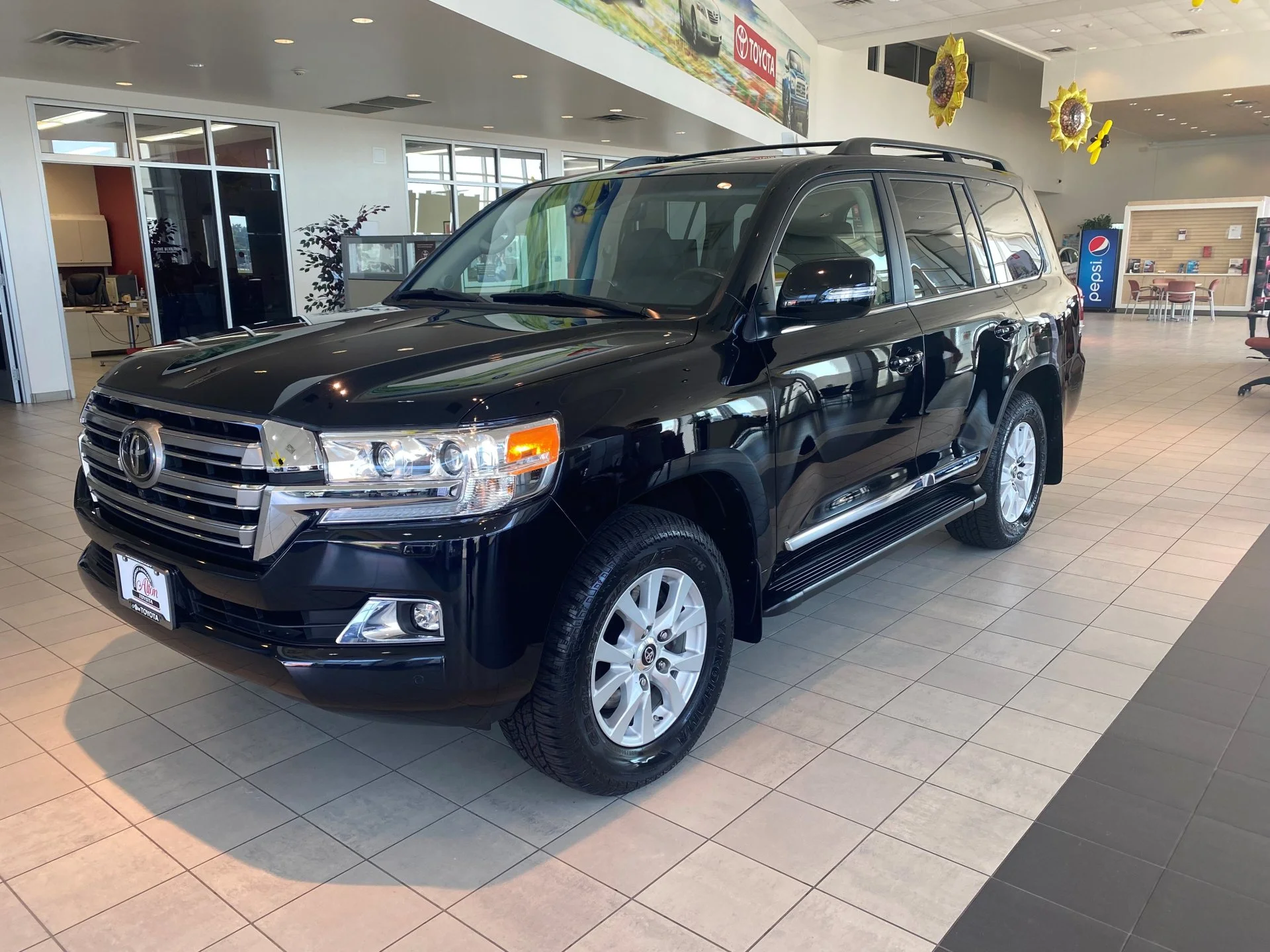

August of 2021 I picked up a nice 2017 200 with 32k miles, it has remained stock for now as it is my wife's Daily driver.

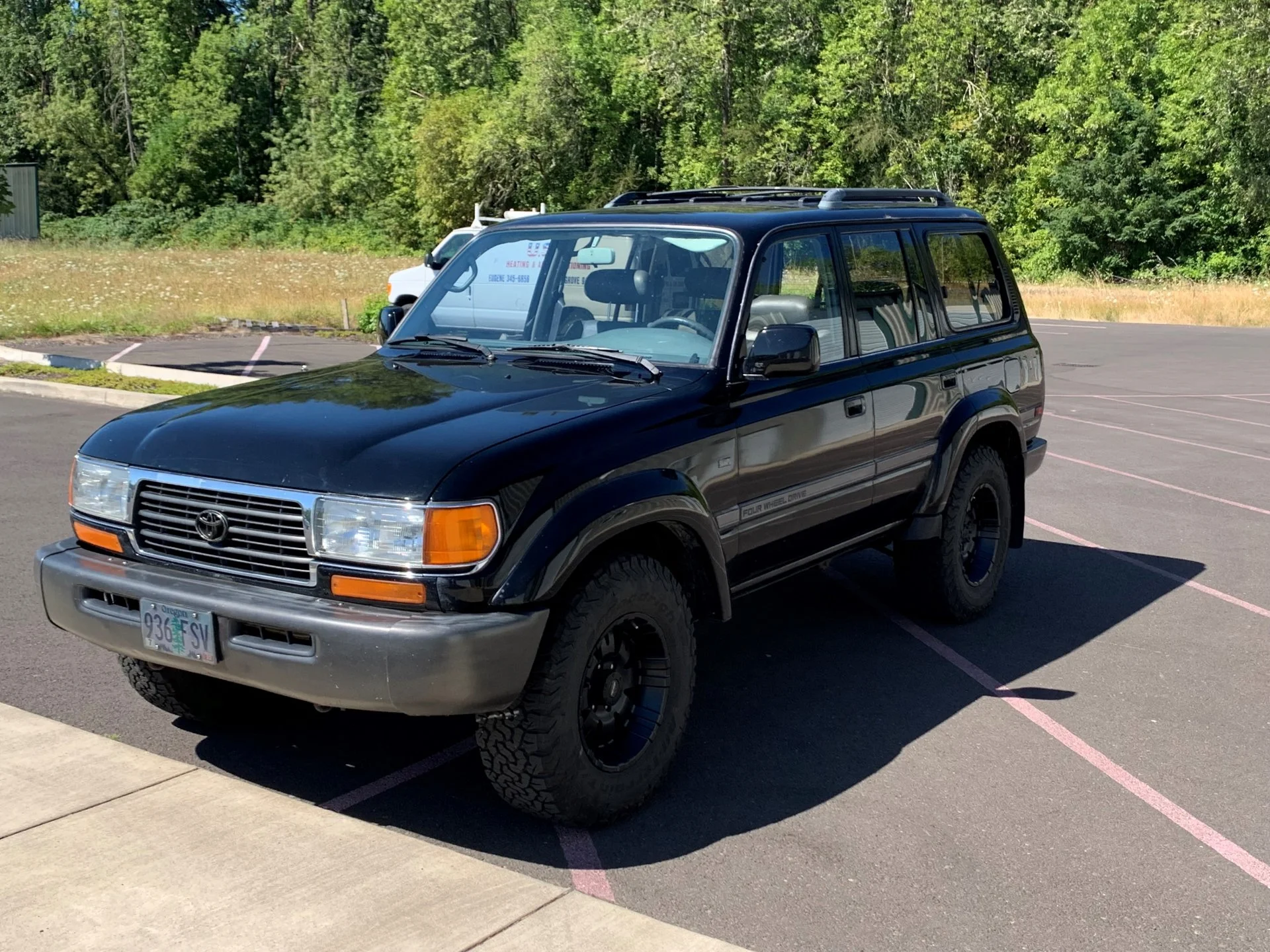

The 80 bug never went away especially since a lot of the guys in the KYTLCA have 80's and I have gone down there for a few events around the DBBB. It somewhat made sense that my 100 wasn't exactly made for some of that plus since that was really almost done I needed something new to go after. My one sticking point was finding one with gray interior, not tan. I also wanted either a black or gray exterior. Randomly I found one on here, flew to Oregon to check it out, and had it shipped back.

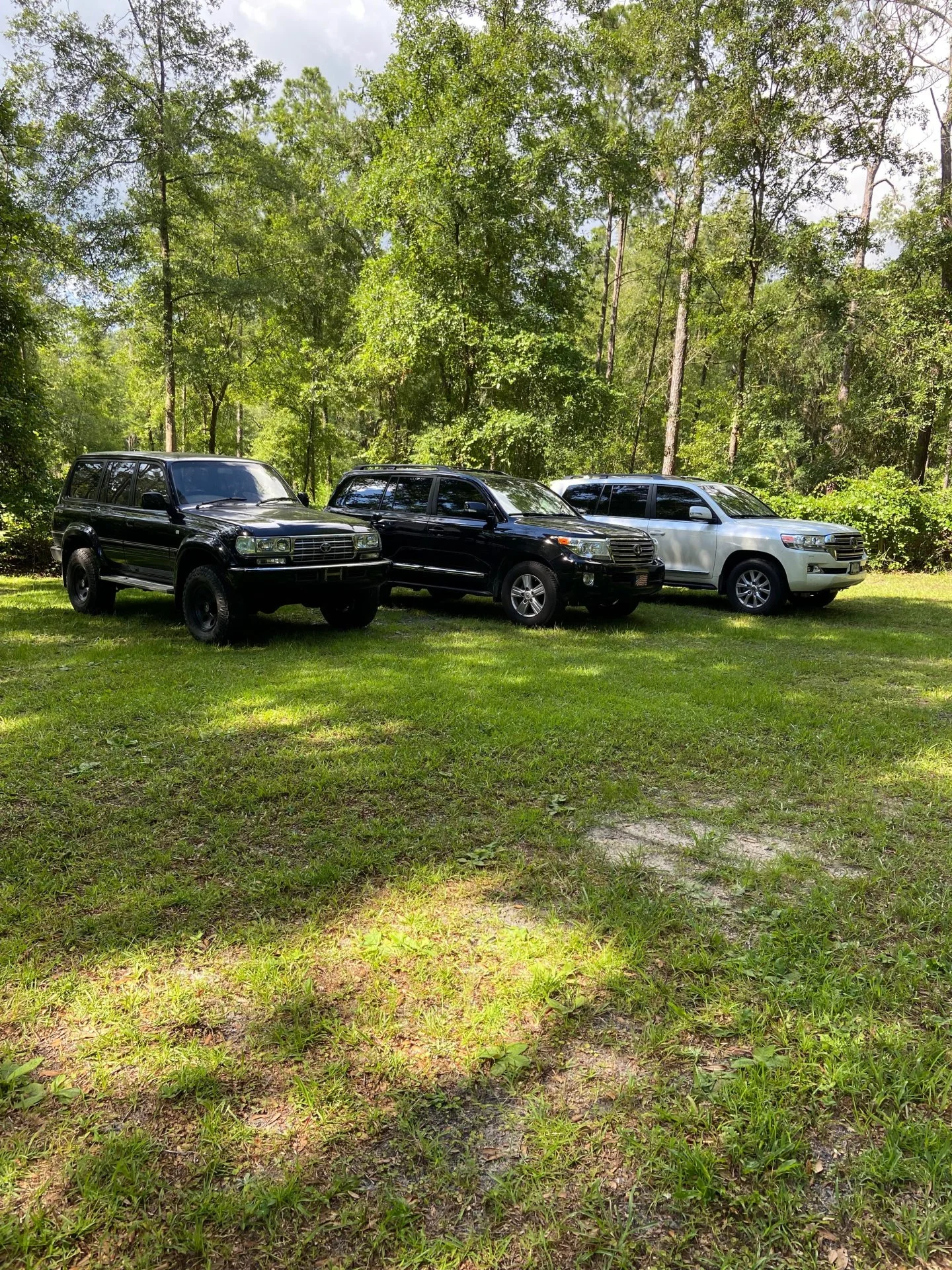

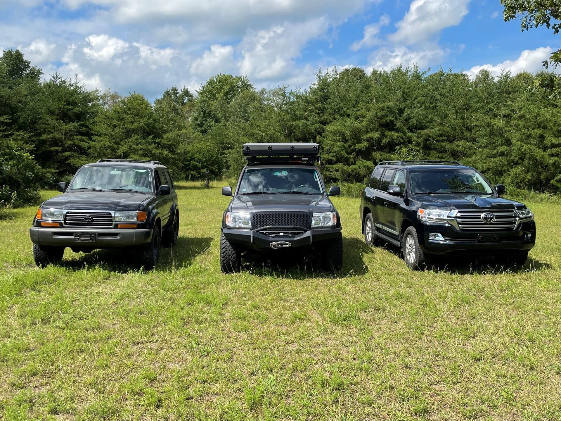

Here is the 80 and then the other two...I still own all three.

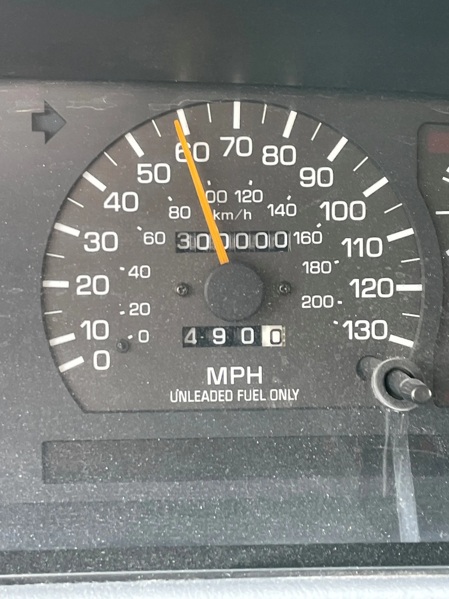

It just turned 300k miles, and I knew an engine rebuild was going to be a sooner than later thing so I have started to ask around about that. Surprisingly I am not having a lot of luck in getting a response from some vendors, I guess I'll revisit that later then.
