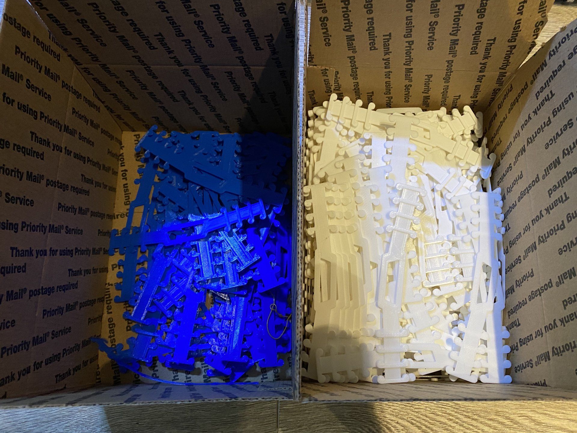

Have been making these facemask straps. This is a donation of 500 pieces. It took four printers 3 days.
It is for people who need to wear facemask for extended time during the work. I am thinking to throw in a couple of pieces in each future orders.
Thats awesome Ben and thanks for making these during these trying times. I am sure that people that receive them with their orders would more than appreciate them and use them.
