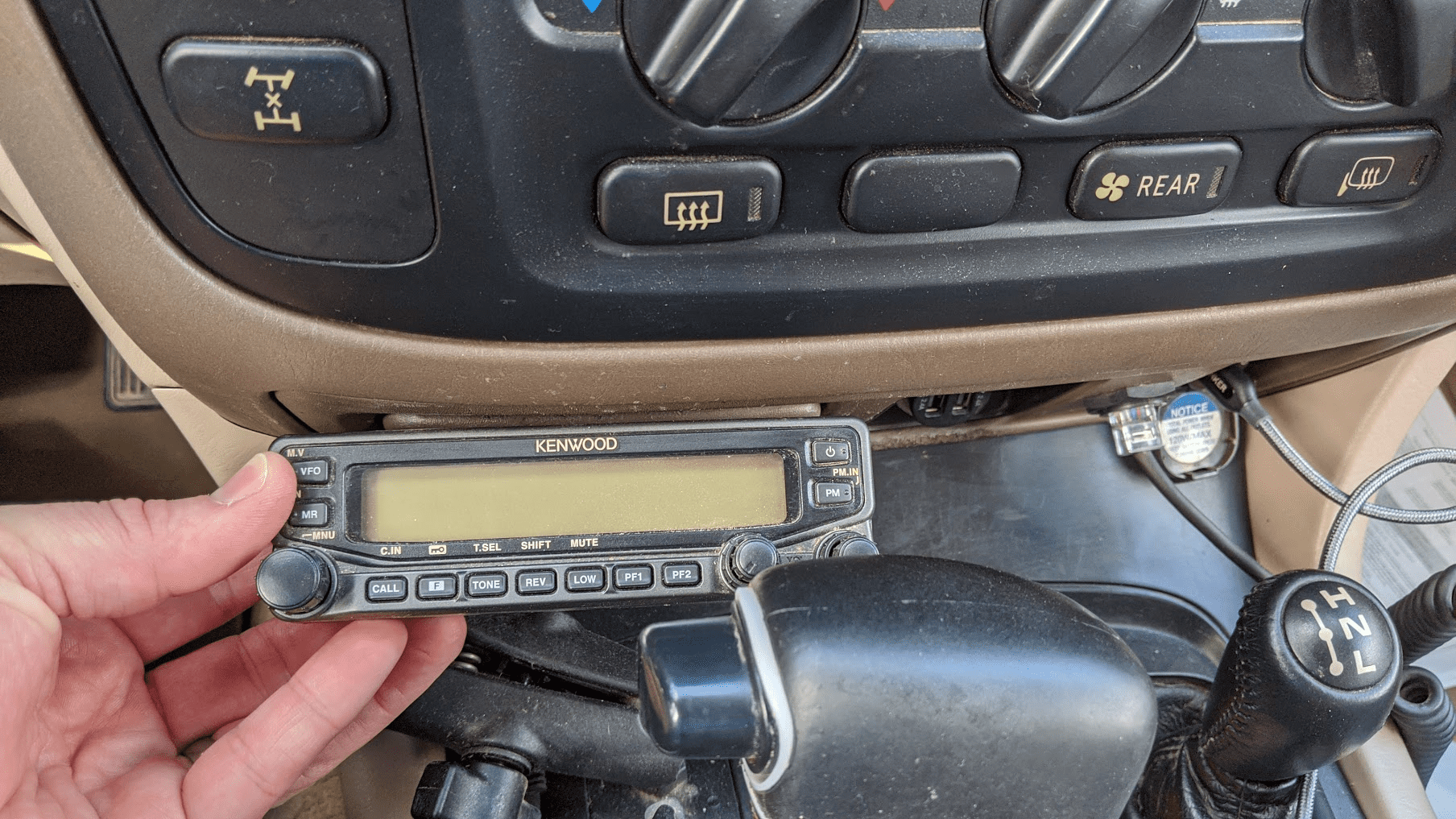

As you are working on the ashtray replacement panel, could you see if fitting a mount for the Kenwood 71A head (like you did for the overhead console) would be feasible? I have mine mounted via a RAM mount and like to rest my palm on the shifter to poke at the buttons on the radio, but it would be great to clean up my center console area.

Once I got the panel fitted, mounting scheme is customizable. That is definitely a good place for radio control unit.
