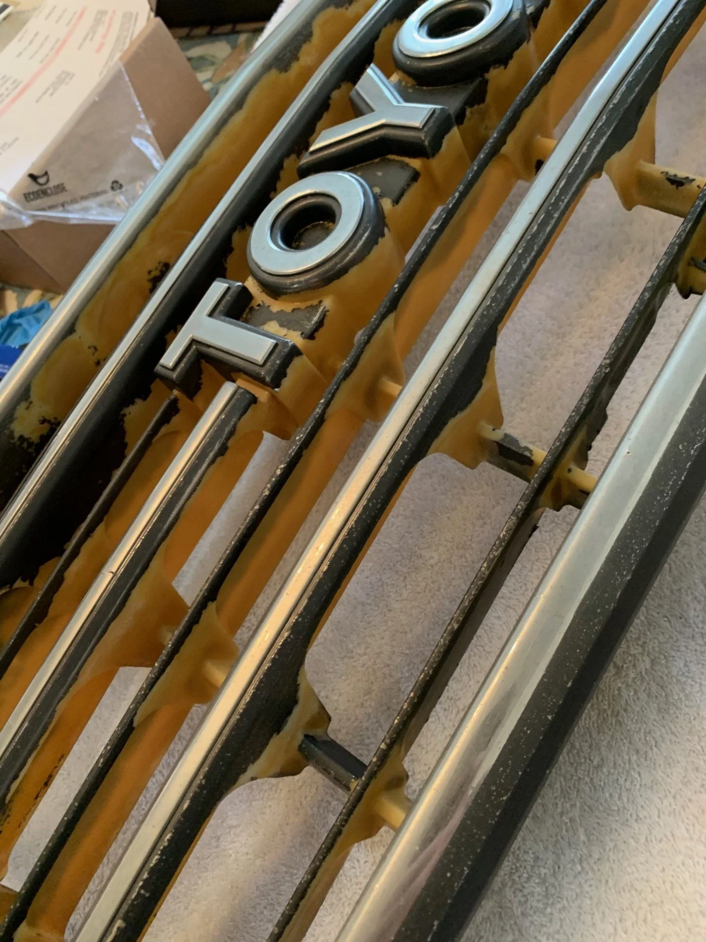

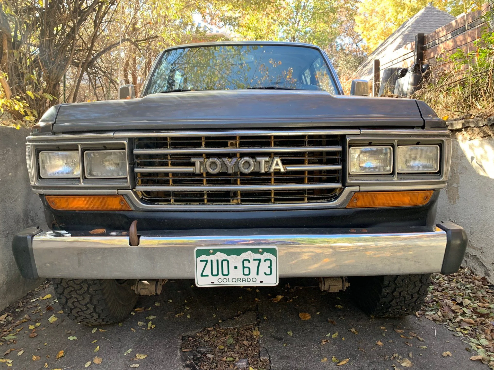

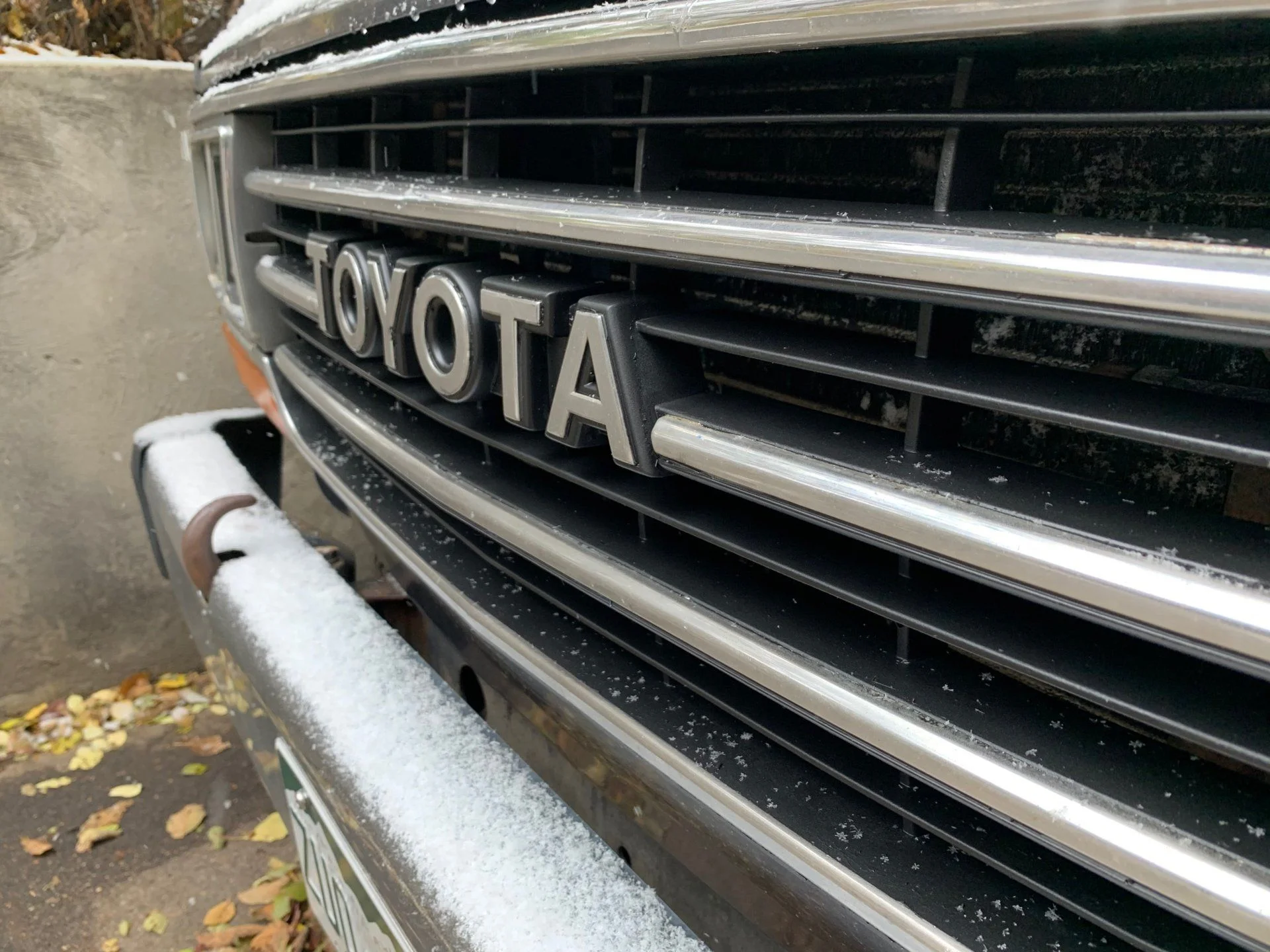

Also, my grill chrome had mostly flaked off to exposed plastic (see below). I looked into new grills and, seeing that they were a few hundred dollars, decided to try to just paint my own using this painting grill thread cause I figured even if I destroy it I can just buy a new one anyway. So, I pulled the grill, degreased it, scoured it, and prepped for paint. I wanted to keep the chrome lettering and main horizontal lines, both of which were intact, and do black plasti-dip behind the chrome. So, I decided to tape off the intact lettering and chrome. Big mistake. What I should have realized was that plasti-dip is made to peel off, so when you peel the tape and have painted over the tape, it forms a layer of plasti-dip across it and pulls at the tape lines, leaving jagged edges. Maybe there is a way around this, but my tape lines kinda look like trash. Since you can peel plasti-dip, I took a razor after and tried to cut clean edges after the fact, but they still don't look great. I also didn't scrub down the chrome flaking enough because the dip texture is a bit rough in spots.
Before the paint:
After (yes, it started snowing as I was doing this):
Detail after I pulled it:

It's a five footer for sure, looks good from over 5 feet but when you get up close, not so much. If I ever sell the truck, I will likely just buy a new grill and headlight housing. Also, while pulling it, I realized one of the headlight housings was cracked and will need to be replaced anyway. Plus I lost 2-3 clips pulling it and somehow ended up with an extra screw in the process, because of course I did. All in all, at the end of the day I'd say its a slight improvement though. Especially cause it's my current dd and will be in the foreseeable future.
