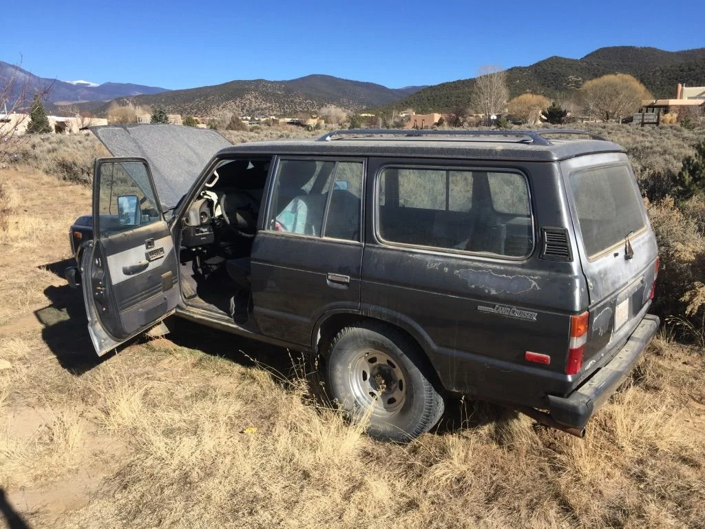

Below is the car as I found her, after filling the tires. It had basically just been tenement housing for mice for years at this point, and we used a compressor to spray out a graveyard of carcasses and years of mouse poop. Dust is everywhere on the interior and exterior, but other than that the interior was in decent shape - the PO threw a sun visor in the windshield and an old sheet over the seats, so everything is pretty intact except the tops of the door interiors which are all cracked. The dry NM weather took care of the body - this truck has minimal rust.

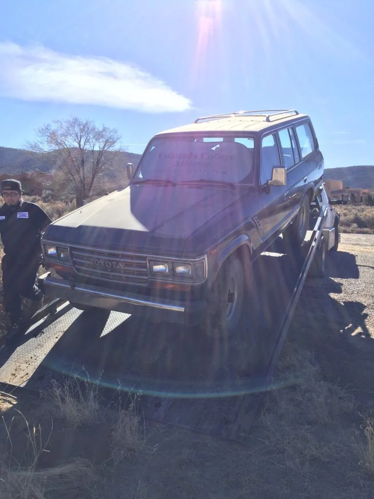

Up on the flatbed to the new home:
Grey Lady was officially mine! Now to figure out why she wouldn't start... the previous owner doesn't remember why he parked her in the first place.

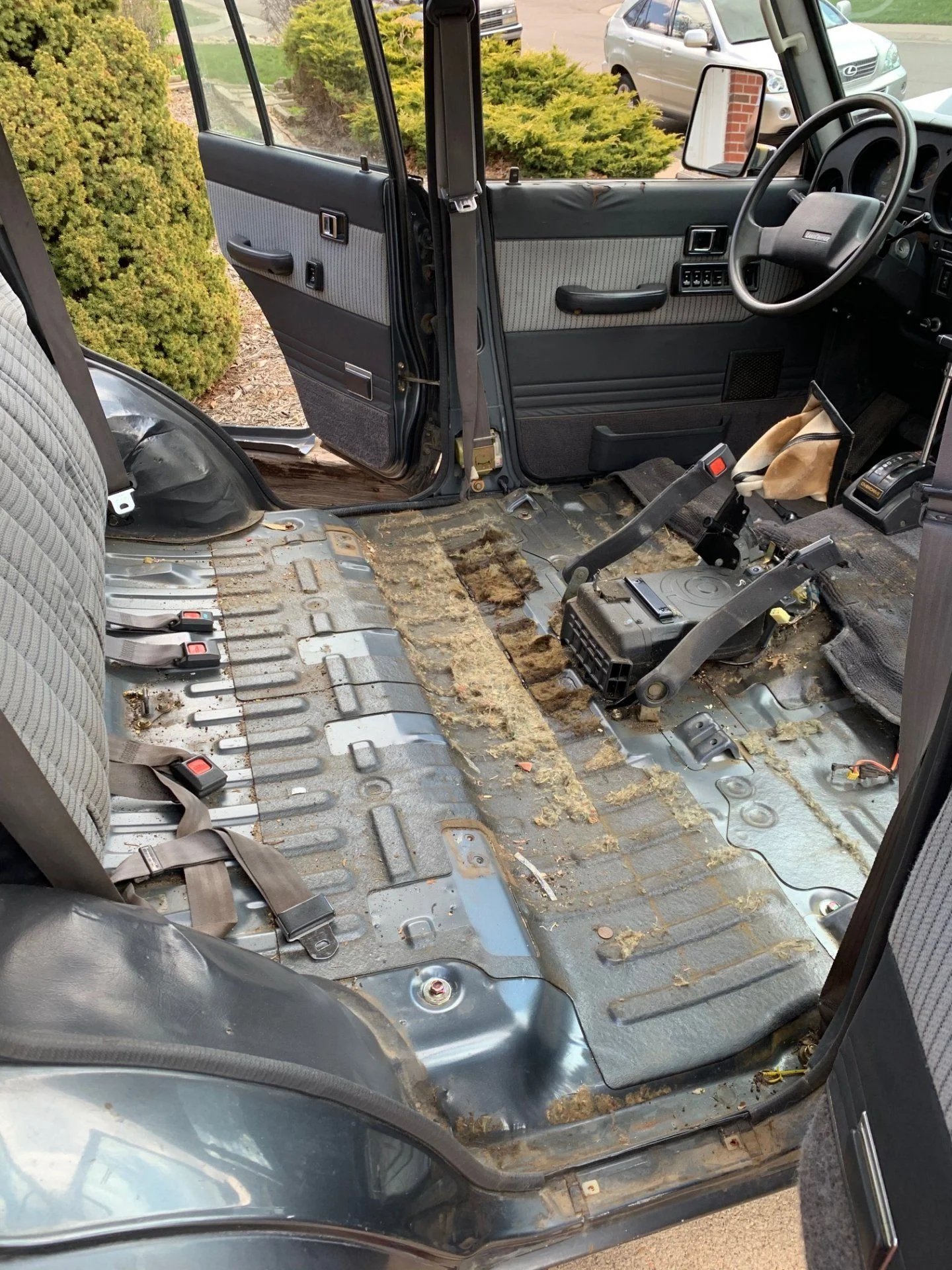

COVID has finally got me working on some FJ projects! Finally got around to ordering and installing carpet from @dnp. The results came out pretty good. I found a guy that said he could do the install for $100 and in retrospect, I should have done that. But now I know how to change carpet in an FJ, so I guess that's cool!
Nastiness:

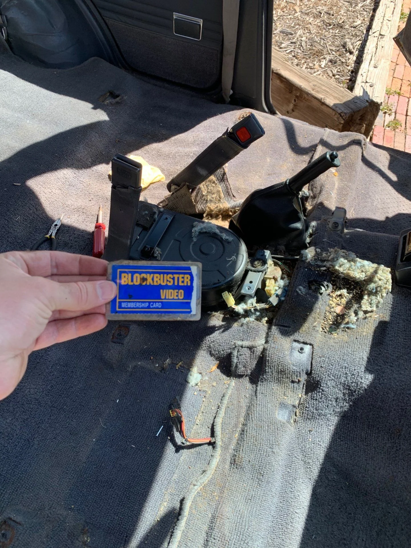

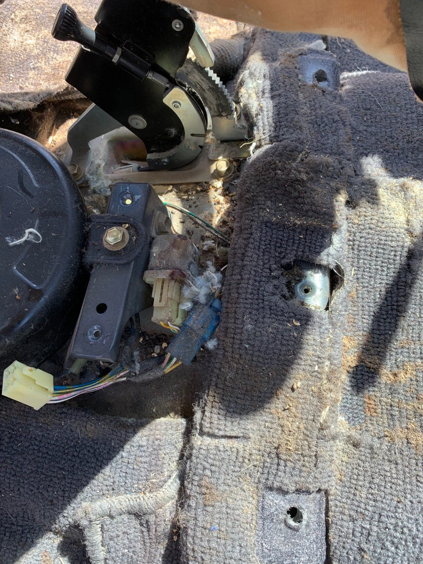

Its clearly been a while since this thing was properly cleaned out, as evidenced by the blockbuster card found under the center console. The PO is a friend of mine and they did not know whose this was so it must have been in there for a while. Also, notice the full blown mouse hotel under where the console was that I've been driving around with:

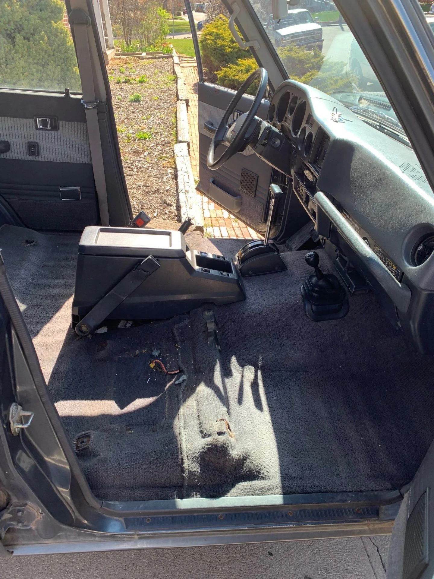

Progress:
Admittedly, the old carpet wasn't the worst. I did a pretty good job cleaning it up after I got it. But mice had been living in it for so long it had a certain musk that I was getting bored of living with. The new carpet took me most of the weekend to install, I definitely didn't get the trimming perfect for the door jambs and transfer case, and its a bit baggy in areas, but it is finished and smells way better!

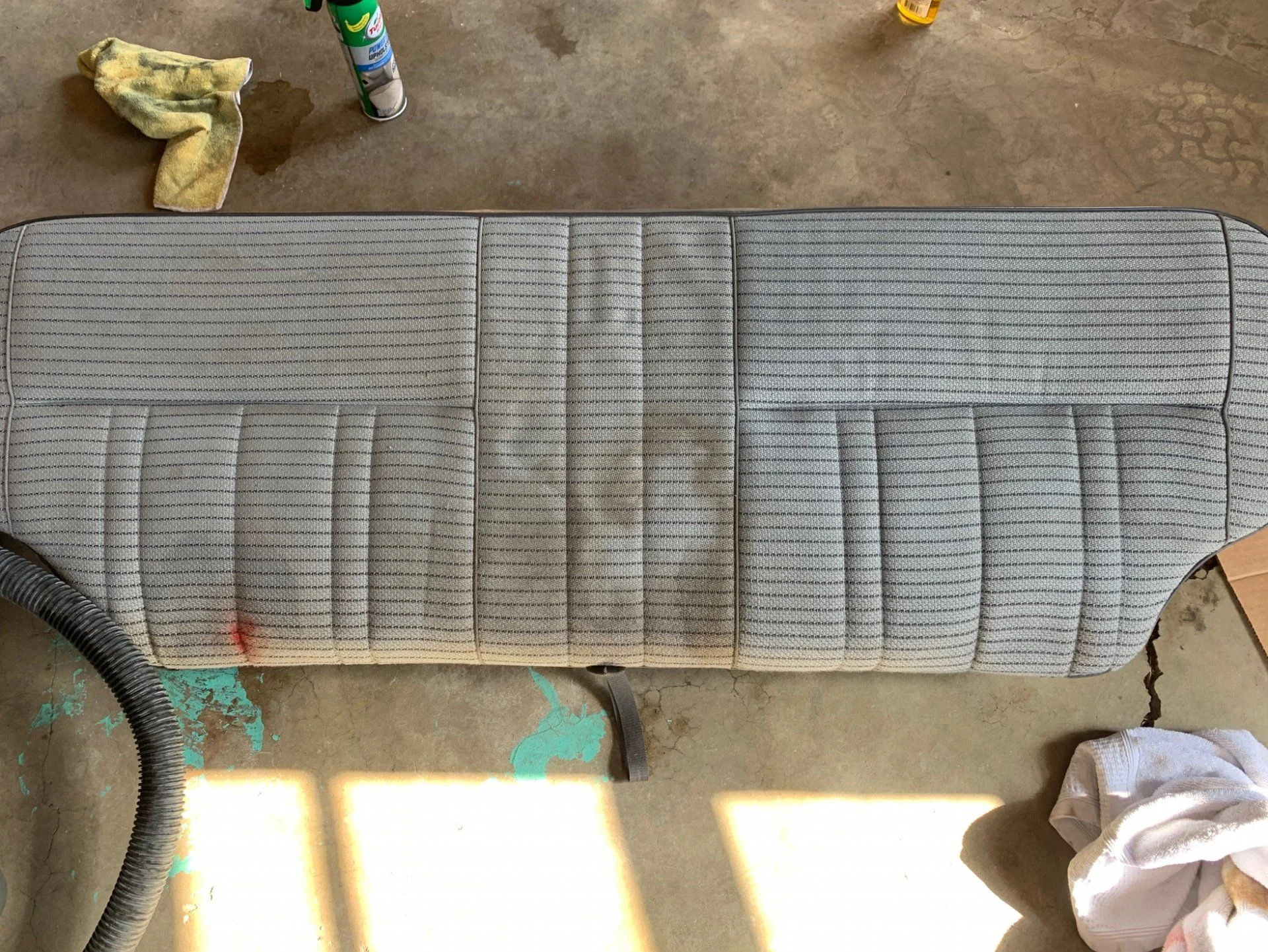

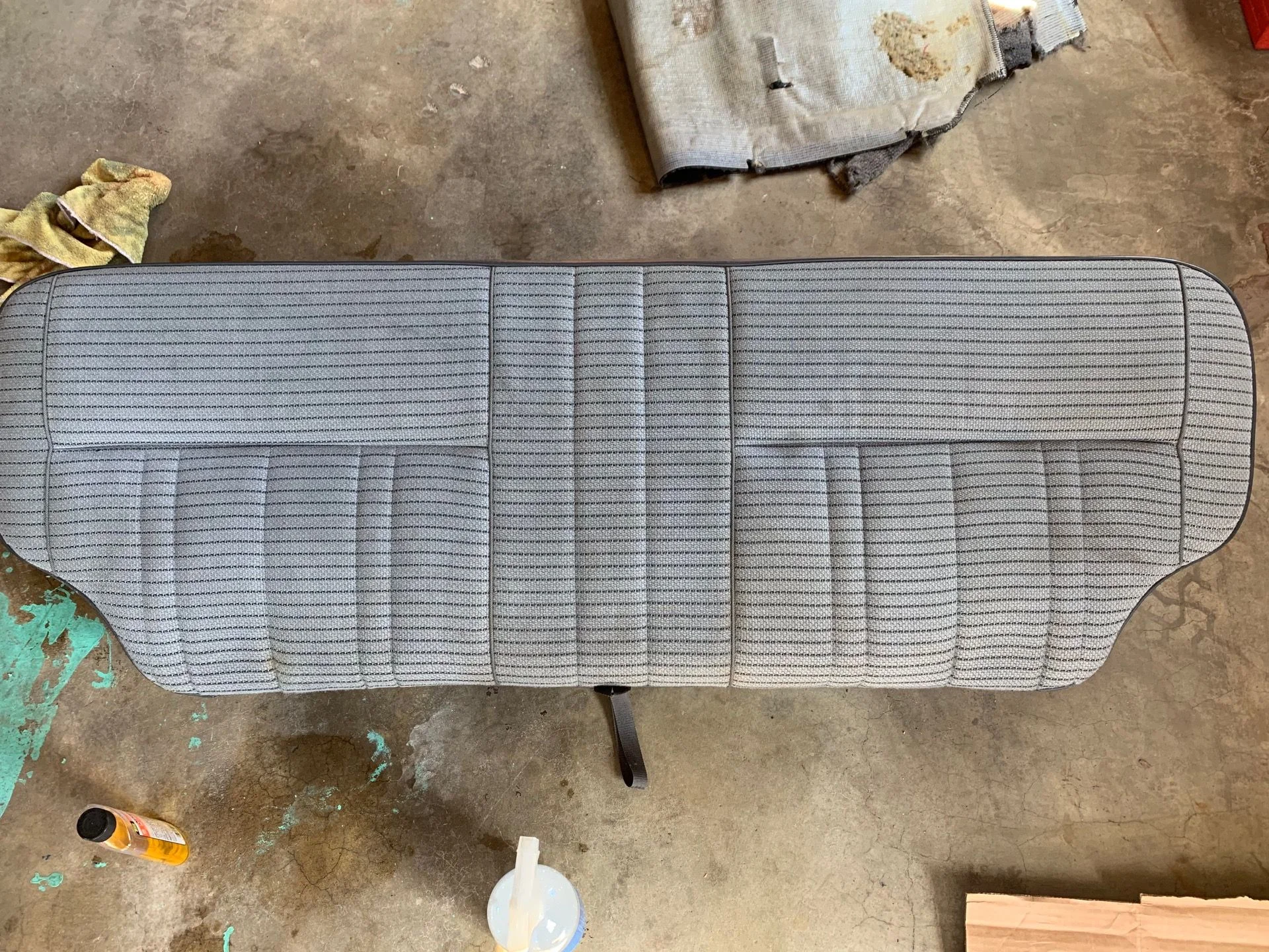

While I had the back seat out, I decided to try to do some work on some of the stains. Not perfect, but definitely an improvement. Old seat:
And the improved:
Way better. I used a combo of dish detergent, vinegar, and warm water, and some random turtle wax cloth interior cleaner that I had. Did a lot of spraying the warm water/soap solution and shop vacuumed it out. Still can be cleaner but I am happy with the results for using stuff I had lying around the house. Also, quick shout to @RodrigzCrzr - I now have a rear tailgate card and installed the carpet on the rear tailgate so I can have a proper spot to comfortably sit and have a beer.

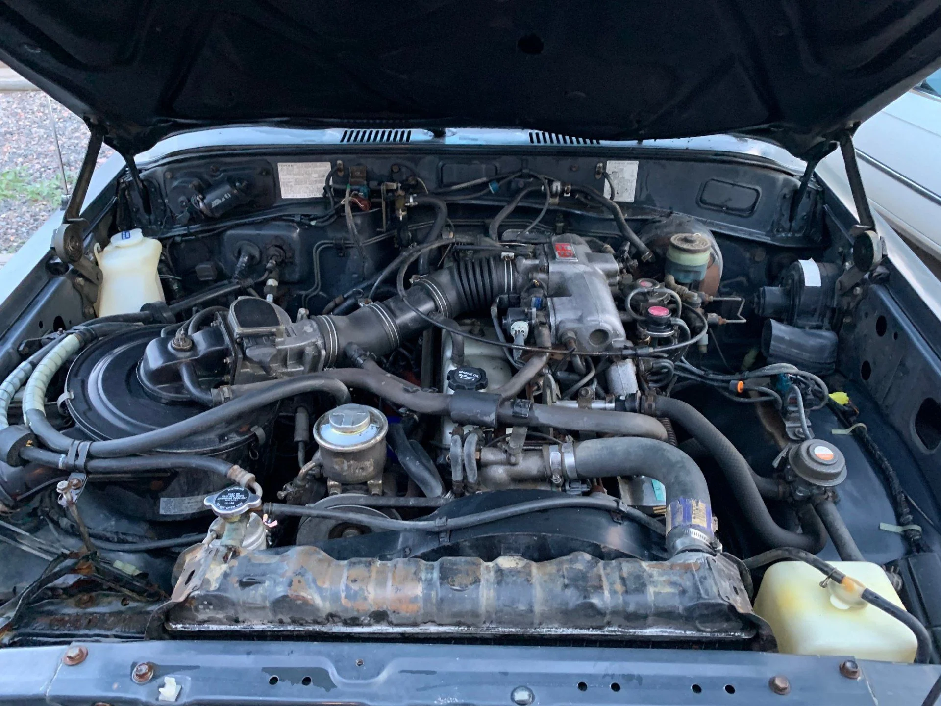

I watched some ChrisFix vids on engine bay detailing and decided to give that a go. When it finally was starting to get dark, it felt like I had been at it for an hour or two with very little results. It still has a ways to go to be clean but after I compared the before and after I realized what a difference it had made. I had no idea there was letters on my oil cap (which looked really new and likely replaced at some point) or that my power steering cap said 'Toyoda' with a 'D' (which I am assuming is aftermarket). If anyone knows where the cap came from I would be interested. Here is the before:

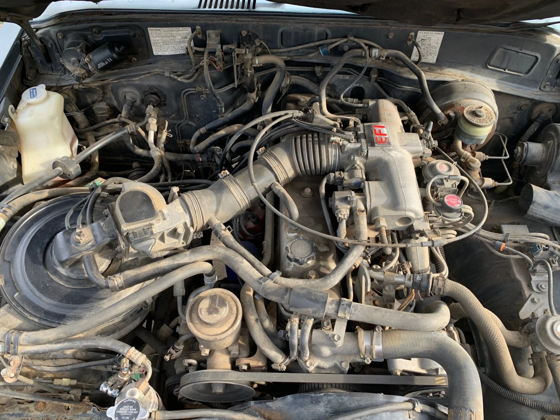

And after:
Definite improvement but makes me realize how many hoses are ready to be replaced. Good that I can now notice these things though!
Toyoda is the family name - it's a correct, original cap for your PS.
