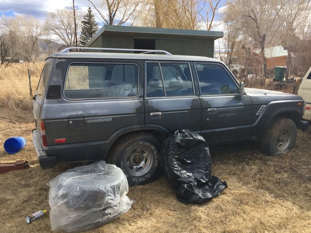

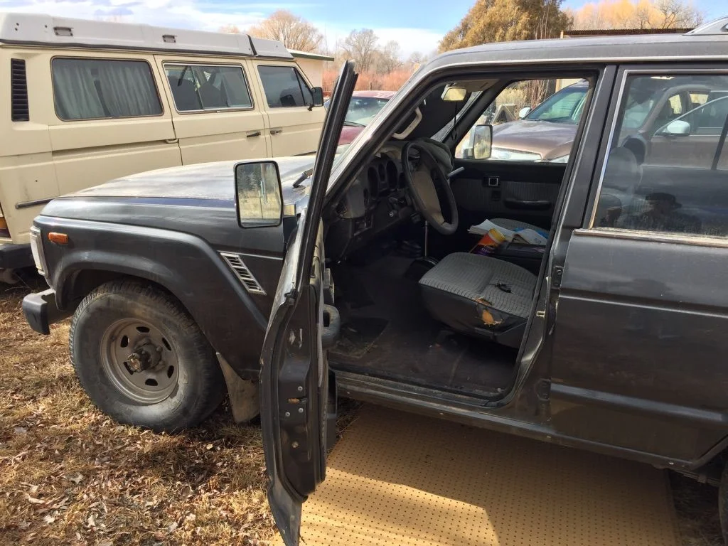

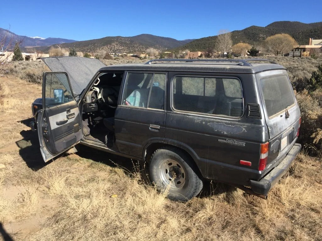

Below is the car as I found her, after filling the tires. It had basically just been tenement housing for mice for years at this point, and we used a compressor to spray out a graveyard of carcasses and years of mouse poop. Dust is everywhere on the interior and exterior, but other than that the interior was in decent shape - the PO threw a sun visor in the windshield and an old sheet over the seats, so everything is pretty intact except the tops of the door interiors which are all cracked. The dry NM weather took care of the body - this truck has minimal rust.

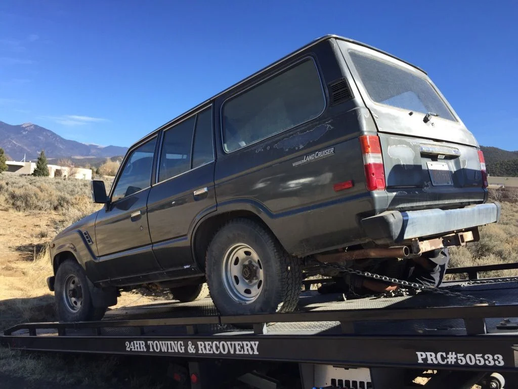

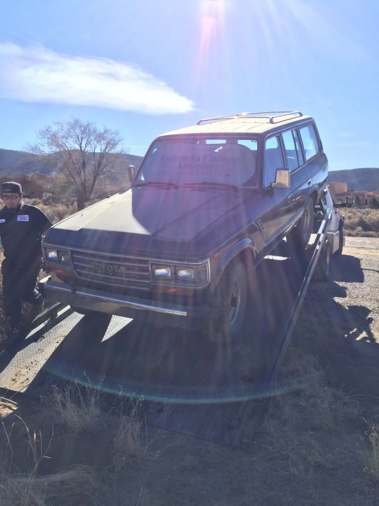

Up on the flatbed to the new home:
Grey Lady was officially mine! Now to figure out why she wouldn't start... the previous owner doesn't remember why he parked her in the first place.

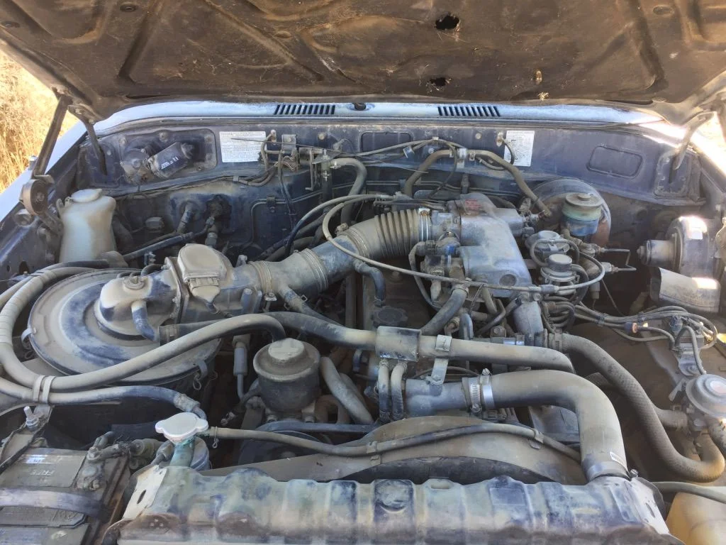

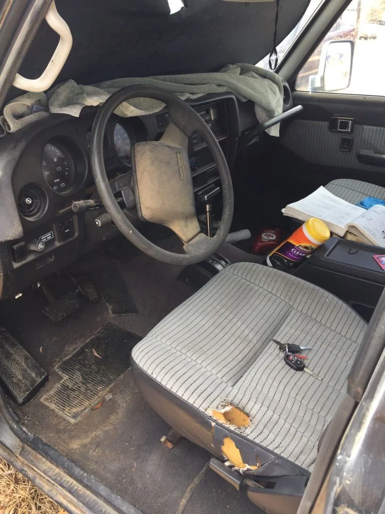

This is what I start with (and actually pretty much still looks the same as of Jan 2019):
I learn about fuel - air - spark and decide this is the best place to start. I drain the old gas and oil, swap the fuel filter and oil filter, swap the spark plugs, spray some fogging oil in the block, add new fuel and oil, and swap the battery. Will it start? Nah, of course it wouldn't be that easy. She turns over, but will not get started. I learn about spraying starting fluid through the air intake to see if it will turn over (I later learn this isn't always the best idea) and voila! She turns over and runs with starting fluid being sprayed in! So, I decide fuel is my issue.
I pull the fuel line at the block and try to turn it - sure enough, no fuel. I try to listen for a fuel pump running and can't hear it but am not really sure if I am supposed to or not. I read a ton on the forums and decide a bad fuel pump is my issue. In retrospect, I probably did not do enough diagnosis before deciding this and just got lucky that it worked. I pack it back in and drive back to Denver - the fuel pump will have to wait for another weekend. I PB blast every bolt I can find holding in the fuel tank and call it a weekend.

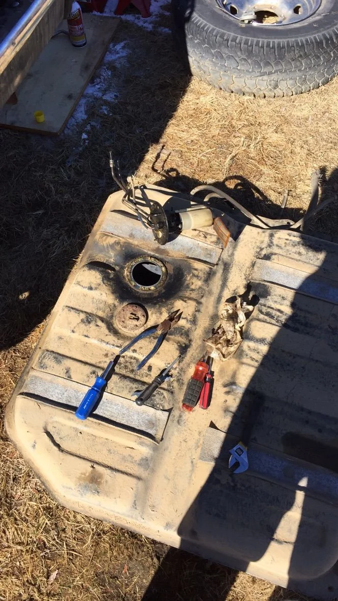

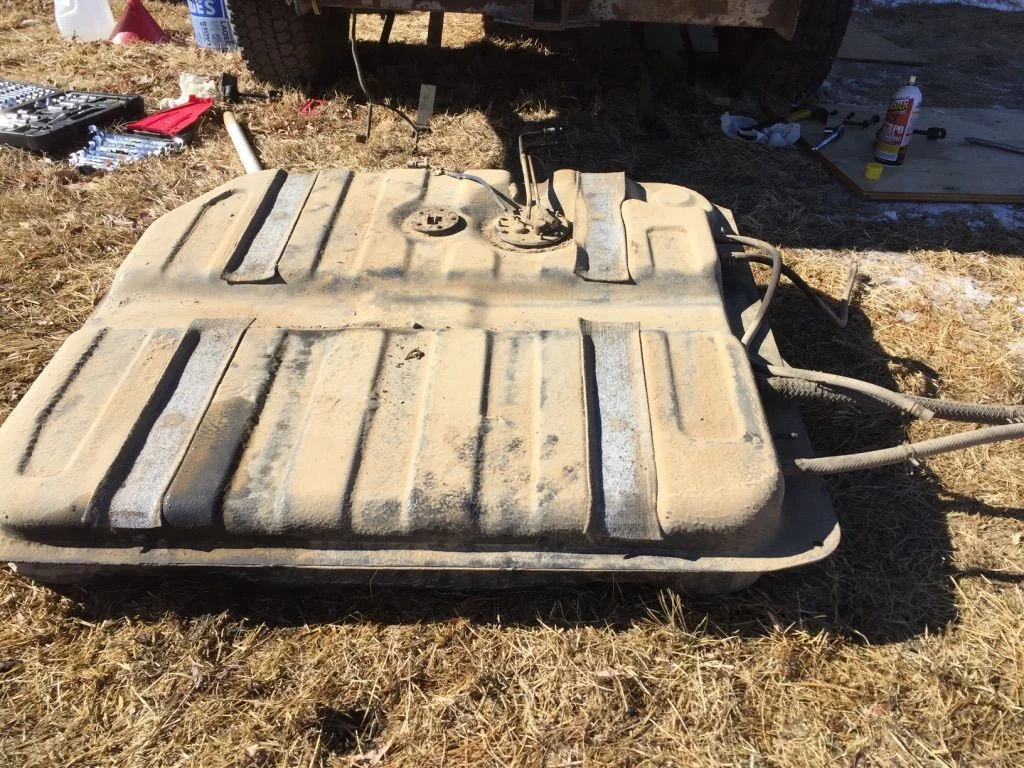

After the above post, I ordered a new fuel pump and decided to drop the fuel tank mostly because I didn't know how to cut a hole in the floor of the truck. I read a ton on the forums about how long this would take and read anywhere from a few hours to the better part of a day. It took me just about the whole weekend! I had a nightmare of a time getting the metal fuel line disconnected and later, reconnected, and I'm really lucky I didn't bend/break the damn thing. Here is my thread for the fuel line:
Special way to disconnect fuel line?
Made sure to check the relay and sending unit before dropping per the forum but not sure I really did this correctly - I still don't really understand how to use a multi-meter properly. Mostly just got lucky that the pump was the issue.
Tank out:
Pump out:
Reinstalled the tank with the new pump and attempted to start. The damn thing started, and idled, on the second try! I have a video of it, but there is a lot of cussing because I'm so excited plus couldn't figure out how to embed, so decided not to share. The Grey Lady was running!

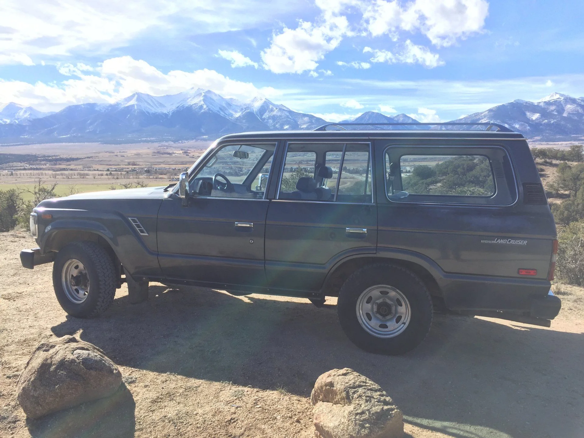

In October 2018, I drove the cruiser back to Denver - another 150 mi of mountain passes. Here is a pic from that road trip:

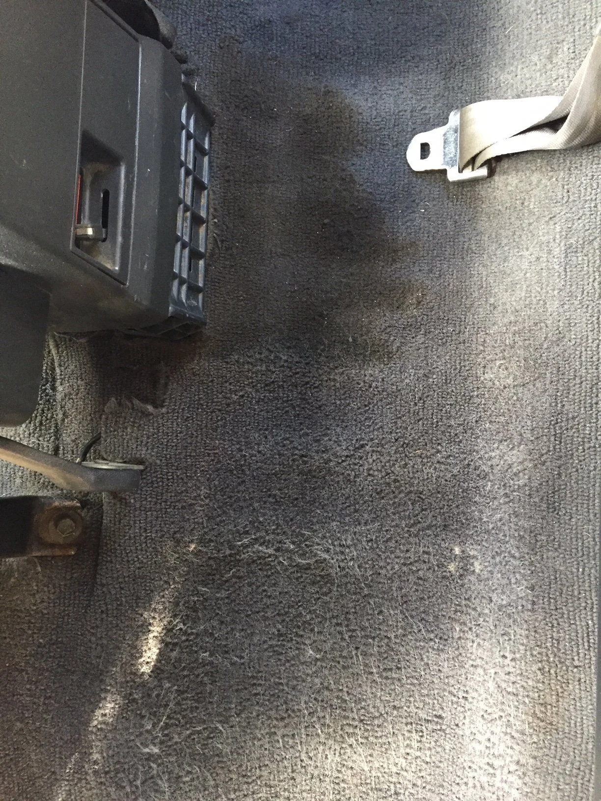

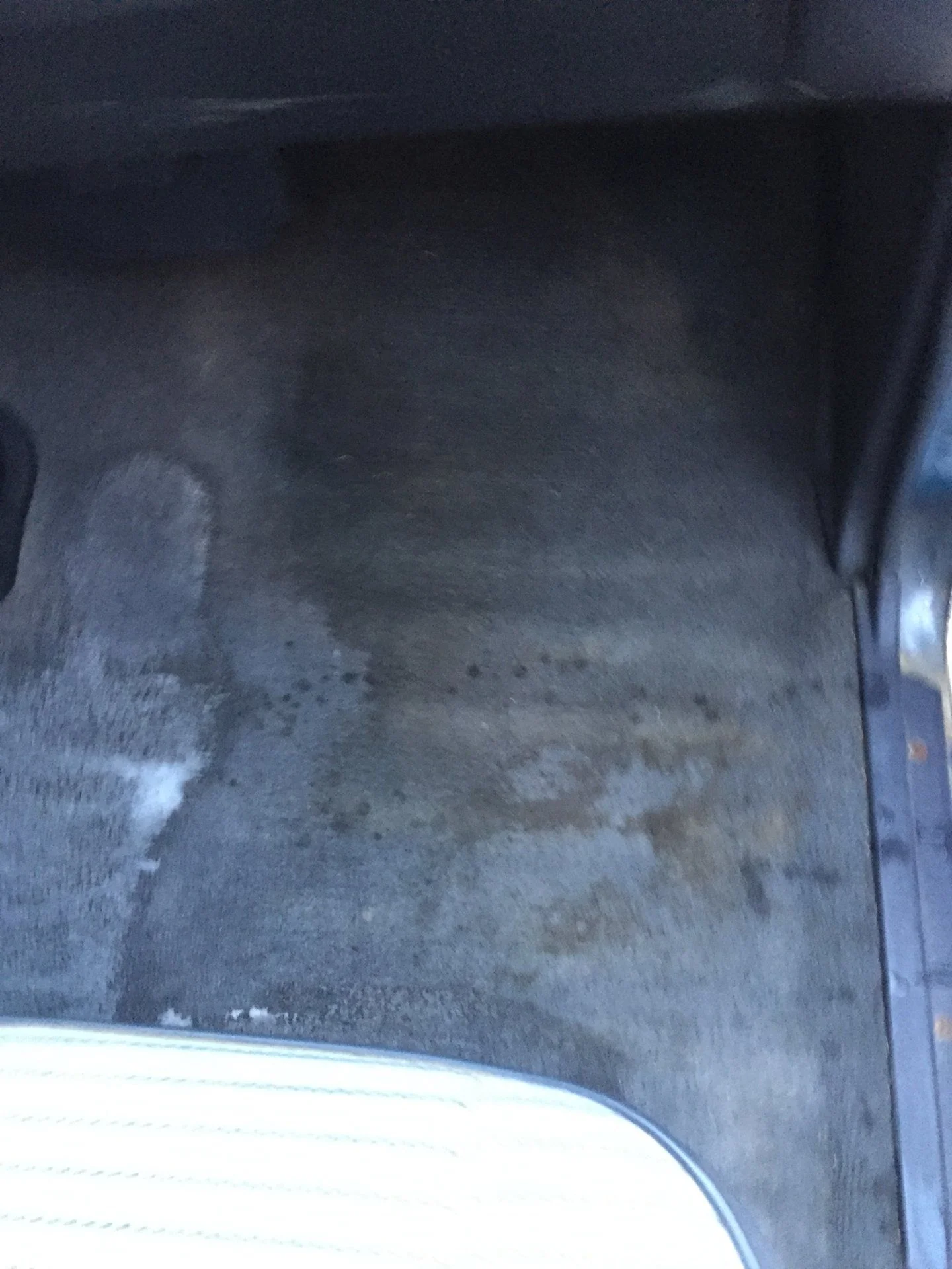

The carpets were in desperate need of a good cleaning after years of spills and dead mouse carcasses. Here is what one section looked like. The top half of the photo is before, the bottom was cleaned. Carpets aren't in the best shape but at least they now look ok:
I used a mixture of basic carpet cleaner and tons of engine degreaser and a brush and scrubbed until my arms hurt. Here is the passenger side footwell before:

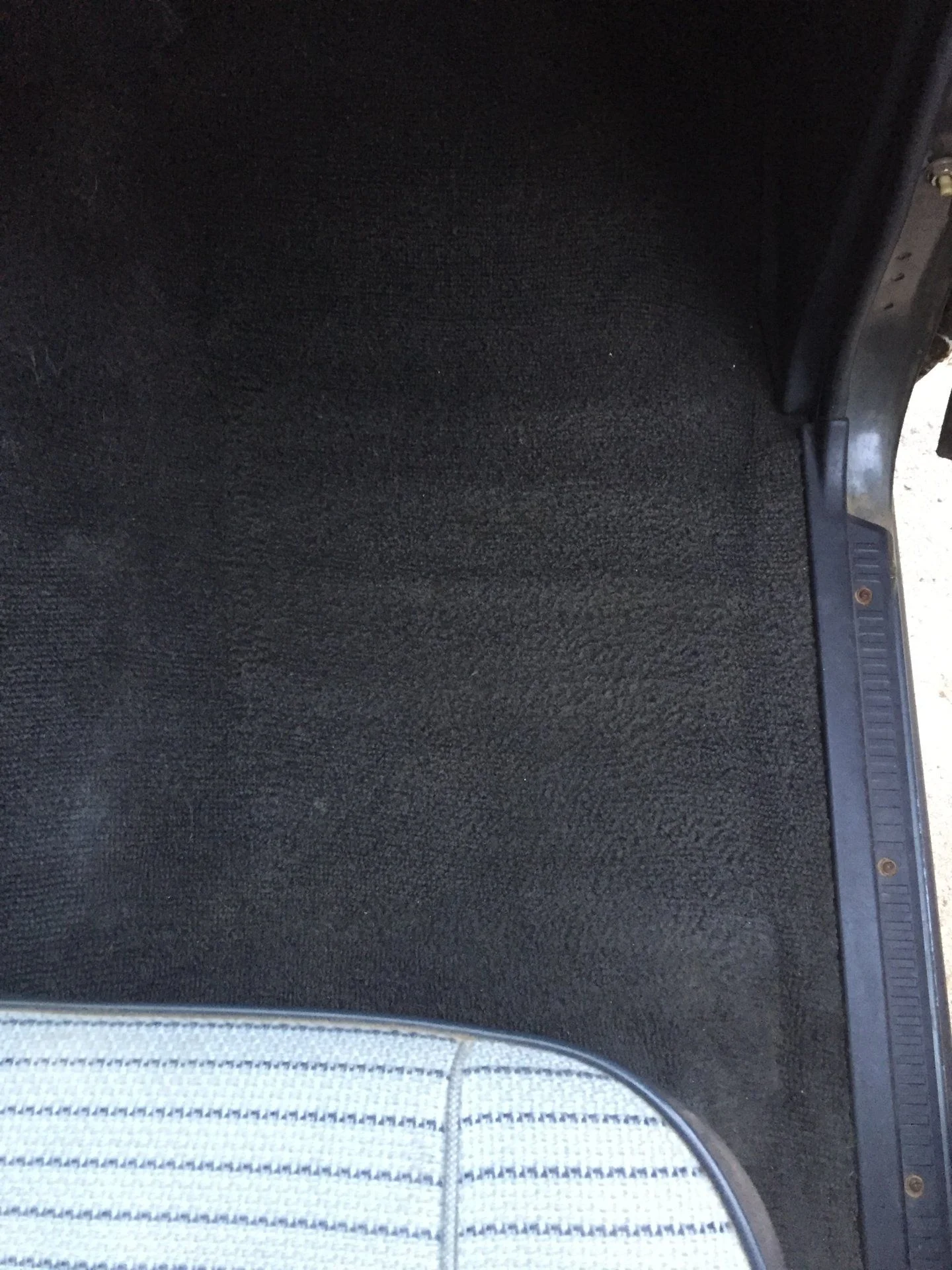

And here is after the scrubbing:

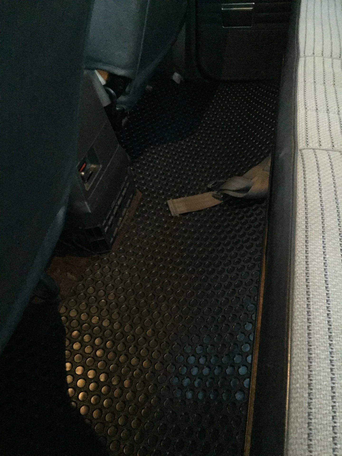

A significant improvement. The cruiser came without mats, so my fiance bought me some for xmas:

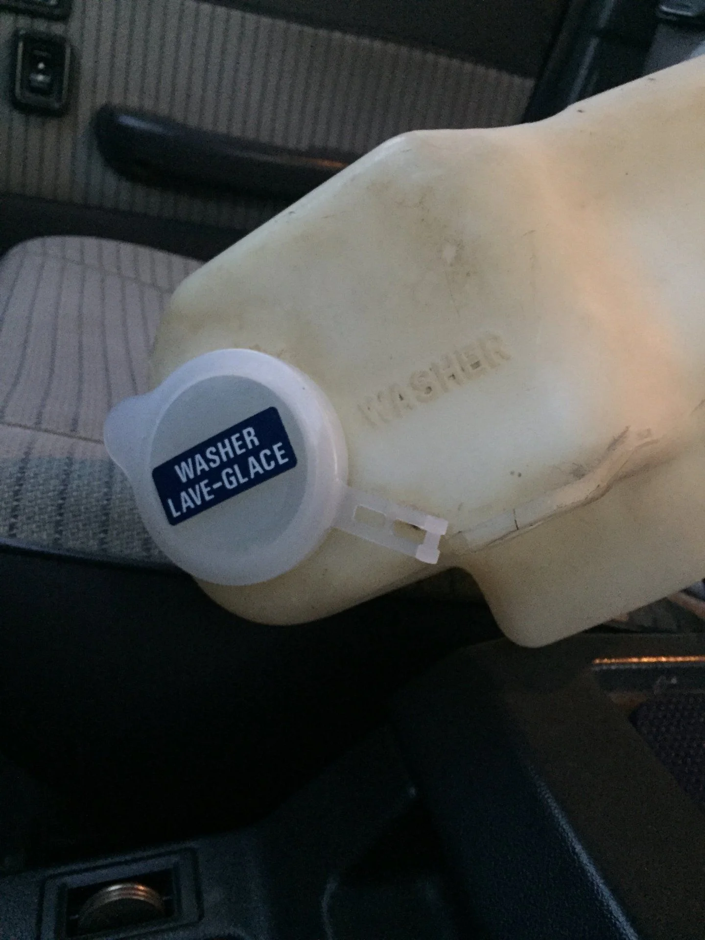

I found out the spare rim was bent when I put on the used tires. I hit up my craigslist buddy and grabbed a new spare rim and tire and rear dome light (it crumbled when I was cleaning it), and a washer reservoir cap:

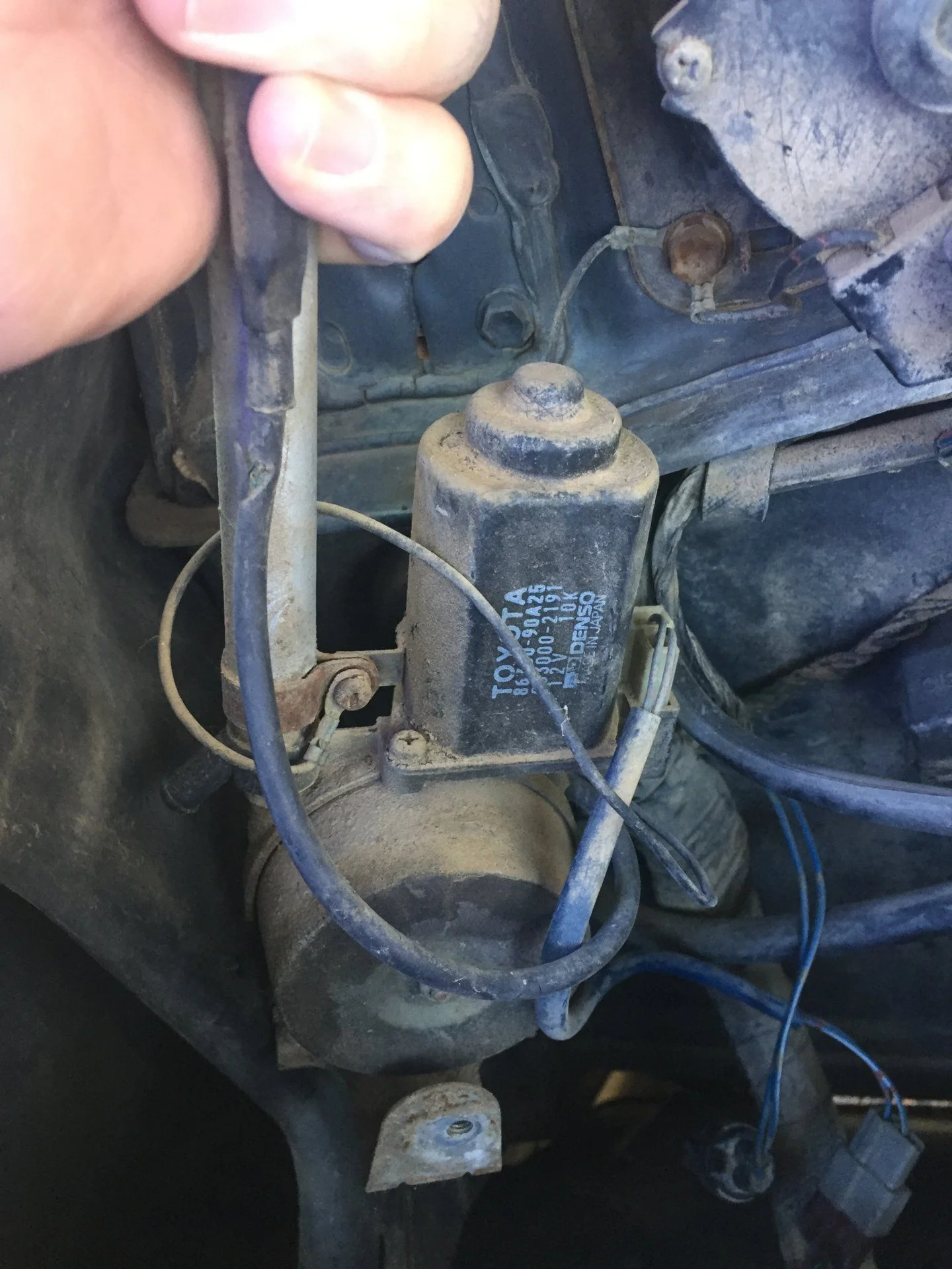

The liftgate was sagging, so I installed new hatch struts. I also ordered a pump for the front windshield sprayers, and possibly my favorite FJ62 feature: a new power antenna! The antenna motor still worked, so I installed a replacement antenna and it now works!
