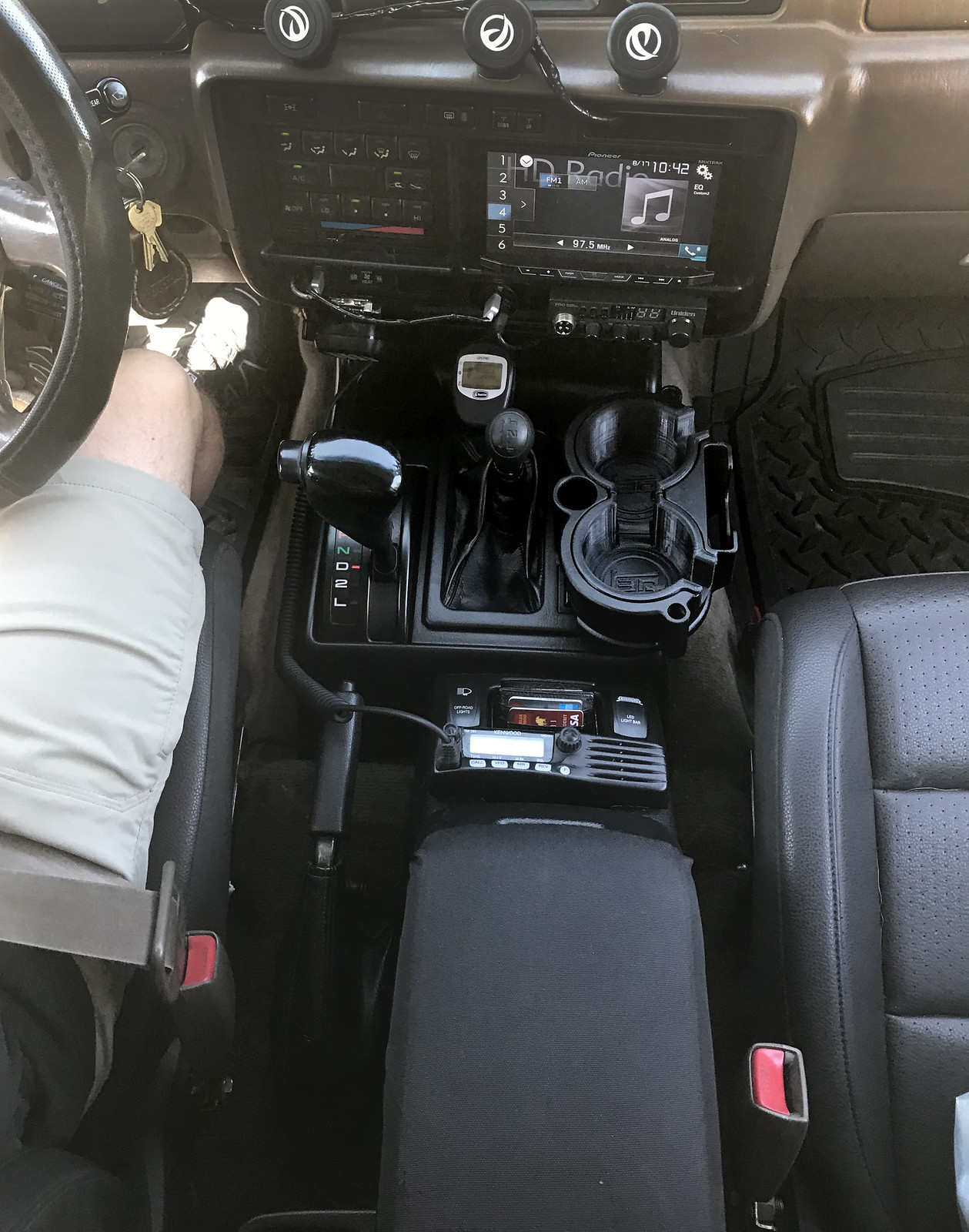

Pioneer MVH 1400NEX here. Replaced all 9 speakers with Focal including the subwoofer in its factory location. ARC audio Xdi 1100.5 to run it all from other the drivers seat. LOVE IT.

It mounted right up using the brackets I pulled of the factory radio. No trimming or nodding was required to the dash trim. This harness made it pretty much plug and play:
Direct wire harness for Pioneer Headunits (fits Toyota and Subaru) https://www.amazon.com/dp/B078GBDRVX/ref=cm_sw_r_cp_api_i_7WB8Ab8SACXF1
You will have to run wires for the backup camera, camera power and ground, reverse sensor, and parking brake sensor, but that’s all pretty simple.

Hey Jen... the link you posted is correct. It should work just fine for you. The unit bolts right up without any trimming, using the factory brackets from the OEM radio.
A couple of notes... my factory amp was bad, so I just ripped it out. I didn’t jump or make any bypass wires that I’ve heard other people describe. Seems to work fine for me.
I replaced the door speakers in the front and rear and deleted all the other speakers, including the factory sub. The sound is fine for me. There are audio geeks here that will chime in to say how terrible that is, but I’m used to listening to my two factory door speakers in my 60 and they are fine for me as well.
As for the stereo.... I love it. The longer use it, the more familiar I have become with its capabilities. It definitely modernized the 80 to current standards.
My gripes are that the screen is highly reflective and hard for me to see in the sun. If you’ve tinted your windows, this might help, but I have the factory tint still. I have heard that the next model down has a different screen that helps, but you lose some of the crispness and touch sensitivity of the higher end screen.
My next issue is that the software can be glitchy sometimes, especially with the Apple Play mode. Sometime the system won’t recognize when my phone is plugged in. This could be an issue with my phone though.
On the plus side, the Bluetooth connects right up every time and hands free Phone conversations sound clear on both sides.
The rear view camera works great and the unit has the ability to adjust the parking guides to dial in exactly the way you like.

I grounded the brake wire to the stereo bracket. I haven’t tested the functionality of that yet, but I can tell you that the pioneer gives me an onscreen warning about it. I suppose the GPS senses the car is in motion while the brake wire is grounded.

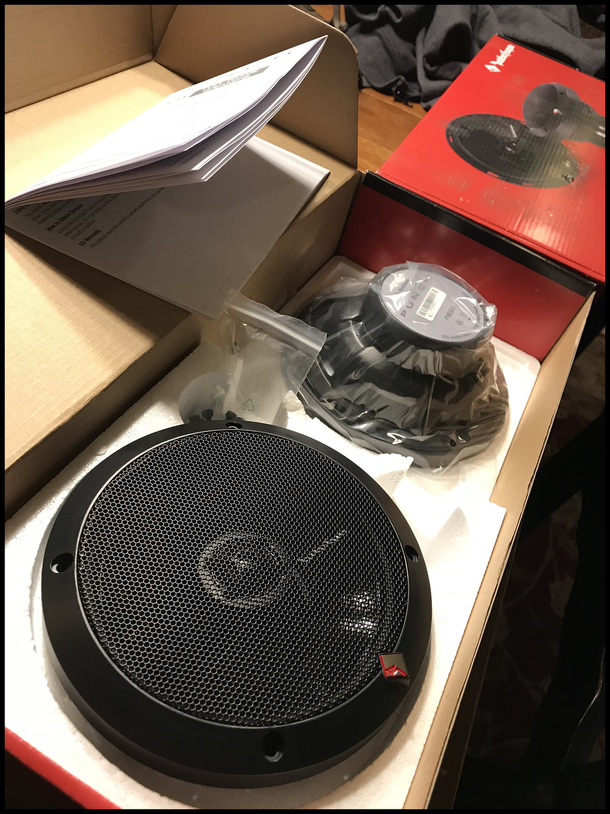

fosgates fit no prob in front doors or did they need spacers?? look rad
These specific ones needed spacers. Used some 3/4" MDF to cut some rings.
