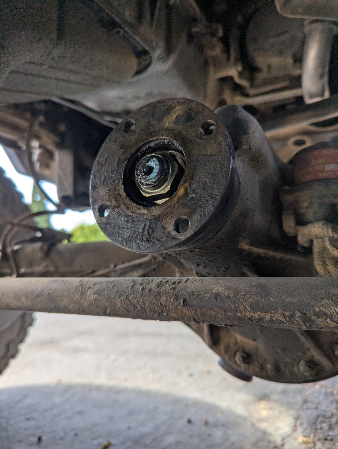

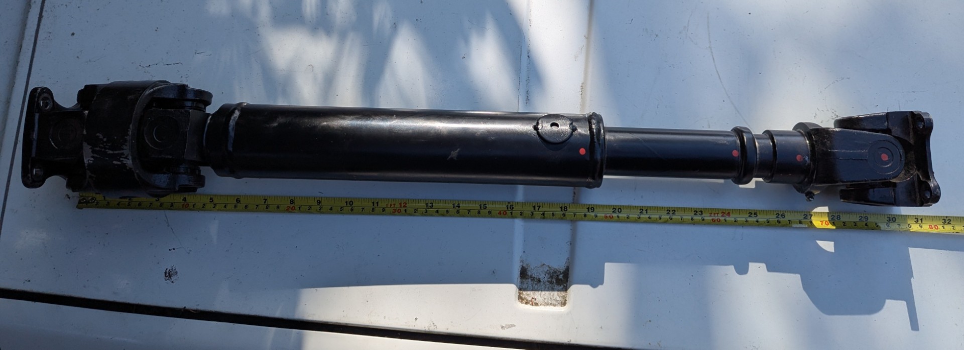

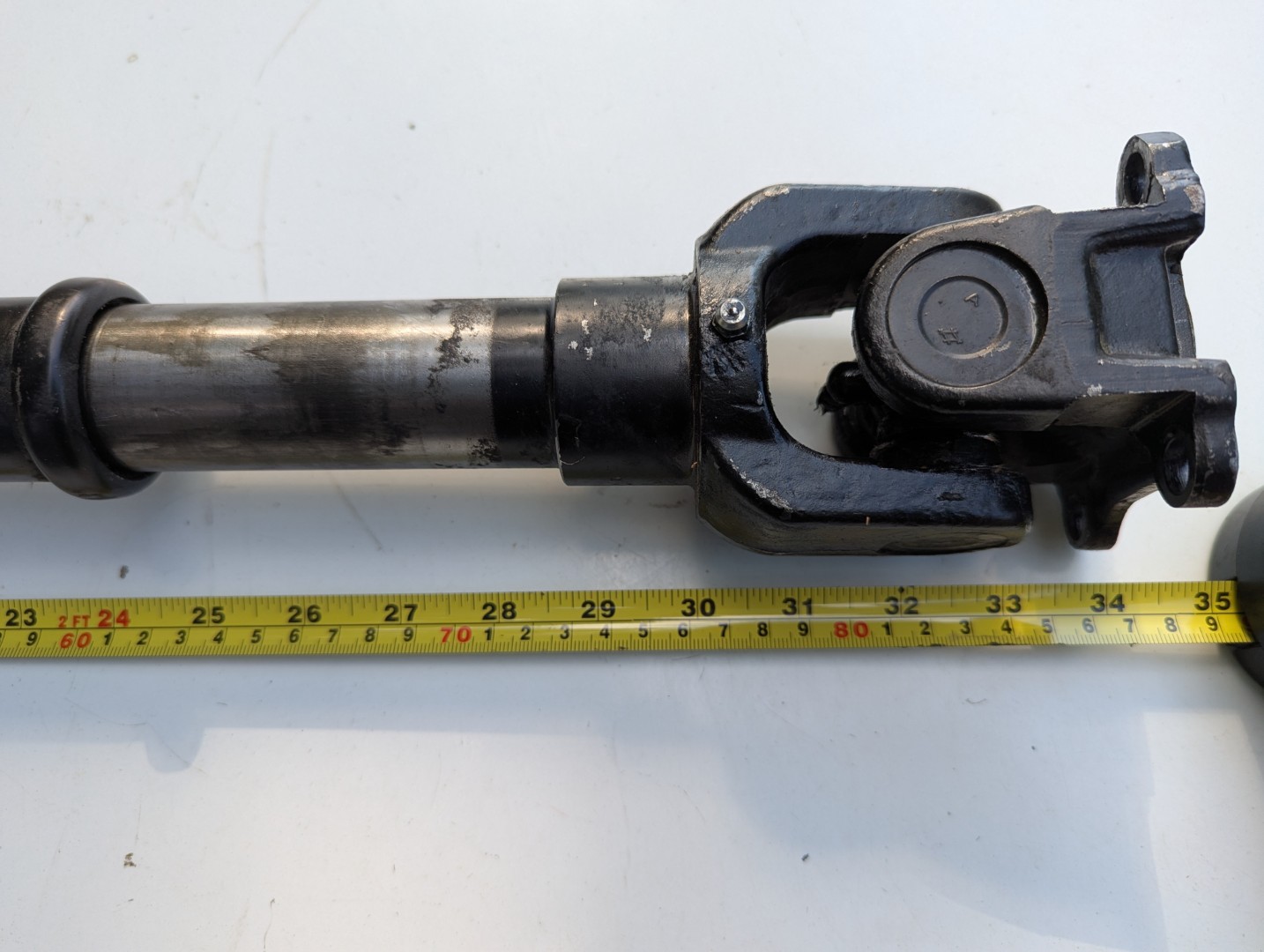

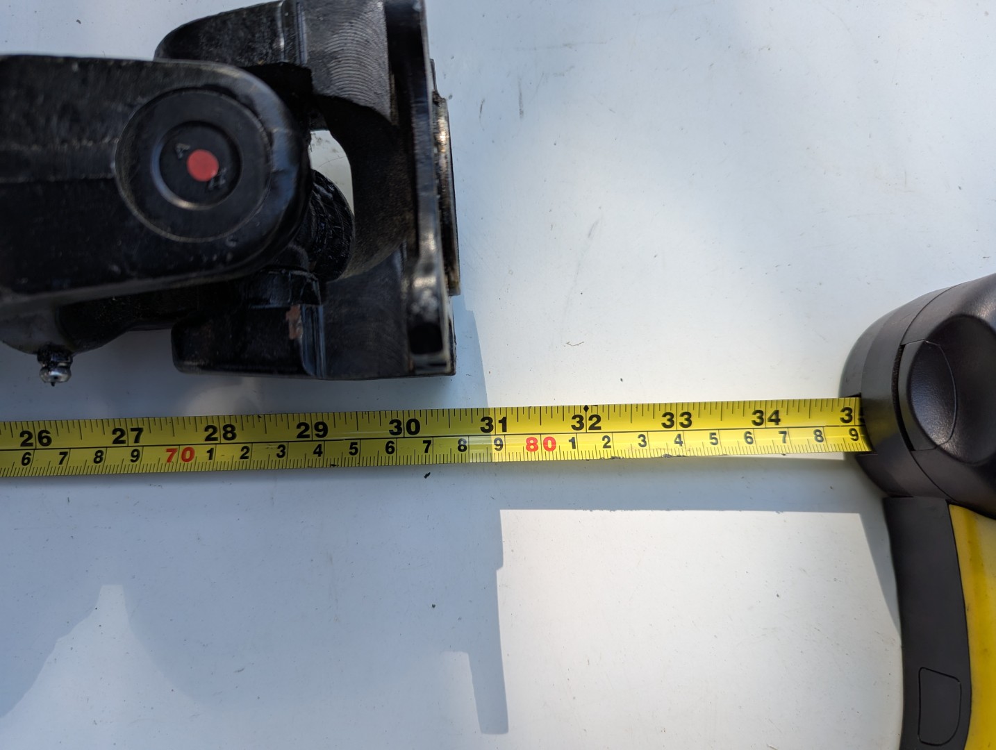

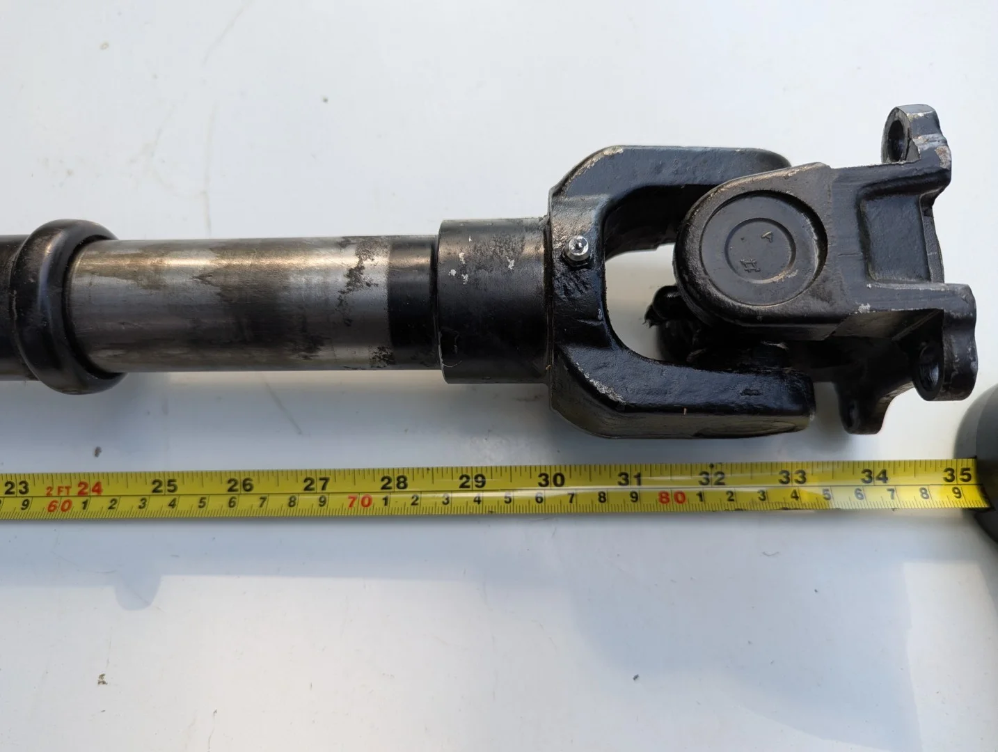

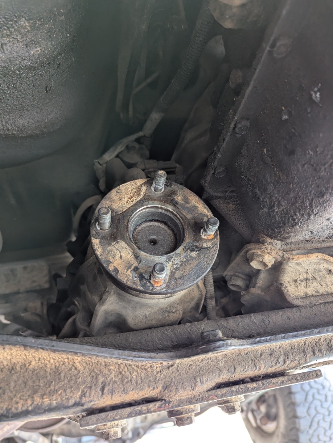

Some pics.
Flange to flange at parked ride height is 81cm (as above)
With shaft removed, view of the xfer box flange
And ditto for diff flange
Fully compressed shaft
Fully extended shaft with splines just visible
Shaft in fully compressed state and with phasing as shown and delivered from Slee.

When it was installed, were both ends well seated onto their respective drive flanges? If there was even a tiny gap where the mating flanges were not seated with each other, they will flex with each rotation.
If those flanges to have a new driveshaft installed, there's a lot of debris and gunk.on the faces.
Clean off all flanges, make sure each end seats well and make sure they are torqued properly on all hardware.
And the DC end goes to the transfer case, not the differential.
Is the sway bar dragging on the DS?
IME uni joints have always come with only enough white grease for assembly.
I always pump in moly grease until it spews past every seal and pushes oit no more white grease.
"A couple of squirts" wouldn't do it.
If you're feeling some notchyness, along with the ding sounds, you've got a dud or dry, or broken needle roller in there somewhere
Front differential problems like a chipped pinion gear could transfer and ring through a tubular driveline under load then not once the load and amplifying device is removed.
May be a cheap check would be to dump the diff fluid and check for iron contamination if you don't find a problem with the shaft...
