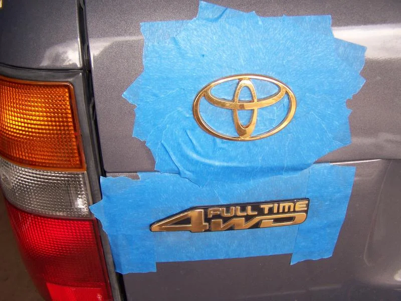

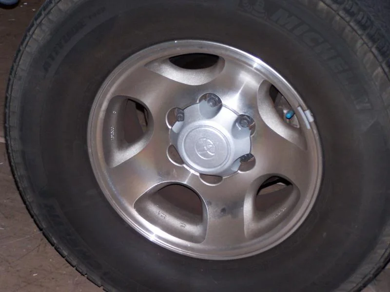

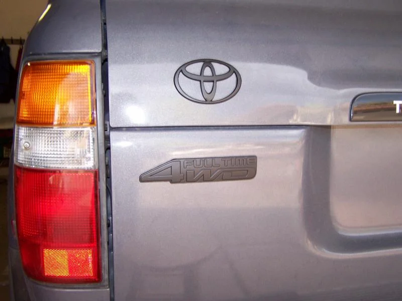

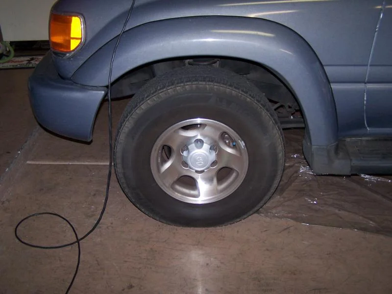

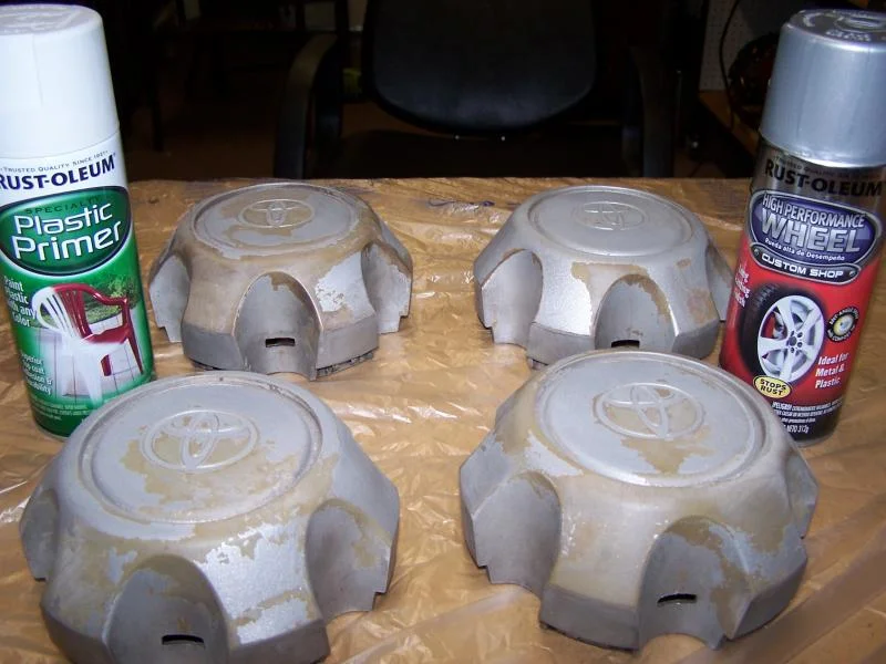

Repainted the center caps - I'm not too happy with the result. They look a lot better in the daylight. Think I'll eventually paint them flat black.

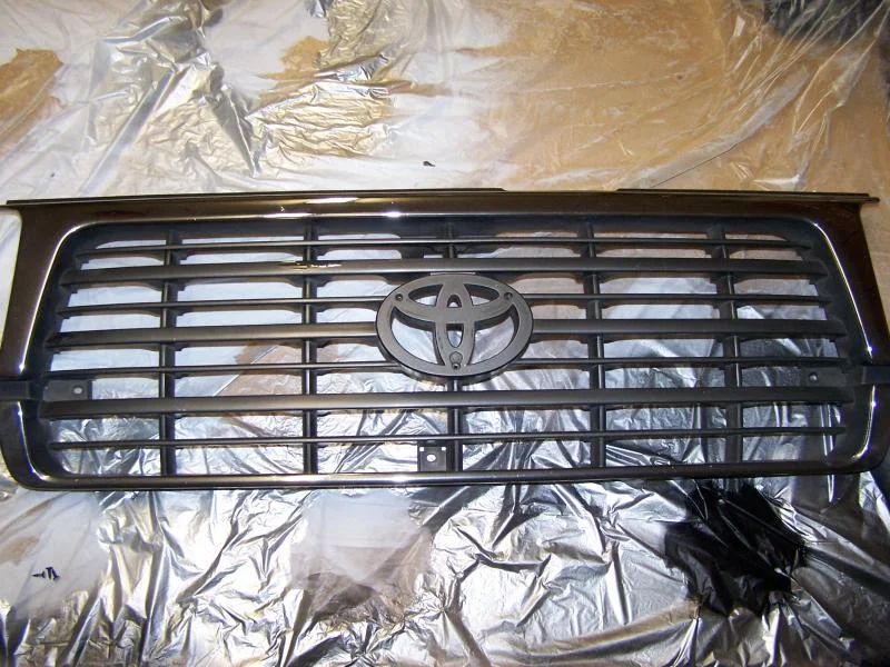

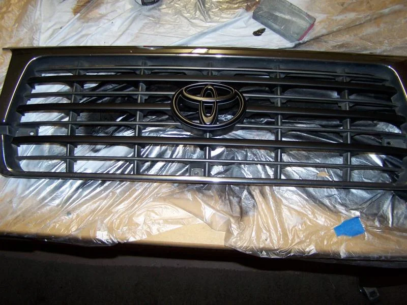

Repainted part of the grill. Still debating if I should go flat black over all the chrome on the front end.

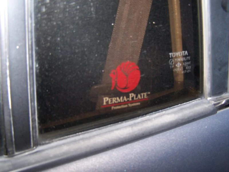

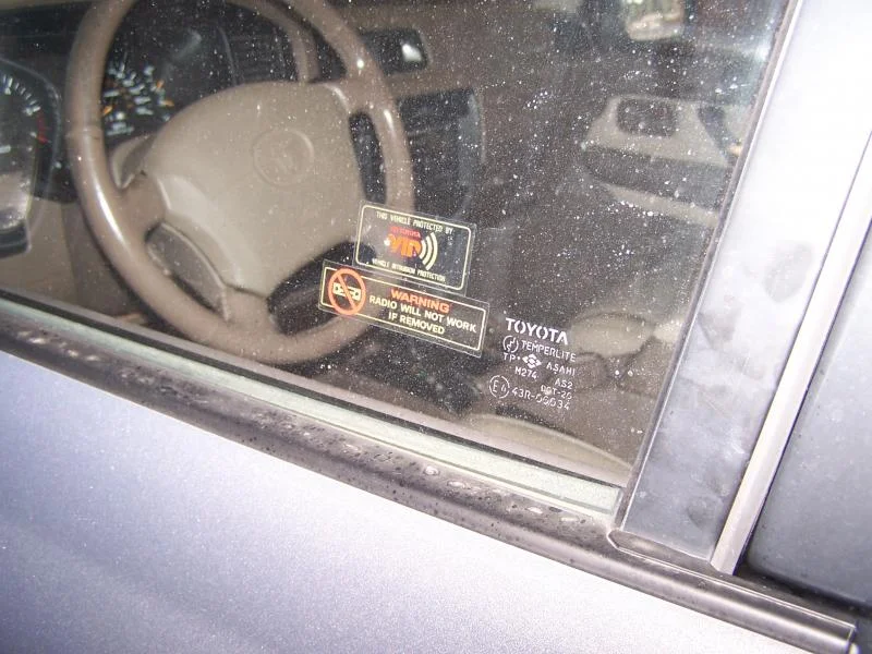

Peeled off the factory stickers. I think one of these is for the undercarrage coating. The original owner said they coated it at the dealership before he bought it. The pictures show some dirt. It rained off and on from Sacramento to Phoenix.

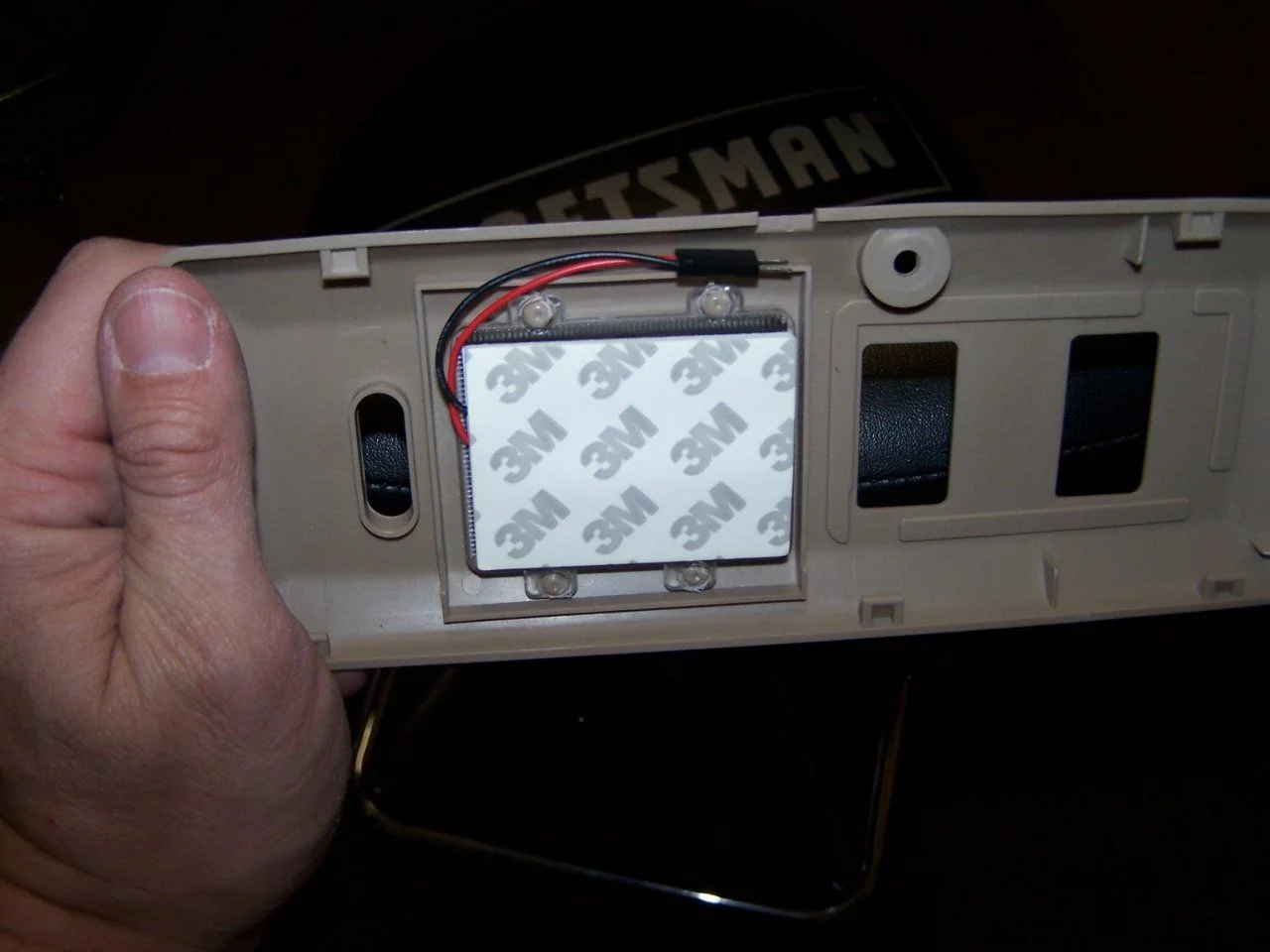

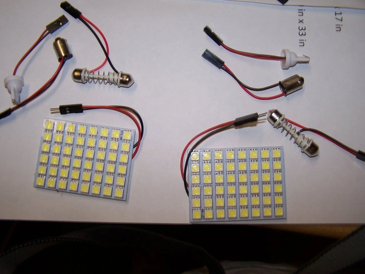

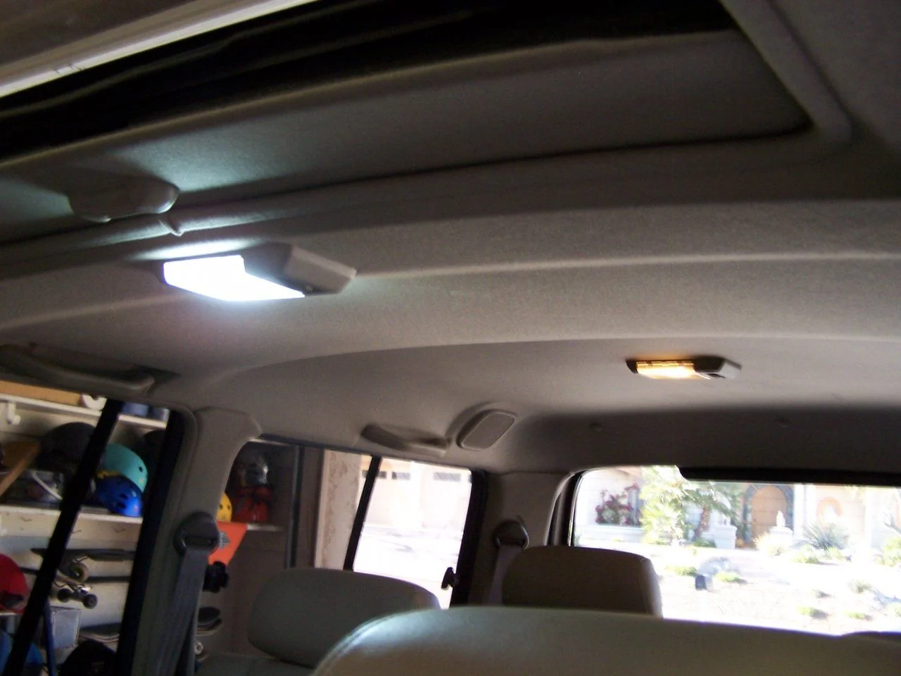

Interior lights - I replaced them with ones I found on Amazon. They are great - $9 for a pair, I bought two pairs. They all fit great into the existing openings and the front map light was a perfect, perfect fit. I think I will find some smaller ones for the door lights. They can be found here:
http://www.amazon.com/dp/B00FKPJJNY/?tag=ihco-20
The picture shows the new with the old. I think you can figure which is which.

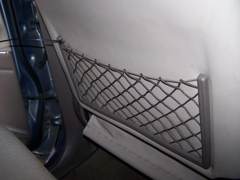

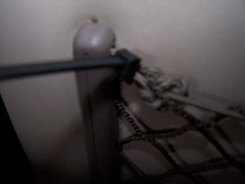

Alarm Antenna - There is some info on this on this forum. Lot's of people trying different things to get better range. At first I ran a wire up the B column and around the top of the driver's window. It helped, but once I covered it all back up with the trim the range was cut down again (still way better than stock). I then thought to try an easier approach. Hook the wire to a ground source - I used the seat bolt. This is WAY better than the wire I ran, so I left it. If anyone sees a down side to this, please post.
