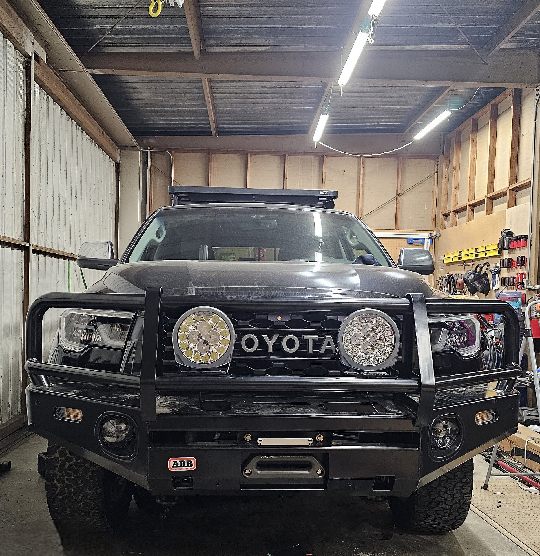

My first order of business after full maintenance is an ARB bumper (7-13 Tundra 3415010) which I ordered this morning. The next order of business is replacing the window belt moldings of the doors, I already ordered and received them from my parts guys at the local Toyota.
The driver side is pretty well baked and needs replaced, the passenger side moldings were faded but good, I ordered all 4. I will be fixing the gooey hatch handle at some point also.
I was hesitant to do it, since it already has some nice Morimoto LEDs on it, but I ordered 2018-2022 Sequoia platinum LED lights and fender extensions from Toyota as well. I have the necessary components on order to build the wiring harness for the new Sequoia lights. That being said, I will clean up the Morimotos and list them for sale soon.

I will be adding some auxiliary lighting also. During the trip home I had to drive through a winter storm across 3 separate passes. Each time I found the need for something other than the LED headlights. It would have been extremely beneficial to have had some amber lights.
I have a pair of Dobinsons 8.25" Zenith lights, an ARB AR40v2 light bar and purchased yellow Morimoto 4Banger fogs for the bumper. I may add a pair of Amber spots later, either Baja Designs Lp pro or Morimoto BigBanger HXBs. I will be running a Warn VR EVO 12k with synthetic line on the ARB and will make that decision once everything is mounted.
I think I will keep it fairly mild, unlike my 80. I'm thinking 35's on 17" wheels. I may or may not regear it at that point.

Well, the TRD front sway bar is a definite fit. The yellow Morimoto lights are on hold for a bit. I installed the Morimoto fog lights that came installed on the Sequoia into the ARB bumper. I designed some brackets to mount the Morimoto HXB lights in the ARB little square openings at the bottom. They have 15 degrees upward tilt and 18 downward so I should be able to get them leveled out. Hopefully they still cast light properly being set back in the bumper.
I also mounted the ARB light bar using the bullbar clamps and I'm not a fan of the look, a bit too protuberous for my liking. Also, the light bar barely fits under the bottom bar, so I don't think the pedestal mounts would work since they add 10mm of height. I may just get a different light bar and put the ARB on the 80 series as originally planned.

I have decided that instead of using individual switches for every auxiliary circuit such as the morimoto fog lights and the Dobinsons etc... that I wanted a cleaner and more adaptable system than my 80 series.
This led me to look at 6, 8 and 12 gang remote switching relay boxes. Originally I was thinking Garmin, then you have to have additional devices to operate it. Then I was ready to settle on something like the Auxbeam 8 gang but I really didn't like the amperage capacity of the circuits. That's when I happened across the Scosche M8RIX.
I found a new unit for a great deal and ordered it. I received it a little over a week ago and have been planning the installation since.
There just isn't a great place to install it in the Sequoias engine bay. Some might say put it on top of the fuse box or build a bracket to go over the top of the fuse box or something. I don't want to have to remove it or fight with it if a fuse pops. I considered housing in the ARB bumper at one point. As I stared at the engine bay looking for any available space it came to me. I will more than likely have to build a bracket regardless and the battery sits so far down...why not mount it under the Battery? Why Under? Because it's an Aluminum housing and I'd rather have a battery smashing down on it than it smashing down on the battery.
So, I went against my own standard operating procedure and took some rough measurements, designed a bracket up in Fusion 360 and sent it to be made. I guess we will see if it fits when it gets here. I usually print stuff like this out first to ensure relationships and dimensions but my Fusion subscription is about to expire and I'm not entirely sure I will renew it for what it cost. I went with ⅛" 5053 Aluminum, I will make all of the mounting holes and tray locating holes when it arrives, then prep and Epoxy primer it. Then I will use the original plastic battery tray on top and find some longer J-bolts to hold the battery down. Once I have all the parts I will get some pictures and my exhaustive ramblings will make sense.
Meanwhile I removed the shifter and cup holder portions of the center console to get the Tow Haul switch panel out. I drew up and started iterative prototyping a screen holder for the M8RIX touch screen. I will grab some pictures of that when I go to work on it this evening. I may change it again and I'm still deciding what to do with the Tow Haul and The CDL switches. I'm just working 1 problem at a time. I have a solution in mind but I'm waiting on other stuff to arrive to see how it all jives.
Here are some screen mount model pictures until I can get a picture of the actual prototype mounted.

Well, it's 0336 and I just got home from finishing buttoning up the Sequoia. I sprayed the M8RIX panel with adhesion promoter and a coat of filler primer. I haven't done any sanding or anything but I did install it. I still intend on smoothing it out and potentially making a mold to resin cast it. Still undecided on the angles and all.
I really Jeeped up some wiring and a mounting situation to test the M8RIX, Morimoto 4Banger fog lights and Dobinsons lights. On a side note, I got ahold of Dobinsons. They make Amber lens covers, available in Australia. Dobinsons North America said they would air freight some here. I'm ordering a pair of Amber's. I cannibalized the Dobinsons wiring harness and built a harness for the Morimoto foglights and loomed them together. Just your standard 2 pin Deutsche connector. I happen to have a Deutsche connector kit so that worked out. It is so nice not using individual switches, switch harnesses, relays and fuses. Once I mount it under the Battery the M8RIX setup will look clean. I'd post a picture of what it looks like now, but....it's very "JEEP guy tried to save a buck" looking. Not clean and professional like I like, Lol.
I was fiddling with the matrix and boy does it have a lot of options. You can set button icons, name them what you want, make them dependent on other buttons, dim your lights, strobe your lights, flash them. Change button colors...Haven't figured out how to change the inactive color. Just the active. Anyway, lots of features. The multi-function button also doubles as an voltmeter and amp usage monitor.
Well, the last thing I need to do is order some 5/16 4AWG terminals and the metri-pack terminals necessary to eliminate splicing to the pigtails that come with the M8RIX. I just want to get rid of that 6" pigtail and wire it directly.
