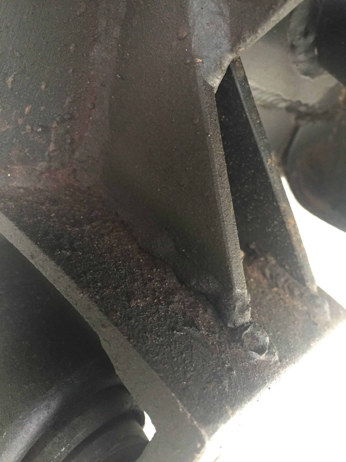

Until I noticed this...
1995472
1995474
My sketchy suspension was due for some serious attention, not a surprise really... Boots4 and Cruisermatt both mentioned the poor materials used and overall bad construction.

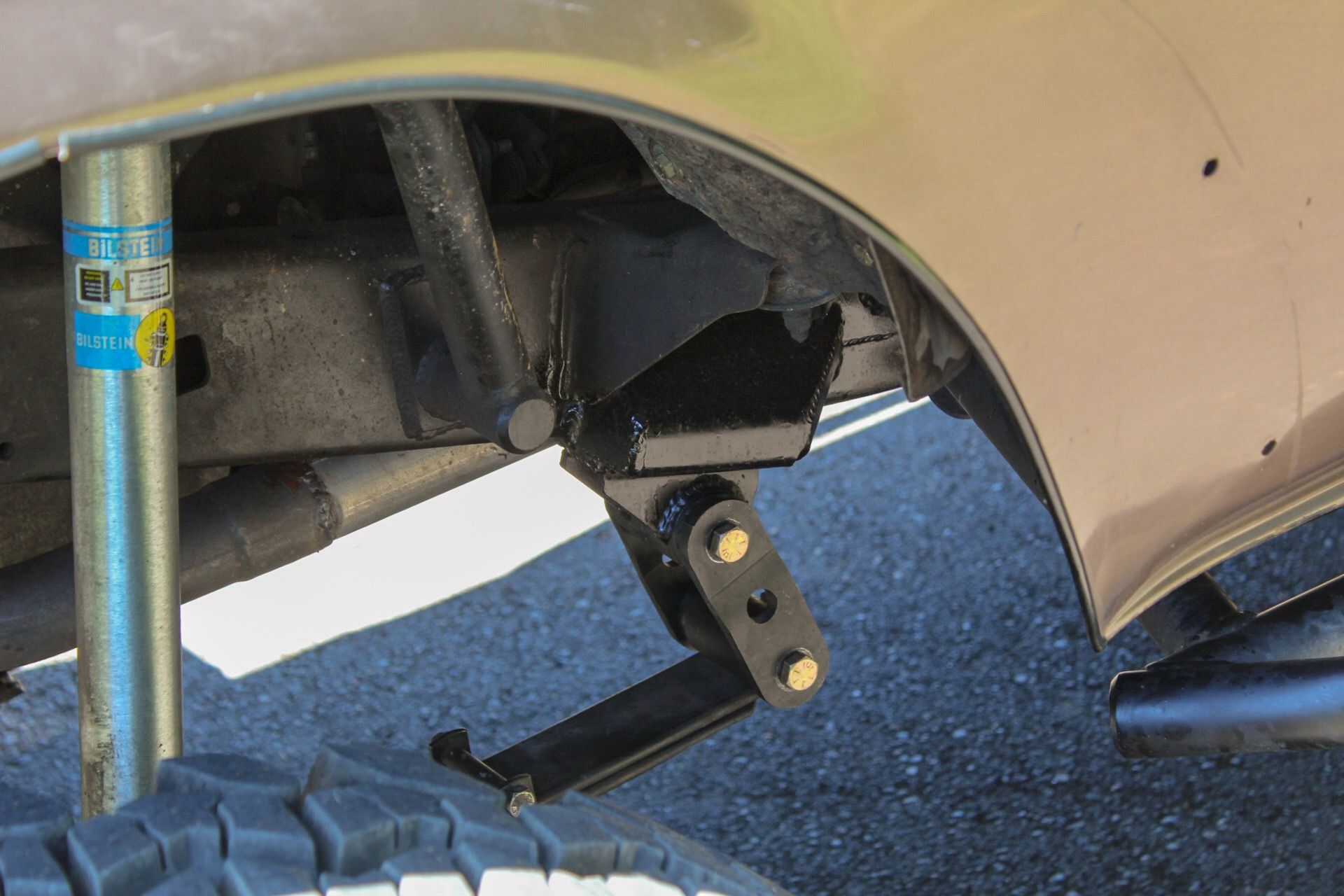

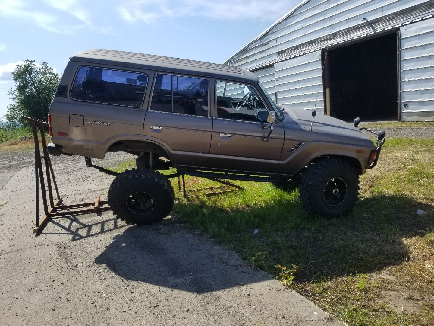

Having just lost access to shop space and welder however I wasn’t in a position to tackle the project myself so I contacted Adham over at Hamms offroad and we figured out a plan. I’ve worked with Adham many times and he’s always excited to work on the Cruiser and he does high quality work.
We decided to keep my front springs (4” lift springs for a 1985 3/4 ton Chevy p/u) and swap Suburban 63s in the rear.
Per usual he went above and beyond.
1995480

Looks better overall, also looks like you went with a shackle reversal up front. Now having driven the same rig with both suspension designs which one do you like better in your setup?
Your on the right track now, looks like you had quality work done. So many strange parts choices you have had to un-do, chaindriven slip yoke T-case, steering box swap that makes zero sense, etc. At least you're working through issues.
Thanks @boots4, honestly I’d say for daily driving I don’t notice much difference. But undeveloped roads and going fast over bumps I definitely noticed it’s more predictable. I don’t know if predictable is the right word exactly, but that’s what it feels like. I like it, it’s much stronger, and helps my approach angle.
