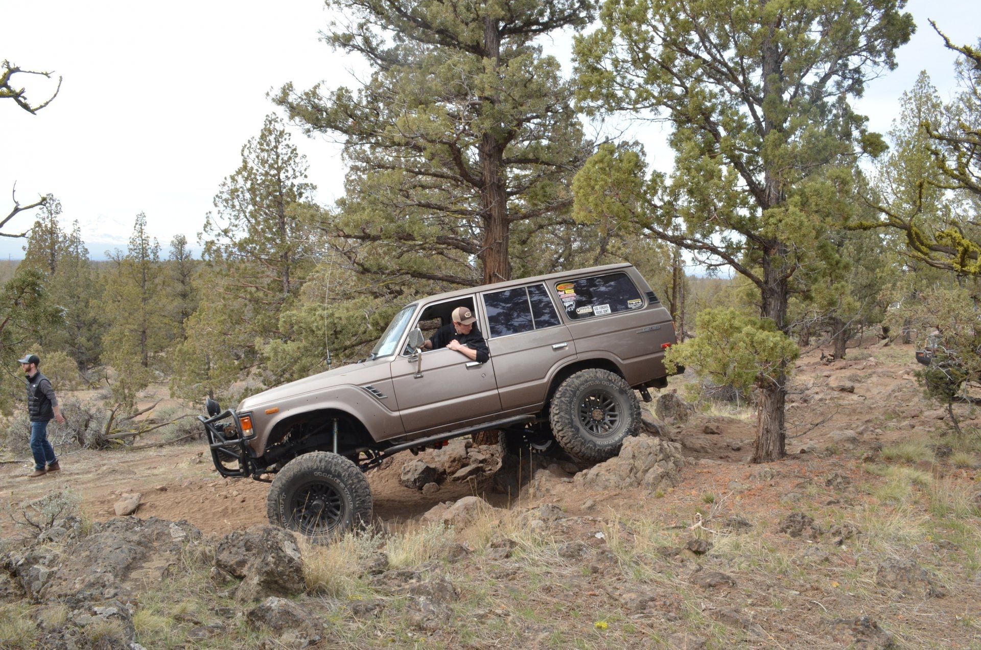

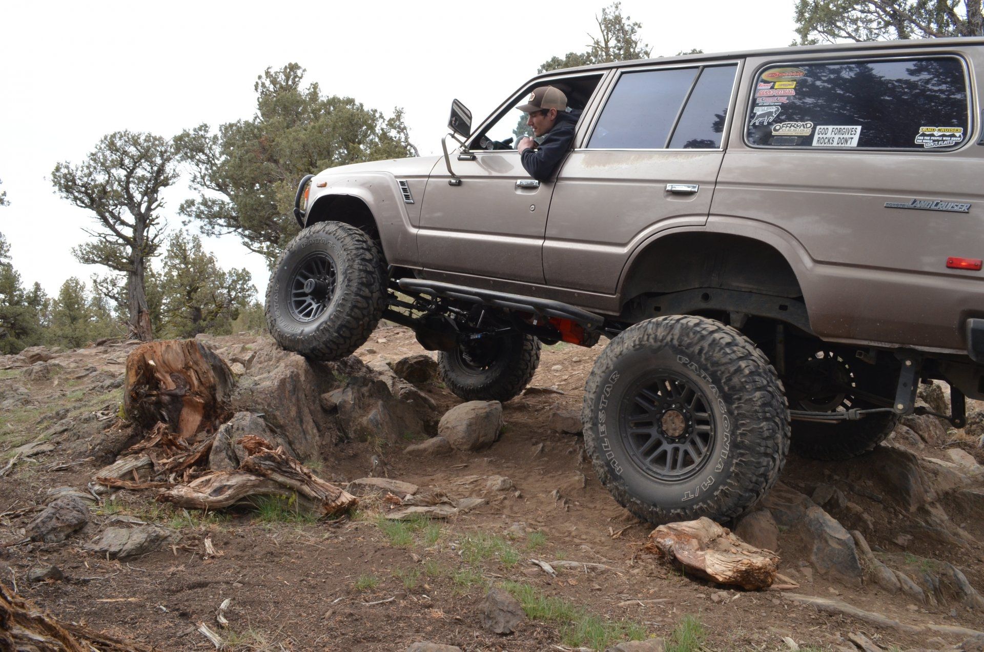

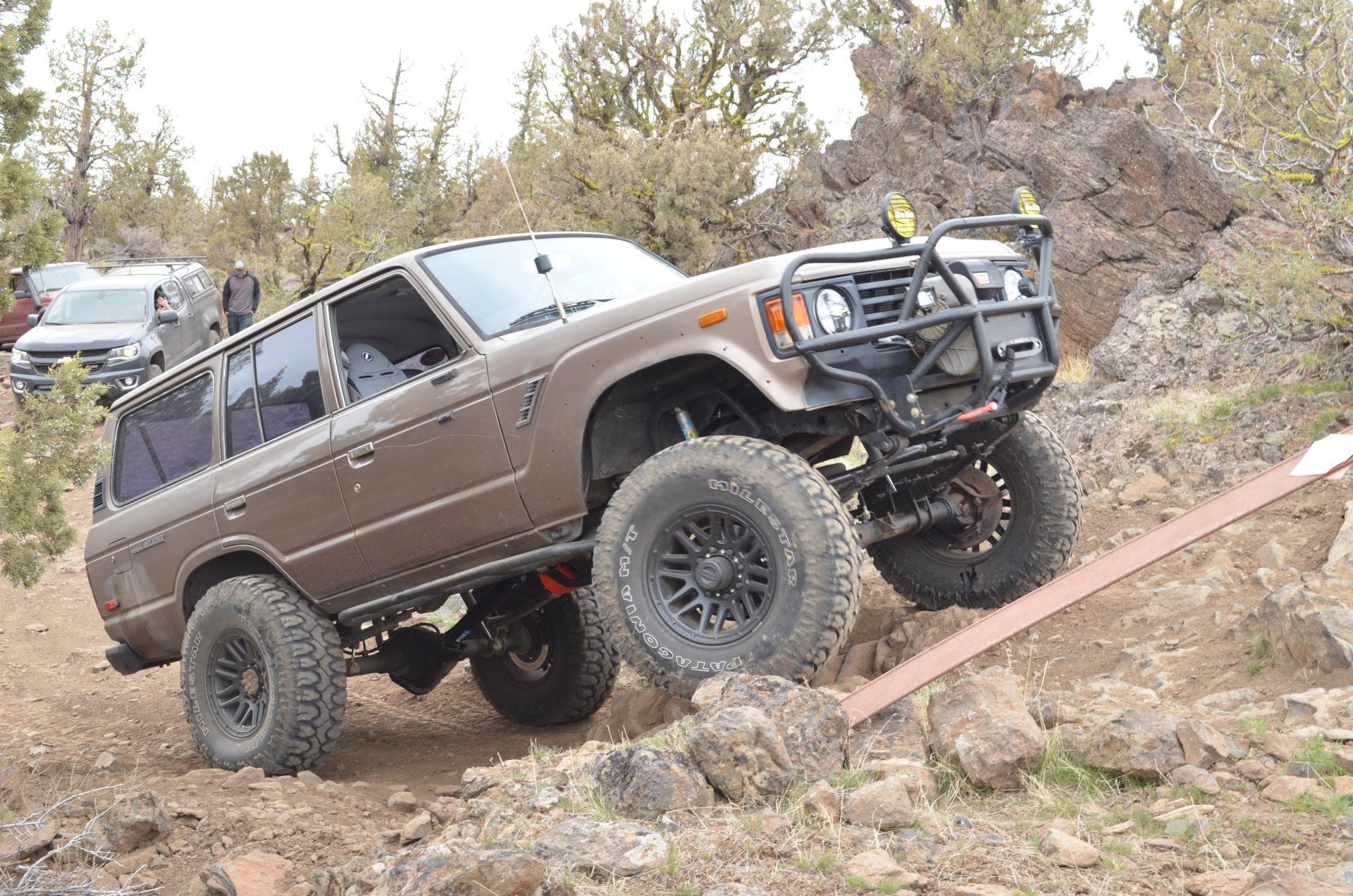

Took the cruiser out this last weekend and wheeled it for 2 days plus about 280mi driving round trip. Performed great! The trans is making excessive noise but shifts better than my last sm465. The doubler was awesome, complete control and lots of speed options depending on the obstacle. Totally a game changer!
I’ll post some pictures when I get them.
@Hojack absolutely! We were at Cline Butte OHV, about 15min NW of Redmond. It’s my favorite place to camp and wheel, love central Oregon.
I’m always down for Land Cruiser get togethers!

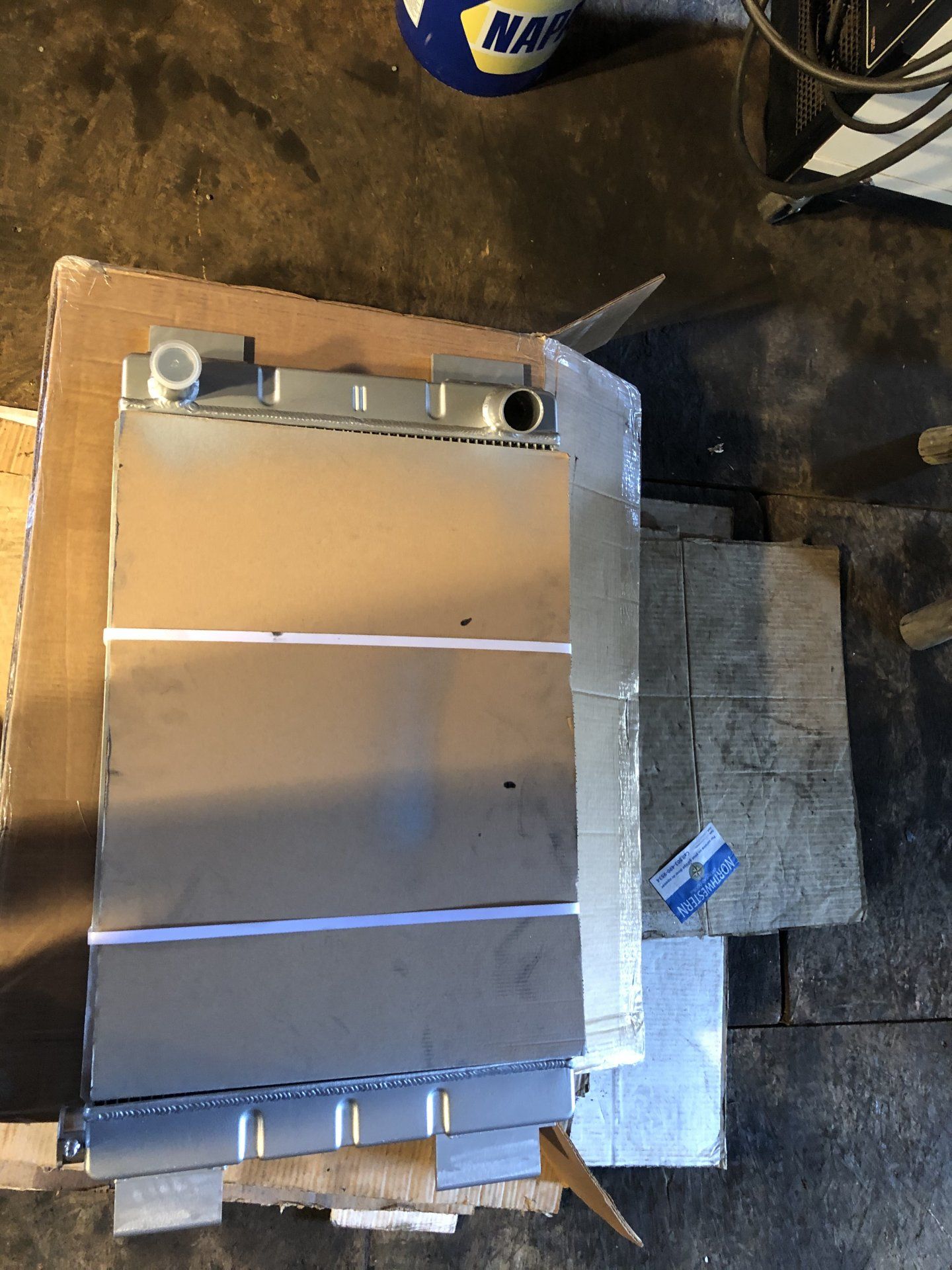

As to the radiator, I used 50/50 mix this last time and the rad is grounded (although I might make doubly sure with a ground strap). My brother and I changed the afr and idle timing, which has helped my temps a lot. My previous 2 radiators broke from excess twisting of the rad support, near as I can tell. I have that sorted now too I think...

I have a new LS style radiator installed, premixed coolant, system is bled (I’ll be rebleeding it today). Everything appears to be working correct and I still can’t keep my low speed driving temps down, I got up to 240* in town (stuck behind a city bus), so I whipped into a parking lot and shut her down.
I ran this same setup just a couple weeks ago wheeling and the temps stayed in the 210-215* range. Flip the secondary fan on and usually it slowly cools down.
So I adjust afr at idle from 14.2 to 14.5. I also moved idle timing from 12* to 18*.
I also plan on venting my hood, any other thoughts?
How often do you drive it? I bet you just have air in it still. Have you verified the sensor is good?
I drive it a couple times a week. I think I still had air, I rebled it and with the other adjustments, I made it did great. I only ran one fan on and tried all day to overheat it in about 80* weather and hottest it got was 211* about perfect I think! Stopping and starting, high gear and low speed driving in town. It averaged out at 205* which I have no issues with.
I’ll be keeping a close eye on it this summer on the hotter days for sure though.
Hood vents are definitely on the menu.
What thermostat do you have?
At some point I may swap for one of those 160* tstats, a lot of LS guys seem to like those in built cars with less air flow. My bumper and stuff probably blocks quite a lot of flow. But so far having swapped to a 16psi rad cap has helped a lot.
