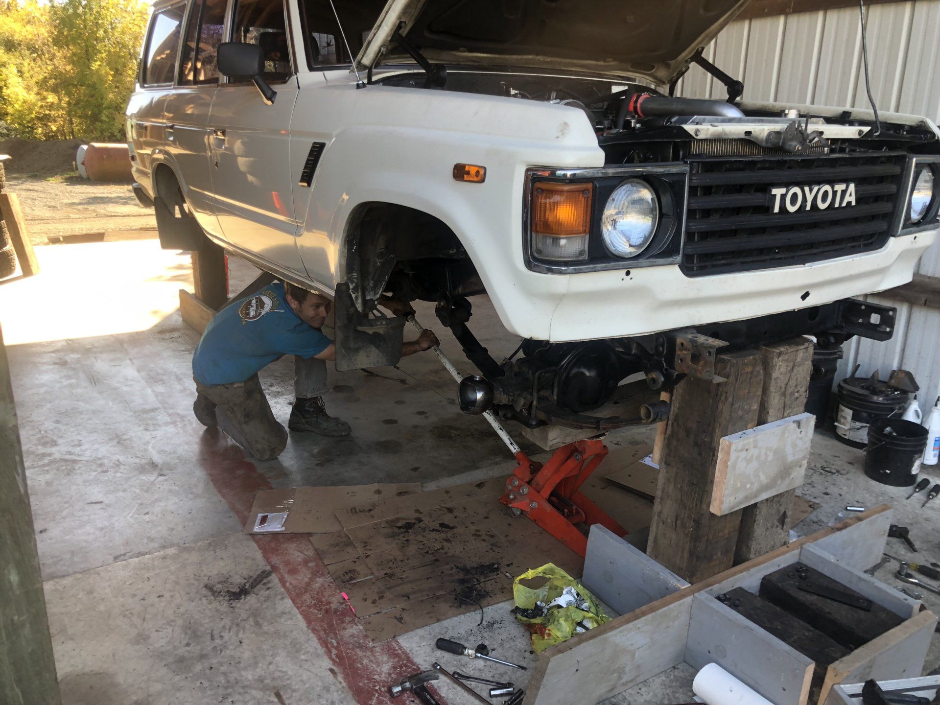

Basically we removed the tires so we could lower the rig as close to the ground as possible. This makes it much easier to remove the axle as there isn’t any drop. The rigs on jack stands, with the tires sitting under it currently, because I’m a bit paranoid of the whole rig falling to the concrete.

Axle out.
Currently this is how it sits, the final parts are still arriving, and I hope to finish the front axle install next weekend. I maybe able to do the rear axle at the same time. Shouldn’t take very long to do the rear axle.
