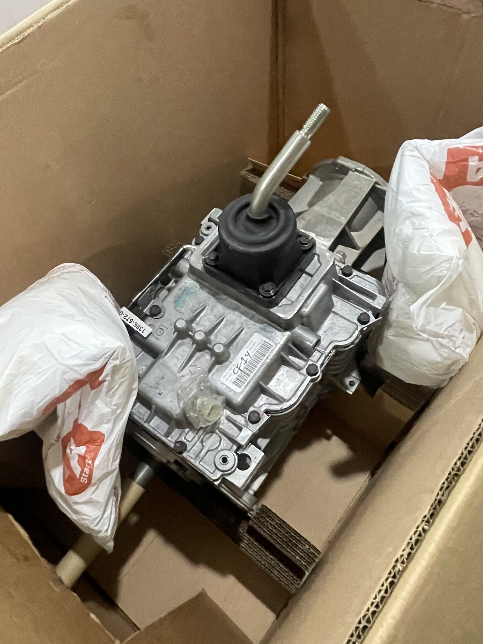

This sweet unit is headed your way in a few days. :cool:
This is gonna be sweet! I’m still working out what I’ll be doing for transfercase, so it’ll probably be a few months before I set time aside for the install. But having that sitting in the shop should be motivating!
I’ve been very busy with work but this is sitting in the shop ready to get installed! Thanks again @cruisermatt
I am saving for an Atlas now for it, although exploring a few options I think the Atlas gives me the best bang for buck… The drivetrain alone will be worth more than I paid for the truck haha but I want to build this to last.
