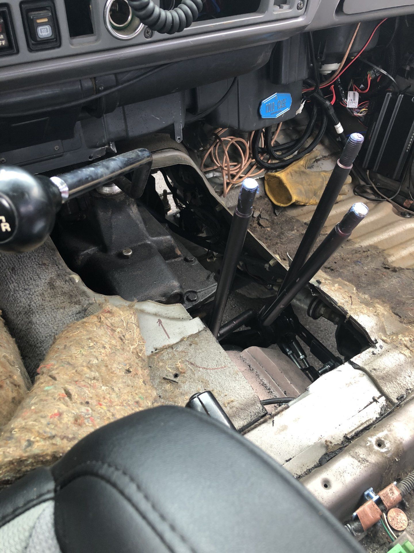

Late November I started removing the loudly protesting SM465 and NP208 from the truck. I assumed from there it would be a simple matter of reinstalling my spare 465 and then attaching my 203/205, then building a crossmember.

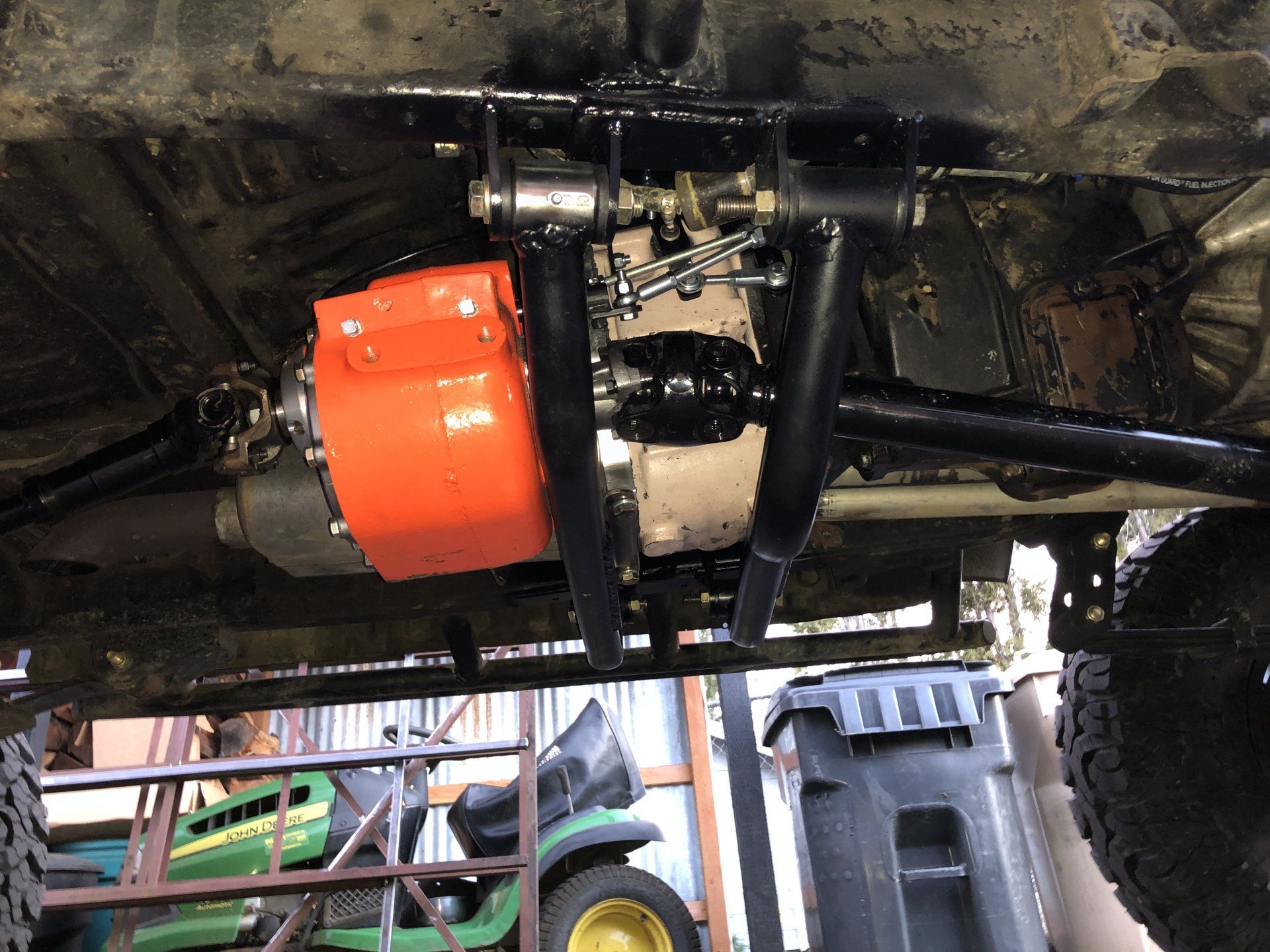

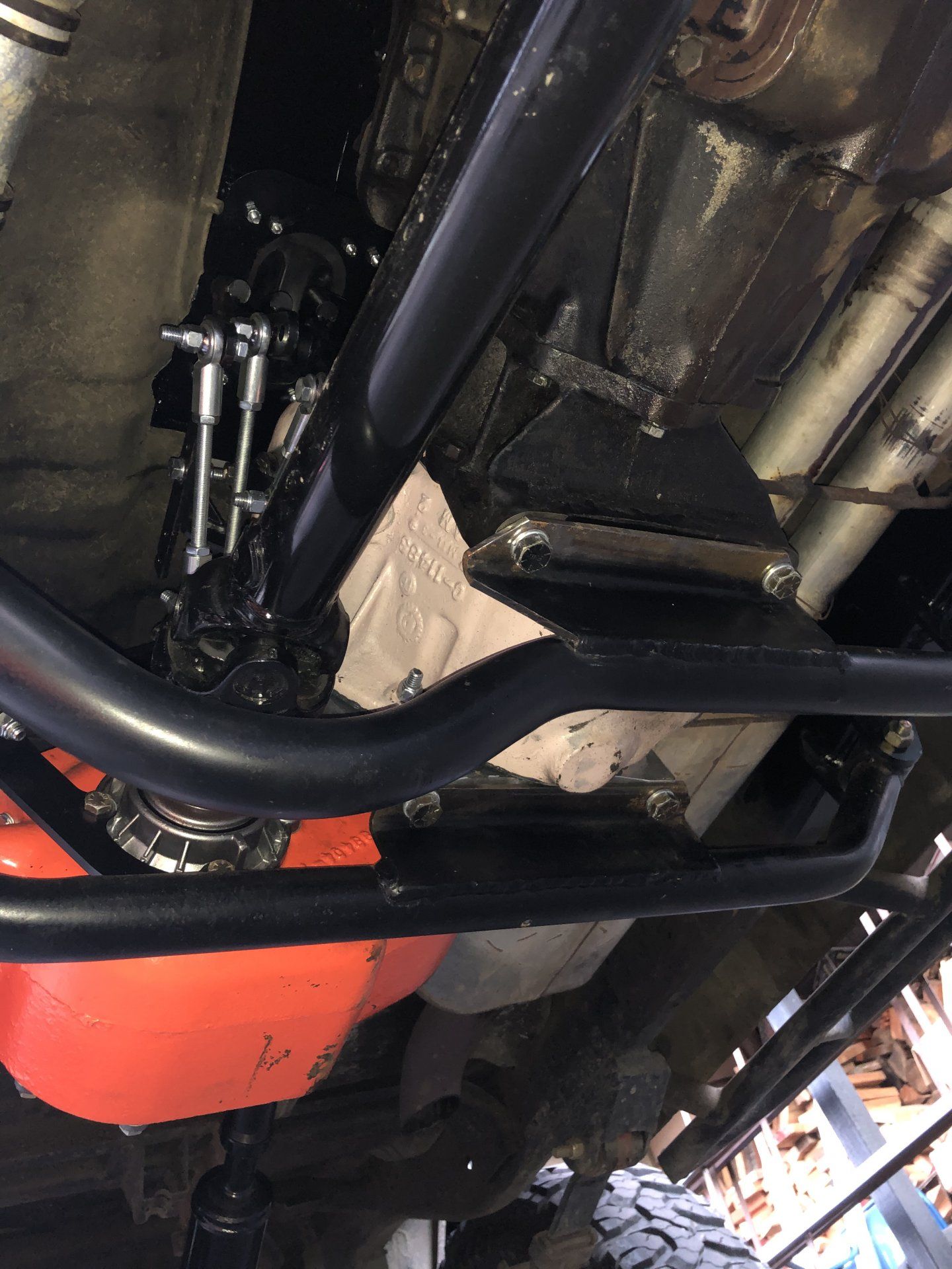

Something I noticed immediately with the ORD 203/205 doubler kit is that the instructions leave a lot to be desired, for the money spent I would have liked a little better pictures and explanation at a couple key points. Either way though I figured it out, assembled the cases and strapped it up into place with ratchets. I think another thing I completely underestimated was the weight of the assembled unit. The 465 is, of course, cast iron, as is the 205. Added to that is the range box and doubler adapter. Even with jacks and two people it was a bear, ibuprofen is recommended for the after party.
By this time it was February and with the work space I had available it wasn’t feasible for me to build a crossmember, between work and planning a wedding my time became even more limited. As such I hauled the Cruiser into RJs Chassis in Salem and let Jim do the fabrication. Russ and Jim are grade A guys, I think I’ve known them now for about 8-9 years, always quality.
Jim came through on the crossmember and I brought it home. Had driveshafts made by Full Torque (another good experience) and installed those by mid February.

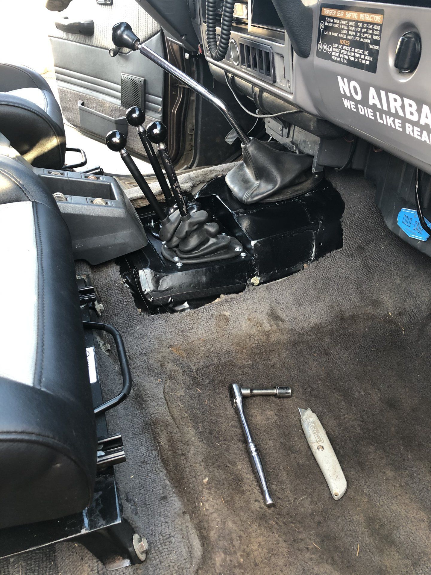

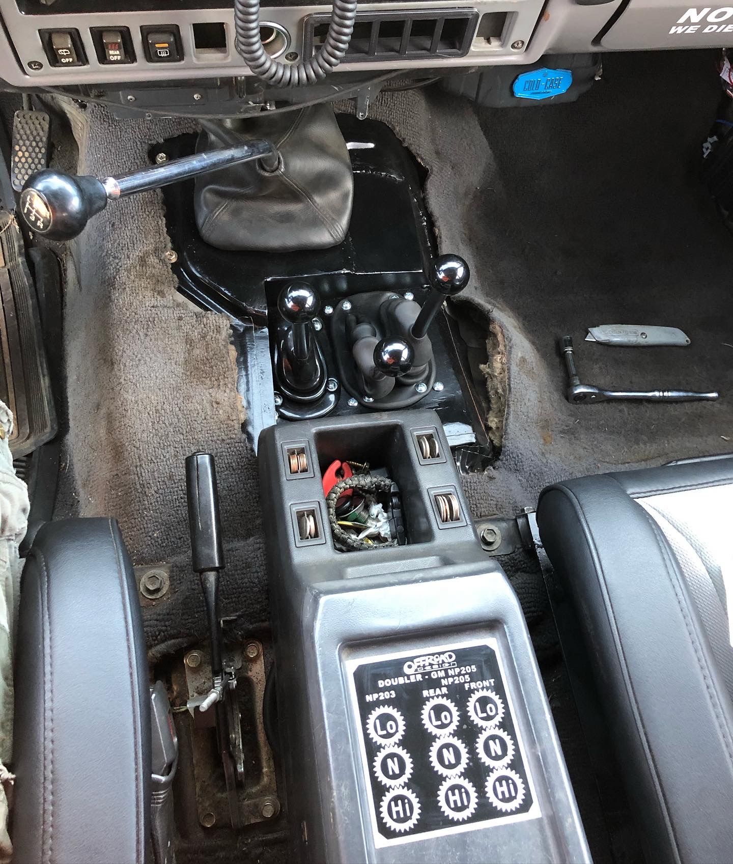

Its a driver again so I built a trans-tunnel cover, filled the cases with oil, installed the triple stick shifters, and took it for a spin!

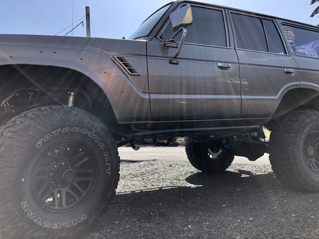

I think if I had bought a clocked adapter it would have been a lot tighter to the floor. I’m not sure cutting it out would have helped to much there is still room, but the 205 is a big unit. As it is I have 20” at the lowest point and 22” at the rest. Im headed out this weekend to put it to the test.

what bellhousing do you have and what's your motor mount situation? solid mounted 203/205 on one end and aluminum SBC bellhousing on the other, the 203/205 is going to win that battle. Keep a close eye on your bellhousing and 203 bolts. I shattered my bellhousing in last year
