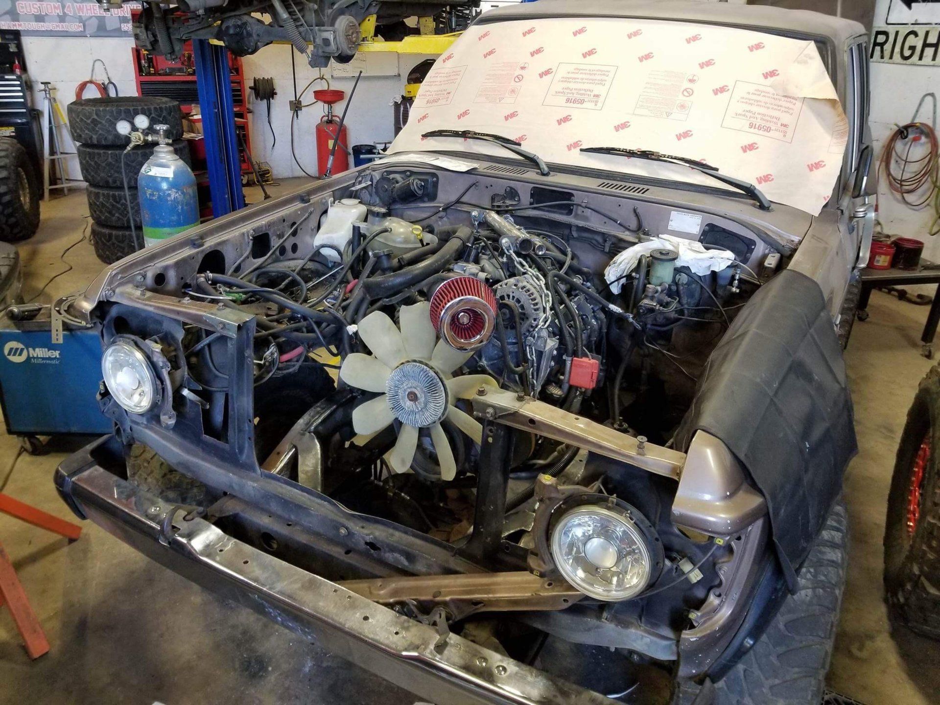

Partially installed, motor mounts are welded up and they are working on fabbing a new trans crossmember. Had some issues with the shifter not clearing the front of the trans tunnel cutout, but I think with some massaging that it will all work-out. Otherwise it’s probably about two weeks out from completion (of the engine install phase), so once it’s back I need to install the wiring harness, fuel system, and exhaust.
And prepare for the plethora of things that I didn’t expect to have to prepare for...

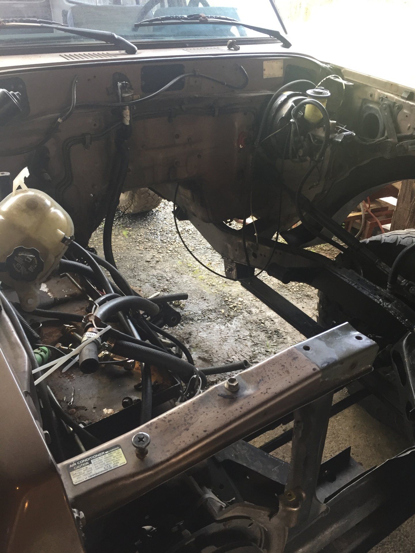

It’s back, time to pull the engine (hopefully for the last time) and install the clutch.
I still have to figure out exhaust manifolds, wiring, fuel delivery, and all the little details.

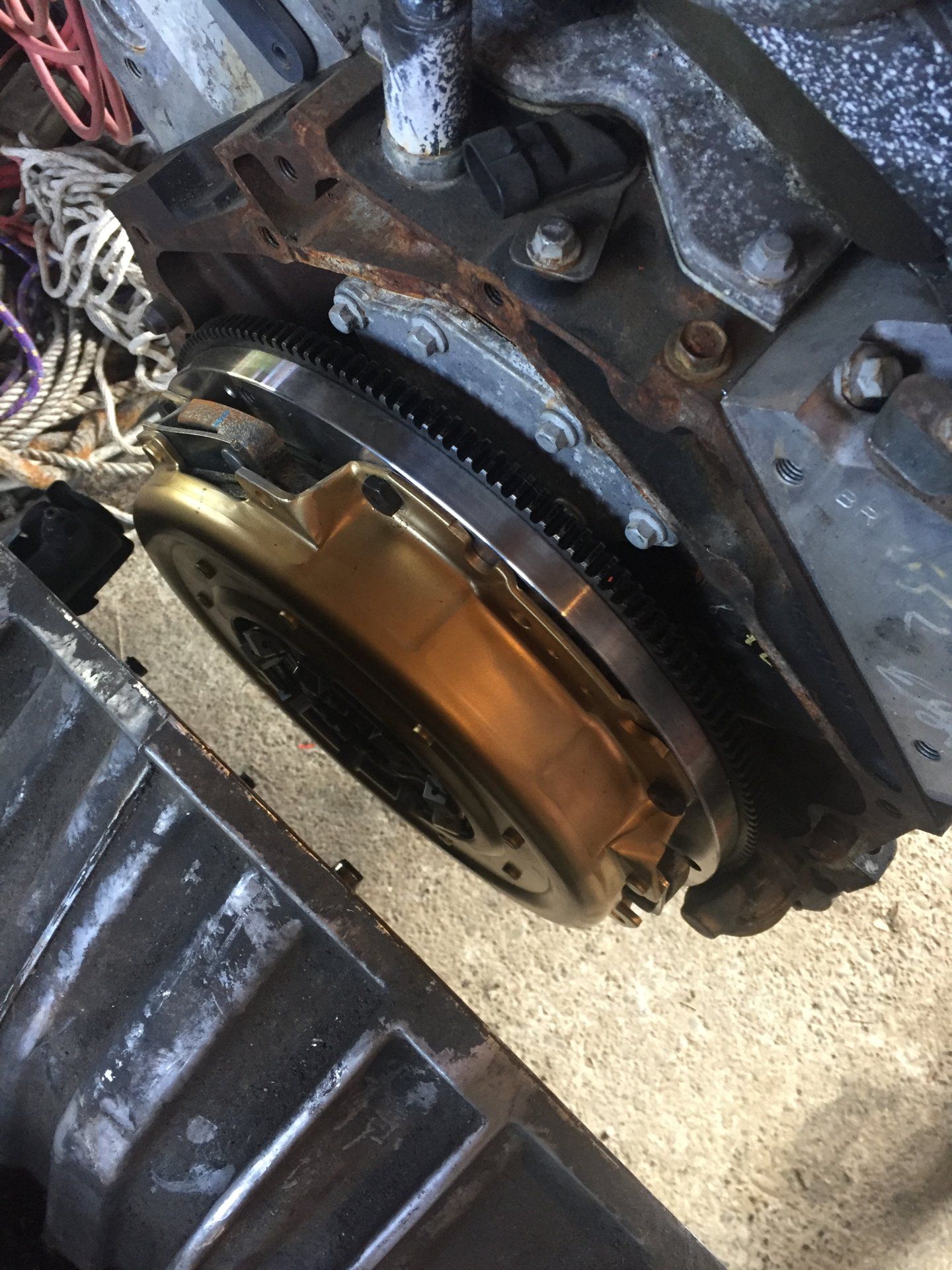

Clutch on, it’s a Centerforce clutch. The whole kit from Advanced Adapters was well put together but missing a couple little things in my opinion. A part number for the correct pilot bushing would have been nice and a clutch centering dowel was sorely missed... it’s the little things.

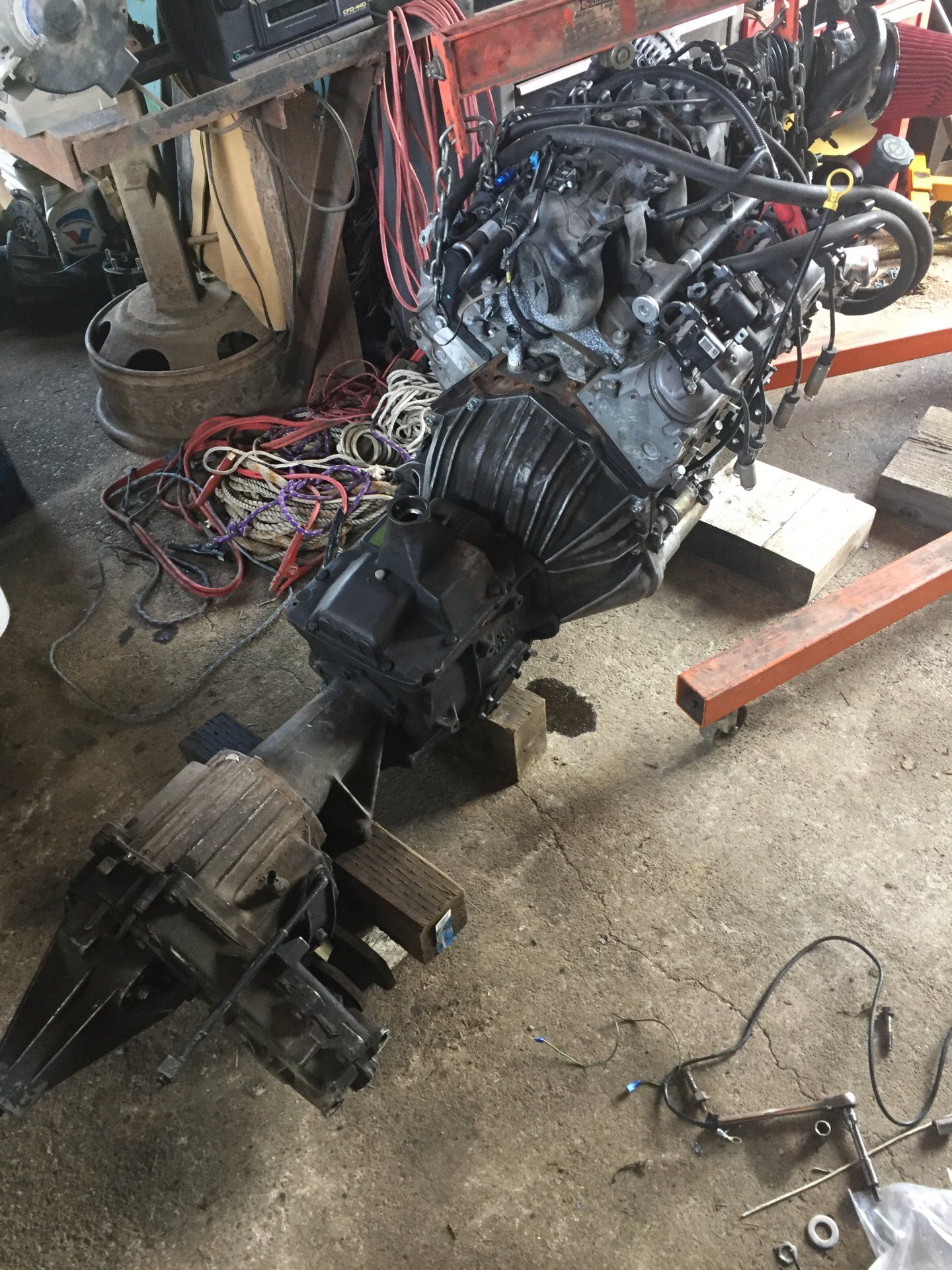

All back together and ready to reinstall.

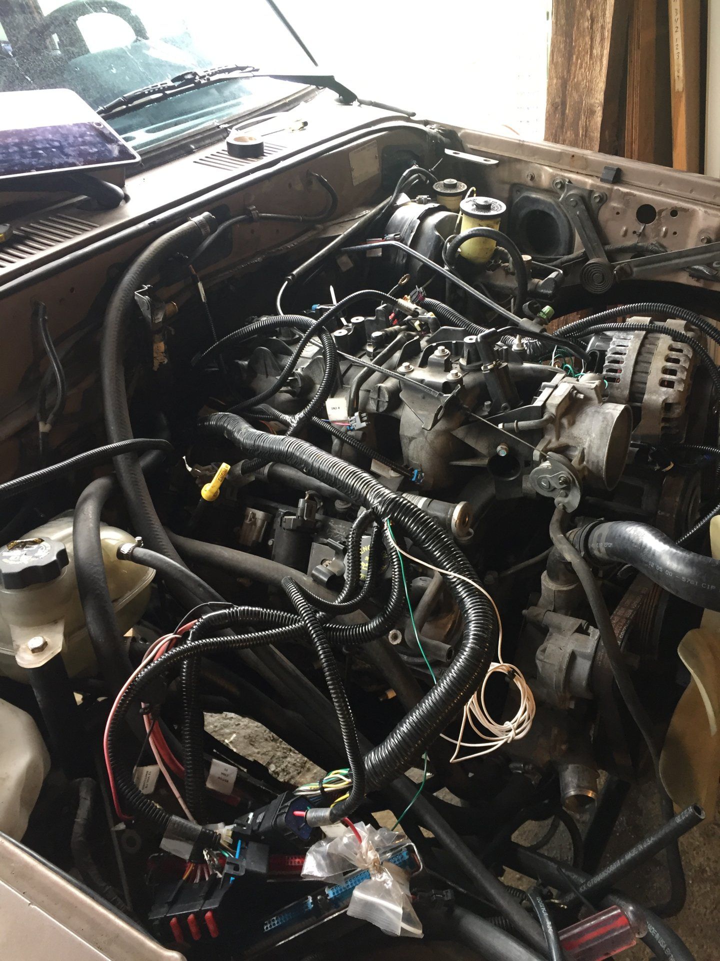

My wiring harness from Schwanke Engines has no provision for O2 sensors. I guess this is part of the issue of buying the loom second hand... so I guess I’ll need to find what pins those use on the ECU plugs?
It runs and drives! Feels crazy to have it at this point, I'll post a video if I can figure out how.
