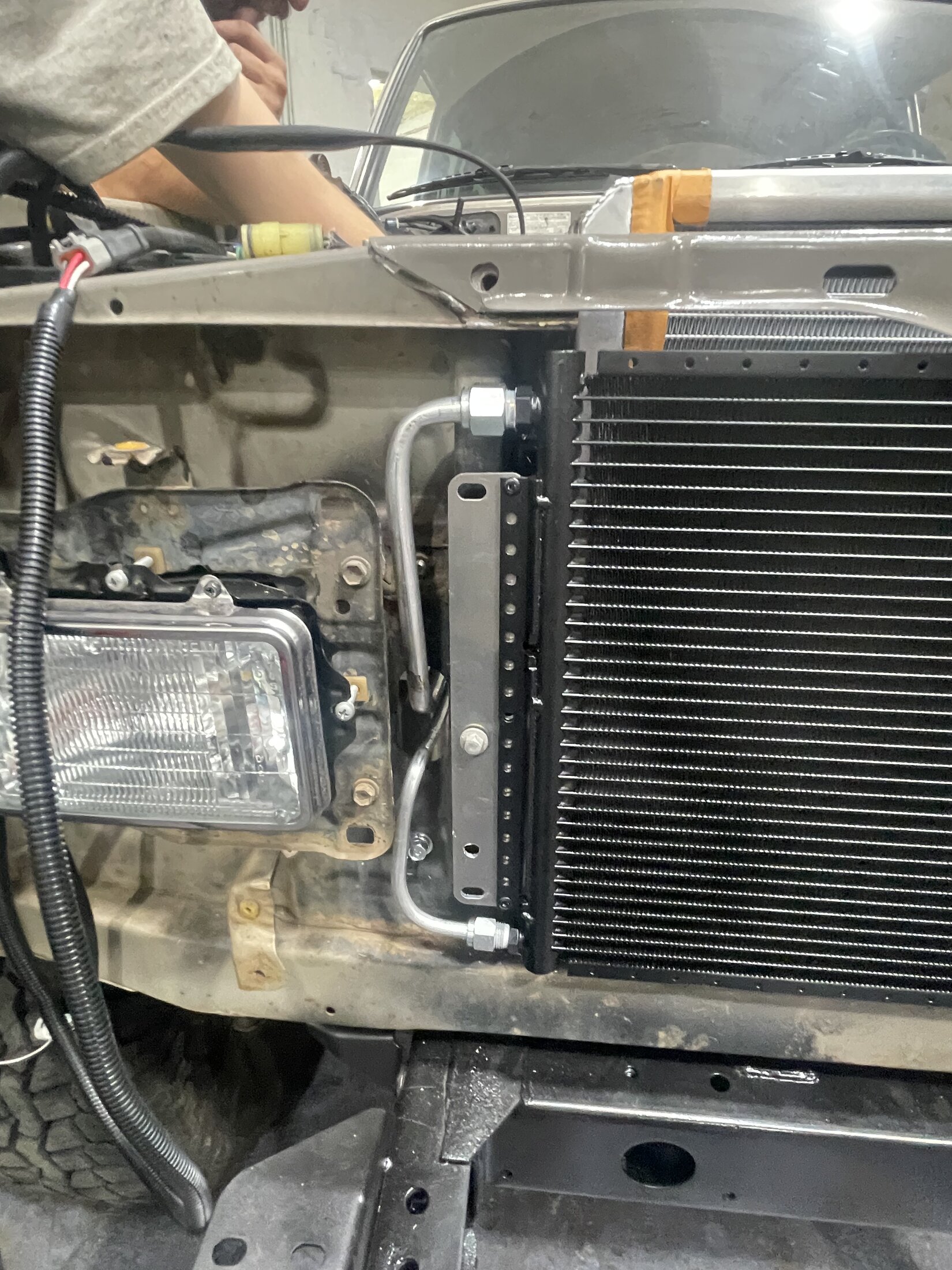

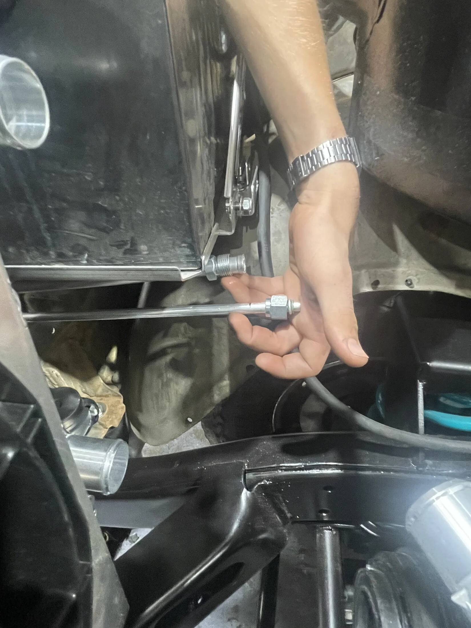

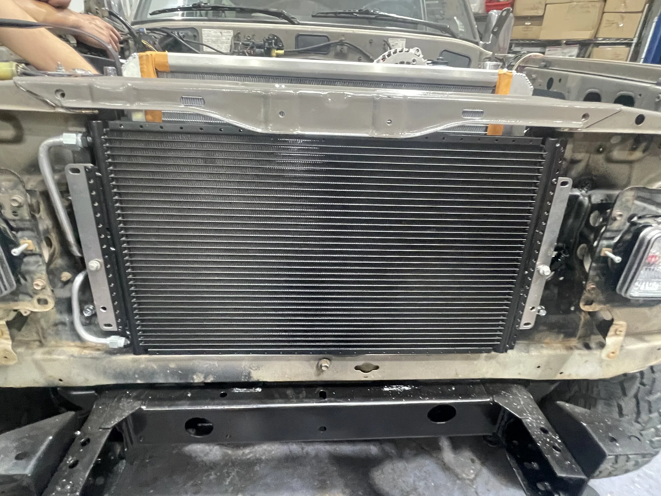

Working on getting our templated lines manufactured, and a braket designed to bolt to hang them under the battery tray. There will be both 6/8 male ends in the lines there and then the next step will be premade hose options to go from them to LS/2F/3F
@cruisermatt how we looking? This heat wave on the East Coast is brutal
@cruisermatt how are things looking on this? Any potential timing/ETA?
Thanks for taking this task on
Still in the process of manufacturing the pre-bent tubings.

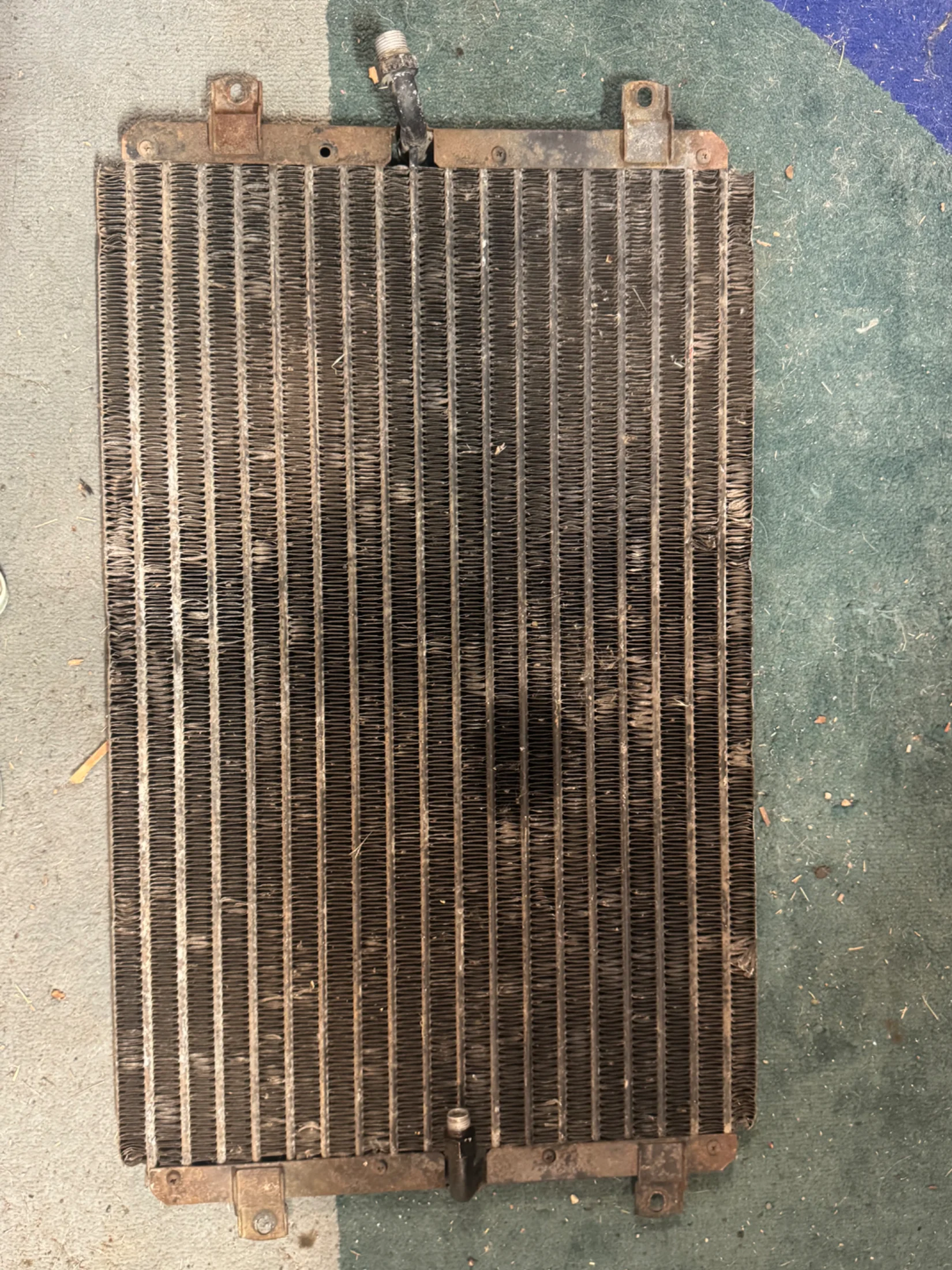

I have a leak in my condenser (and summer is fast approaching) and will need to replace it as it doesn't look like a repair is in the cards on this one; after doing some research, it appears that the OEM unit is no longer made/in-stock. I've done some reading that the Jayair CN-6297 is close to a stock fit, but I can only find these in Australia.
What are folks in North America doing when needing to replace their condenser? Do 60/62 series share the same condenser?

Yea I would like to see pics if anyone has them. I just receive samples and can duplicate but I have them all mixed up and my original catalogs are not matching up with the vehicles. if you have any diagrams or even pics of your originals that would be helpful.

So from the pictures I have received and the ones I have sold I am thinking the one in the picture is 88460-90A00 08/80-04/84 USA 2F Gasoline. They are all very similar in size with some minor changes in fitting directions brackets. But you have all been very helpful.

I and Mosley both have LS hose kits already for both 80-84 and 85-90 condensers.
