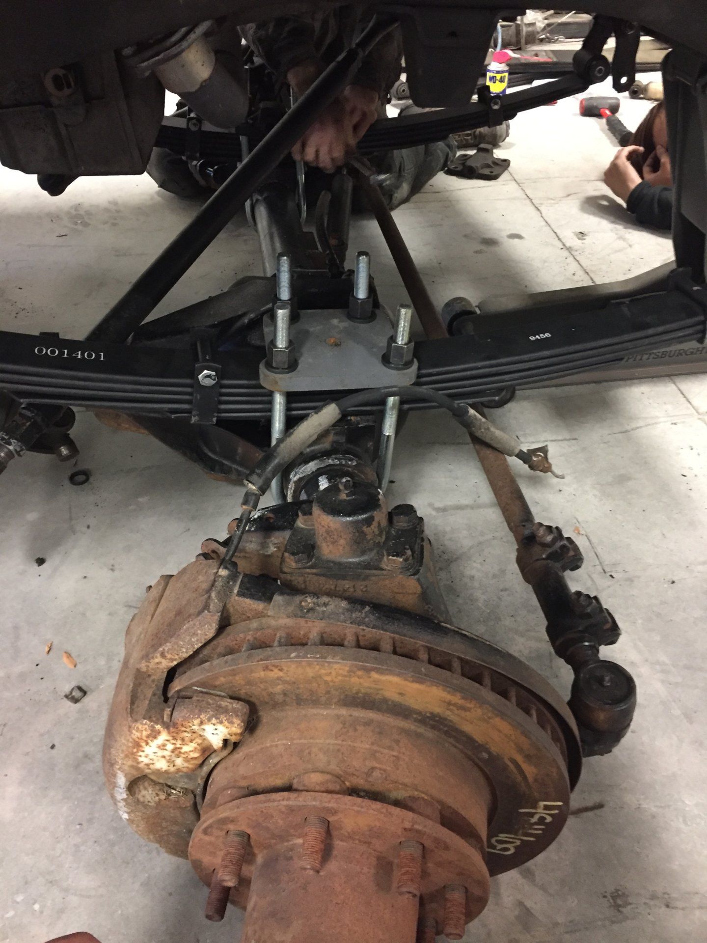

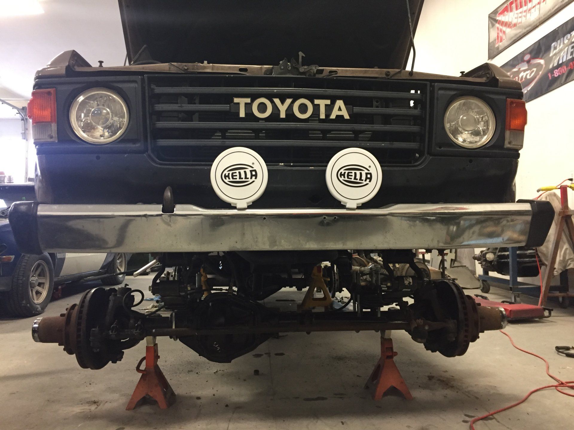

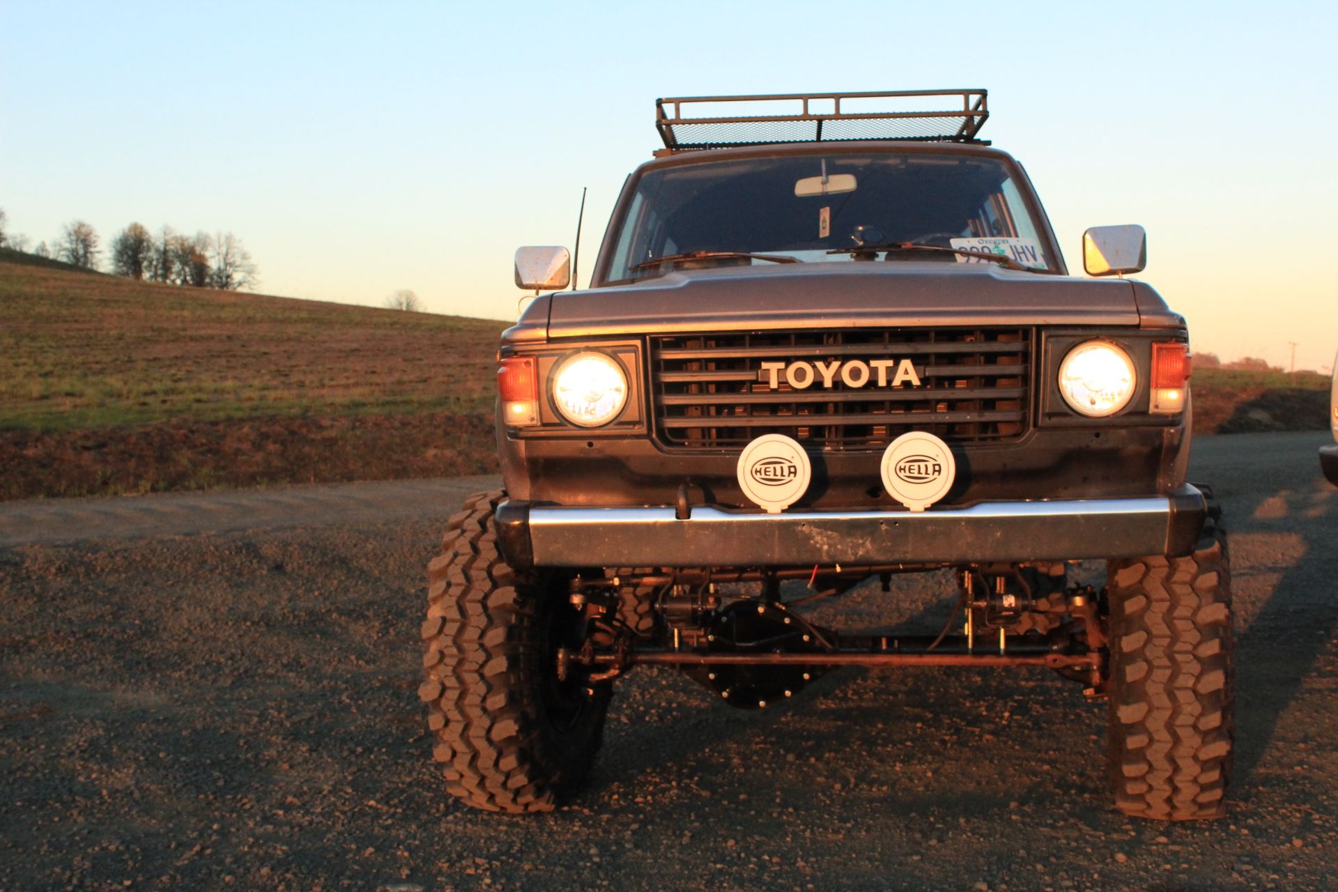

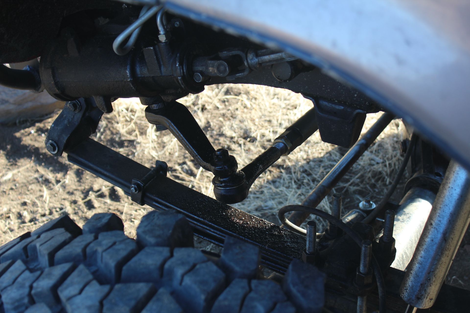

Both axles are underneath the 60, things did not quite go to plan however. The shackle angles are terrible in the front with the actually arched springs. So the springs will need to be shifted forward and the shackles may need to be addressed or changed. The rears are okay because nothing changed but those may need to assisted at some point as well.
So I still need to figure out/install steering, brake lines, rear disc conversion, 14 bolt gear change, rear locker install, ECU re-pin for O2’s.
Also I realized that once the 37s get under this thing, it’s going to be huge... so the suspension may need to be readdressed at some point. Again.... it’s going to be stupid wide still as well.

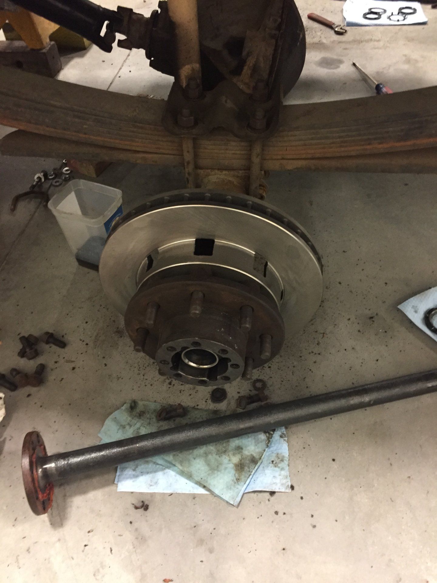

I got more done on Monday, stripping the brakes off the 14 bolt for the disc conversion. Ran into a road block when I tried to repress the studs into the hub after the drum was pulled. I tried the lugnut method and I tried a hammer, both failed. Without an actual press I’m pretty stumped.
Well shoot, a lots happened...
After having my bearings pressed at my local machine shop, Custom Machine in Dallas is great, I was able to reassemble my 14b without further issue.

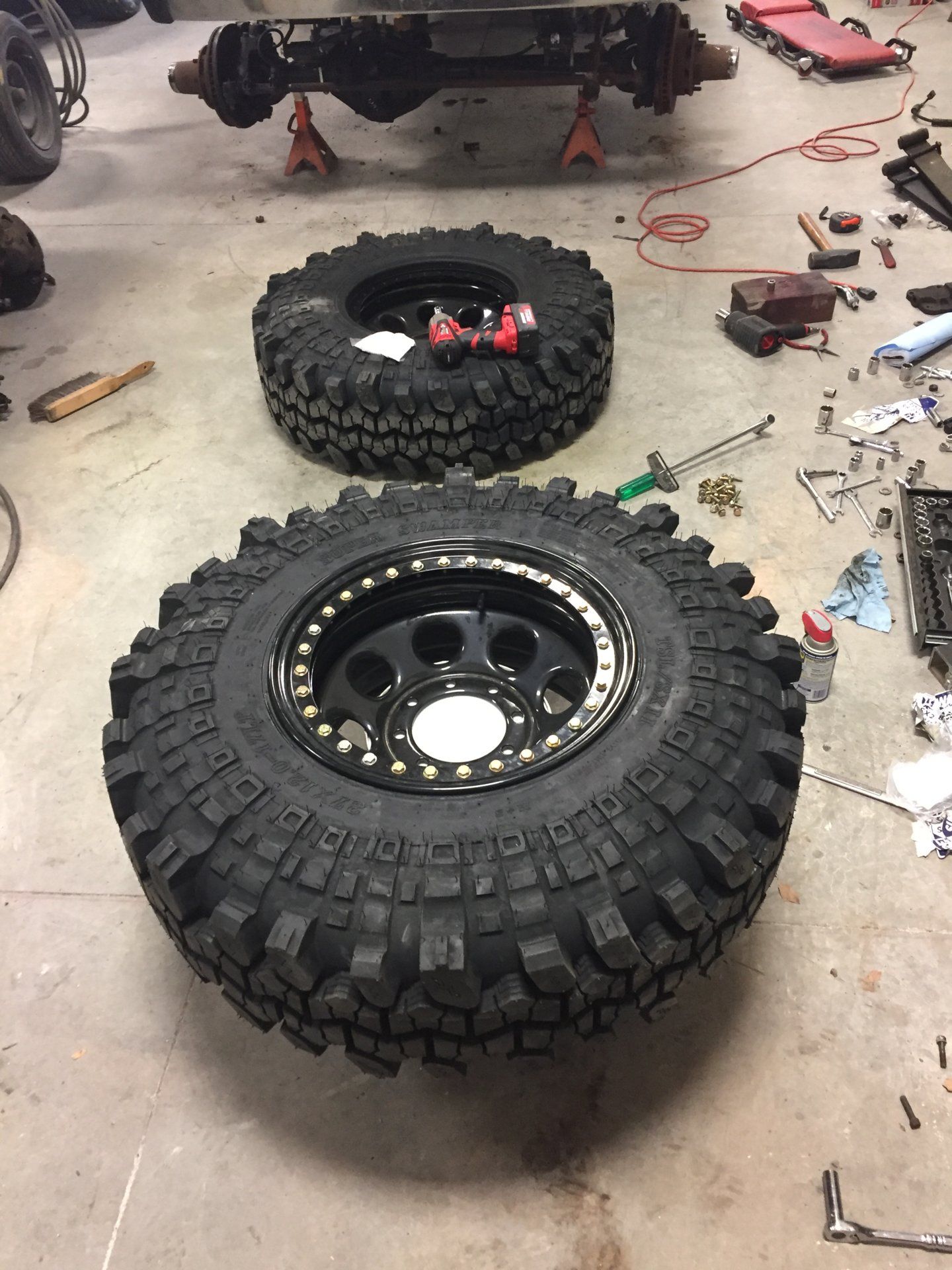

Assembling my beadlock rims and tires (Battleborn rims and 37x12r17 SX2) was straight forward but incredibly time consuming, and a bit nerve racking from time to time. So that took nearly a full day off and on, occasionly doing other things to maintain my sanity.

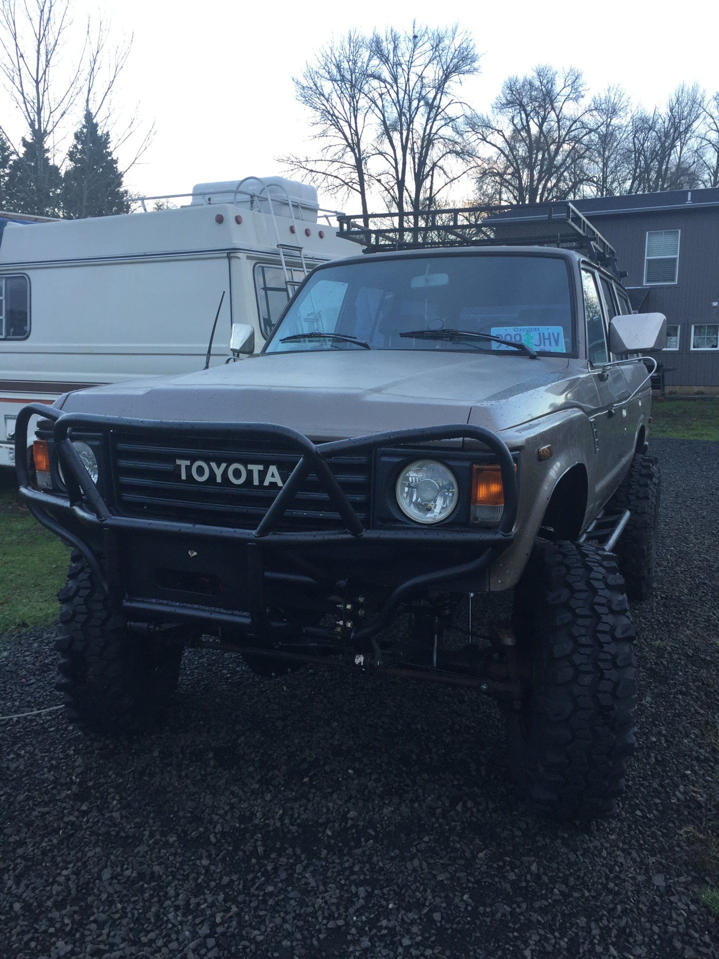

Okay so after all that it’s know at Hamms Fab getting armored. And with that, this thread is all up to date, I should be able to go pick the Cruiser up in about a week, and hopefully take it to go find snow soon.

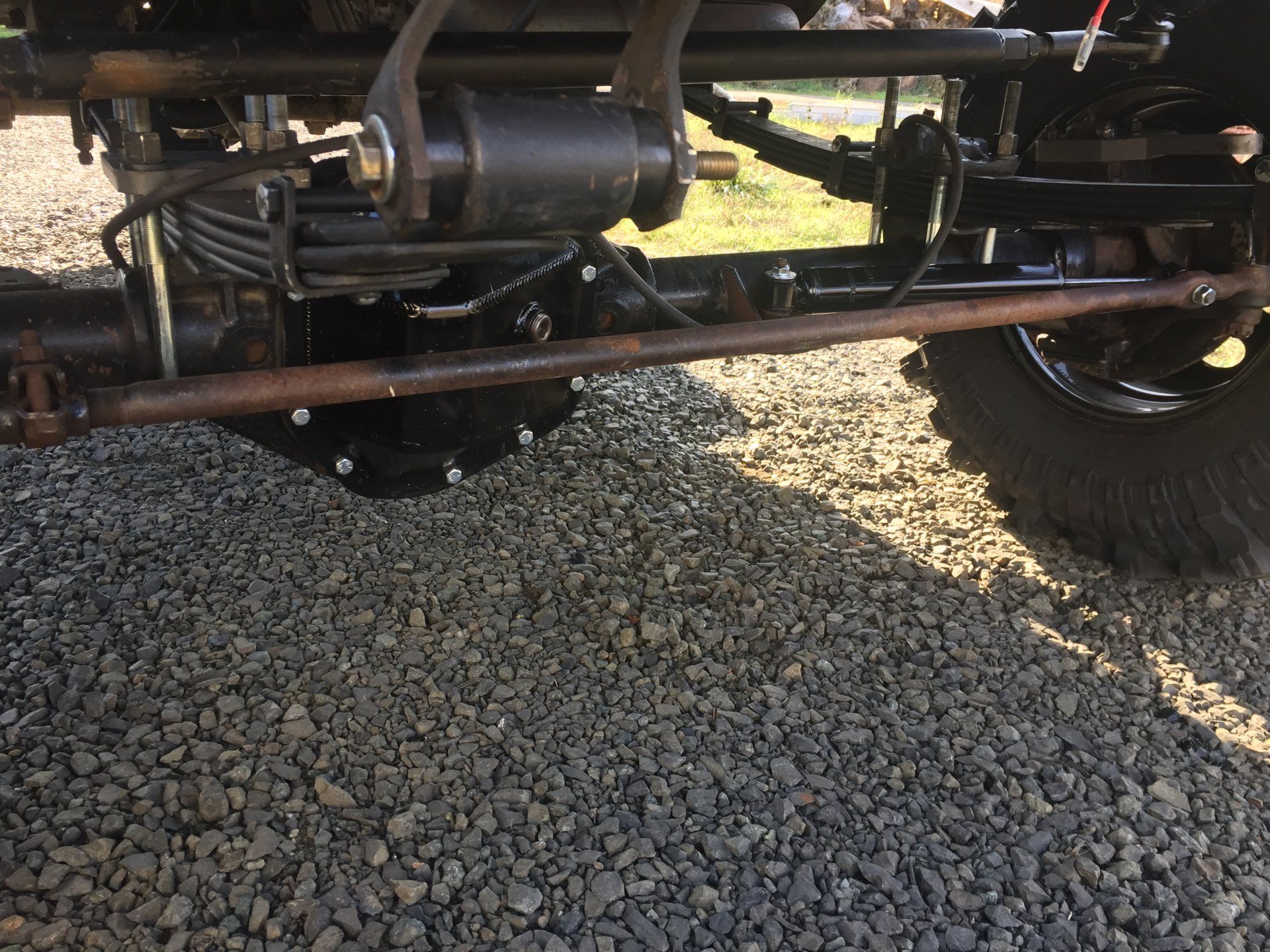

IMO I think the front spring frame side mounts need to be redone completely. I'd outboard the front shackle mount to be able to run a straight shackle rather than the offset one. Once we get @Hojack squared away we could make a trip out and knock those out. I'm glad you got rid of those lift blocks up front too.
Yeah, those thin offset shackles seem like an disaster waiting to happen. Are they even 1/4?" I agree with @boots4 , you want a short straight shackle that's 3/8" thickness.
The Detroit is pretty manageable I feel, it “unloads” at random times, usually in parking lots an such. People always think I’m breaking something, it’s pretty loud. But on the road it’s fine, I’ve had a few other rigs with Detroit’s before.
The shackles are on my list, I should probably move them up in the order though... most of the suspension hardware is on the list. It’s all holdover from the “shop” that swapped the 6.2 diesel in. A shop that I hope has since gone out of business, sketchy work. Those lift blocks are case and point...

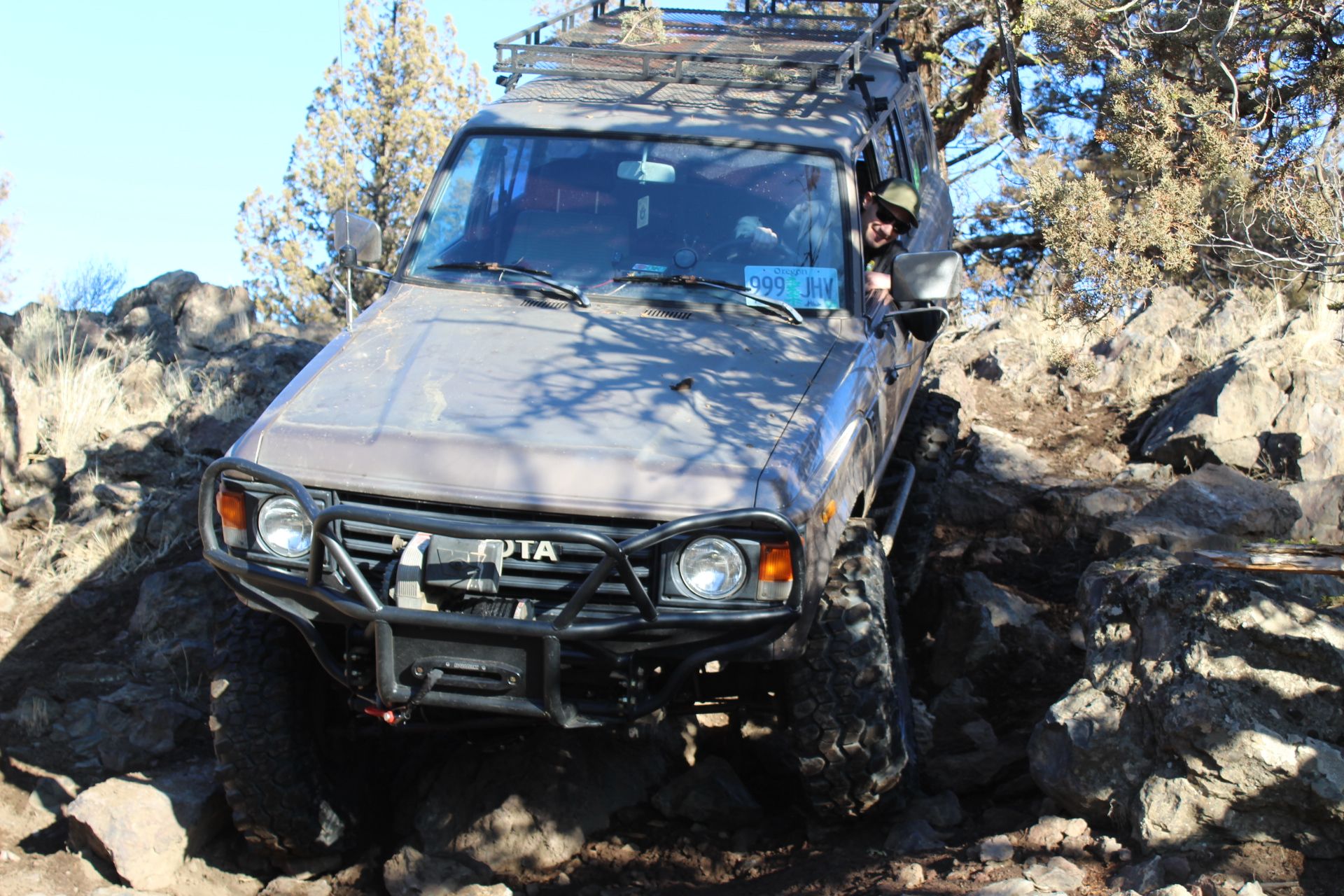

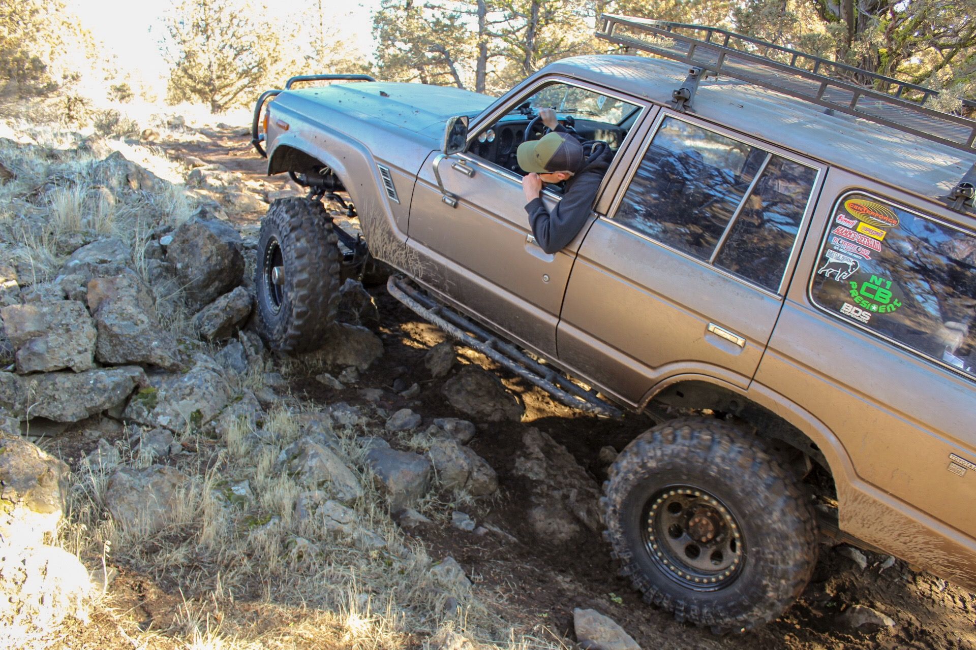

Went wheeling at Cline Butte. I think I blew the rear seal on my steering box, I bonked my diffs more times than I can count and broke my already cracked rear pass taillight. It was a great trip though, it did great on the rocks.
The SX2s hooked great, as expected, and the suspension did great. It had plenty of crawl and plenty of grunt.

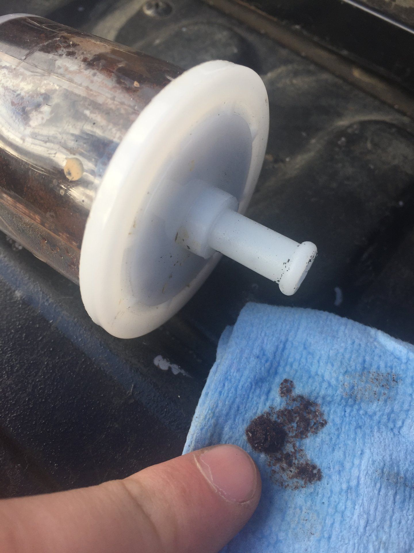

This is what I’m up against:
I can’t go below half tank without this packing up my fuel filter. Anything above that I’m pretty good. I carry a lot of spare fuel filters around...
