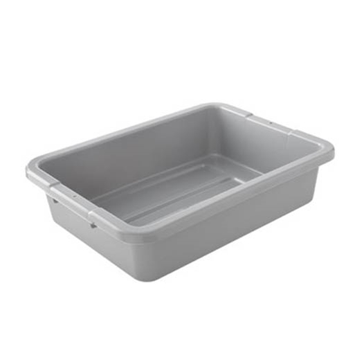

Find your local restaurant supply and buy a couple dozen bus bins.
bottom side left front goes in one bin, bottom side right front goes in one bin and so on. All the small stuff goes in a ziplock in the appropriate bin, use separate bins for engine hardware verses body panel hardware you get the idea. Keep everything separated by location and type then label and stack on shelves. Clean and organize one bin at a time before you go back together.
I can have up to 6 cars going in my shop at a time and this is how I keep track of them all.
Buy good ziplocks in random sizes.
