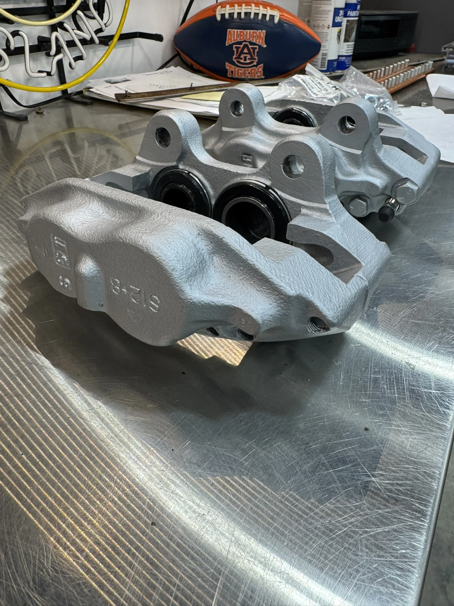

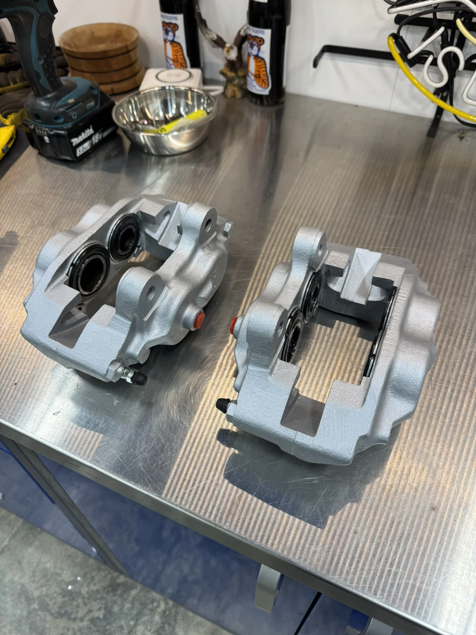

Put the internals back into the disc brake calipers in between football games. Maybe not quite as pretty as the ones that @J Mack pulled out of a box but I guess they will have to do. These things were a bi*tch to clean up btw.

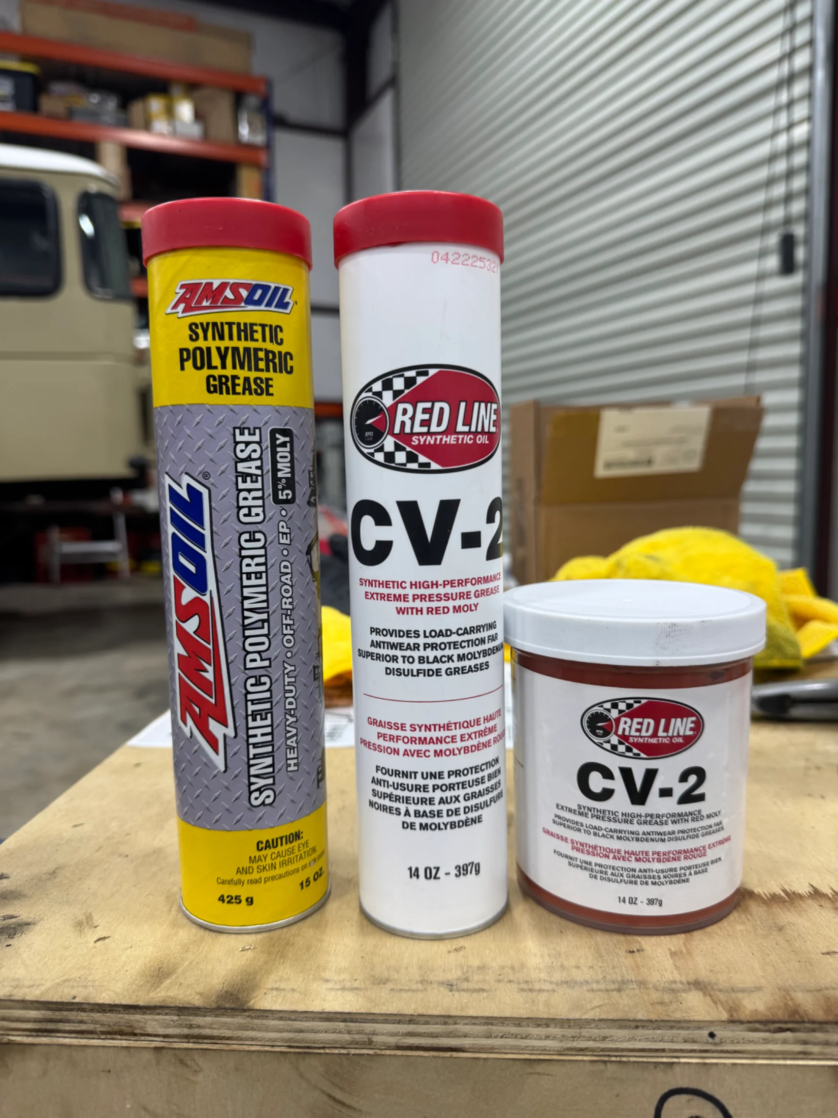

…and in the nobody cares but FWIW category, I threw away all my 10 yo+ Mobil 1 and Amsoil moly fortified today. I was still happy with the Amsoil product but it’s hard to tell the shelf life on grease. I’m a huge Mobil 1 oil fan but their synthetic bearing grease tends to leak out of grease guns, even Alemite guns. So guns are now loaded with these two greases. Of course the Kubota still has its own grease….just because.
