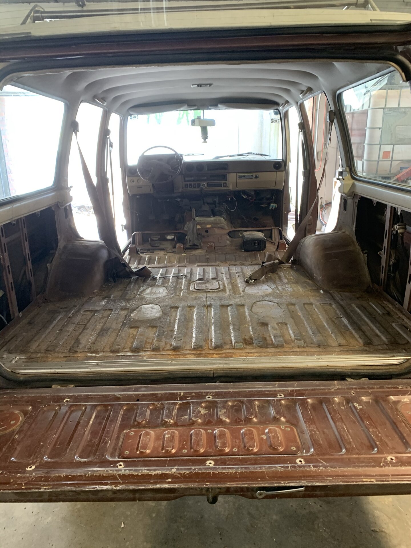

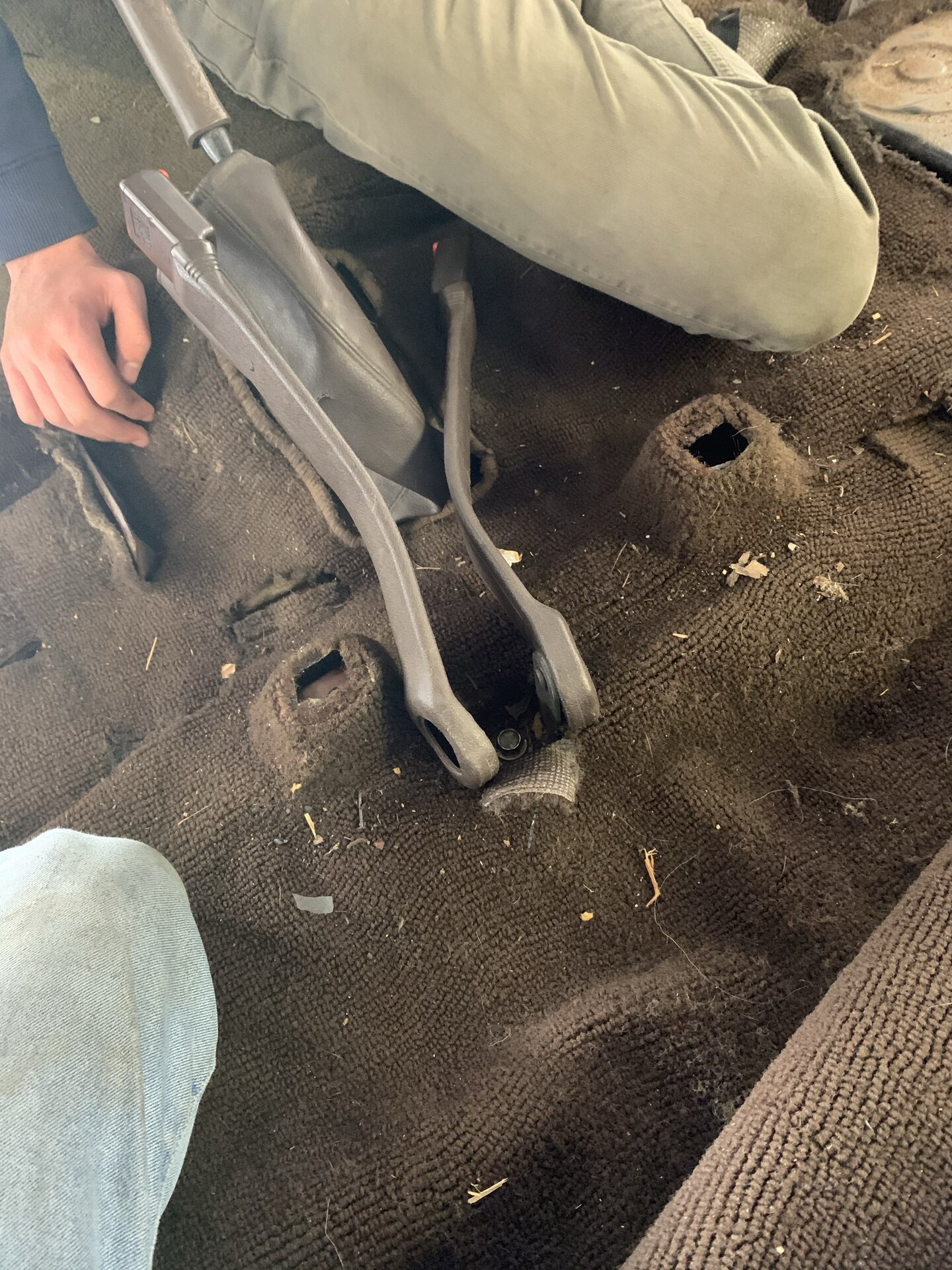

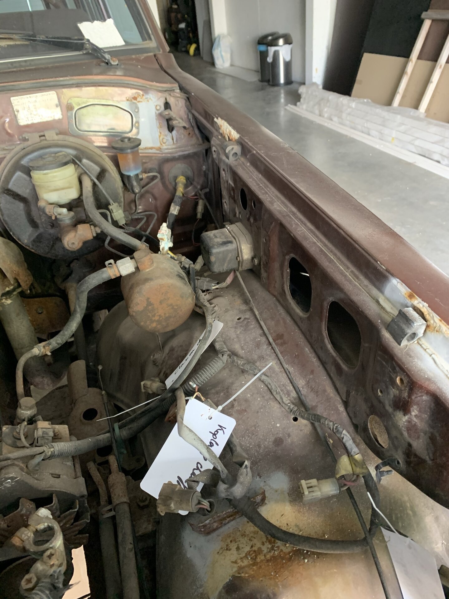

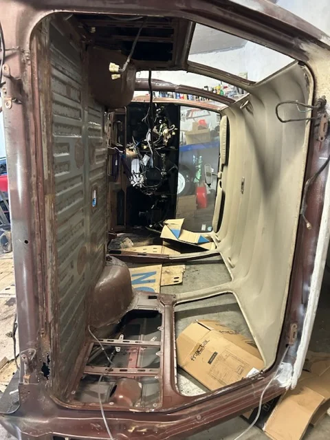

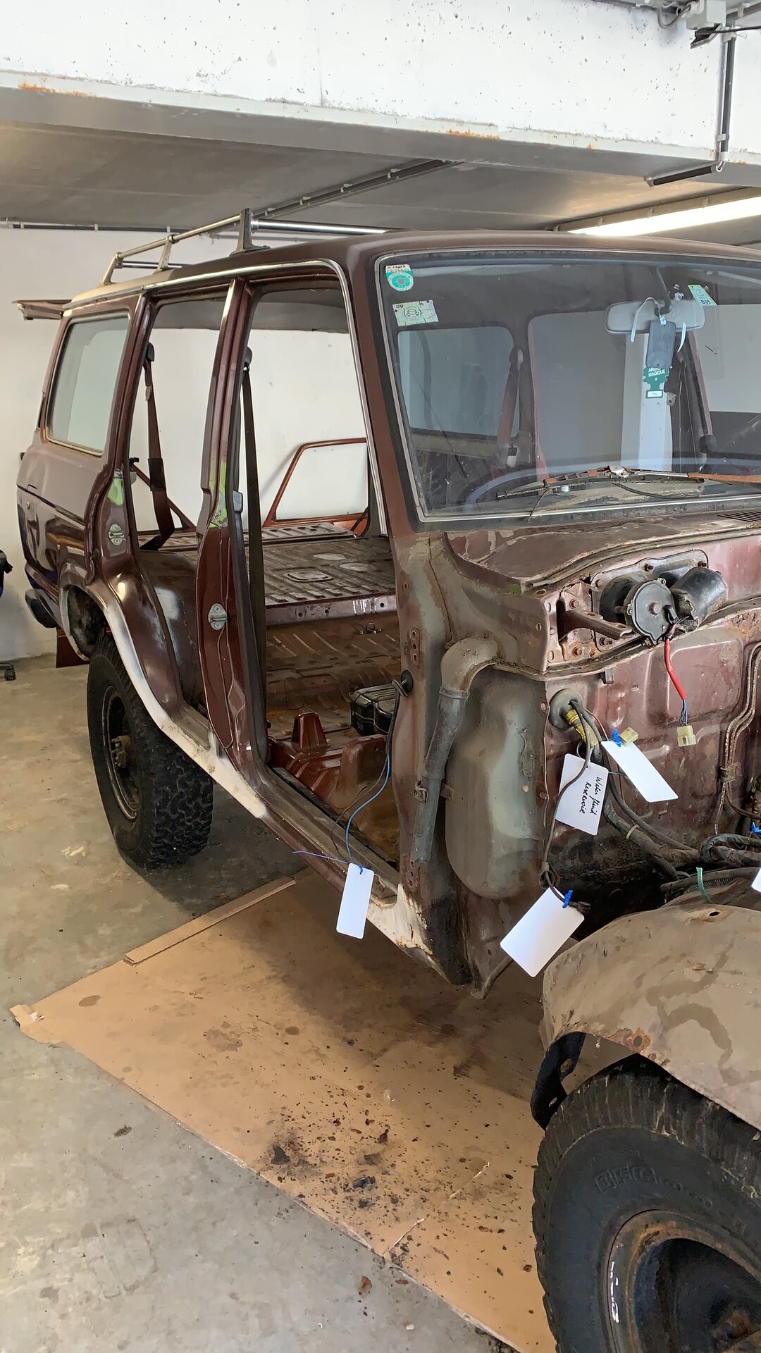

The old undercoating does not come off easy.
The only way is with a heating gun (i use a full-on flamethrower) and a scraper. Afterwards many, many, many stripping discs in different sizes to be able to clean everything.
20+ hours of grinding in and only halfway of the underside paint prep. Will need to weld some rust holes though.

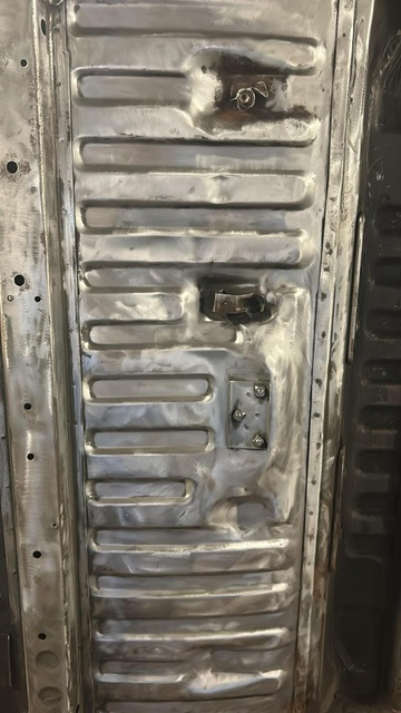

Welding the holes in the underbody proved to be really difficult/impossible to do properly with all the rust still there.
Rented a sandblaster and went at it. Afterwards put a first coat of epoxy primer on all the parts that don't need welding anymore.
Now I have a clean surface to work on. Will be doing the underbody with Raptor Liner, tinted to match the eventual car's colour (Toyota Army Green 6V7).

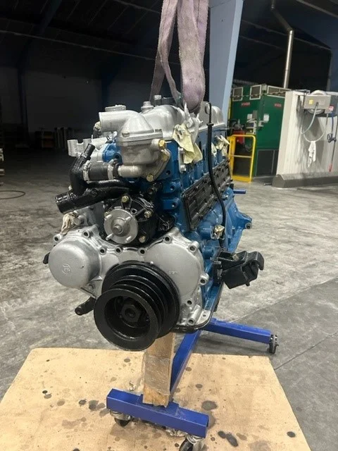

Was about time to make the engine look a little less... crusty.
Painted everything i possibly could. Will attach fuel lines and headers when it's back on the chassis.

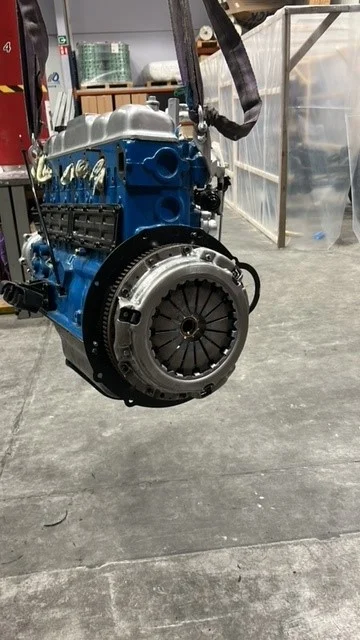

New glow plugs, new sensors, new valve cover gasket, new filters, new belts, new clutch, new engine mounts.
Also new waterpump, new thermostat and new thermostat housing, new rear main seal.

Also, the original blue engine colour wasn't available to me. This one's called 'Ford Blue'. Blasphemy, I know.

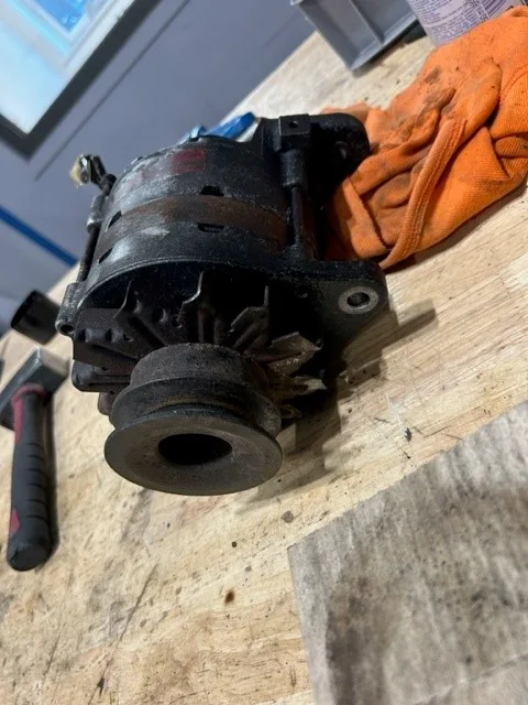

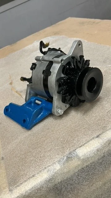

Also went ahead and gave the alternator a good clean-up. 24V (40amp?) with the vacuum pump on the back.
I soldered in new brushes (or at least made a valiant effort with the POS soldering iron I have) and installed some new bearings.
Aluminium parts were waterblasted, the rest was painted. I am short one of those long screws though, and replacements aren't available on any of the parts sites I use. Bracket in the same colour as the engine, of course.

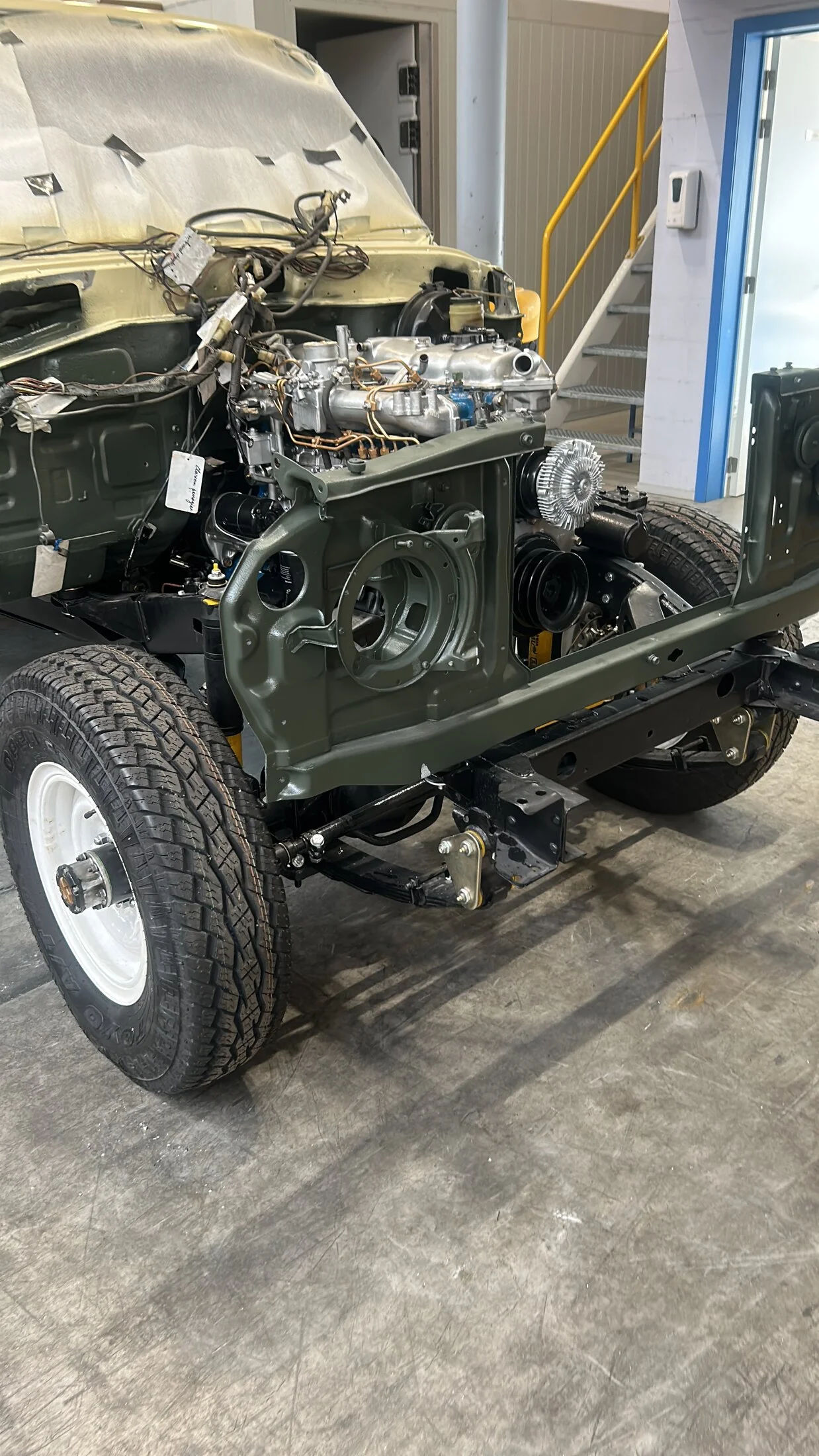

Body is back on the frame, engine and gearbox too. Slowly building up the car again and trying to finish up one system at a time.
Next up is the power steering. Already have the parts, but need to have some connections pressed. Most of the stuff is NLA from Toyota, so have to improvise.
The 2H is looking good! Love the anodised injection lines.

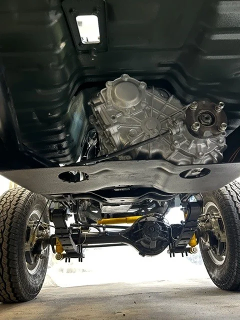

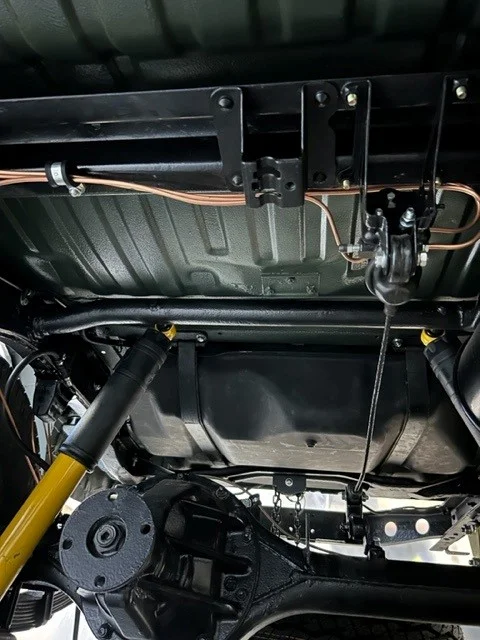

This is what the underside of the car looks like right now. Raptor lined the undercarriage and tinted it in the right colour. Brake lines are as good as in place. Fitted a brand new fuel tank with new straps as well, which was kind of a pain to get to fit. Those who know their 60 will notice I had to make some unusual bends in my brake lines to make it to my P-valve. It's a new one, but was designed for RHD Aussie vehicles and not my LHD, thats why i had to go around.
Currently struggling with:
- an unfortunately snapped off fuel pick-up tube end on the top of my tank. I'm thinking I have just enough left to clamp the hose on and it will be just fine. It's the exterior end if you're wondering.
- installing new U-joints on my driveshafts. Thinking I did something wrong, as it only moves smoothly on one axis, and seems to be stuck in the other direction.

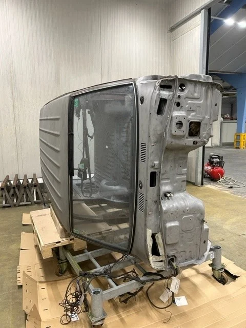

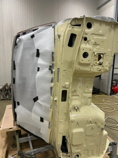

Some more pics after sandblasting some panels.
Removed quite a bit of surface rust. Then epoxy primed. The inside of the fenders and hood will be raptor lined.
All the 'outer parts' will be primed and prepped by me, but will let someone else spray paint it as my setup isn't ideal.
Also, really just want it to look good.
Also raptor lined the inside floor. Should also help a little bit with sound proofing.
