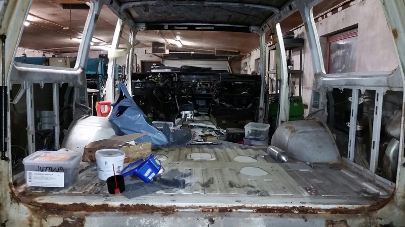

So after christmas I moved it to the new garage and started to pull it a part.
I thought it would be enough to just repair sills and thaths it for the body. I was wrong...
The roof is useless. I had a little break to think about the future and the result was.
So that is what it looks like today. Now I need to start to practice the welding. I have welded 2 times before in my life so I have something to practice on. But it looks like promising now that the car will be ready some day. That is all for now for my first post. I will continue updating when something happens on this project.

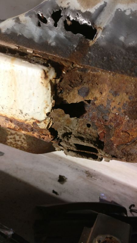

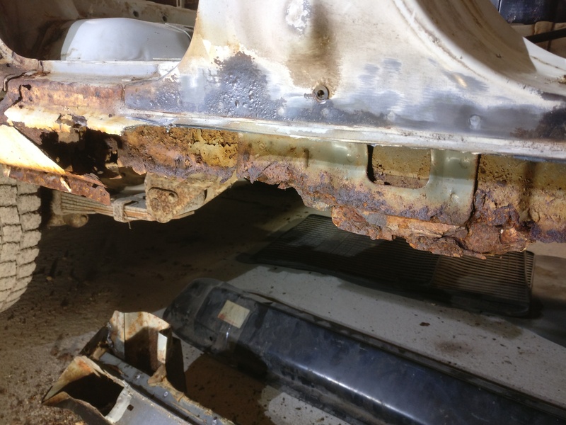

How is the chassis because mine was bad but yours..., that is very close to junkyard.
Good luck but if you like the HJ maybe find a better one? (I would not have listened to that so I dont expect you to) but this will end up expensive.
Rear wheel arch and below doors and chassis rot is normal but yours is rotten between the doors, it qualifies for the mother of all rust.

Thank you for your opinion. I suppose you have not seen other finnish 60 series. Yes mine has some rust damage, but no holes in wheel wells that you seem to have. I know it is expensive, but I have gathered all the sheet metal parts I think I need, allso one more spare body. That brown roof donor body was way gone from something usefull. The roof was only that could be used to something. The other spare body is otherwise usefull but floor is allready welded here and there and has some holes still in the floor section.
Chassis is a bit mystery still for me. But that I will see when I lift the body from chassis. And what comes to finding a better one... it is not easy to find a Cruiser here in Finnland that is still passenger car registered and under 600tkm on the clock. And if you find one it is not near to be cheap. And all are rotten because salt in winter time.

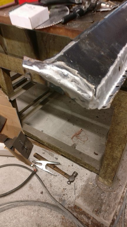

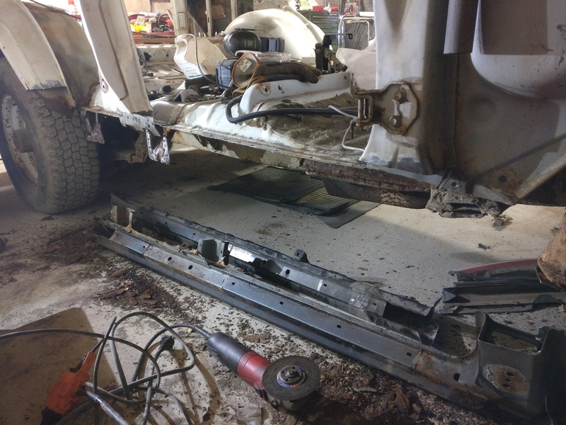

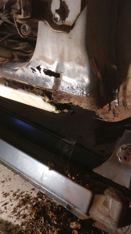

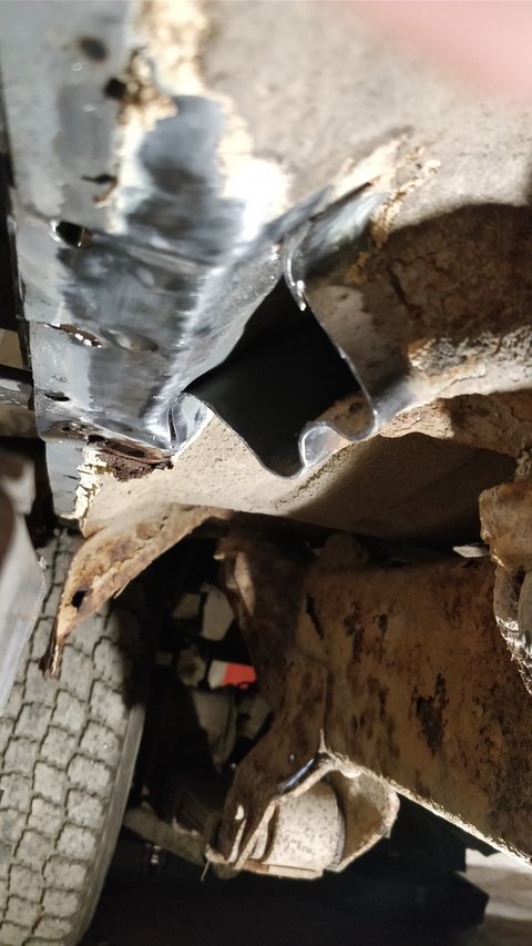

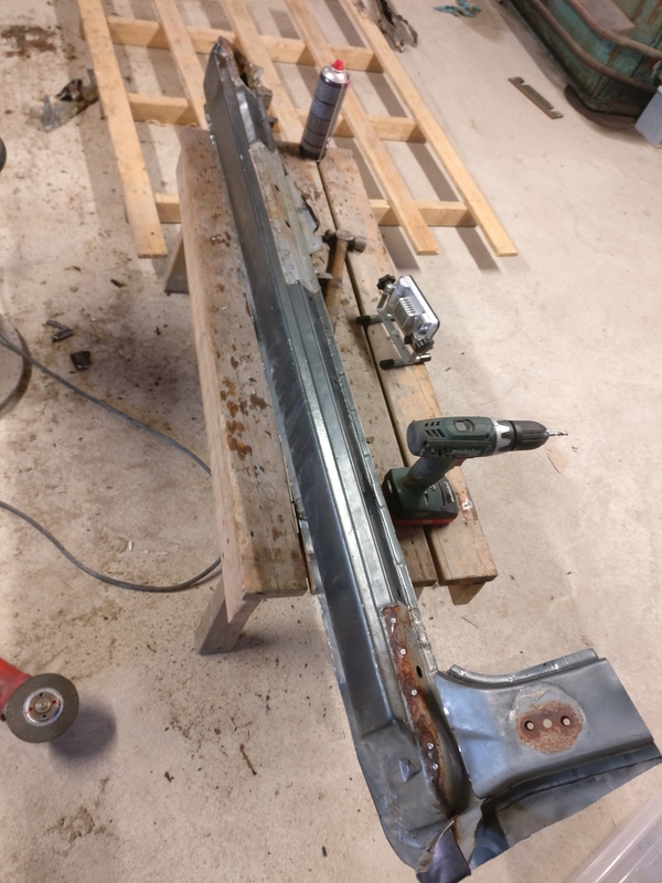

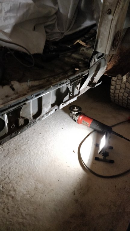

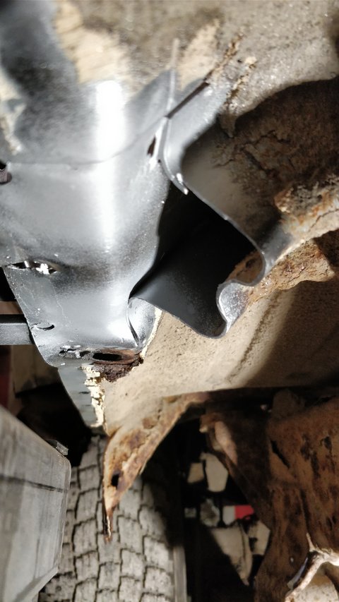

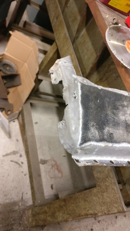

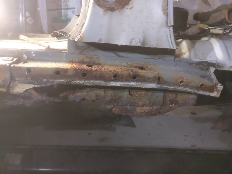

I started to take away useless sections of the sill I am going to fit on the car.
I started to get rid of the old sill. This a-pillar bottom looked good before I strated to strip the paint.
And nothing really good to say about the sill either. And this should be the better side.

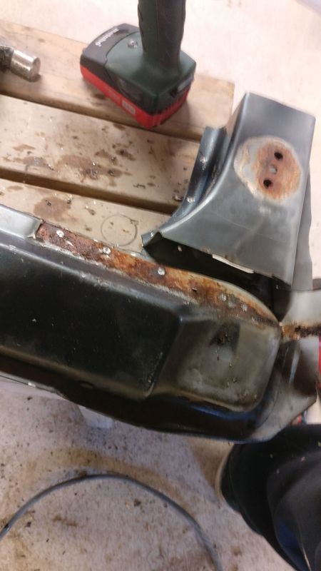

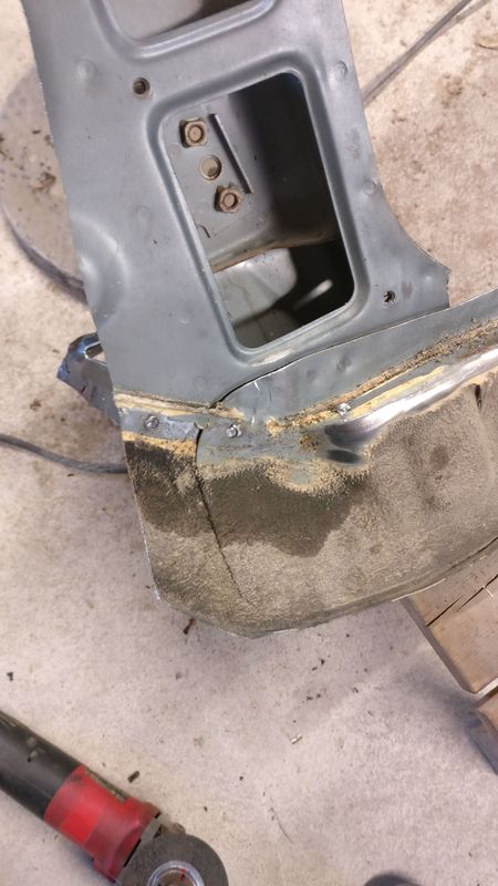

B-pillar bottom was in better shape. I had to cut a piece away so I could drill out the spot welds.
At last the old sill and some rotten parts remowed.
Luckily I have spare bodies to cut pieces from to this project.

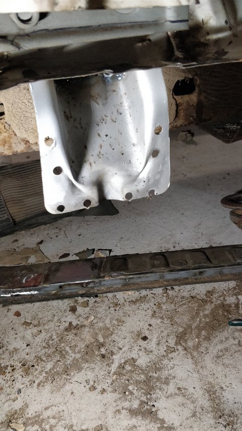

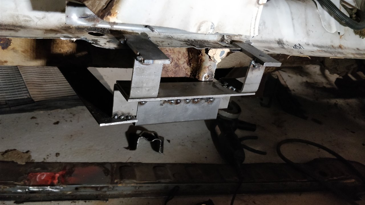

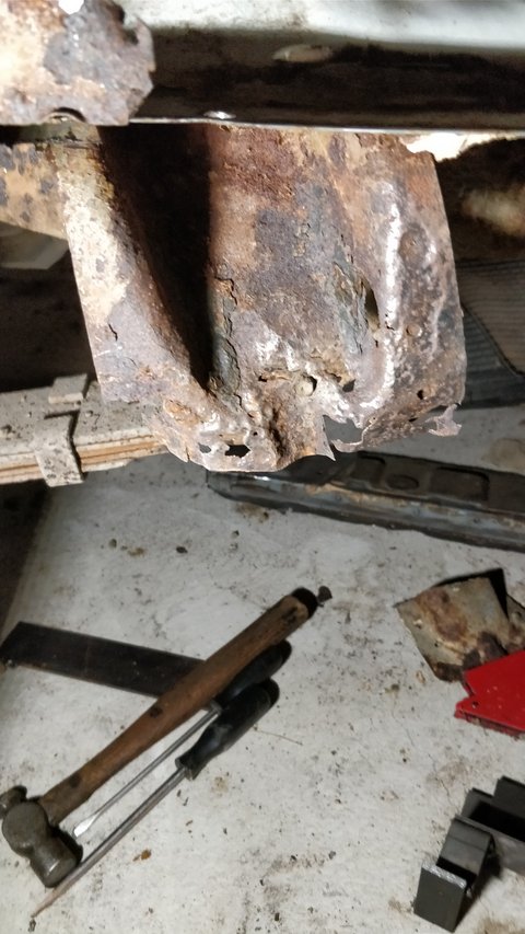

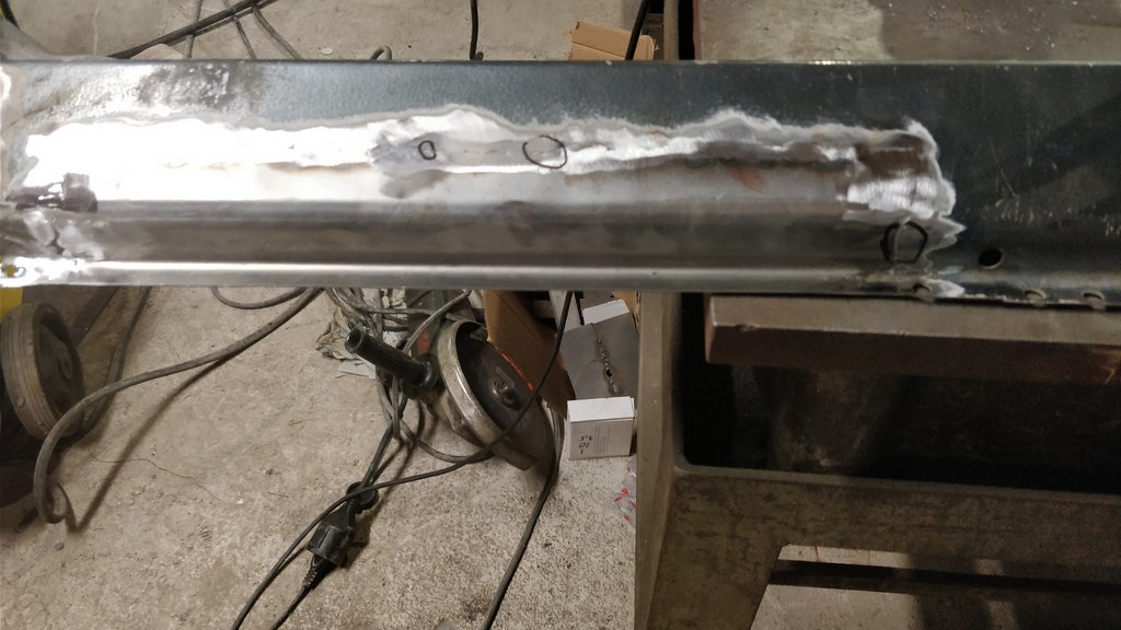

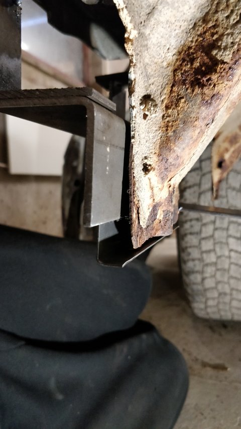

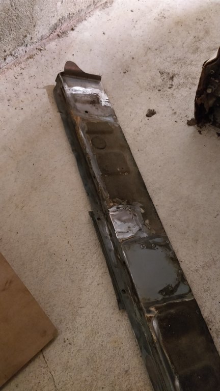

This weekend I got to spend some quality time with the HJ. I had planned to change the end of one crossmember under the body and got it done.
First some jig making to ease the positioning off new part.
Away with the old part and rust.

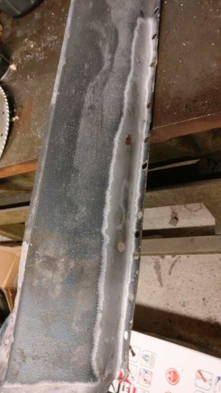

Then some weld through primer.
And in wit the new part.
Next step is to jump on this other one.

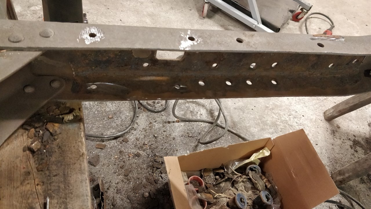

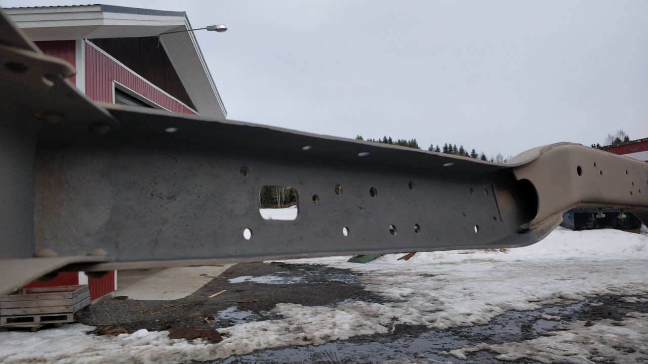

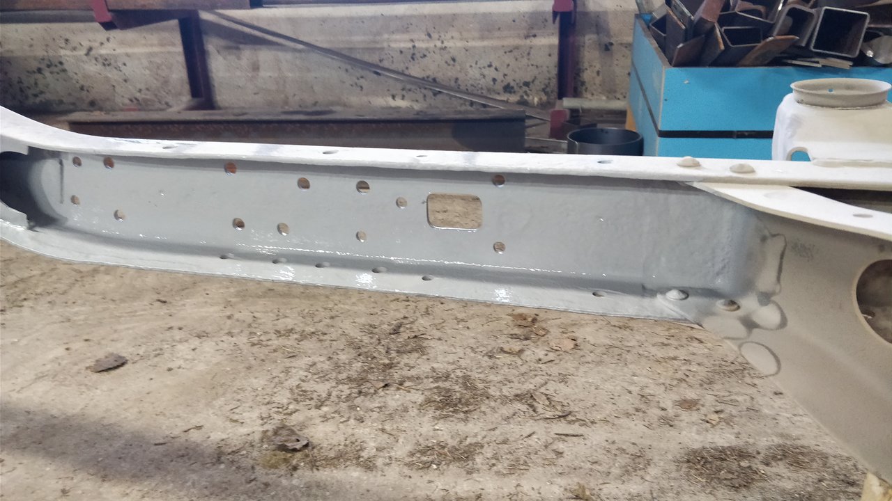

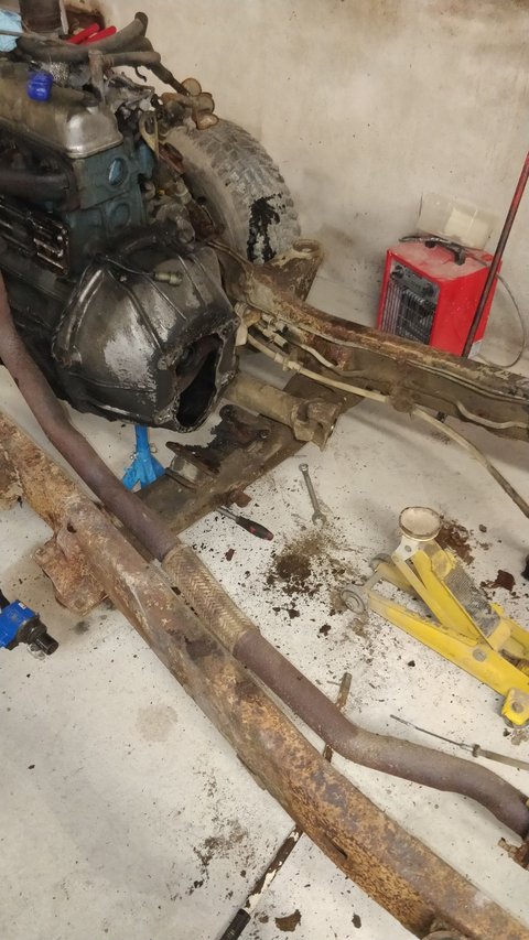

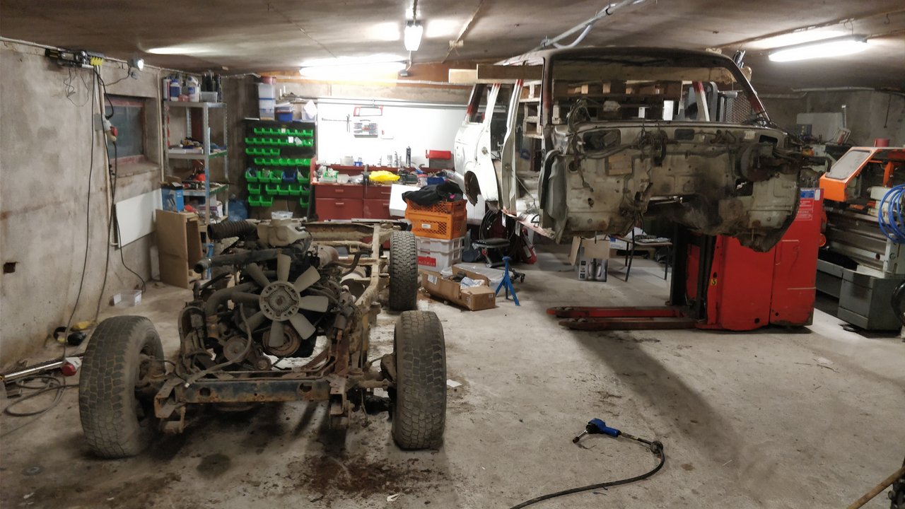

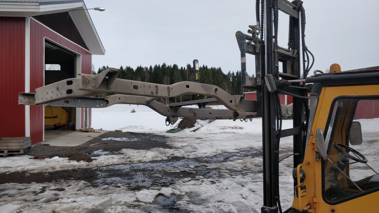

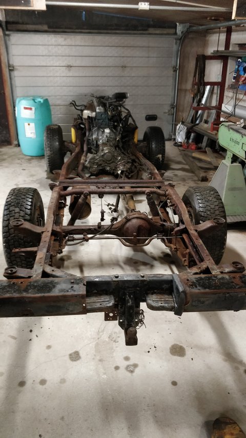

A little update. Frame has been in sandblasting a while ago. Some small fixes before another blast and primer.
Some bodymounts are dismantled and the rear cross beam. And off course these reinforcements from the rear.
Rivets are PITA to remove. Luckily all are removed now that has to be removed.
Then some sandblasting and primer.
And the gearbox has been allmost three months at service. Hoping to get it home soon. A bad bearing had ruined counter axle, nothin else seemed to be wrong with the gearbox. So the axle will be fixed and all new bearings and seals goes in.
