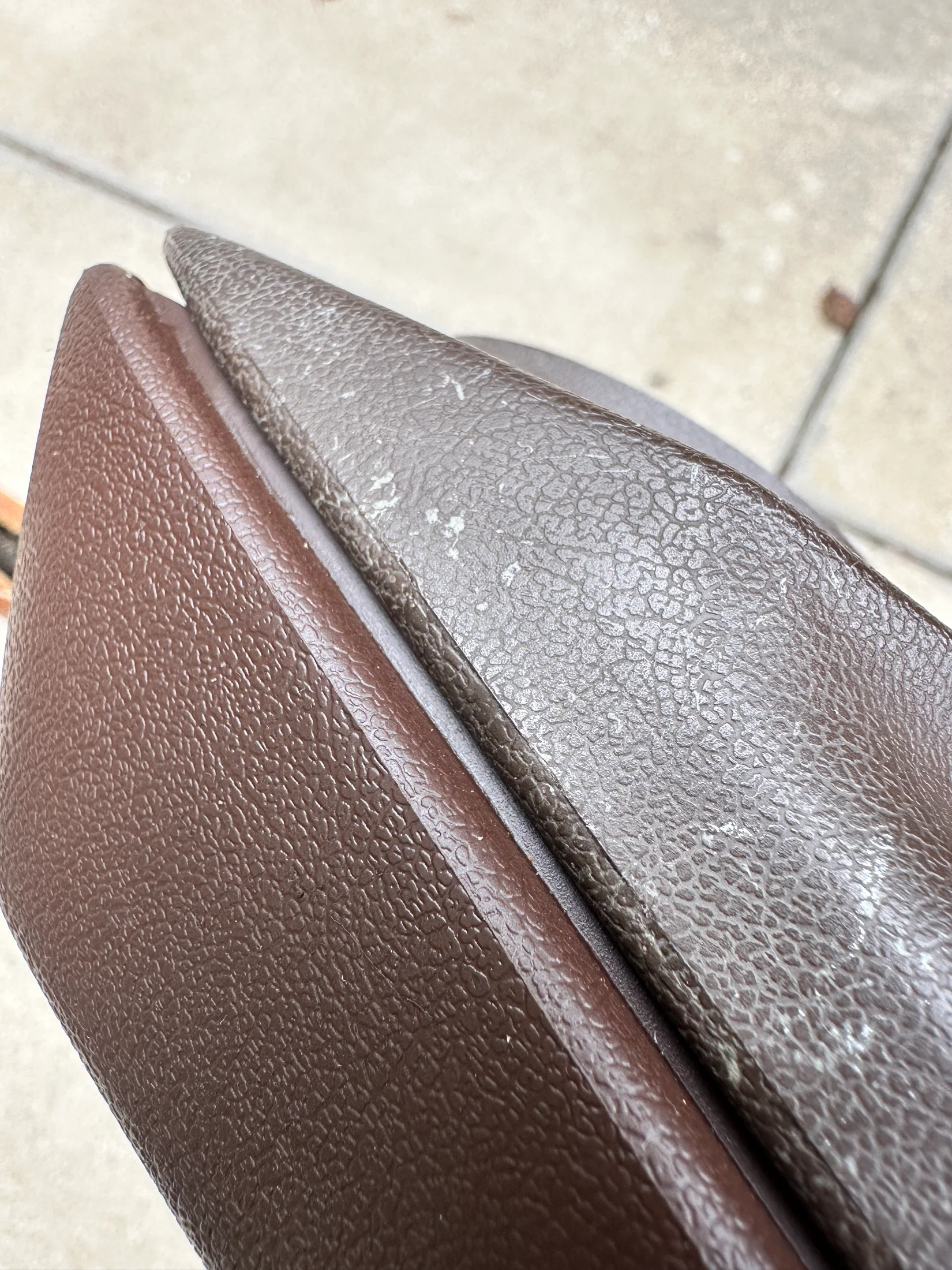

The Cordovan brown doesn’t match the brown used in our rigs. I tested it on the center of my steering wheel for comparison, and it’s clearly off. I’ll share a picture to show the difference.
Find a paint shop with a spectrometer and have them mix a custom color to match. Vinyl or plastic paint in a rattle can works fine, but if you’ve got an air compressor and spray gun, have them mix you a quart instead.
Would changing every part to the non-OEM Cordovan Brown by SEM be an option?
Seems that SEM quality is the way to go and not sure that custom paint would be as good quality... Any feedback on the other SEM colors I proposed?
