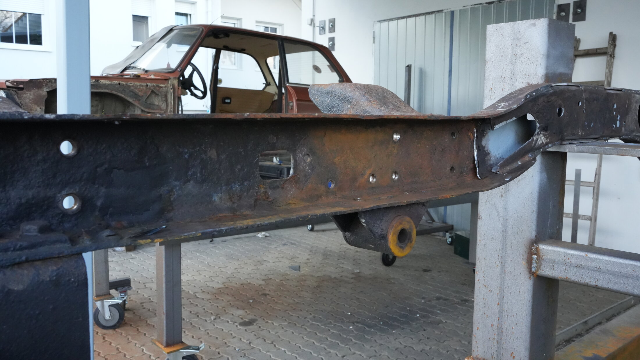

Let’s start with a comparison that really shows the scale of the rot I’m dealing with:
I finally laid the outer (old) C-channel next to my template, and wow—it's completely gone. 😬 You can now really see the true length of the replacement section. The old piece is basically just rust held together by memories.
Today’s Progress – Left Side Complete
✅ Fishplate installed – same as on the right side, it serves as a strengthening part. Again, it's longer than the channel itself for real support, not just thickness.
✅ Outer C + inner channel are in – took the same slow approach and measured everything like 1000 times.

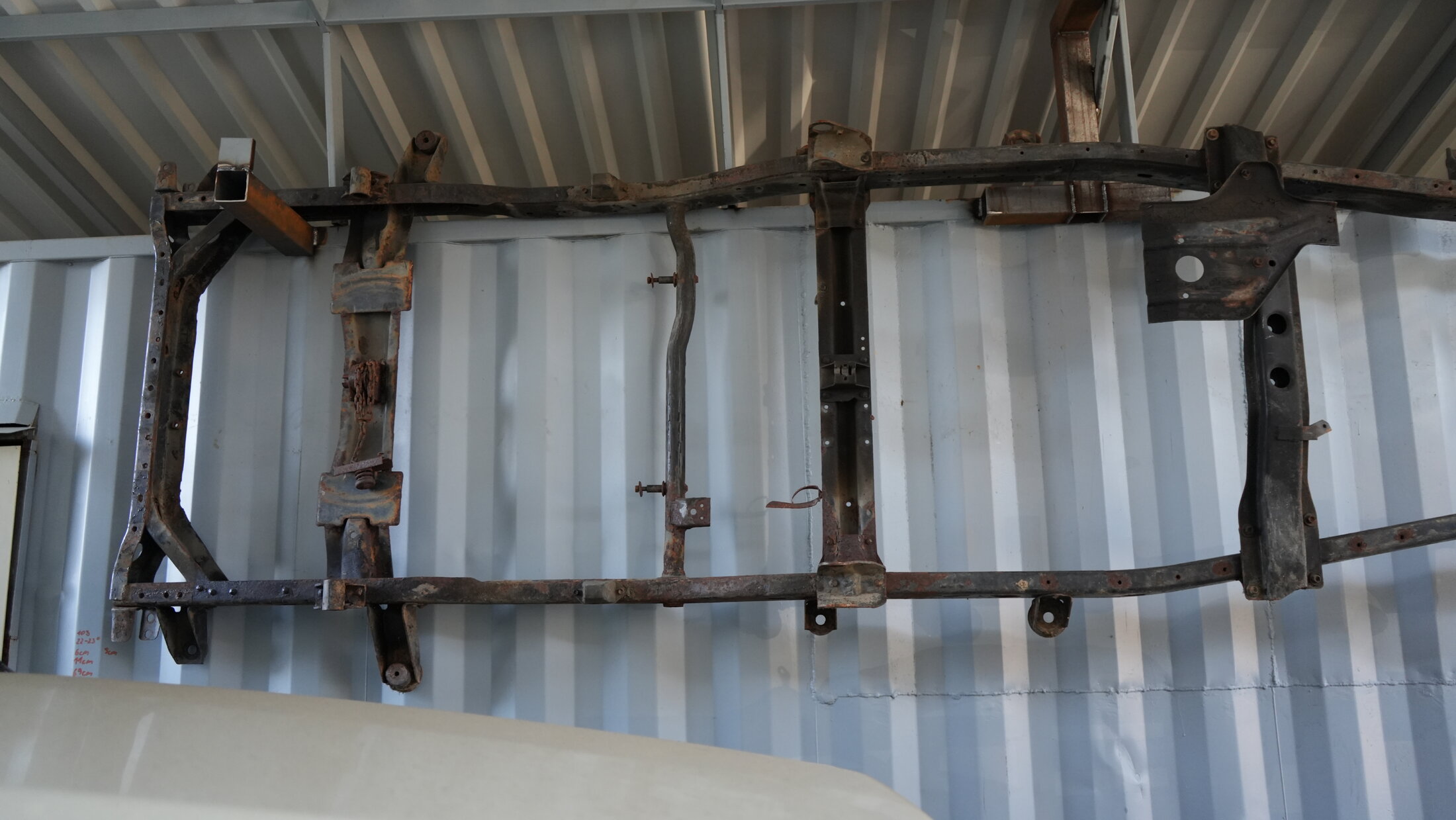

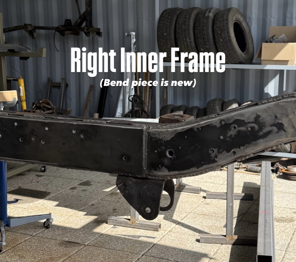

Back again with more HJ60 frame fun (or pain, depending on how you look at it 😅).

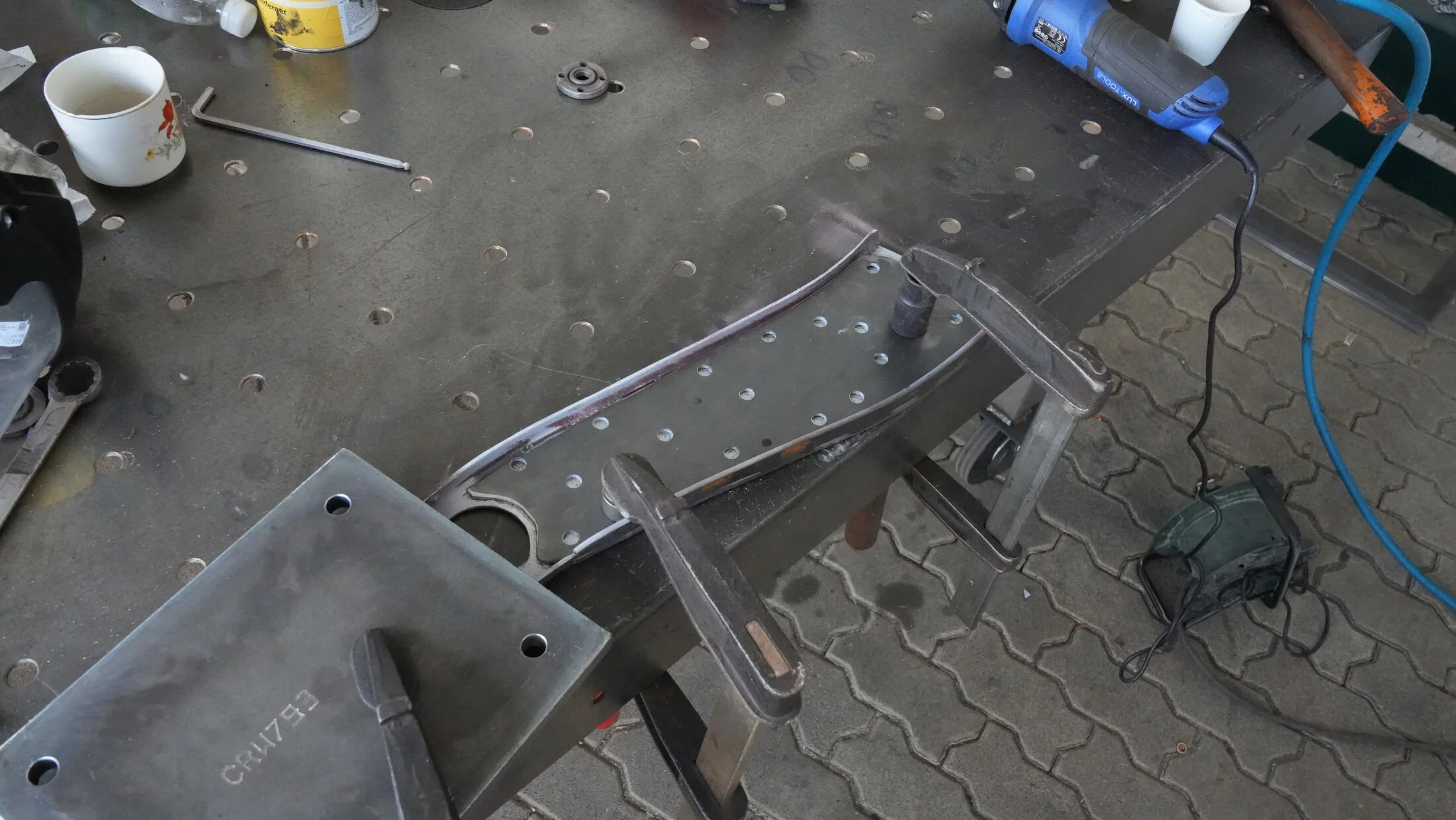

I tackled the bent inner channel sections that lead up to the shock tube—basically the next weak point in this never-ending frame saga. As expected, the old metal here was rusted to absolute hell, and someone had “solved” that by just welding in all sorts of random scrap metal.
As usual, the left side turned out to be a complete sheet metal disaster. While grinding off the welded-on garbage to use the remains as a template, I ran into a major issue. Let’s just say: BIG problem. Full structural mess. Nothing lined up. Not even close to symmetrical. The frame was so hacked up on that side, there was no clean reference left to work from. (There was even bondo on it where the shock tube sits, you can see it slightly on the photo). The good thing is the right side sits just perfect.
Luckily, I’ve got three other 60 Series frames here for measurement, so I was able to get reliable data to work with. I’ve started building the new bent section, taking extra care to match it up exactly. Of course, I added a fishplate to it again, just for safety and strength. With the fishplate, this section now has 0.8 cm total thickness, which should take a solid beating.

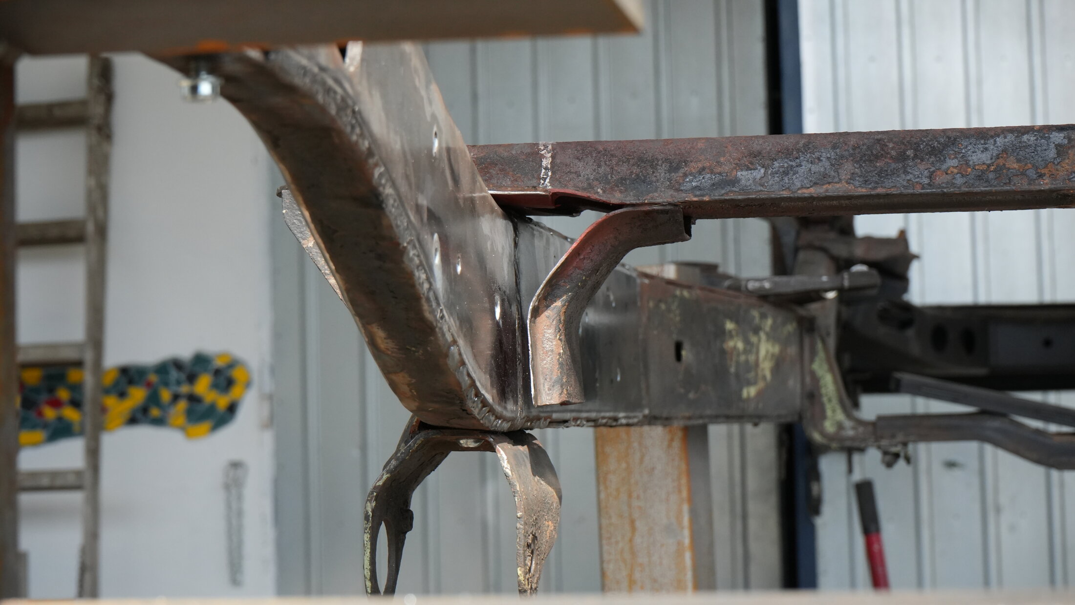

Time for another update on the HJ60 frame rebuild. This time we focused on the bent sections leading up to the shock tube—both left and right sides. We started off by making proper templates for each side. As usual, the right side went pretty smoothly, but of course, the left side continues to fight us every step of the way.
After measuring everything multiple times (paranoia level: high), we finally welded in the inner channels left and right. Total weld time was about 30 minutes, but with all the cooldown phases to avoid heat distortion, the whole process stretched to around 3–4 hours. Worth it though—fitment is spot on.
Once that was done, it was time for the crossmember… and wow, I have to say: this thing was seriously abused. When we cut it out, we discovered a ton of sheet metal just slapped behind it, clearly an attempt to cover up the completely rusted-out left inner channel. No surprise at this point, but still wild to see how far someone went to hide it.
The result? The crossmember is way out of alignment, so that’s the next issue on our list to fix. After that, the only thing left to do is the rear right C-channel over the spring hangar—and we’re finally done with the structural part.

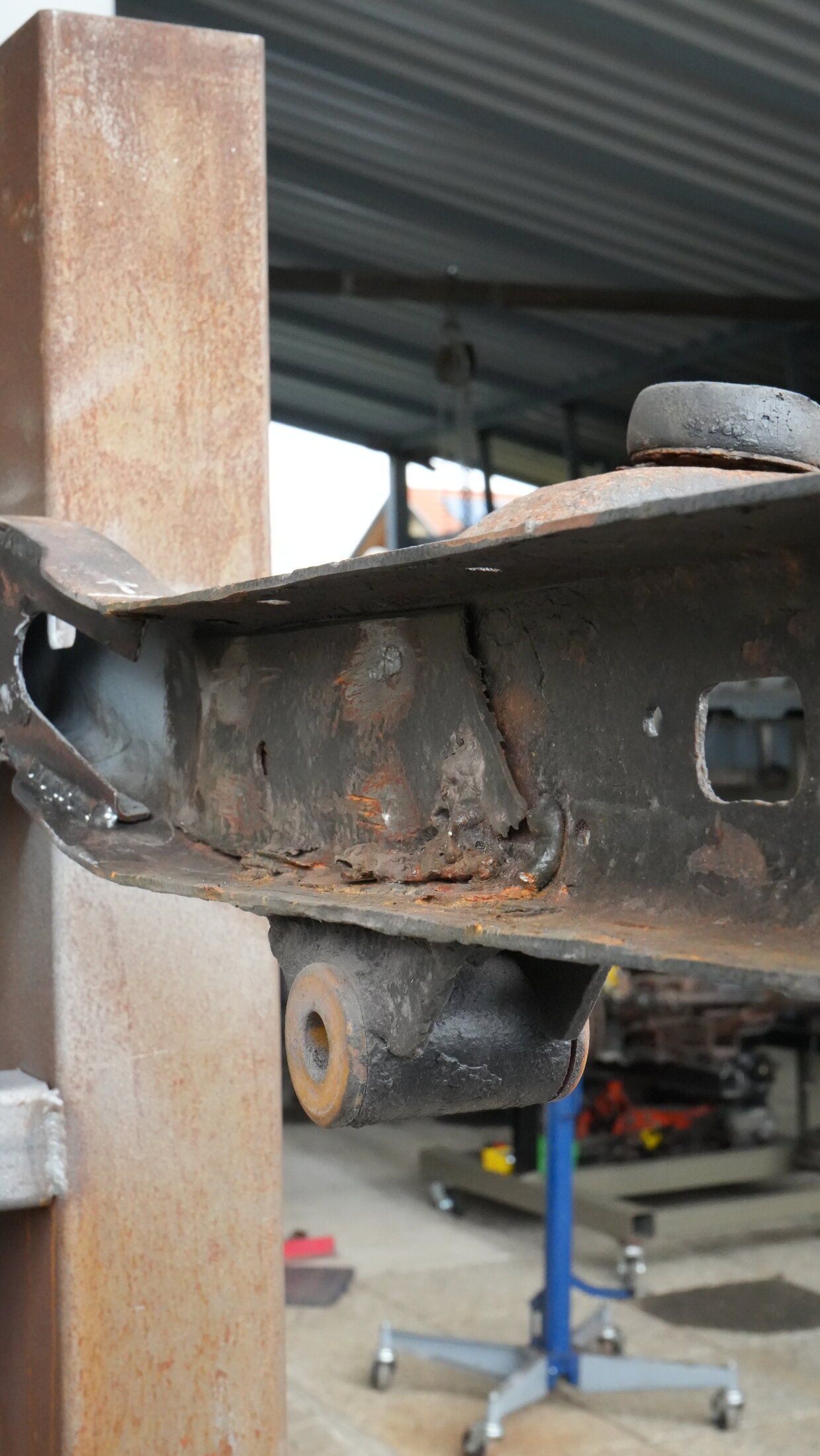

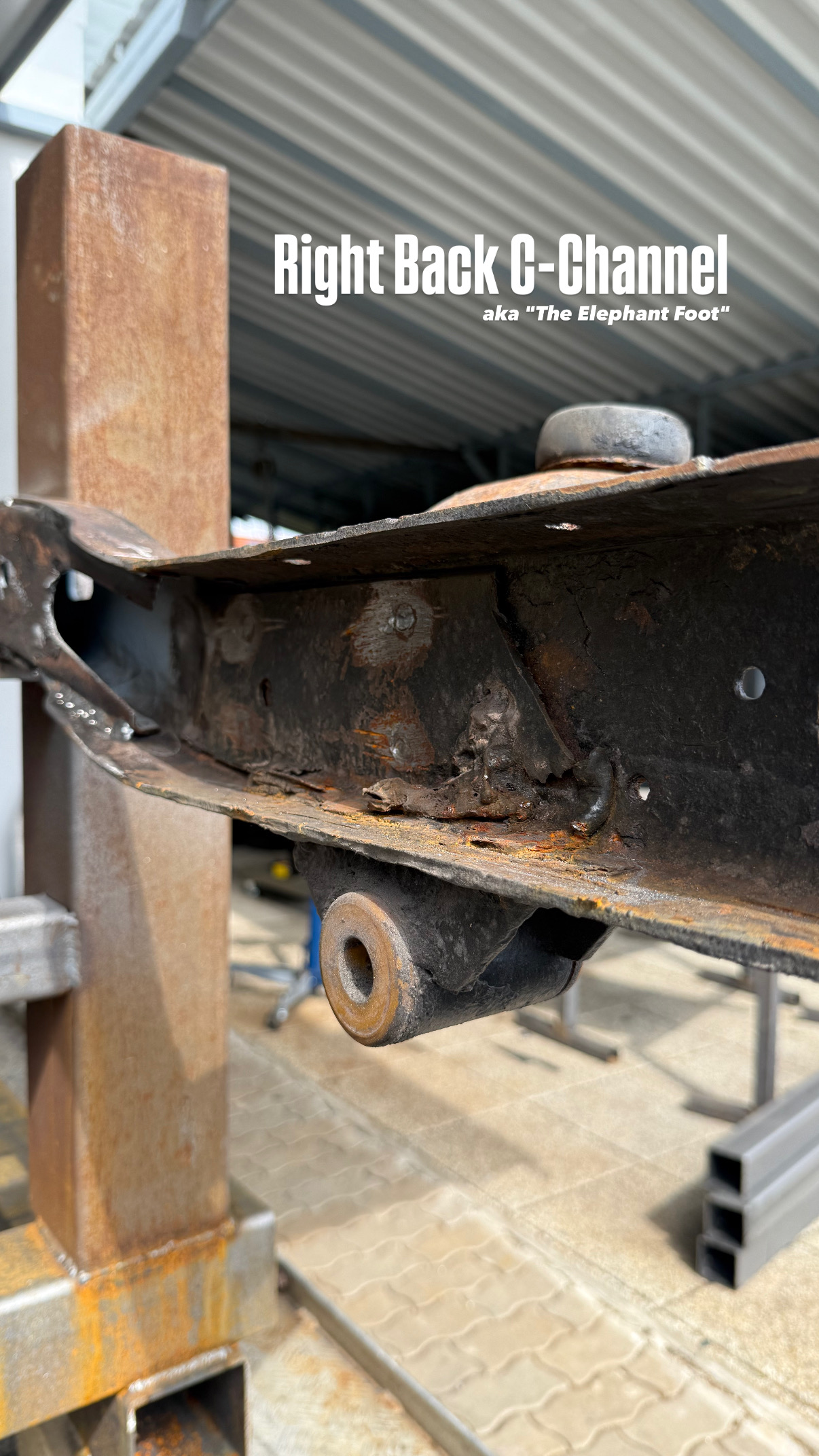

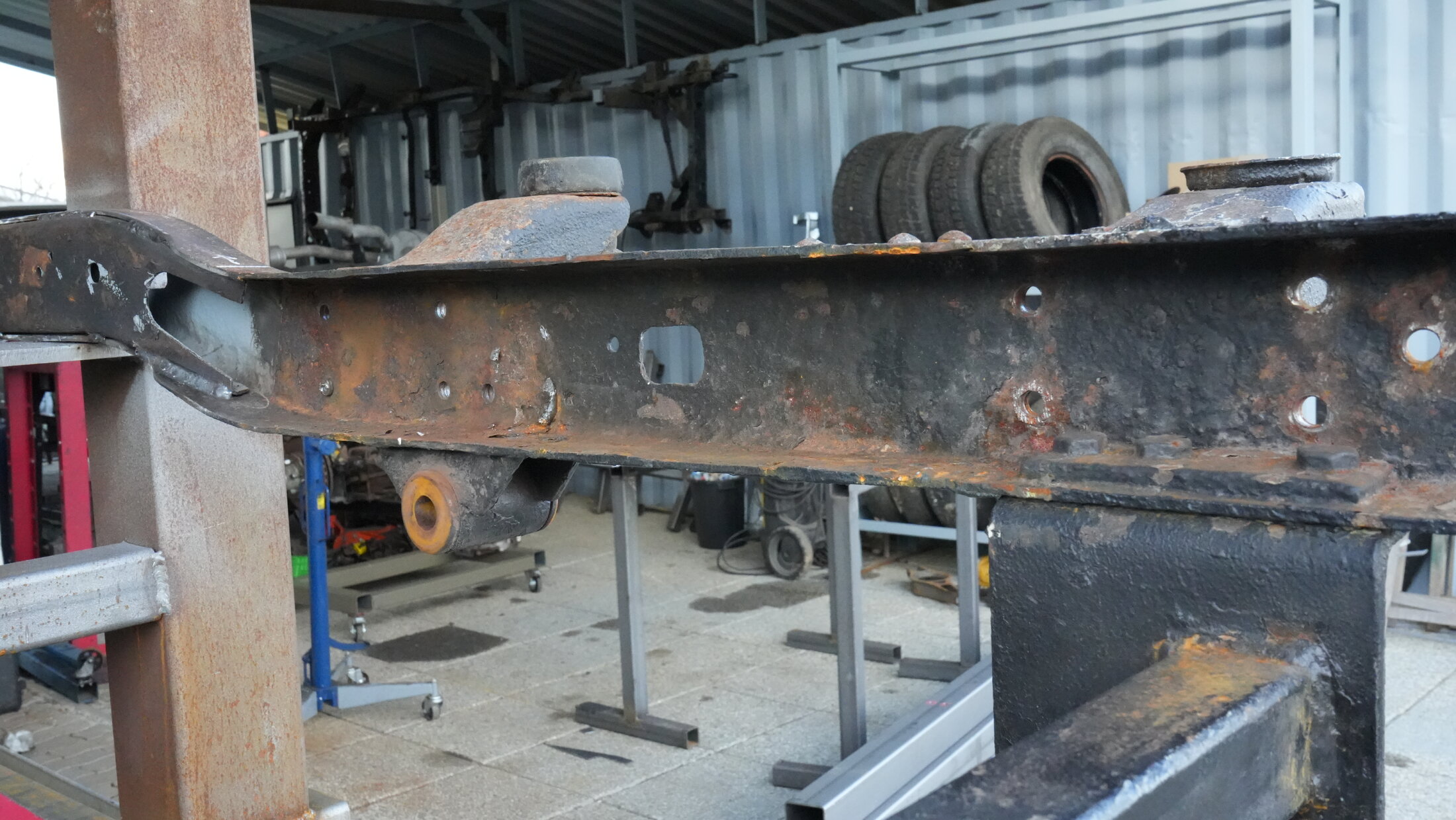

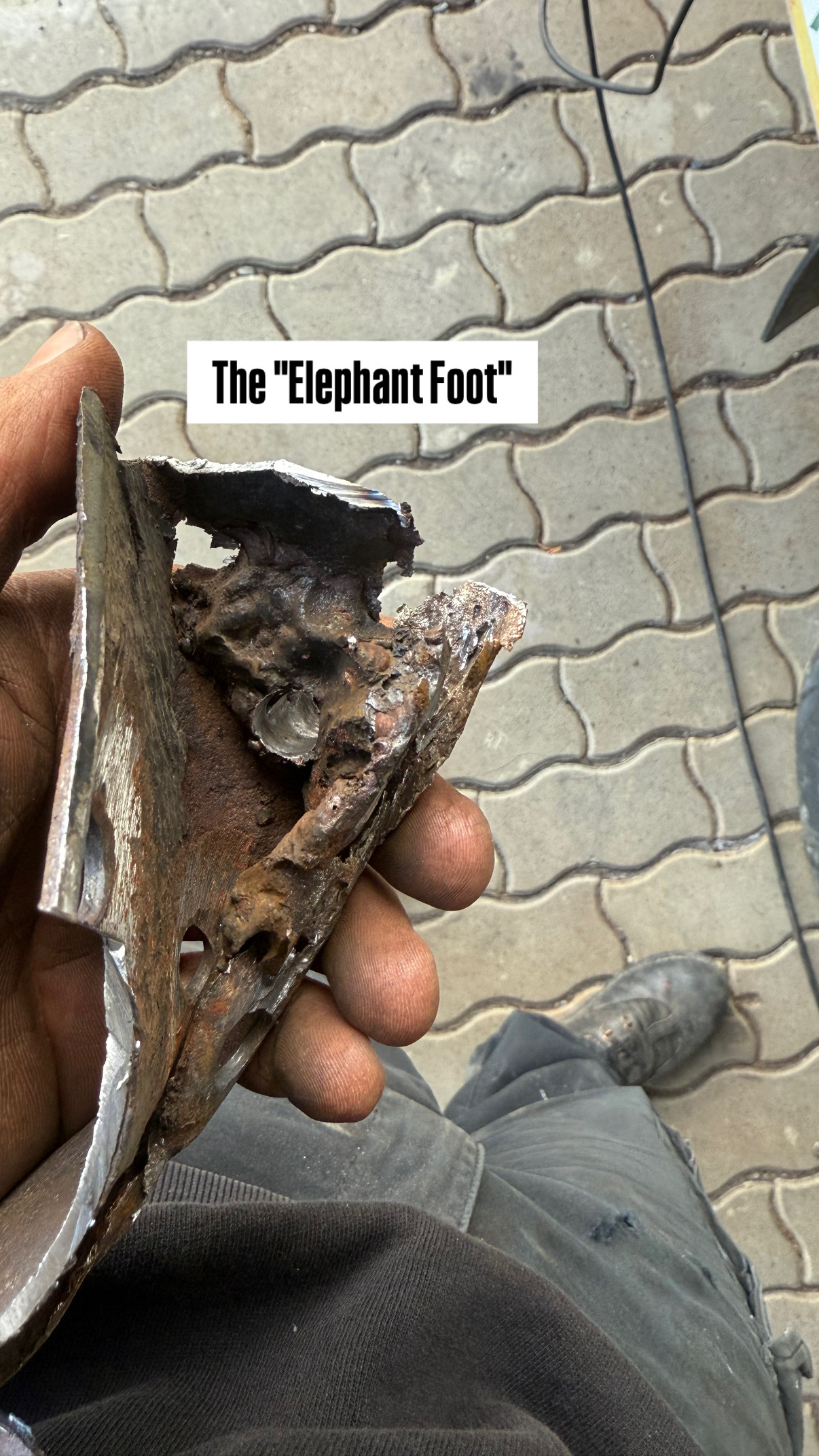

Next up was removing the infamous “elephant foot”—aka the leftover rear C-channels that were never properly taken out. It put up a bit of a fight on the right side, but the left side came out surprisingly smooth. We drilled out the remaining factory rivets and cleaned up the area. It’s been a long time coming, but the rear section is finally cleared and ready.
At this point, the only things left are to bring the frame back to the sandblaster for a final round—this time the entire thing—and then we’ll move on to installing a new shock tube and a brand new rear crossmember. That’ll fully close out the structural part of the rebuild.

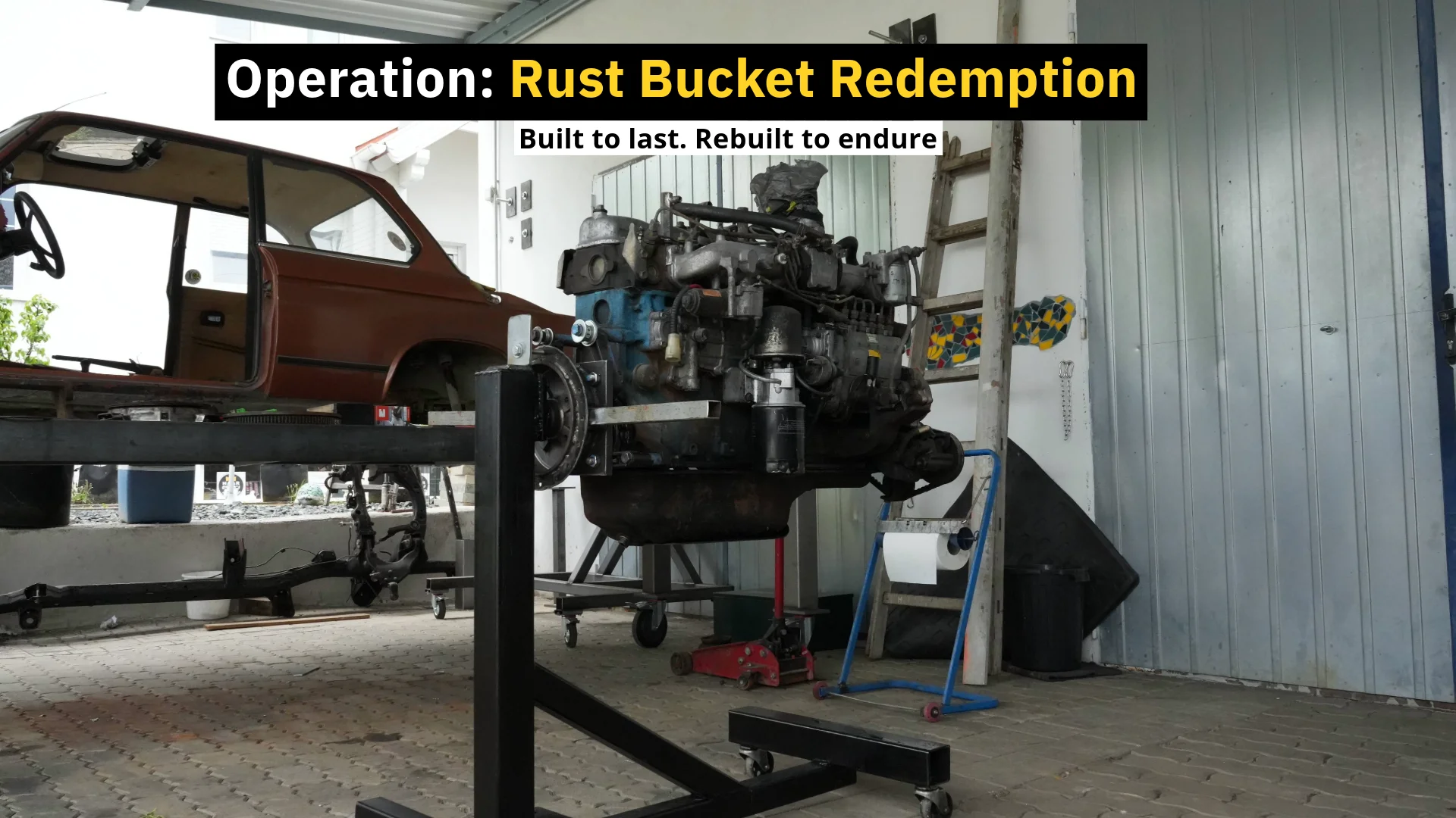

Hope you're all doing well! Time for another update on the HJ60—and this time, it’s engine time.
We finally got the 2H onto the engine stand, and I was honestly excited to dig in. I really hoped this would be the one part of the build where I’d catch a break. After all, the truck only did about 200 km since its so-called "restoration"—so surely the engine was at least somewhat taken care of, right?

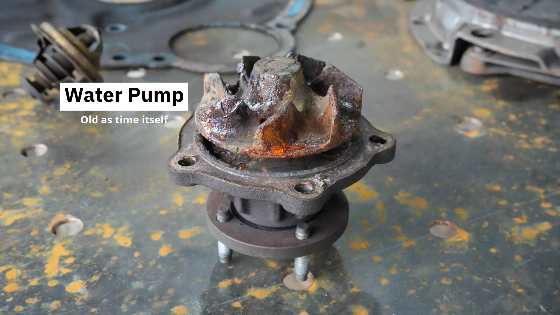

Let’s start from the top. I pulled the thermostat housing just to have a look—figured I’d see a fresh thermostat in there since it’s one of the cheapest and easiest things to replace. But what did I find?
A crusty, ancient thermostat that’s probably seen more highways than I have.
That moment set the tone

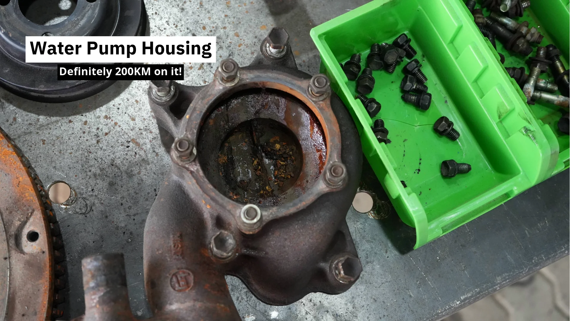

. I moved on to the water pump housing… and yep, it only got worse. Pulled the water pump, and it looked like it had been through decades of corrosion. Rusted to hell. The housing itself? Straight-up horror show. This thing has clearly not been touched in years.
