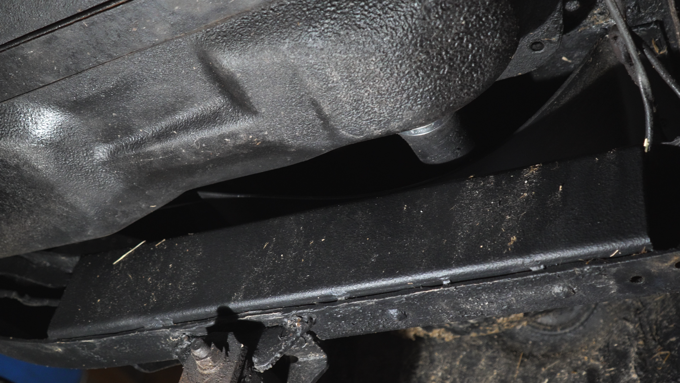

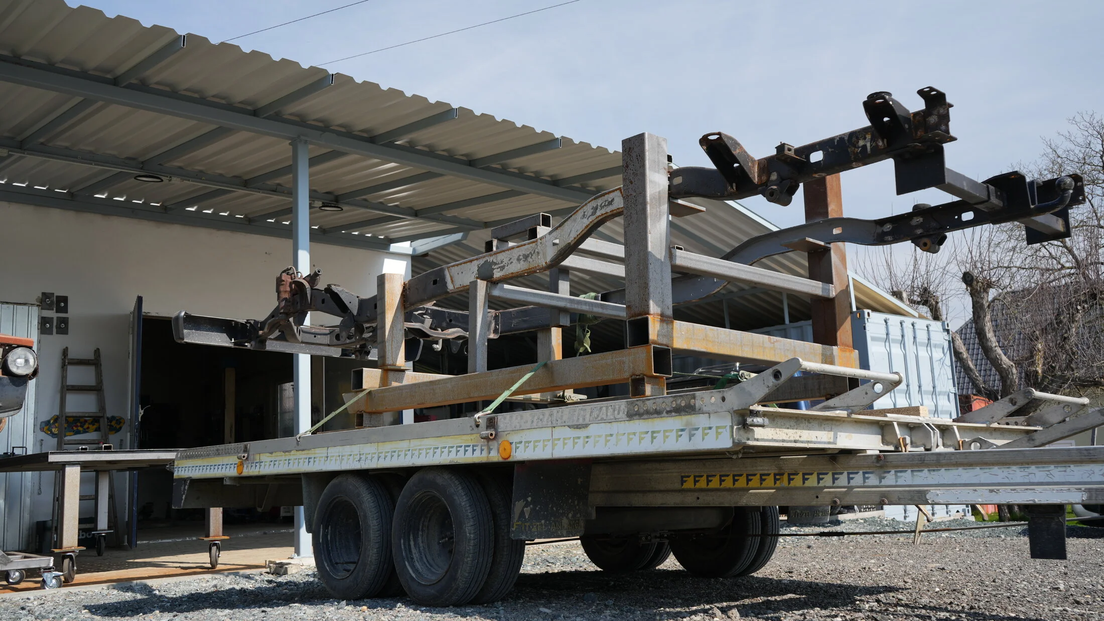

Excited share my latest project—a 1982 Land Cruiser HJ60 with 231k km on the clock. From the outside it looked pretty nice and clean. As you might expect, this is what you get in Austria when looking for an old Land Cruiser… and it wasn’t even cheap. I have been owning LC's for almost 20 years now but this frame is definitely a sight to be seen. 😅

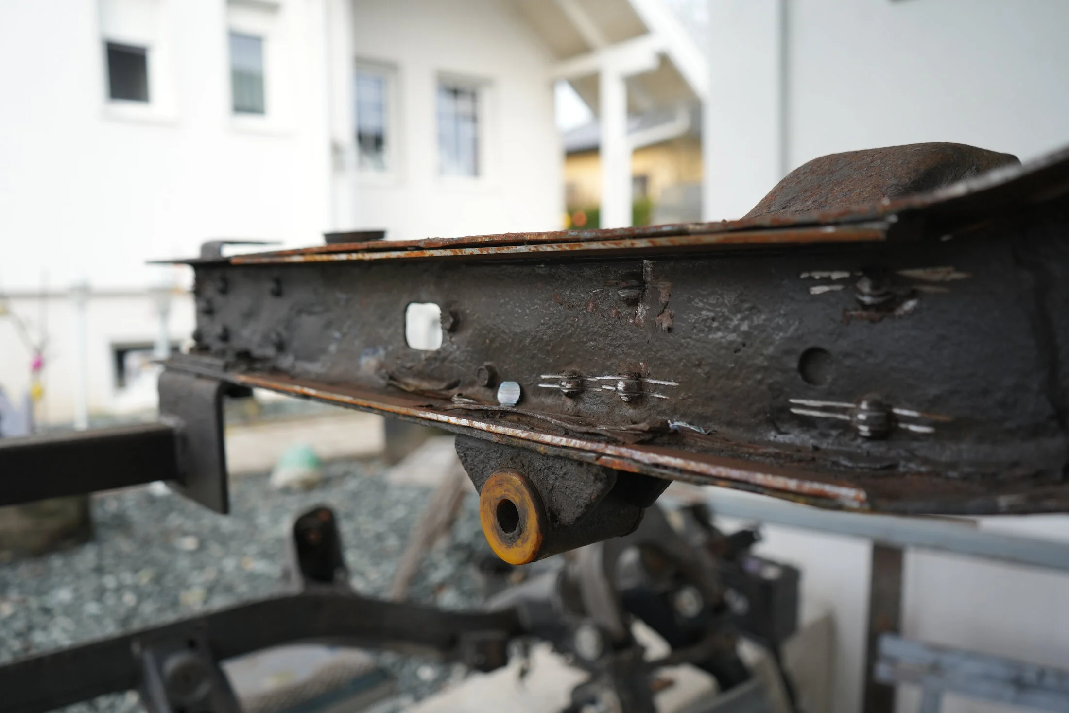

The worst of it? First I saw that the rear spring hangars were welded solid to the frame (ready to snap under tension), and the rear C-channels were mounted backwards—with the old ones still left in for good measure. 🤦‍♂️ Oh, and the shock tube? Filled with rust and bondo. But the real kicker? The frame itself was packed with bondo and so heavily welded that it actually warped! On top of that the rear cross member was properly from garden fence and was secured with four M8 bolts haha. I definitely forgot a few things but that are the main things.
Long story short: I’ve completely torn the HJ apart, built a jig to prevent further warping, and I’m now cutting out all the garbage to start welding in fresh, solid metal. This one's a real rescue mission, but I’m all in!

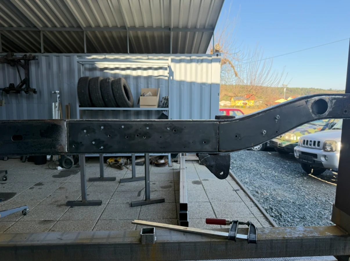

The last thing I did was to tackle the rear section of the frame where the rear spring hangar and body mounts attach. That whole piece—about 1 meter long—was completely rusted away, so we had no choice but to cut it out entirely. Mounted the template beforehand just to see how everything aligns. Thankfully, we had welded a jig beforehand to prevent further frame warping, but to be extra sure, we reinforced it on the backside with additional metal supports.
After carefully tack welding the new section in place, I took my time welding it fully—keeping heat to a minimum to avoid distortion.
Measured everything before, during, and after welding to make sure it was perfectly aligned. Happy to say, the first side was a success, and the second side went even smoother!
Now, only the inner side of the frame remains, but before tackling that, I’ll bring it to the sandblaster to remove every last bit of rust.

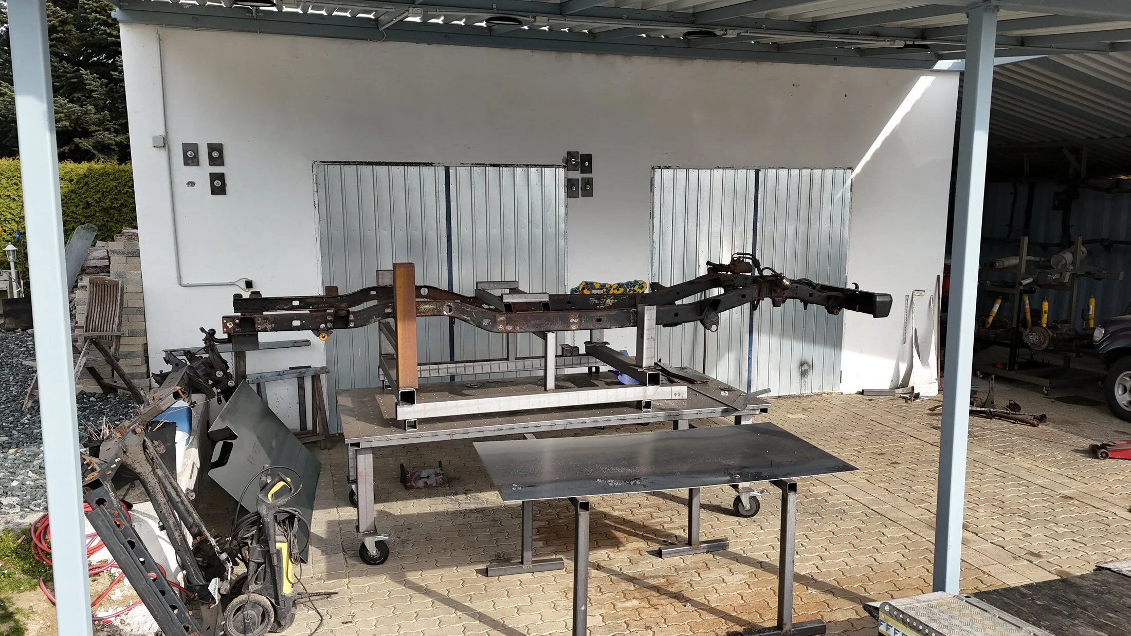

Hey everyone, time for another update on the HJ60 frame rebuild!
Since the last post, we got the frame back from the sandblaster—though we only blasted the new middle section of the frame we recently welded in. The reason? The rear C-channels are still in place, and removing them now would require excessive force. We need more stiffness in the front of the frame before taking them out, or else we risk warping/deformation. So, the plan is to finish the middle section completely (inner and outer sides) and get the crossmember in first. Once that’s done, we’ll remove the rear C-channels and blast the entire frame before final paint.
Recent Work:

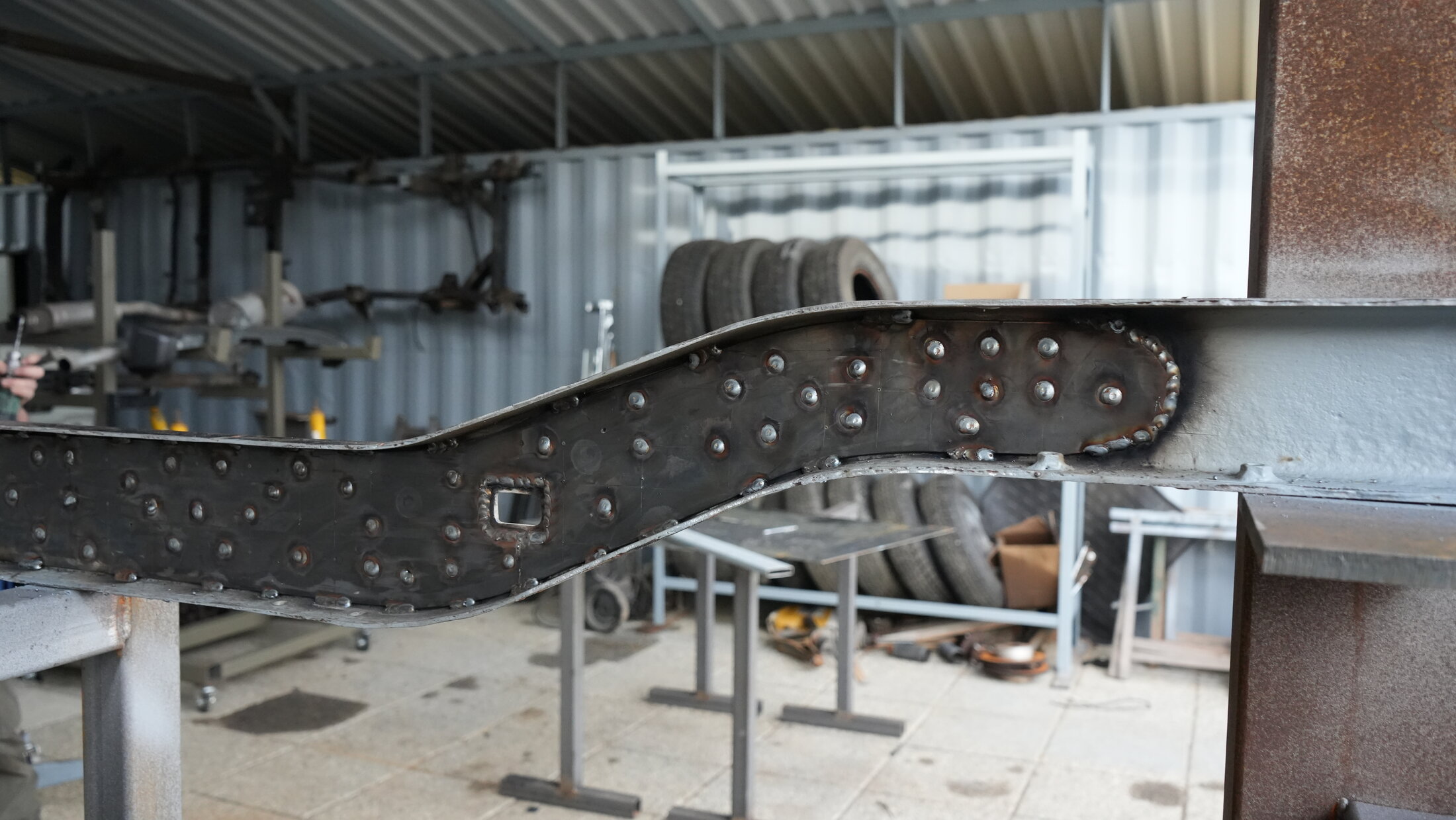

✅ Inner C-Channel in the Middle:
* Installed a 0.3 cm fishplate for added stiffness. Instead of just matching the channel length 1:1, we extended it beyond the channel to actually provide structural support.
* Drilled holes in the fishplate for plug welds, ensuring it's fully bonded to the channel—not just sitting on the sides.
* Took my time welding this in, because frame welding at ~200 amps can warp things faster than my stomach after a morning coffee. ☕

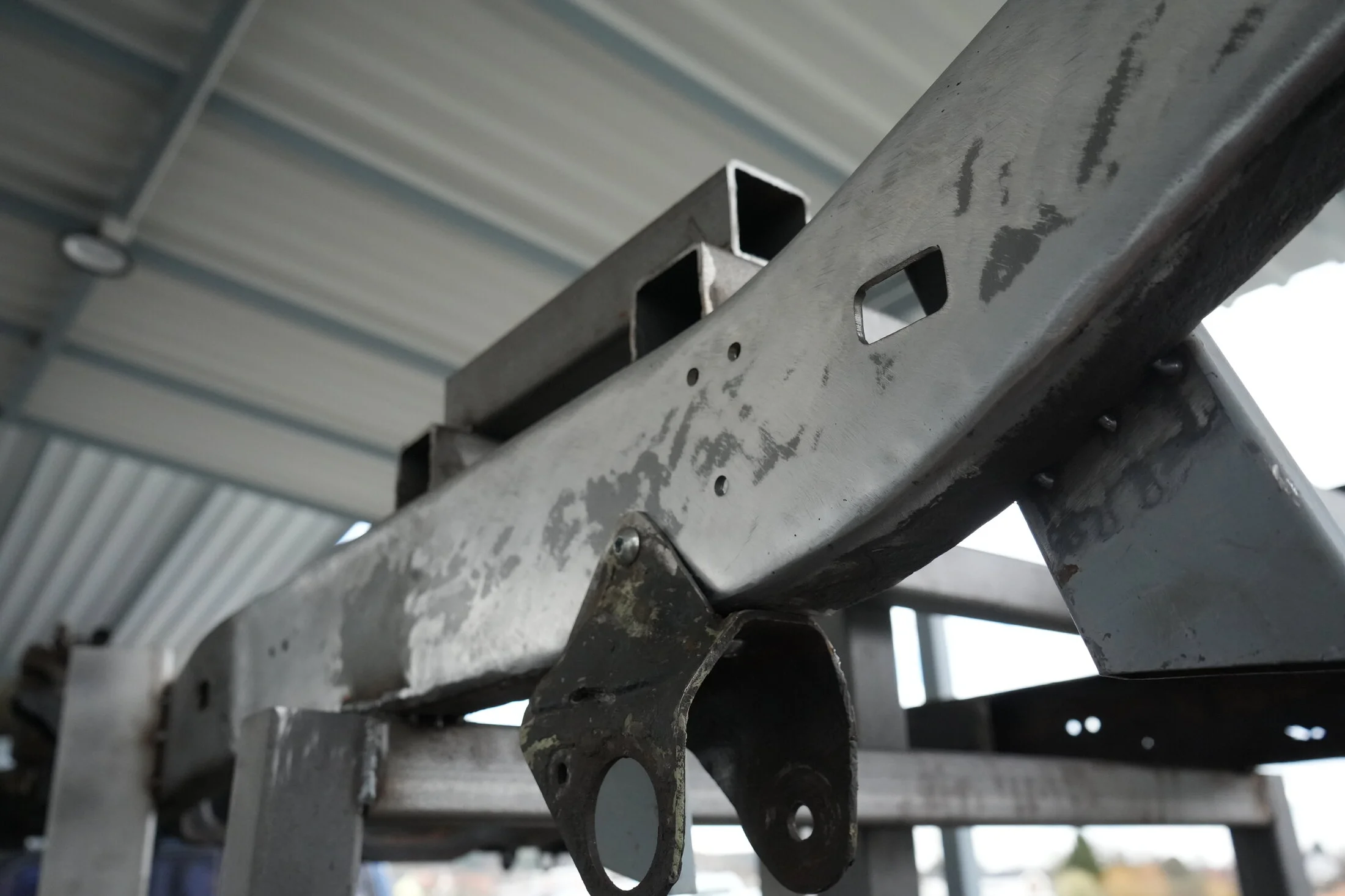

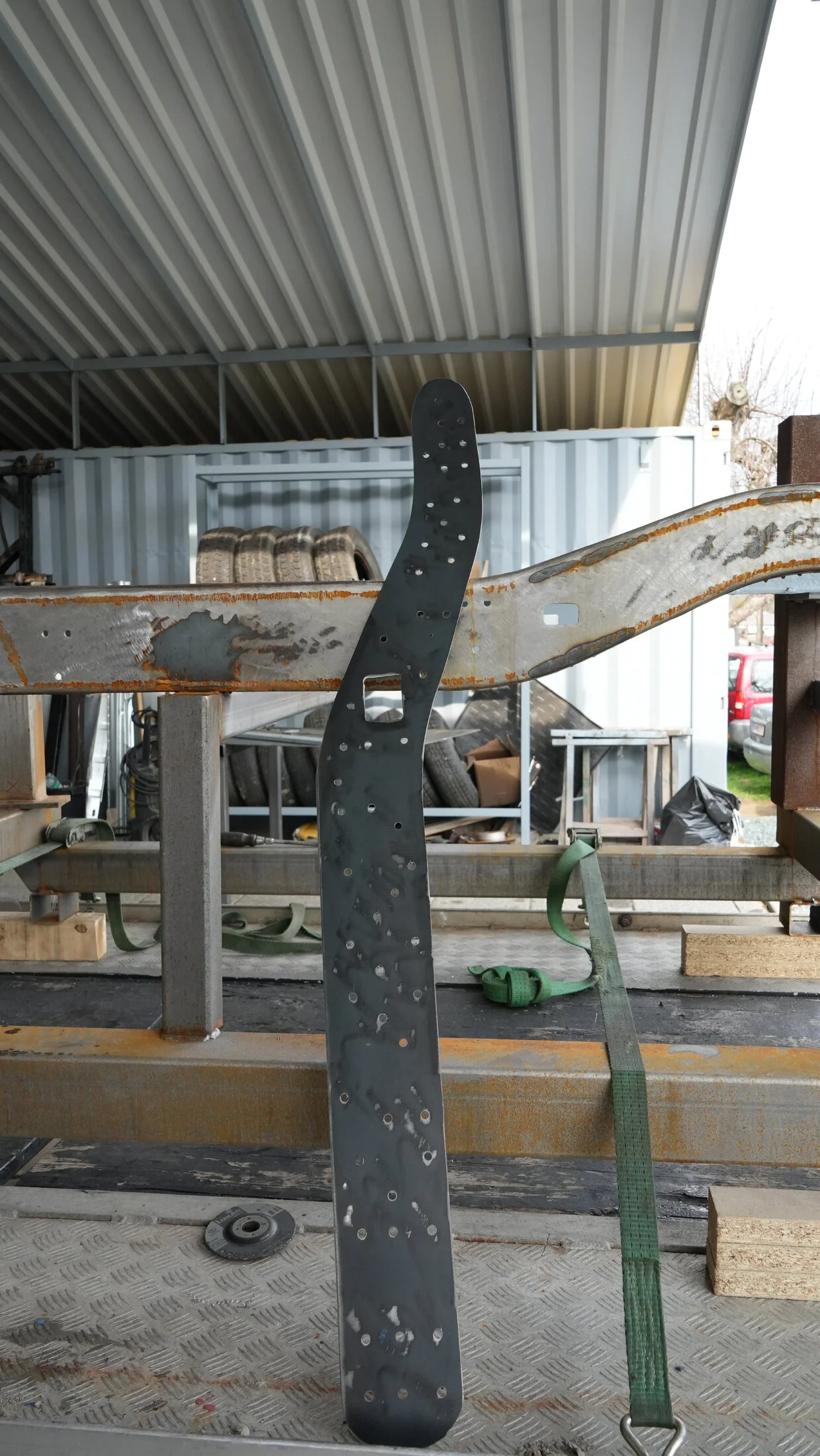

✅ Inner Channel Prepped & Ready for Welding:
* This piece includes factory-style M10 nuts for the body mounts and spring hangars (unlike before, where they were just welded solid to the frame ).
* Added a "smaller channel“. It like a piece that was just pushed behind the healthy metal.
✅ Fitted the Bent Section Before the Shock Tube:
* Just mocked this up for now to check the fitment.
What’s Next?
* Left side & crossmember should be finished tomorrow (fingers crossed 🤞).
* Once that’s in, we can finally remove the disaster of a rear C-channel.
* Full sandblasting to get rid of any remaining rust.
* Then... paint!
I’ll update you all ASAP if everything goes to plan! Looking forward to the next steps.

Wow… those plug welds look great…good thinking on that
