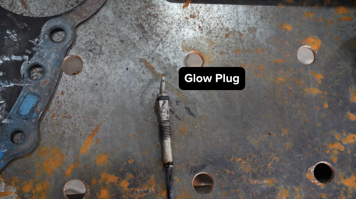

Last time I cracked into the 2H engine and got a not-so-lovely introduction to what was hiding inside. Turns out that was just the beginning. So here’s the next round of discoveries in this never-ending restoration adventure…
Started by pulling the exhaust manifold, and right away it was clear—this thing had never been off. Rust was just flaking off everywhere like old paint.
Pulled the glow plugs and yeaaaah. They were twisted like a banana ...

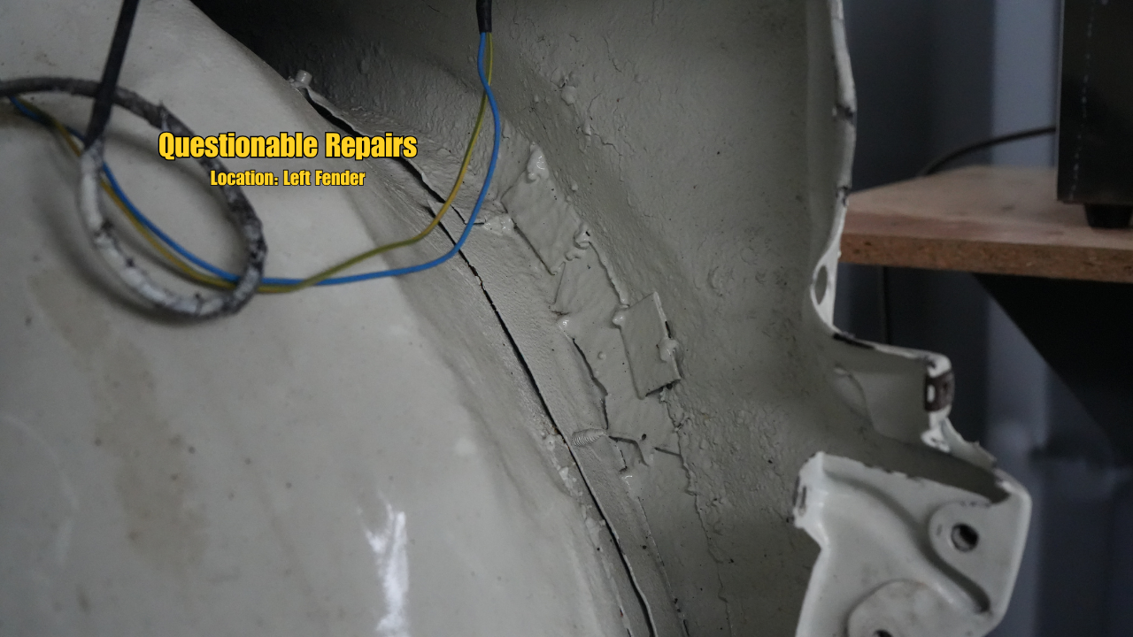

When I removed the front mask, I also discovered some “questionable craftsmanship” on the left fender—just sheet metal pieces welded over each other, layer on layer. No shaping, no blending… just stacked metal. It honestly looked awful and definitely not how you'd want to repair anything long-term.
Also, for those who are following the full journey, I’ve put together a new video on YouTube showing the process. It’s nothing fancy, just documenting things step by step if you’re interested in the details.
