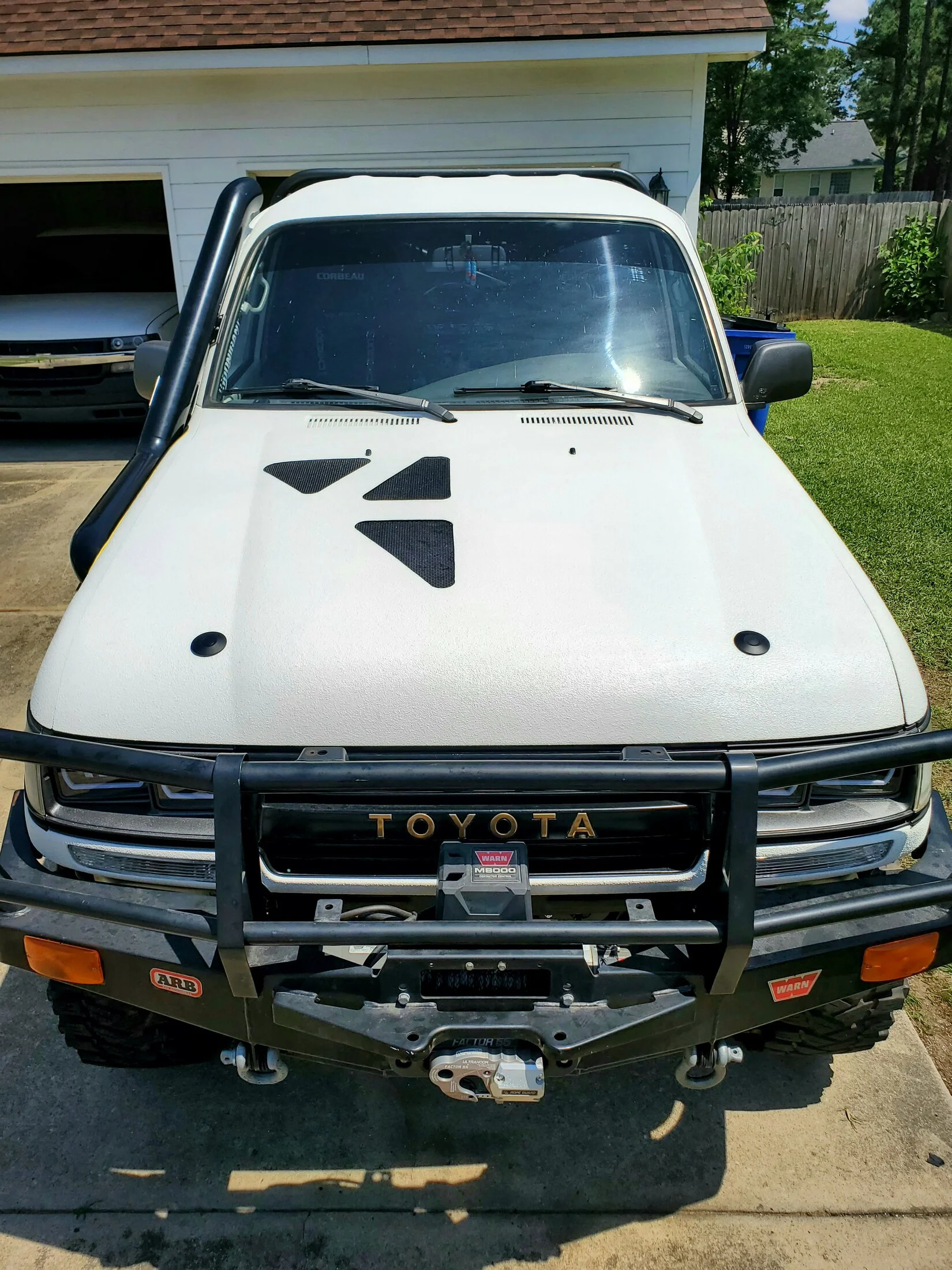

Anyone try louvres, did they seem to help?
I do have vents on my hood, and hood rises. I never did a before and after for temps though. I don't think it significantly lowers temps. Mechanical fan clutch and blade may be the way to go.
Darren those are Ancient Aliens hieroglyphics on your hood

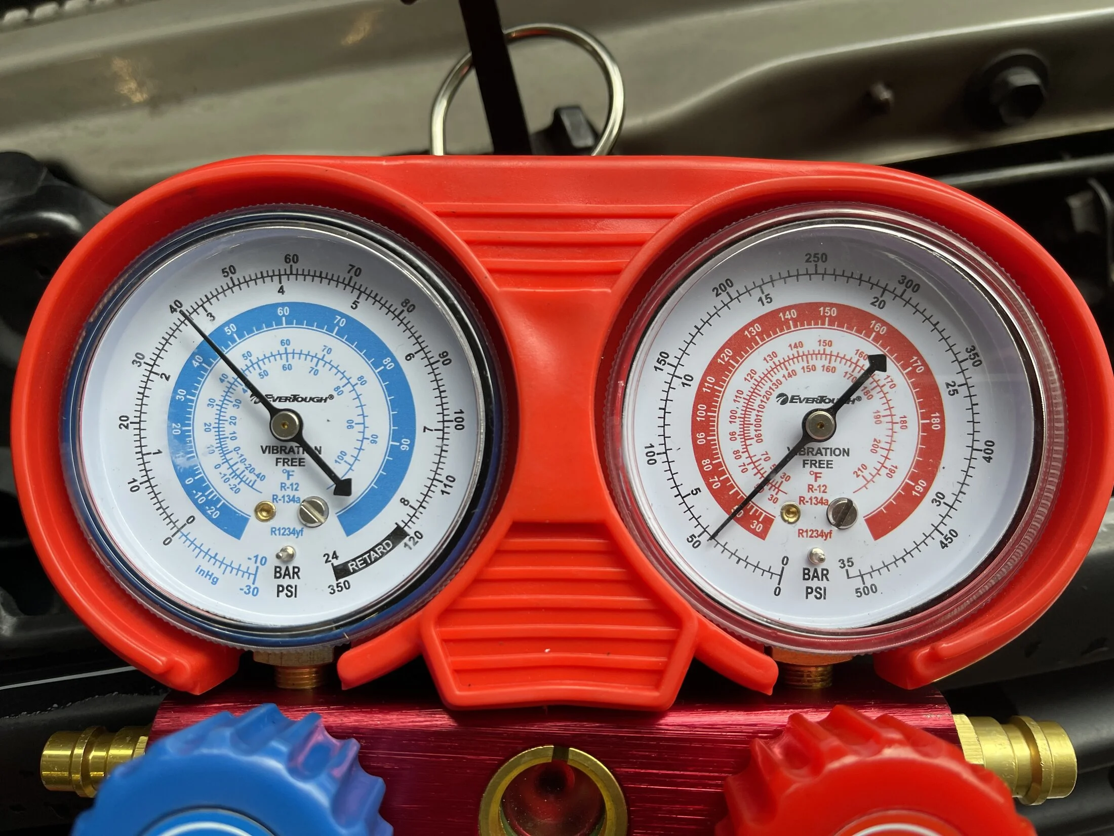

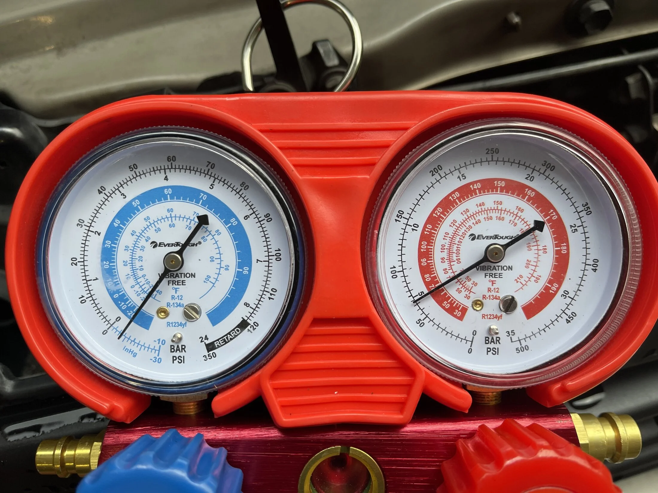

For the guys who have “finished”. I had Torfab connect my AC a couple months back. Not sure if I had a leak or if they didn’t fully charge.
Does anyone have details on how much Freon we should be putting in? 6.0 l96 with. 6l90. One pick is before AC is kicked on. Both sides around 48-52psi. Once it’s on…this feels like we are low on Freon.
Also pressure will
Assume you mean the blue side. The second pic is it running with AC on.
Those pressures are almost equal not supposed to be like that . I can tell you I start off with 2 of the small cans you can buy at local hardware store. Is the compressor engaging the high side red should be way higher in pressure than that . There are some variables to this. I do my own ac stuff and home hvac.
Oh and not hardware store auto parts store.
Thanks. Oddly enough in WA you can’t buy the cans. But we have no emissions requirements. So go figure. The pics are backwards. The 1st pic was with the AC running. I did check the clutch. I watched prob 10 or so YT videos to diagnose before coming here. I assume the system is low and it may have a leak. I have a buddy that is a mechanic who has offered to let me use their machine to evac the system and test it. So I guess that’s the next step.
