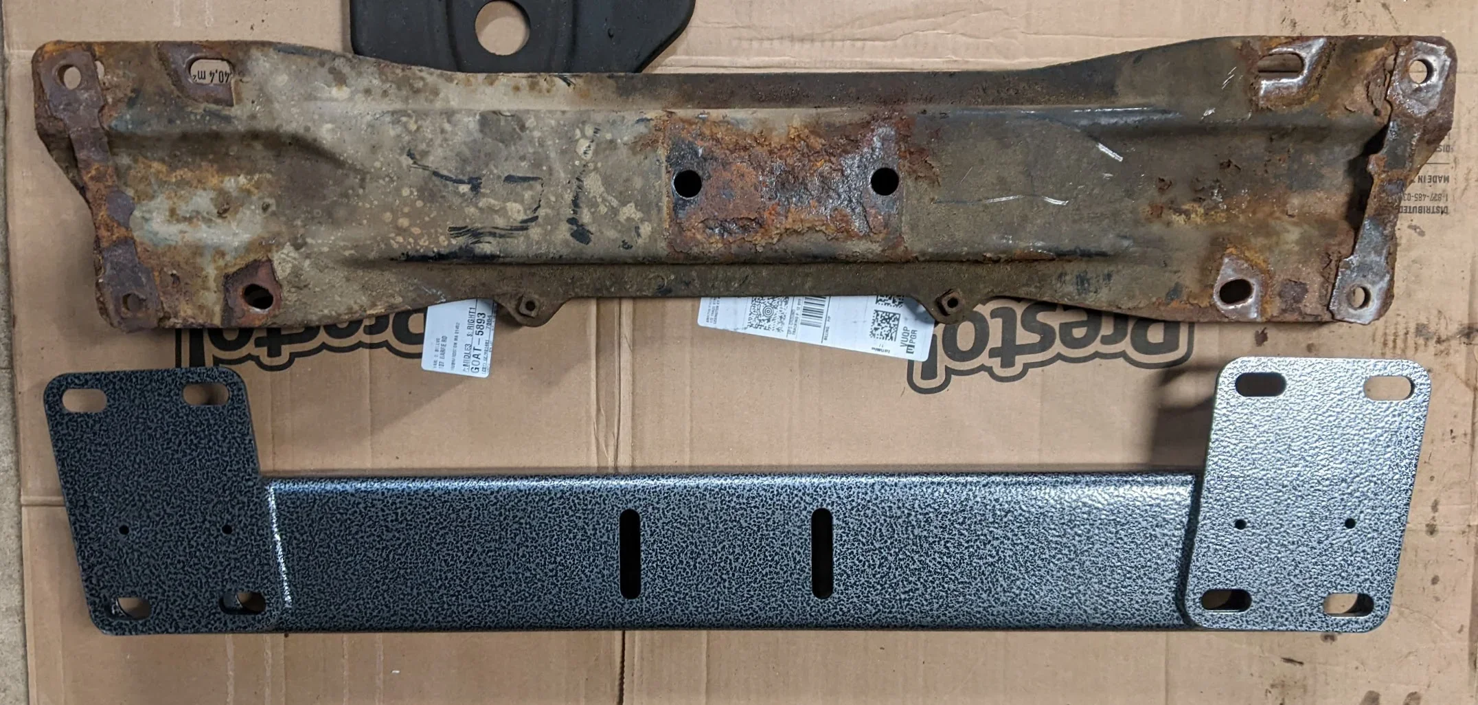

your picture makes it seem it would move it driver side?

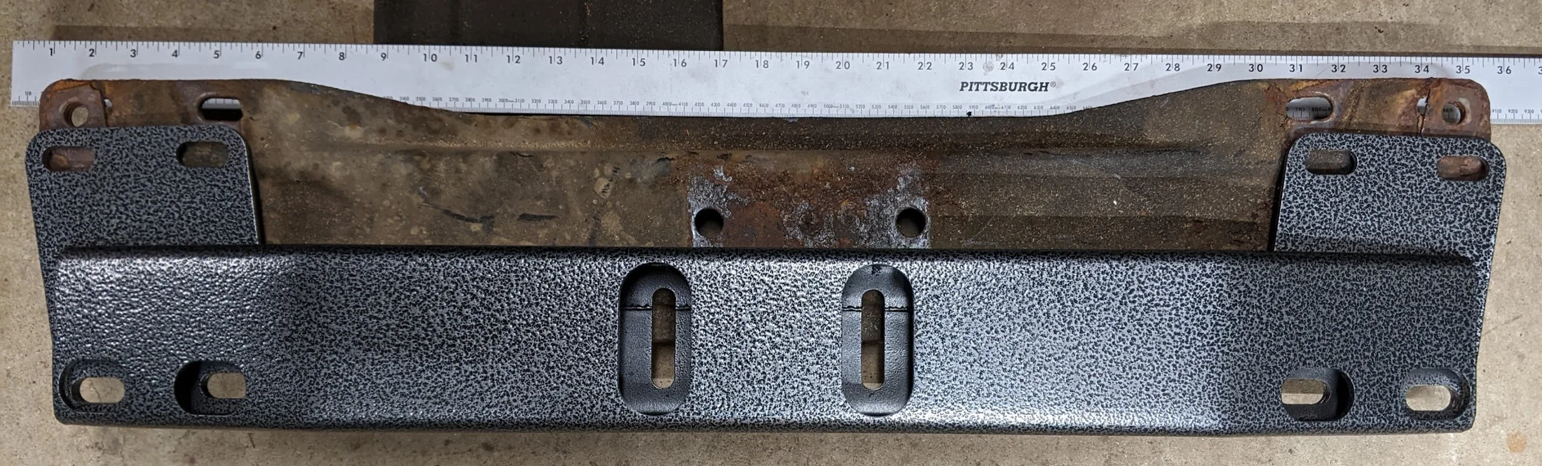

The opposite.
Here is another picture with both in the same orientation.
Looking from top down, and engine is at the bottom of the picture. Selkirk crossmember centers the engine, moving it towards the US Passenger side.
