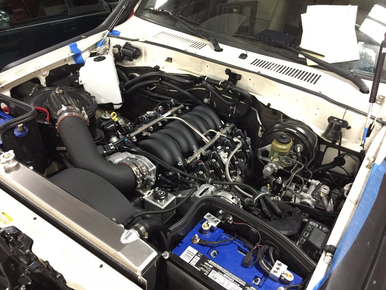

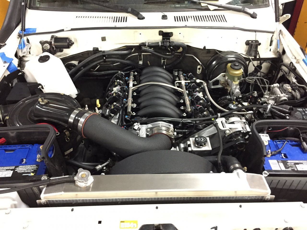

Today's update. The motor started on the first turn of the key! The tach is working, oil pressure gauge, and all other factory lights and sensors are hooked up and working. Engine and trans tuning tomorrow. Dyno runs after the holidays and lot's of testing before I pick it up in January. The blue tape has been removed from all the aluminum parts and it did it's job to protect during the build. Lot's of aluminum fittings and stainless fittings and a bunch of heat shields were made to keep the heat from the cats away from everything. Here is the last picture I received tonight.

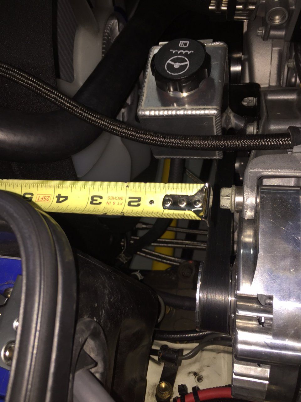

The alternator looks somewhat close to the battery box.. how much room is there?
Also does that outboard alternator setup move the power steering pump in or up to make more room between it and the PS box?
Otherwise, amazing looking rig.
